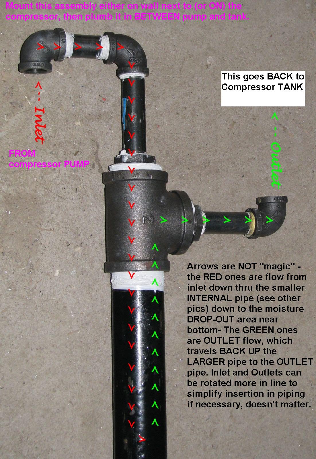

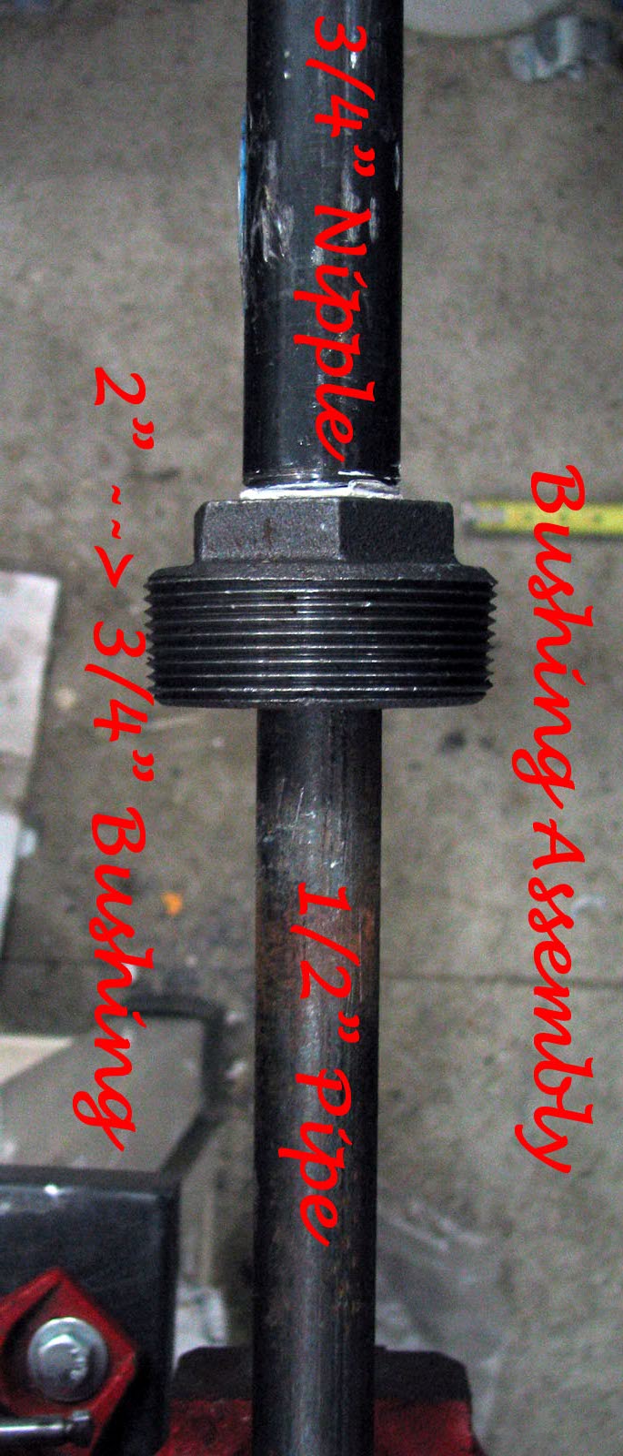

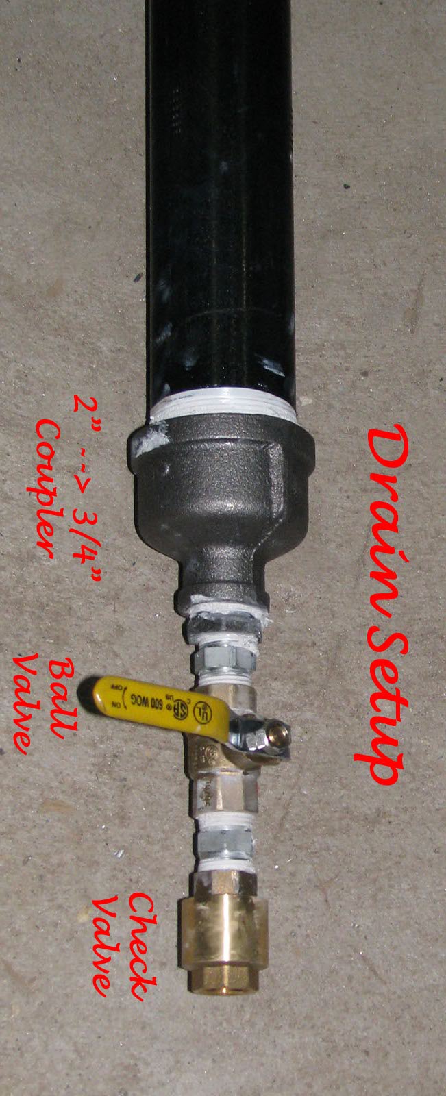

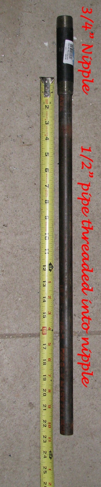

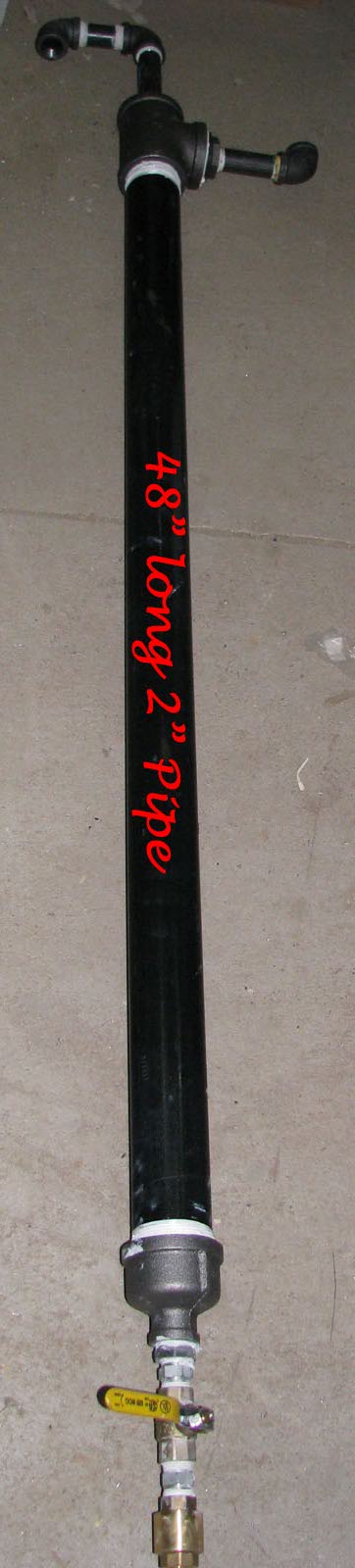

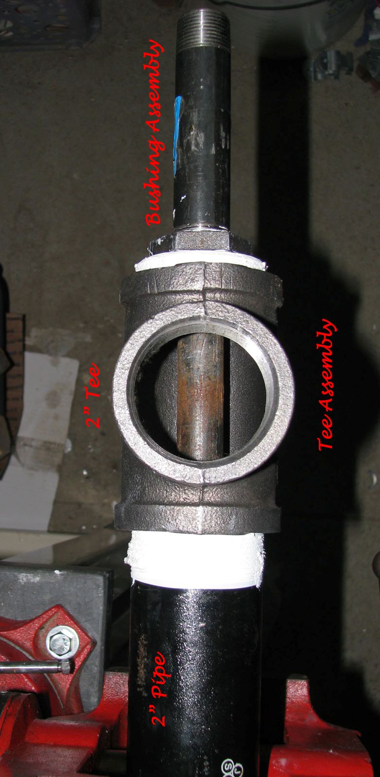

The previous link on "franzinator" has some good info, but could possibly be a little clearer - I tried to re-do some of the pics and add some comments last night, but my internet was down all day til several hours after bedtime; it's back up now, so here goes...
One of the confusions was ORIENTATION in the pics - I've changed them so ALL are shown as they should be when the unit is FINISHED and MOUNTED - in other words, everything in the edited pics is "right side up" - some of the PINK lettering doesn't show up as well, click to expand the pic may help... Steve
View attachment 569920 View attachment 569921 View attachment 569922 View attachment 569923 View attachment 569924 View attachment 569925
Thanks for clarifying Frankenater like putting them in the position that it's suppose to be in, I think if I study it long enough even I can make it, but right now my cheap HF water filter seems to b working, not getting any water out of my air tools.

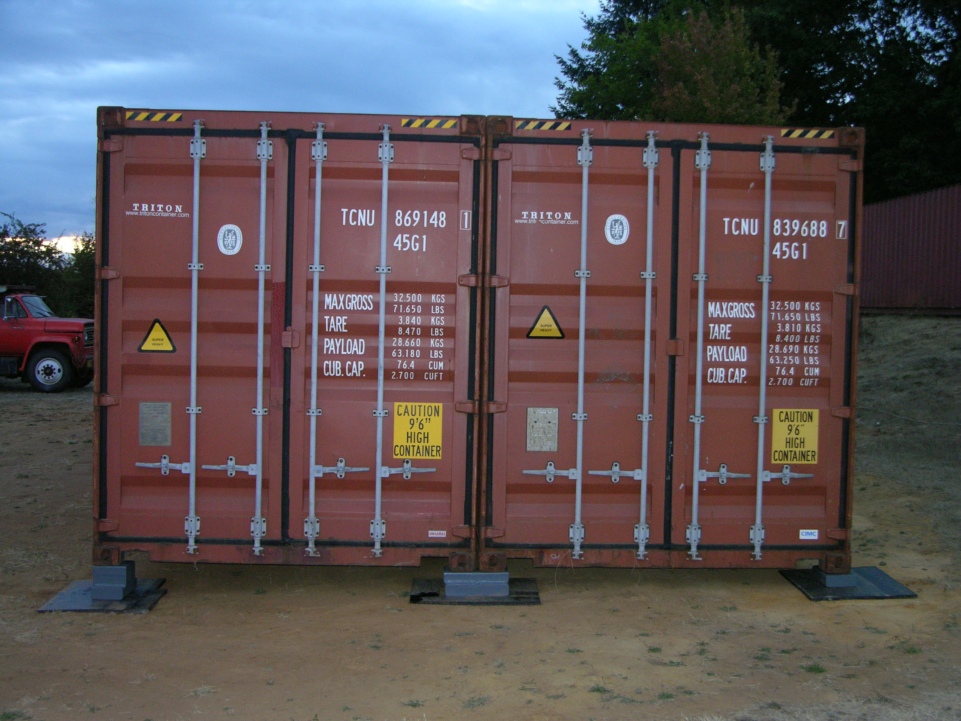

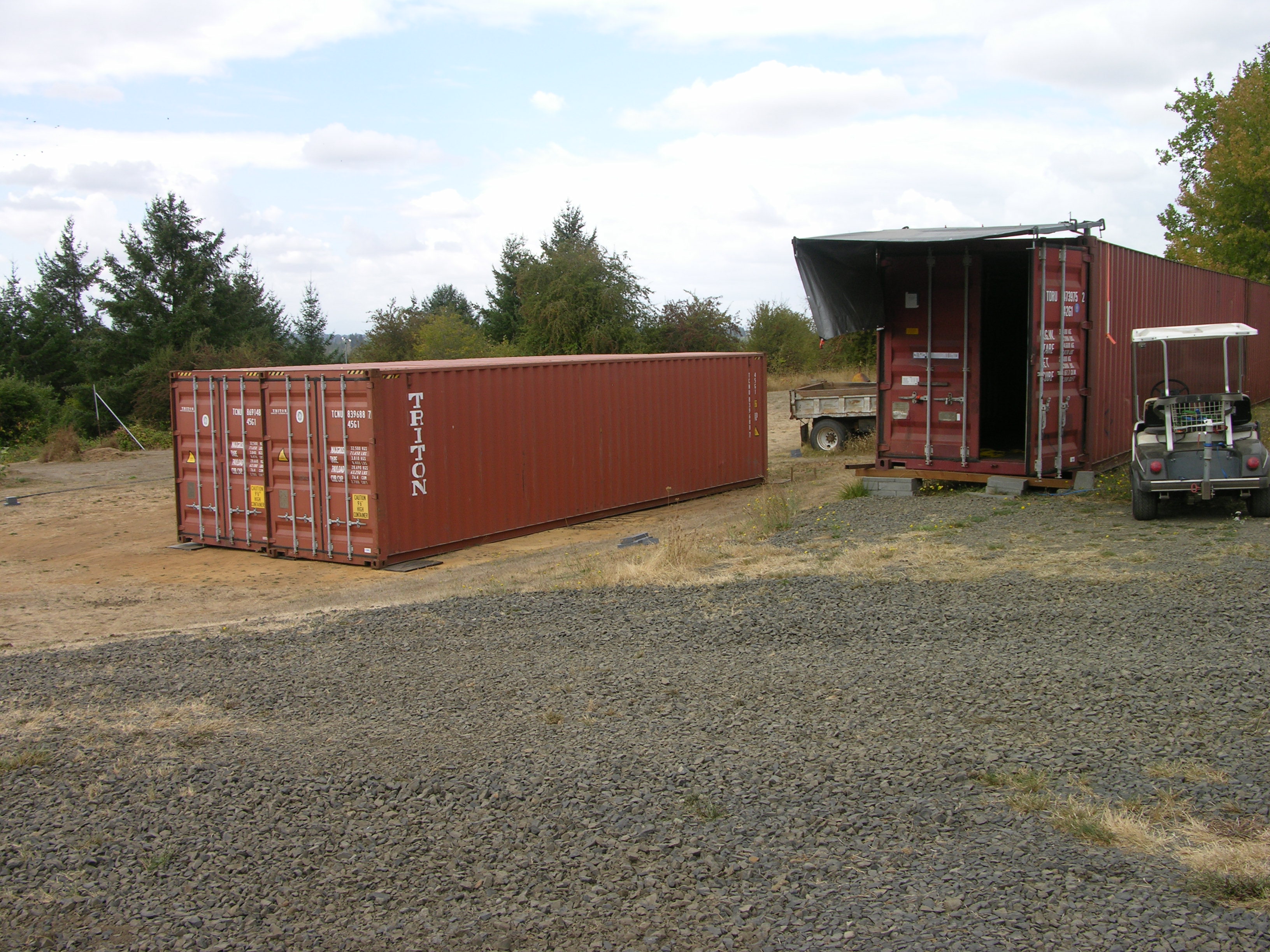

On another (less off-topic) note - my "container guy" finally found time for one of his better drivers to stop by and move the two hi-cube 40's where they'll stay - we were both too busy "beating the clock" for me to get pics of the roll-back truck in action, but here's what I DID get -
"Way before (where they were for the last few months)
The goal was to get the containers moved into place while weather was still DRY; that's CLAY soil, and it doesn't tend to play nice with wetness and heavy equipment :rolleyes: ...Steve
/ Container Weld Shop build -
#510

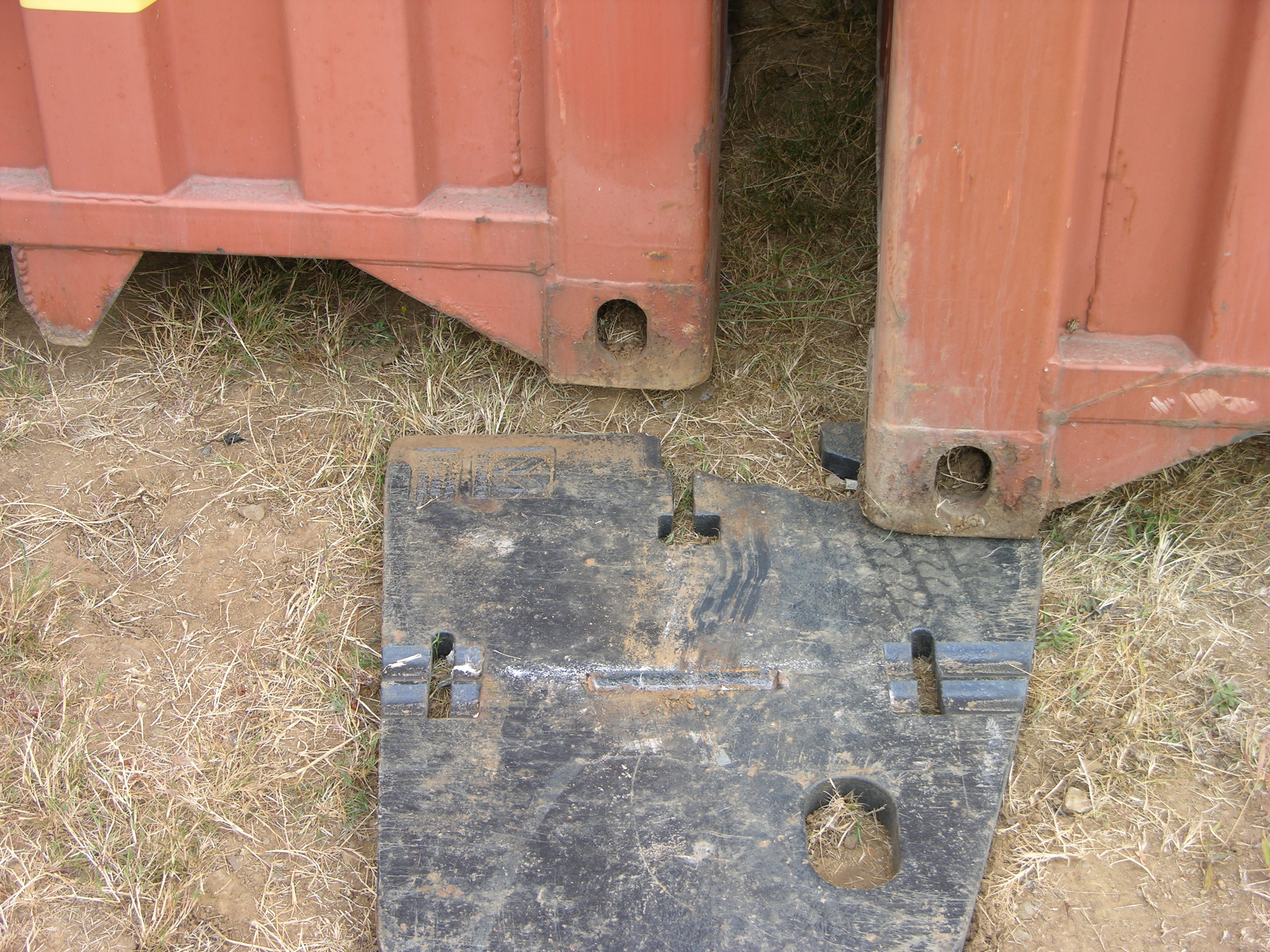

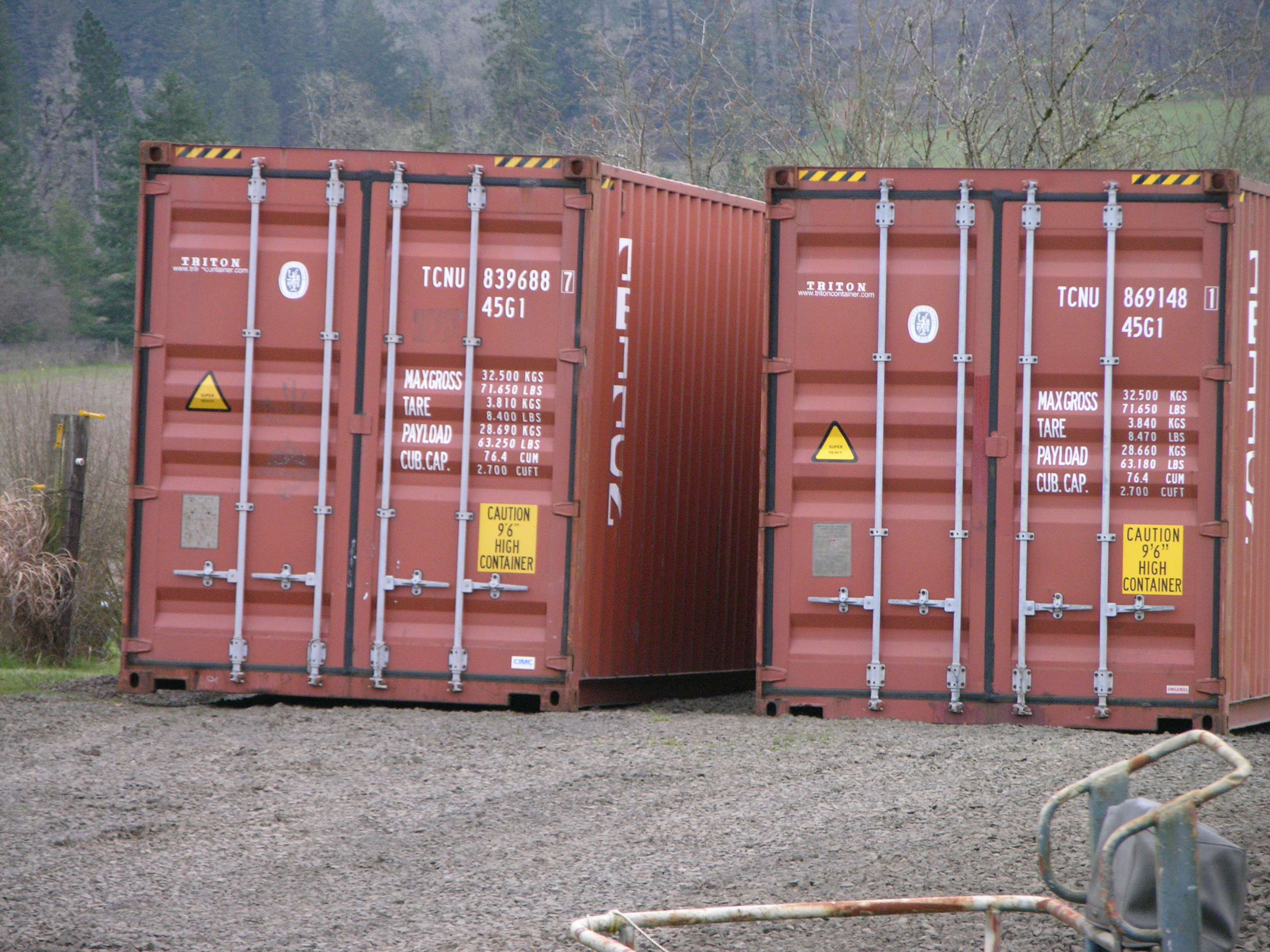

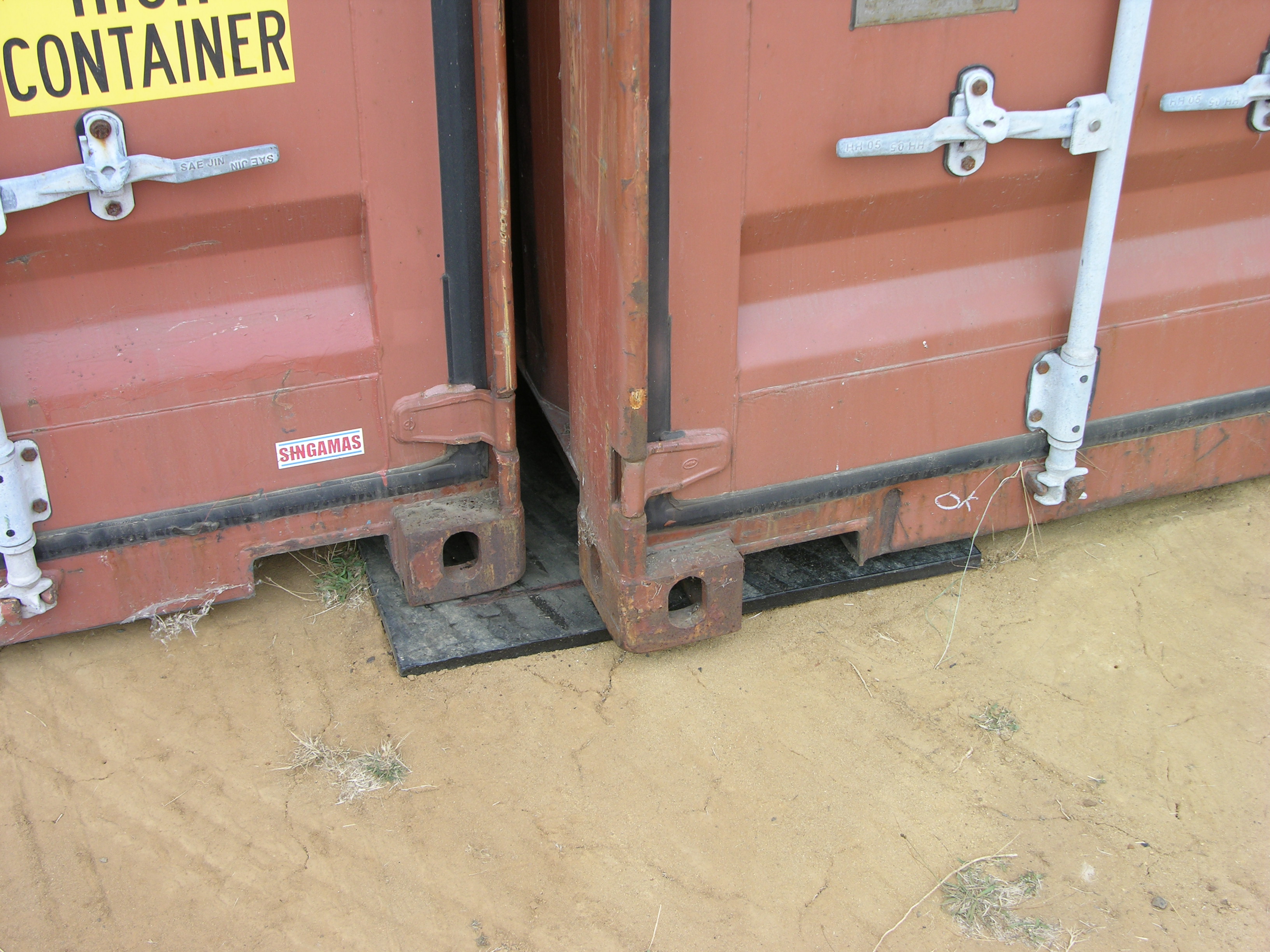

Next is AFTER both containers were sitting (sorta) on their respective "floatation" pads, but BEFORE the "mil-spec Lego blocks" get set so they'll be LEVEL...
Sorta CLOSE -
DSCN3416.JPG DSCN3417.JPG DSCN3418.JPG DSCN3419.JPG DSCN3420.JPG DSCN3421.JPG DSCN3422.JPG DSCN3423.JPG
More to come - because of a slight slope and less-than-ideal jockeying room, that's as close as I dared ask, soooo... Steve

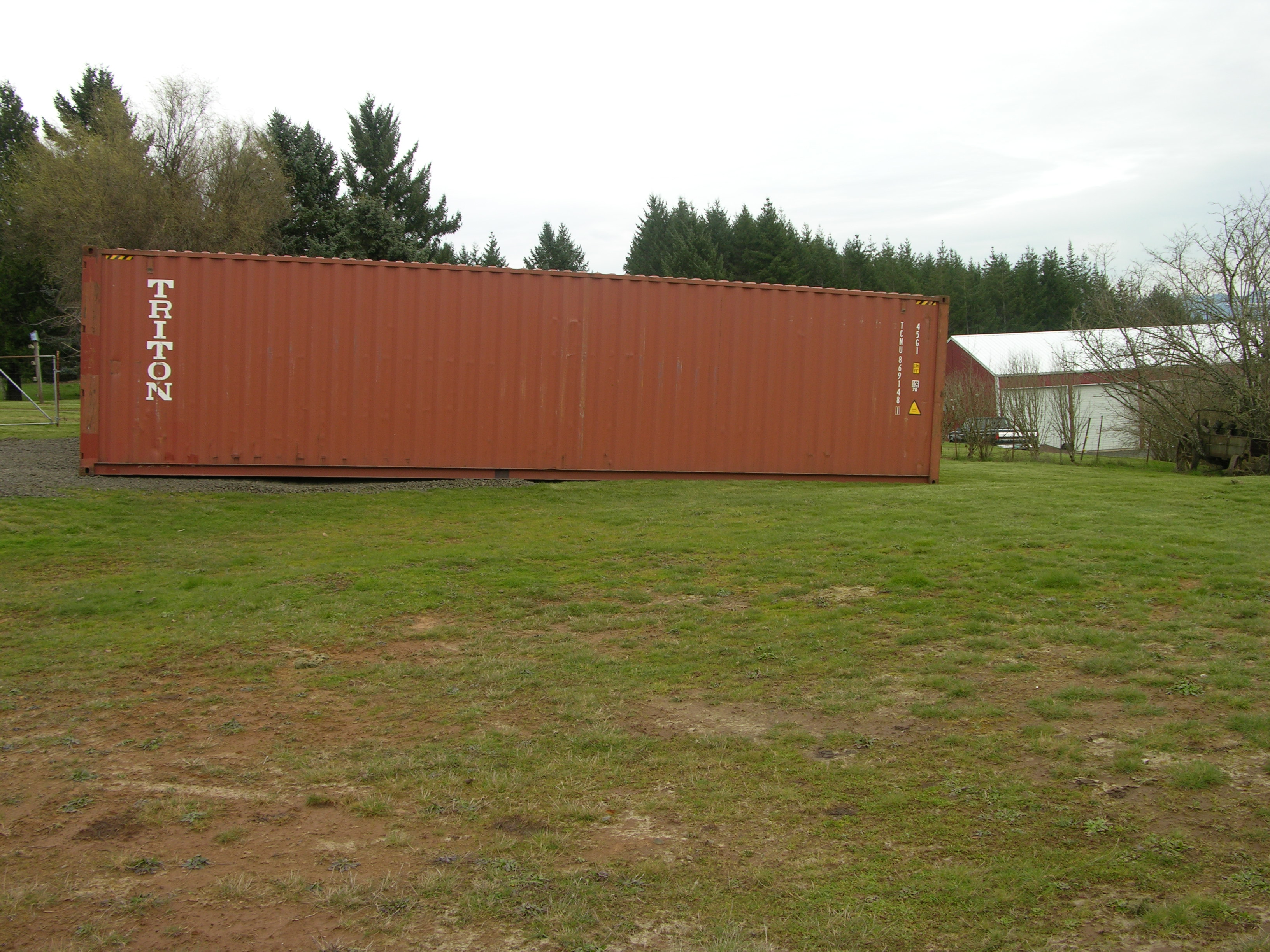

About 45 minutes later, using "the Force" and (occasionally) a chain -
CntnrsB4Lvl-1.jpg CntnrsB4Lvl-2.jpg CntnrsB4Lvl-3.jpgCntnrsB4Lvl-4.jpg CntnrsB4Lvl-5.jpg
About 5 minutes after the last pic was taken, it started to RAIN - That was Monday, and it's rained some every day SINCE - but my backhoe is NOT mired in mud, so I'll TAKE it :thumbsup:
Hoping weather holds the next couple days, I should be able to get all the Lego blocks set and final position "tweaking" done, (using the 2 20 ton air/hydraulic jacks with the toe jack adapters I made, plus a couple chains and ratchet binders) - maybe even another coat of paint to cover the inevitable scratches on the blocks.
I DID manage to shoot the lowest corner and surrounding area with the rotary laser, and it looks like drainage won't be a problem. I do NOT want standing water near those plates, or things might get a bit saggy... Steve

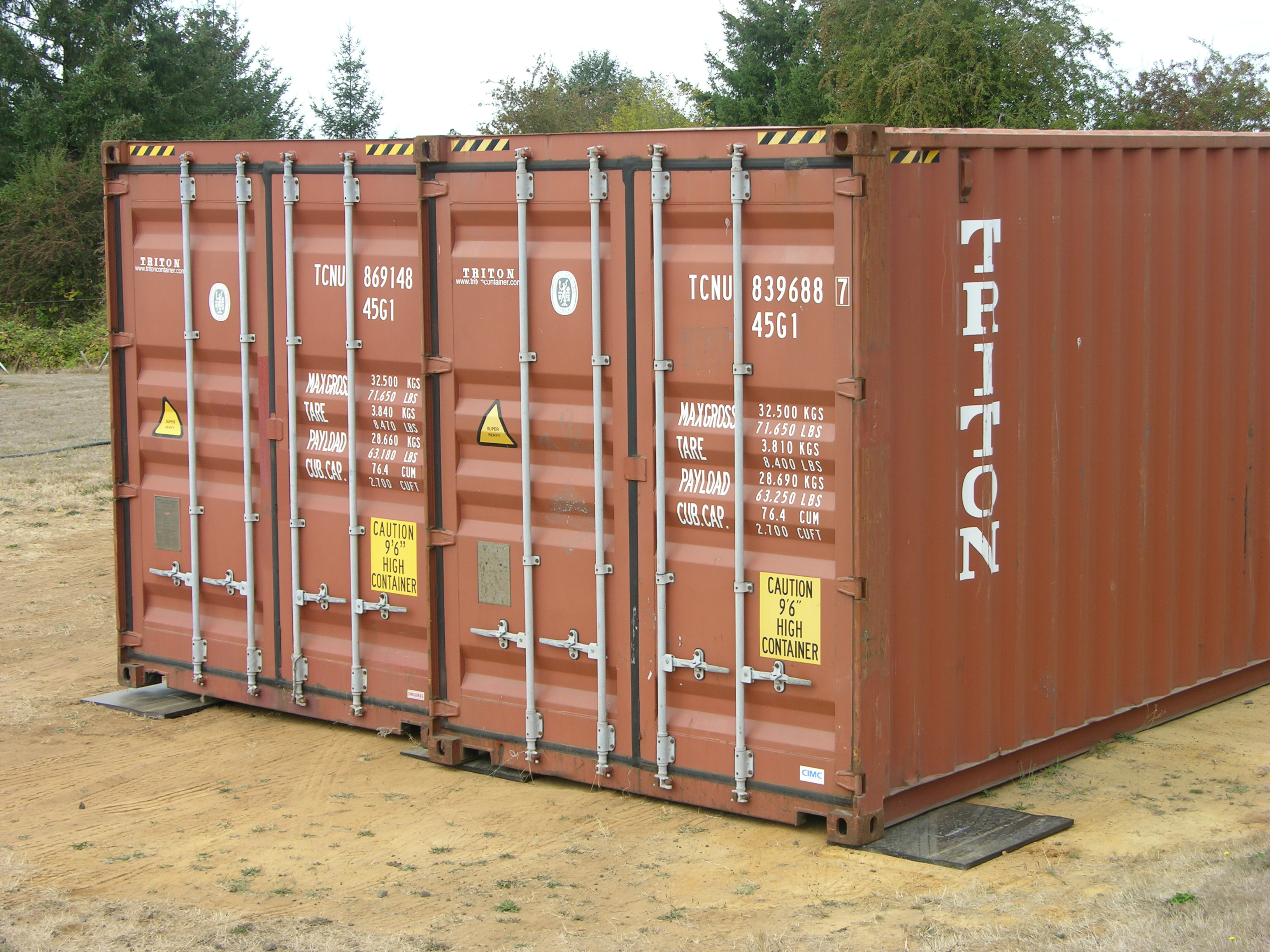

#1 grandson showed up right on time (10am), things looked like this by noon -

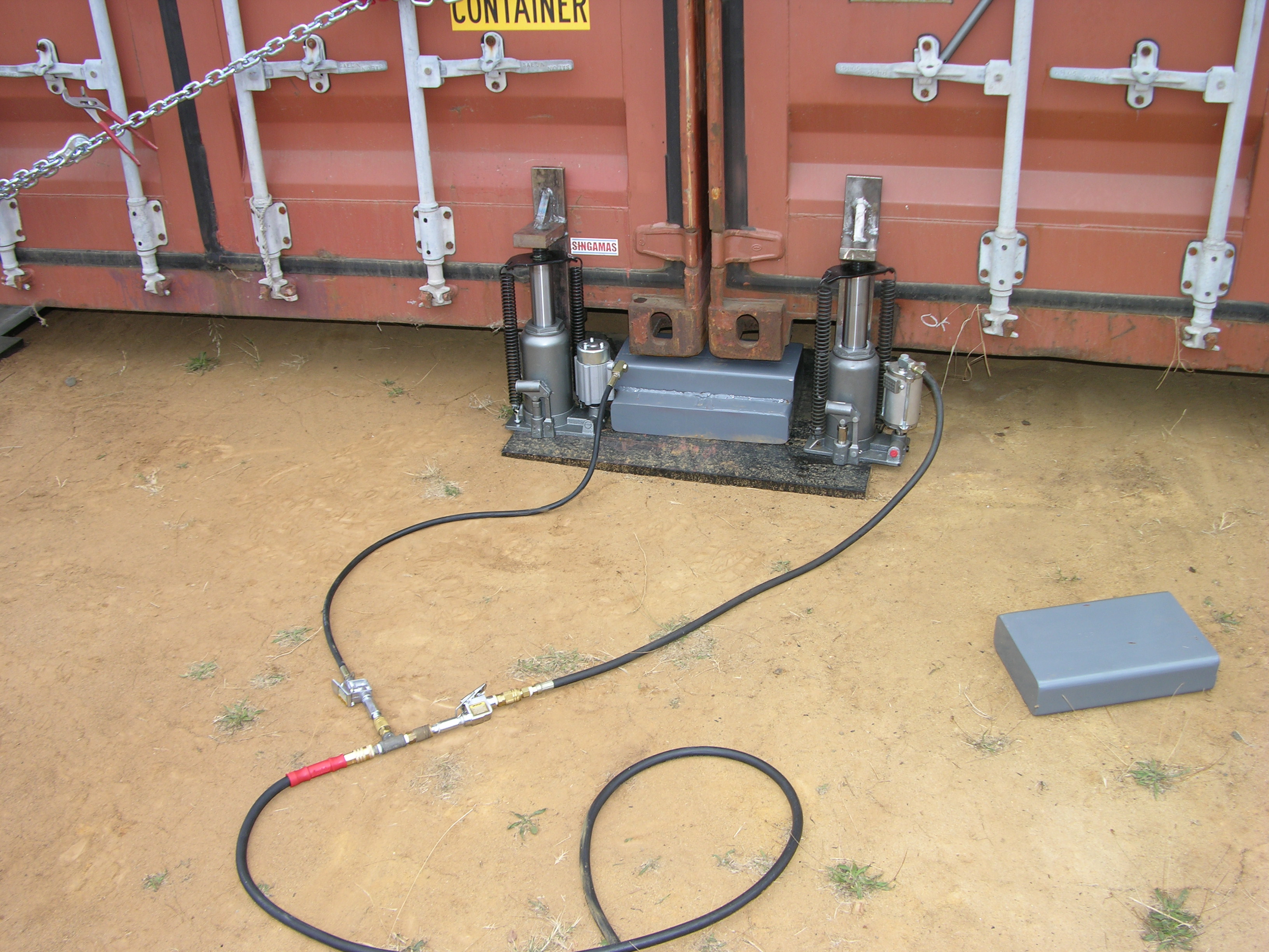

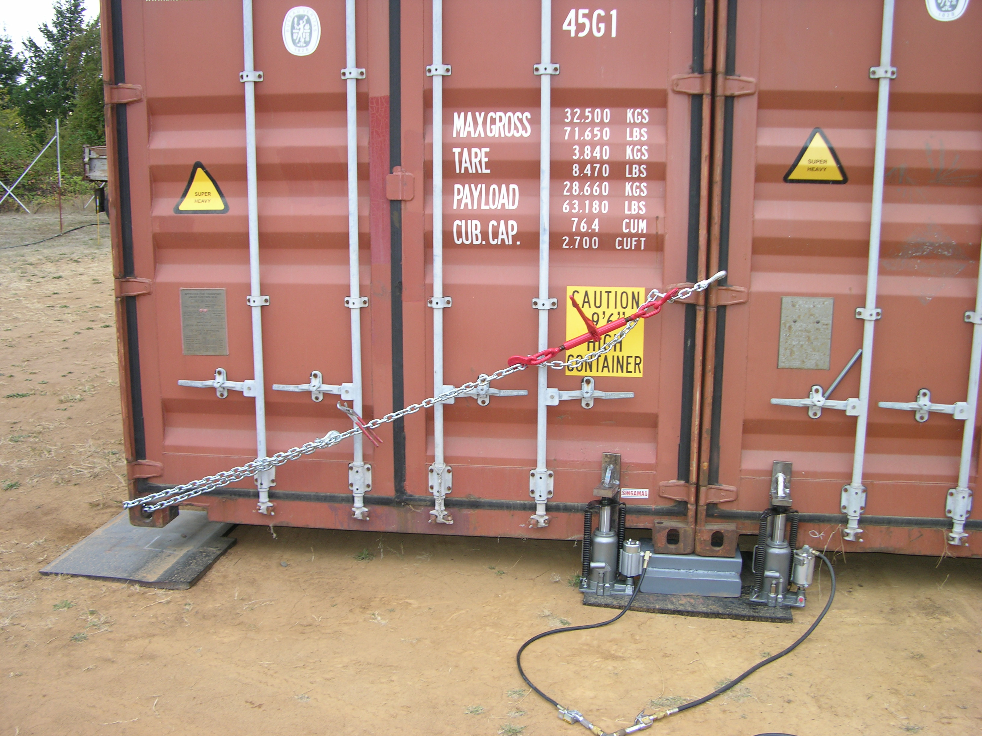

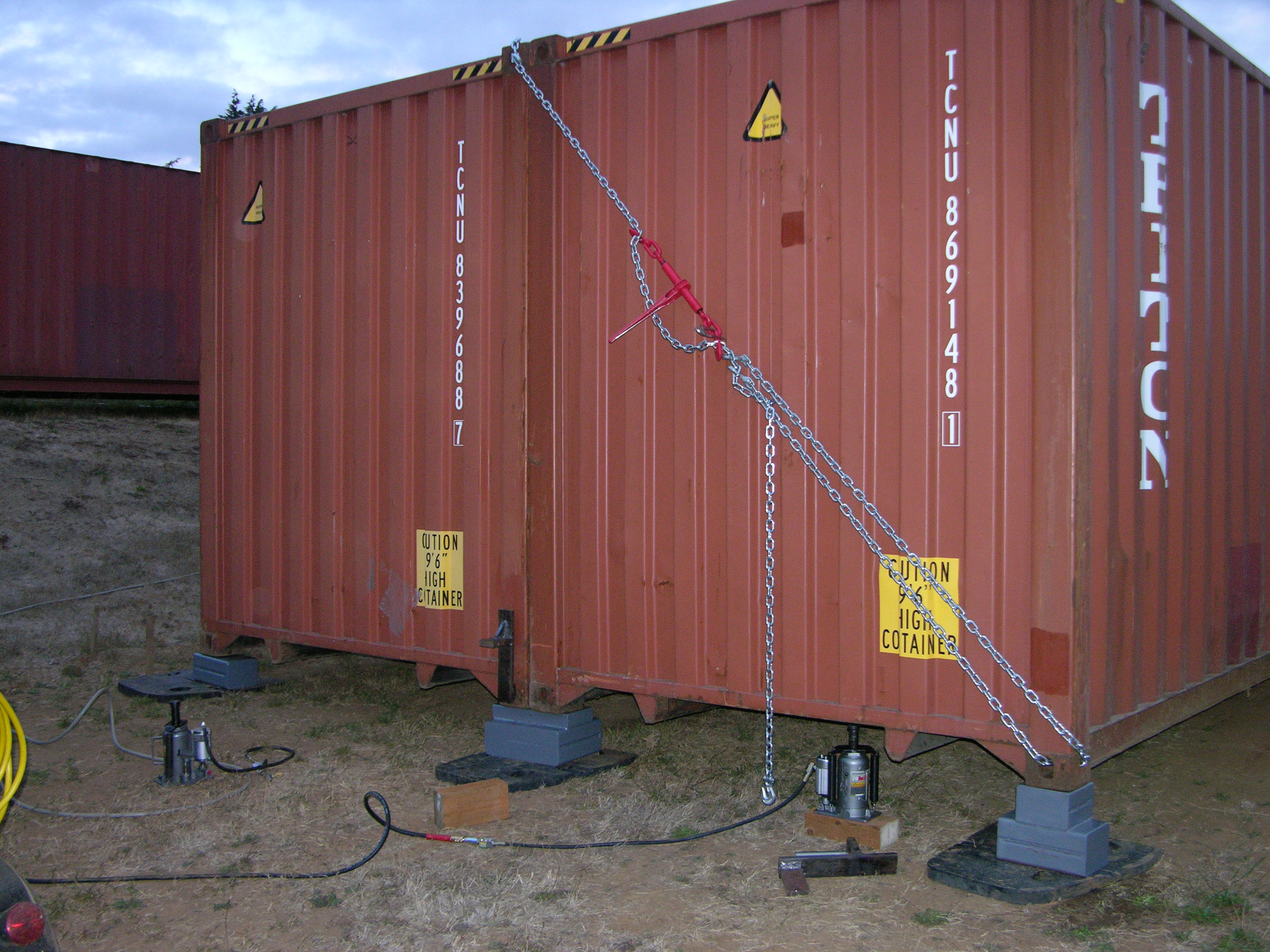

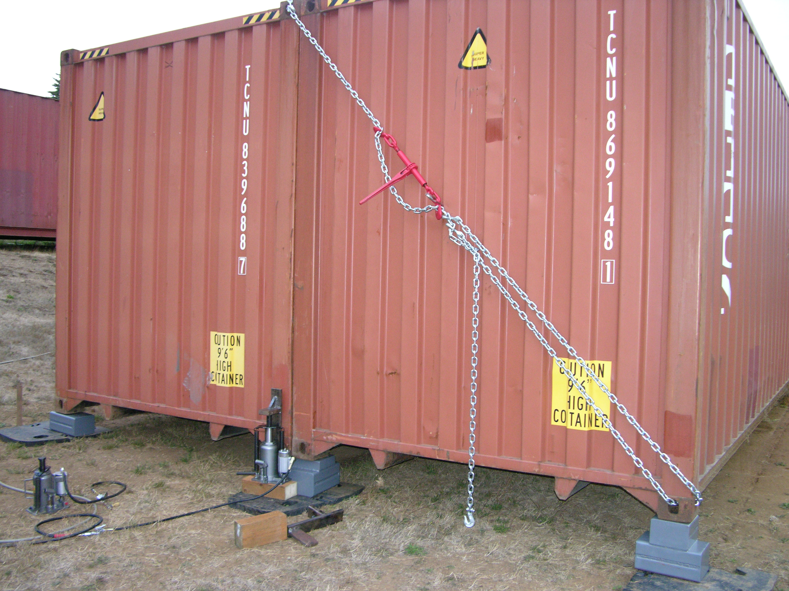

Started gathering rigging stuff about 2pm; both containers needed to be lifted onto their center blocks at the same time, just barely enough room for 2 20 ton jacks at the outer edge of the plate and still able to get the double wide center block in place -
The 2 jacks get used in conjunction with 2 toe jack adapters I built for setting the previous 2 containers - not perfect, but usable. Also note the diagonal chain - this helps one container be the "boss", and the other one move - the high end of the chain pulls DOWN on its container, which gives that one a bit more "traction" so (if footings are about the same friction) the LOW end of the chain is the one that moves when they're jacked up...
Back ends, similar principle - Notice the right rear pylon needs some "attitude adjustment"...
Shoulda left that chain across the FRONTS - note the gap between front ends :rolleyes:
Rears done, had to jack the right rear corner and "nudge" that pylon inward a bit with the loader -
Then back to the front for another gentle nudge with the loader, gap is gone - left the rear diagonal chain ON this time; Done, about 5:30 pm
