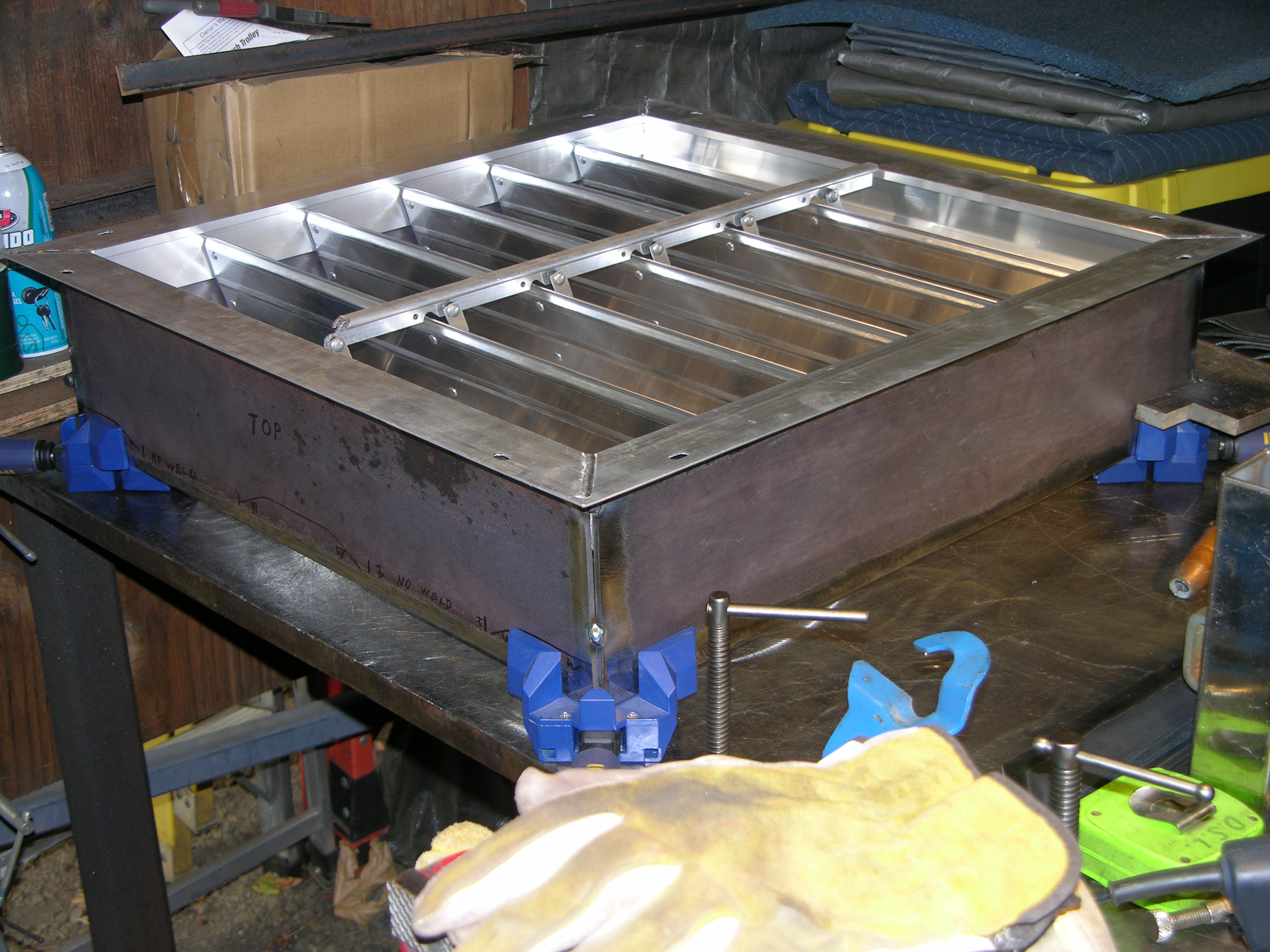

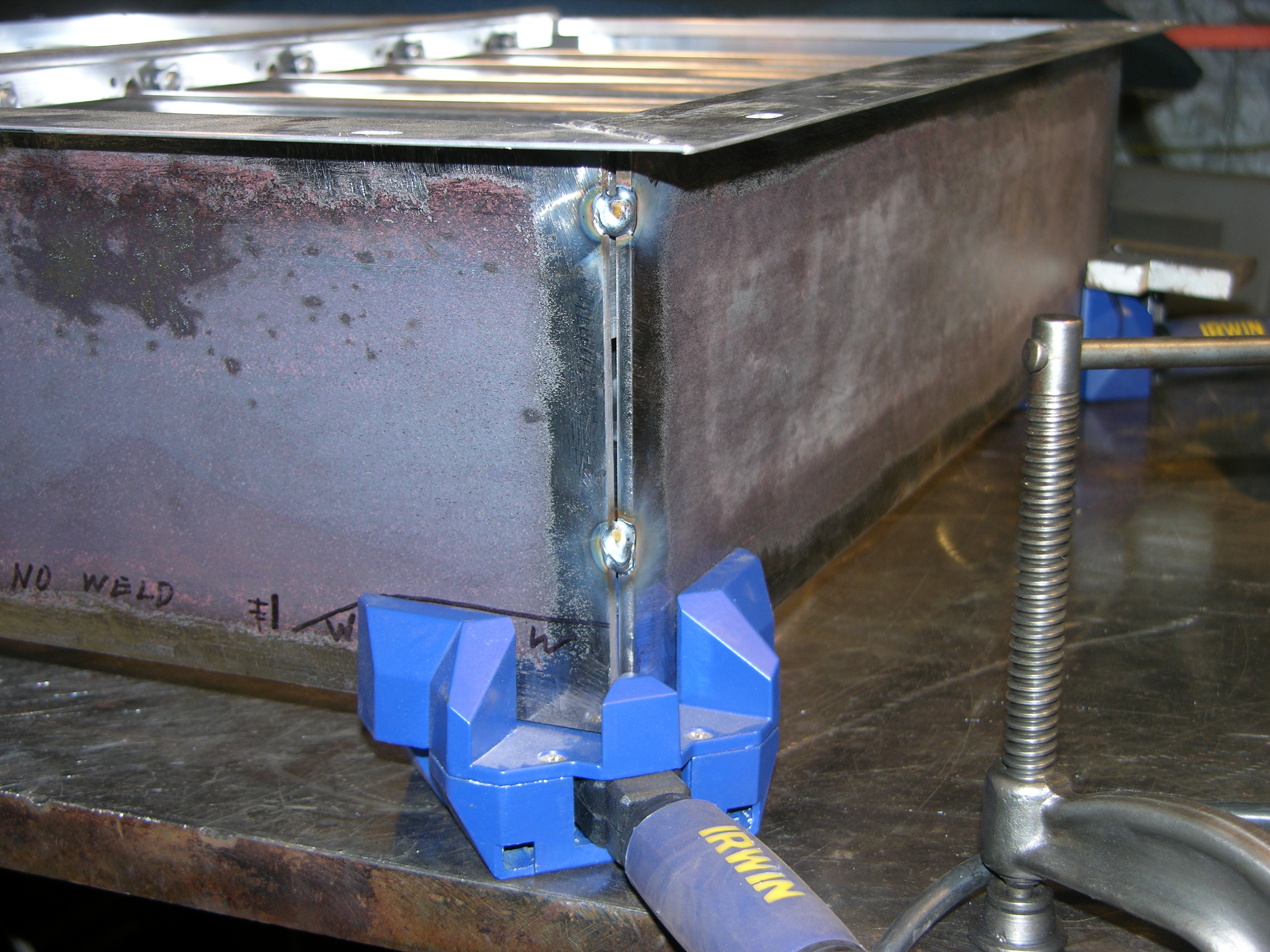

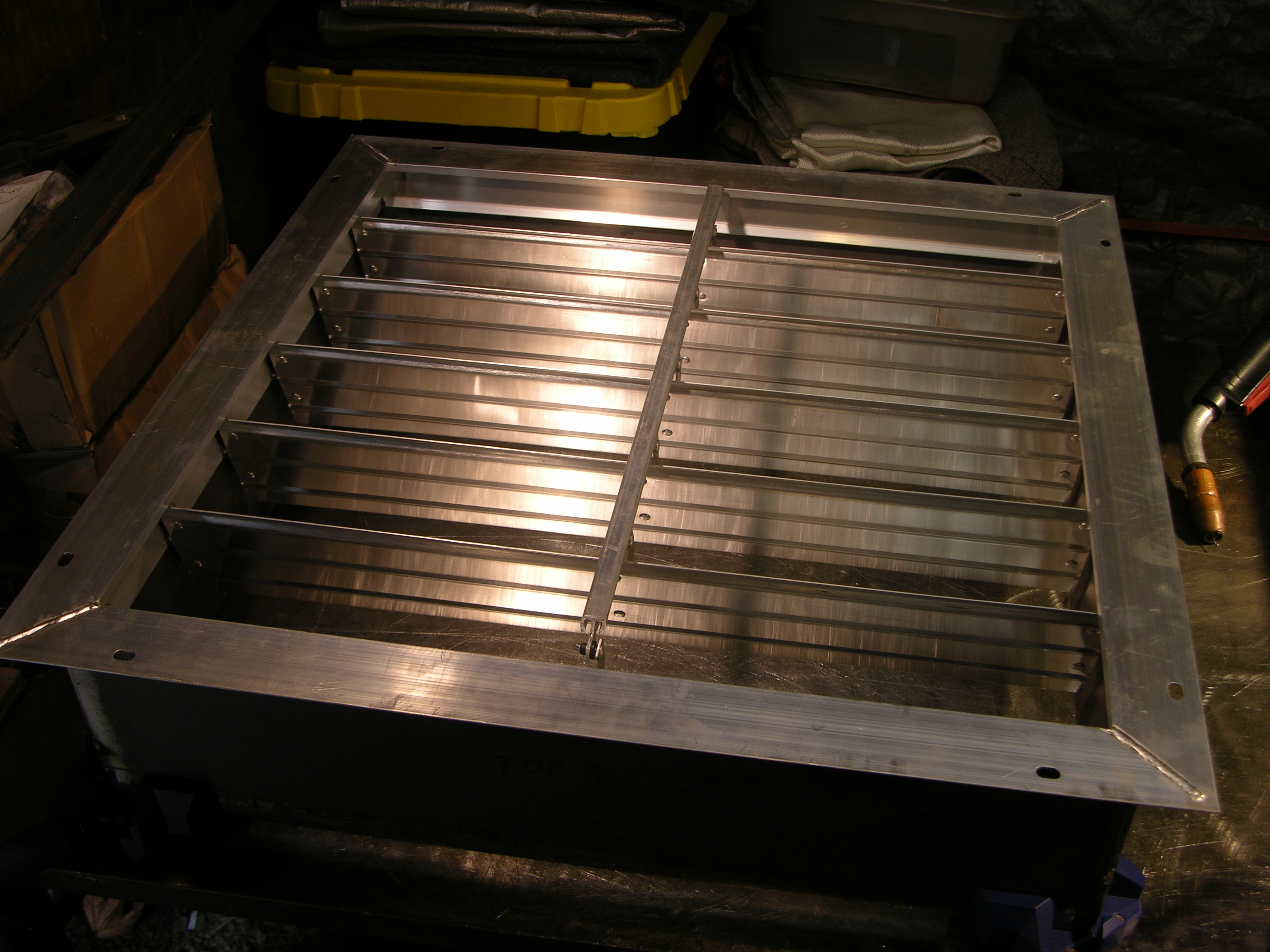

Got a little more done on the bigger louver insert today - a test fit after tacking the 3/16"x6" sides together; if it looks like the corner gap is a bit bigger at the top of the joint than at the bottom, it's 'cause it IS - when I was checking sizes, etc, I didn't notice that the pivot points for each louver stick out about 1/16" past the aluminum frame, so the part of the steel insert where the louvers mount needs to be just a little wider than the rest - too late to start over, so I just clamped the sides a bit further apart at the top before I tacked 'em -
This is what the louvers look like open and closed; that bar down the center gets a spring/chain/actuator motor. Gravity closes, motor opens by pulling the bar downward - DSCN3405.JPG DSCN3406.JPG
The 1/4"x2" mitered flat bar that's clamped to the table will get welded to the vertical pieces, then the whole assembly (minus the louvers til later) gets welded into the hole that'll get cut in the container wall - then, from outside to in will be 1/2" 1018 cold roll rods vertically every 2" across the opening with another welded in the center horizontally (for 2-legged varmints) - inside that will be 1/2" hardware cloth (smaller, 4-legged varmints) then a window screen/frame - the louvers themselves will protrude into that frame by about 4" or so, that's why the 6" sides - otherwise the louvers would hit the screen. DSCN3407.JPG
Then the aluminum framed louvers will get bolted to that 1/4"x2" mitered steel frame, that way I can clean/change/replace louvers if necessary (AND clean the screen), WITHOUT the 2-legged varmints being able to unscrew anything that'll give 'em access.
I'm keeping copious notes on my phone (notepad app) during this "prototype" so hopefully the other 8 (incl. an extra 2' louver for the other shop, to match the exhaust fan I already have in there), won't take much longer for ALL of 'em than this ONE has taken... OK, where's the "dang, I hope I didn't just lie to everybody INCLUDING myself" emoji??!?
Oh, and I'm writing the book itself; it's up to YOU guise to write the book REPORT :laughing: ...Steve
View attachment 567743 - it's easier to see in this pic - View attachment 567744 :laughing: ...Steve
