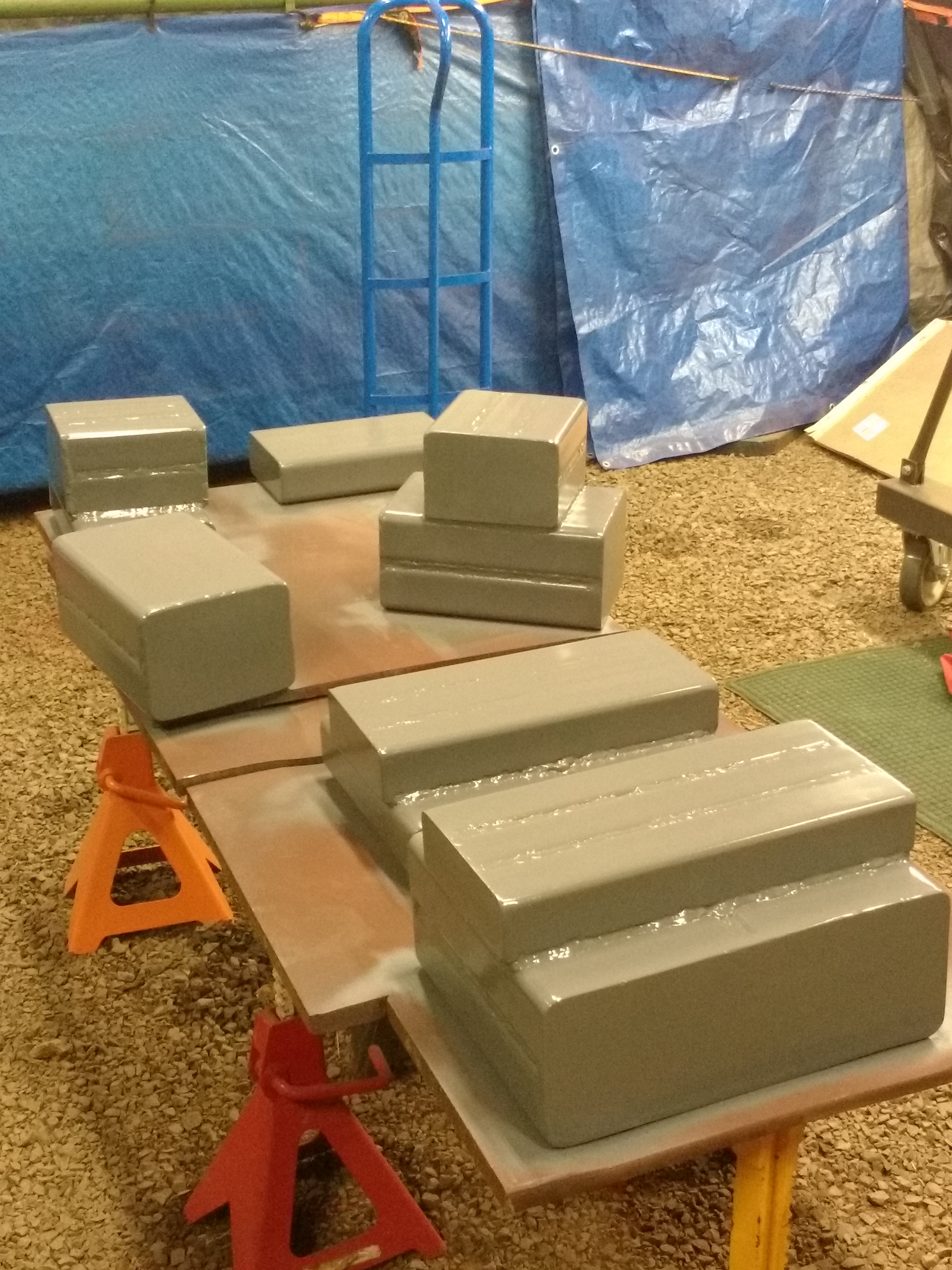

"And what's with the red primer"
That pic was shot immediately after I did a real heavy coat; it's just Rustoleum Ruddy brown, I think it's called - dries more brown than that pic. It's a close match to the container color, so it gets the wife's vote :D

I'm so tired of those blocks by now I'm tempted to just put 'em in primed, but I know from experience I'd be hosin' 'em with MORE paint before long - I got some red scotchbrite pads, they kinda match the primer so I'll probly give 'em a swipe or three with the pads - I got plenty of "smoke gray" paint rattle cans, maybe give 'em a coat of that manana...

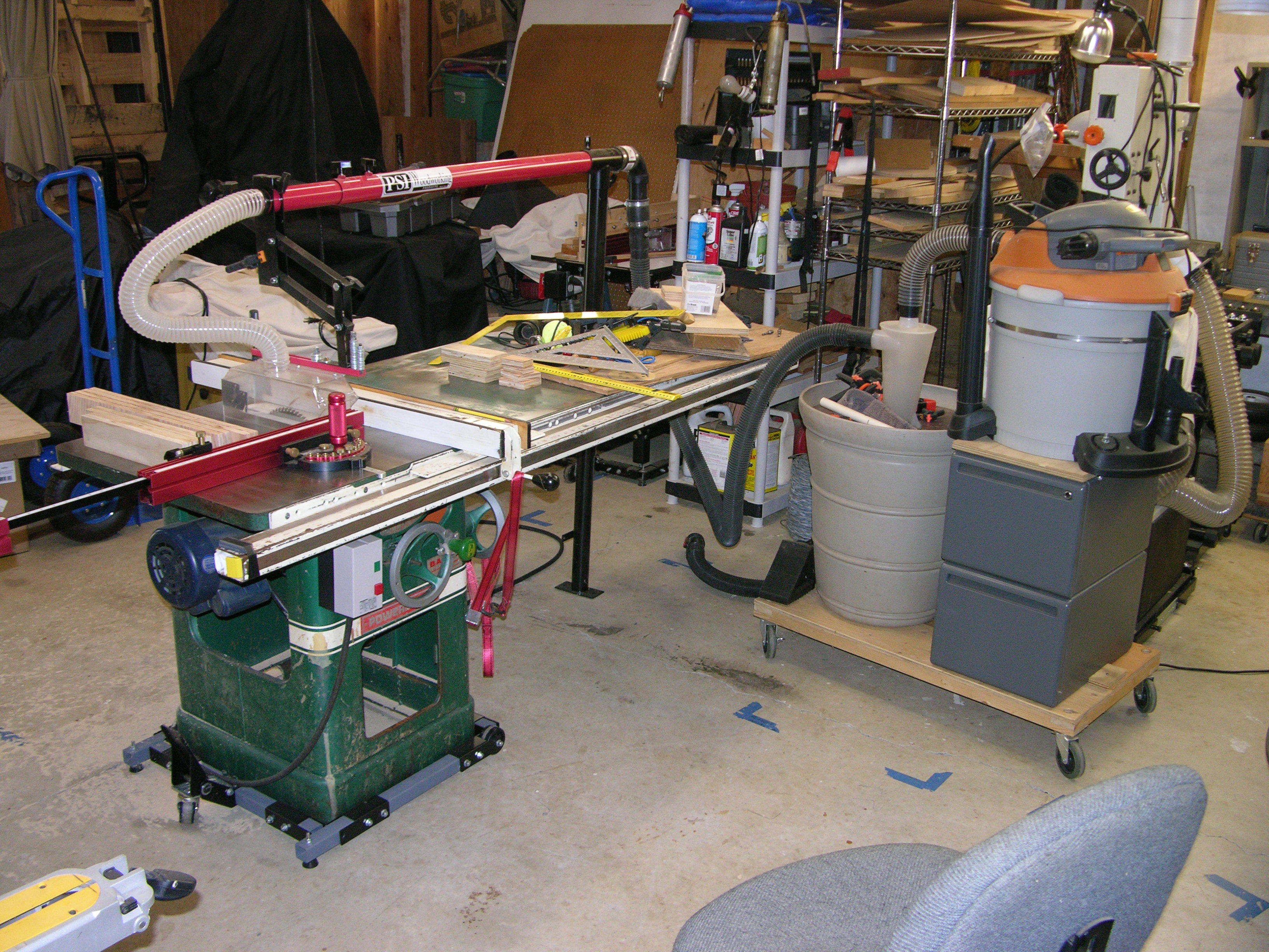

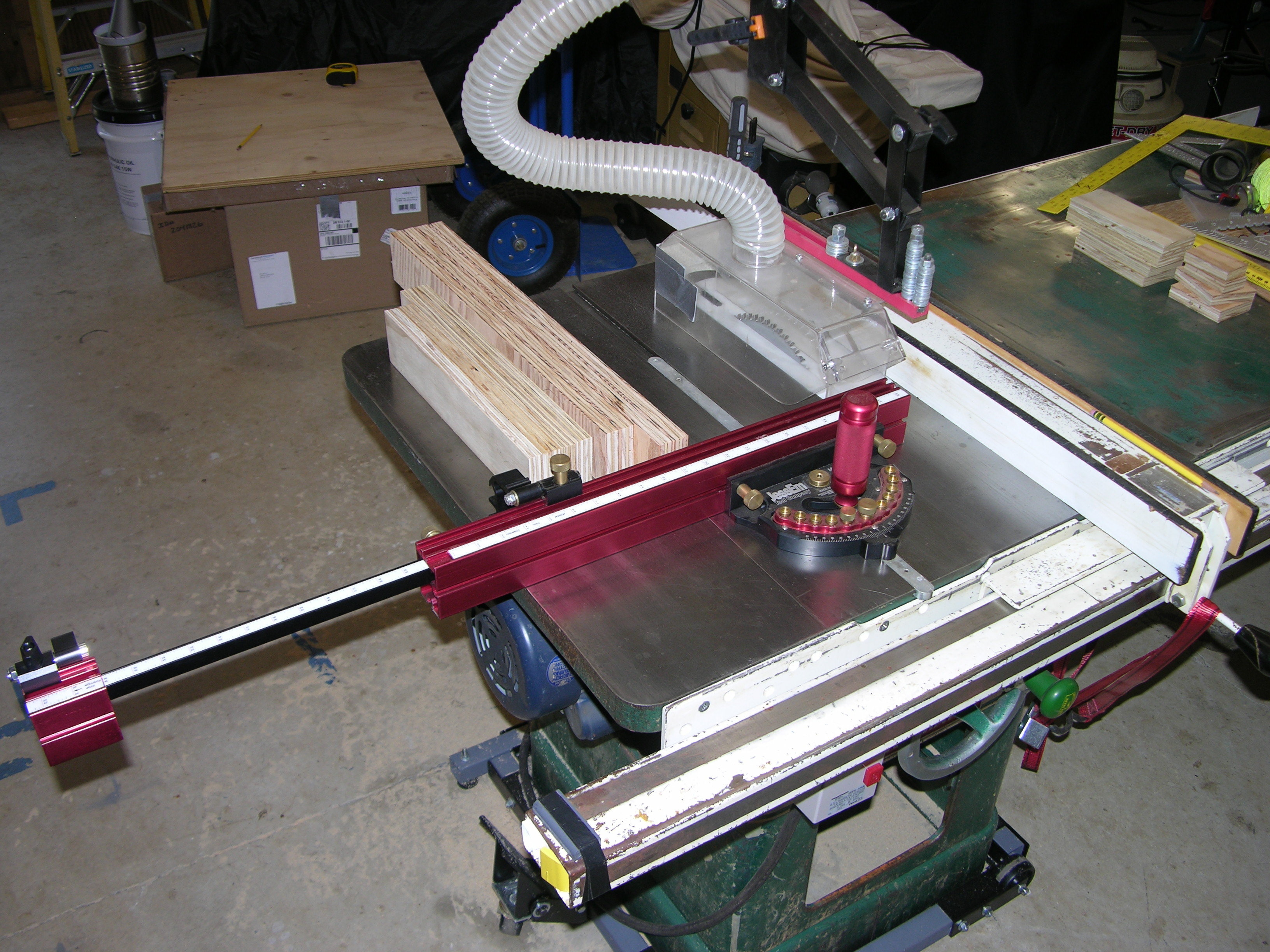

Here's what I got done today (after moving nearly everything in the shop, scrounging around for enough scraps of 3/4 ply to do what I want, etc..)

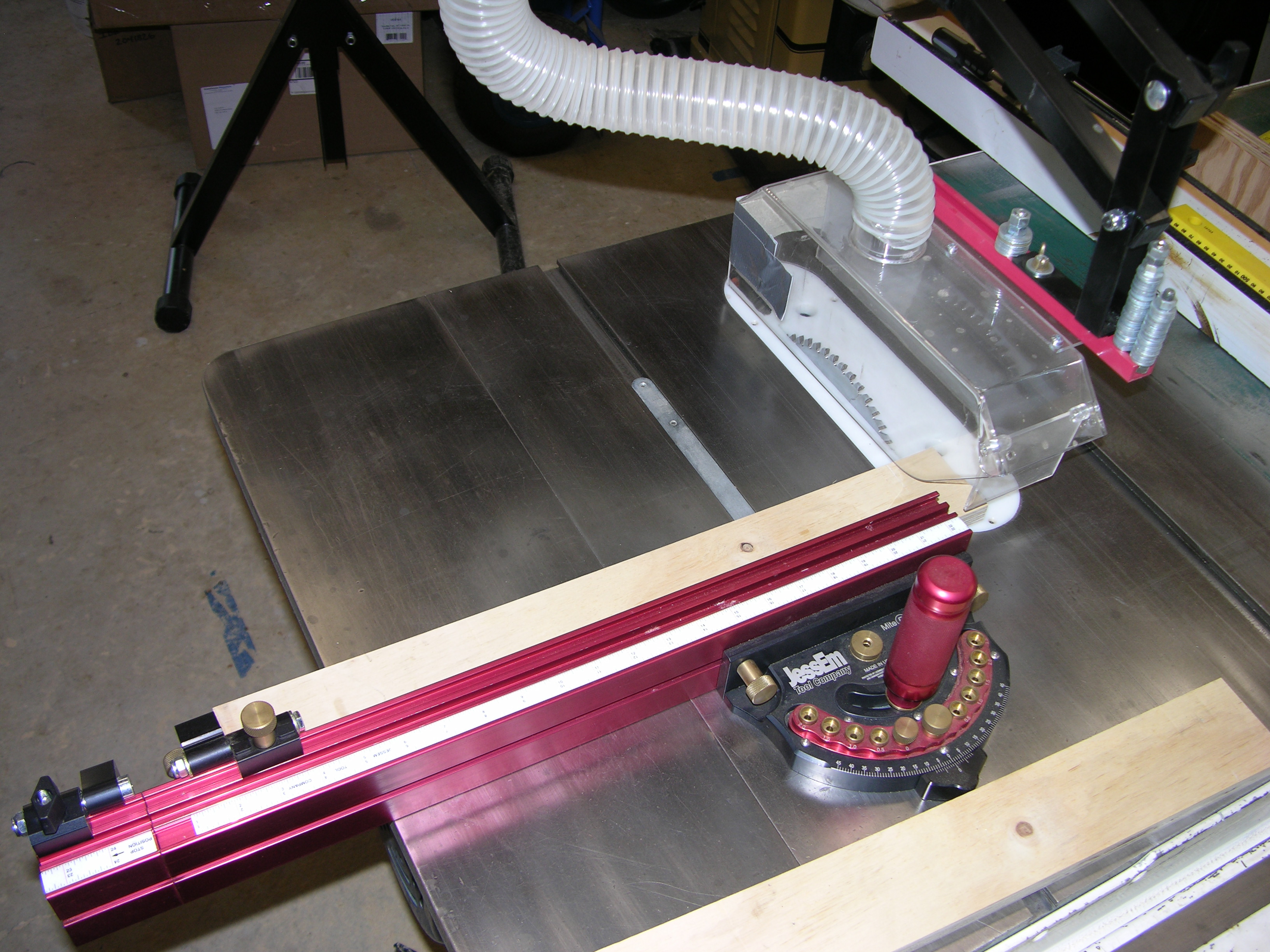

My old PM66, and a miter gauge that probably costs more than some saws - DSCN3386.JPG DSCN3387.JPG - saw's kinda old, but I got it lined up so it'll cut within less than .2 degrees, runs so smooth I can (and HAVE) balanced a nickel on the table with it running.
I still need to spend some time working out improvements to dust control on the saw, it didn't have a motor cover when I got it and I'm moving the lower dust port 90* so it'll be under the extension table, that way both dust collection hoses will be together - one to the bigger cyclone and the overhead to the shop vac. Also need to come up with a slick internal "ramp" that'll encourage the dust to actually WANNA go to the port...

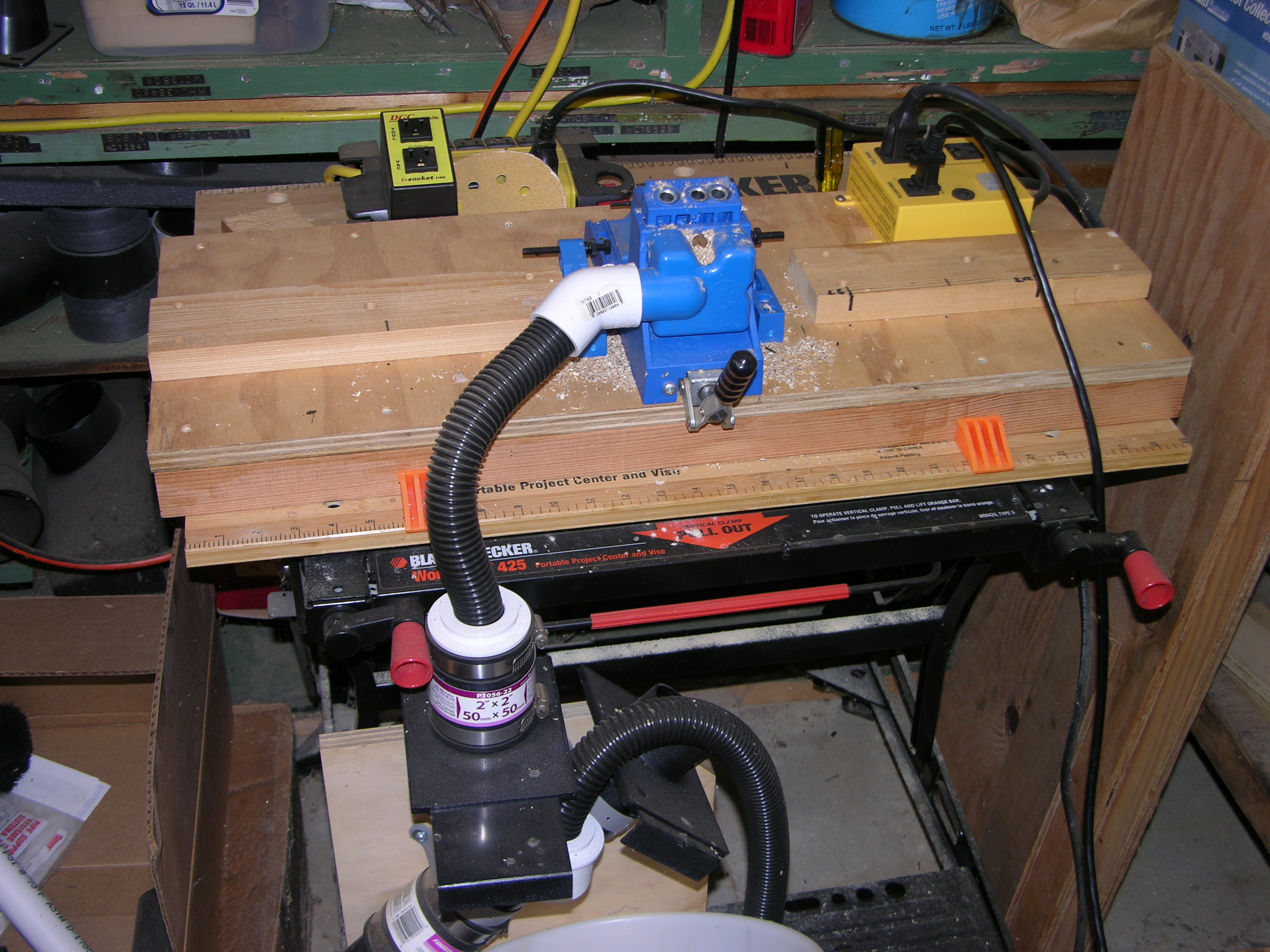

Anybody who's ever used pocket holes KNOWS how important alignment is; when you tighten those screws, they pull the joint tight - and if the cut isn't exactly 90 degrees, then neither is that joint - DSCN3388.JPG
Another reason for that high-dollar miter gauge - multiple stops and a sliding extension lets me repeat crosscuts up to about 3 feet long, exactly the same - DSCN3389.JPG which means I can actually expect things like this to end up SQUARE - DSCN3390.JPG DSCN3391.JPG
I got all the pocket holes drilled in that frame before I came up for dinner, it's gettin' a bit cooler so I'll probably go back down to the shop and do the ones for the smaller frame - hopefully I can get 'em put together in the morning BEFORE it gets too hot again. Then once THAT's done I'll need to scribe both of 'em to the corrugations on the wall, and finally add some "spider legs" that'll keep them from falling out of the hole once it's cut with the plasma... Steve

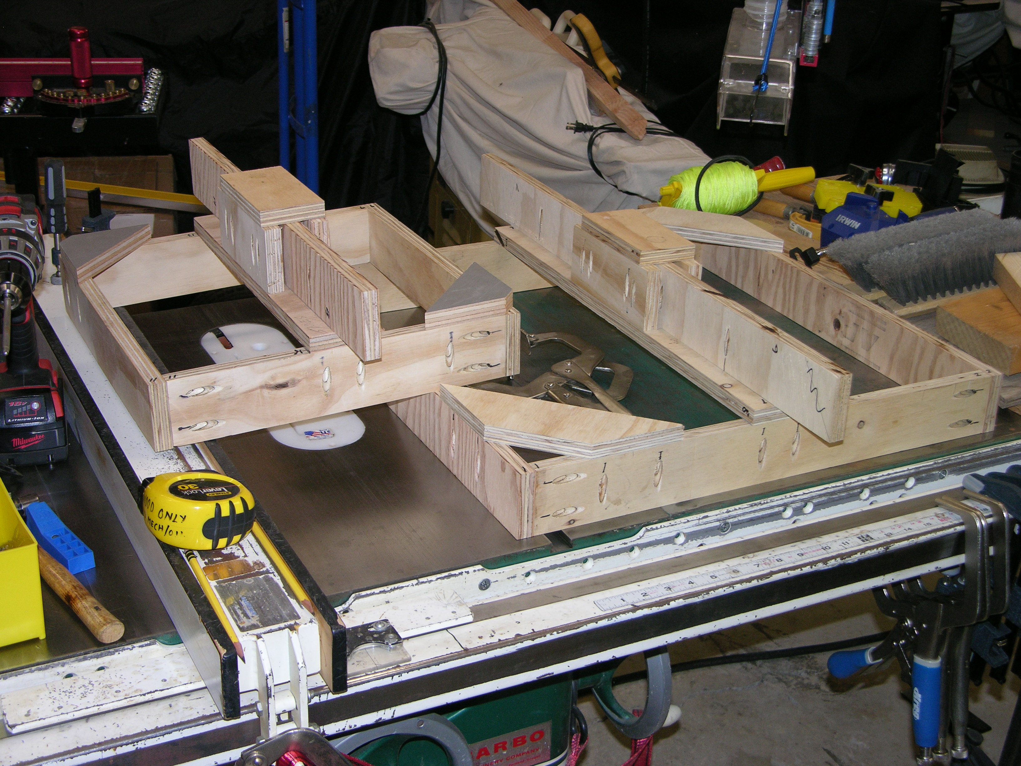

Got some more done in the wood shop before common sense took over :rolleyes:

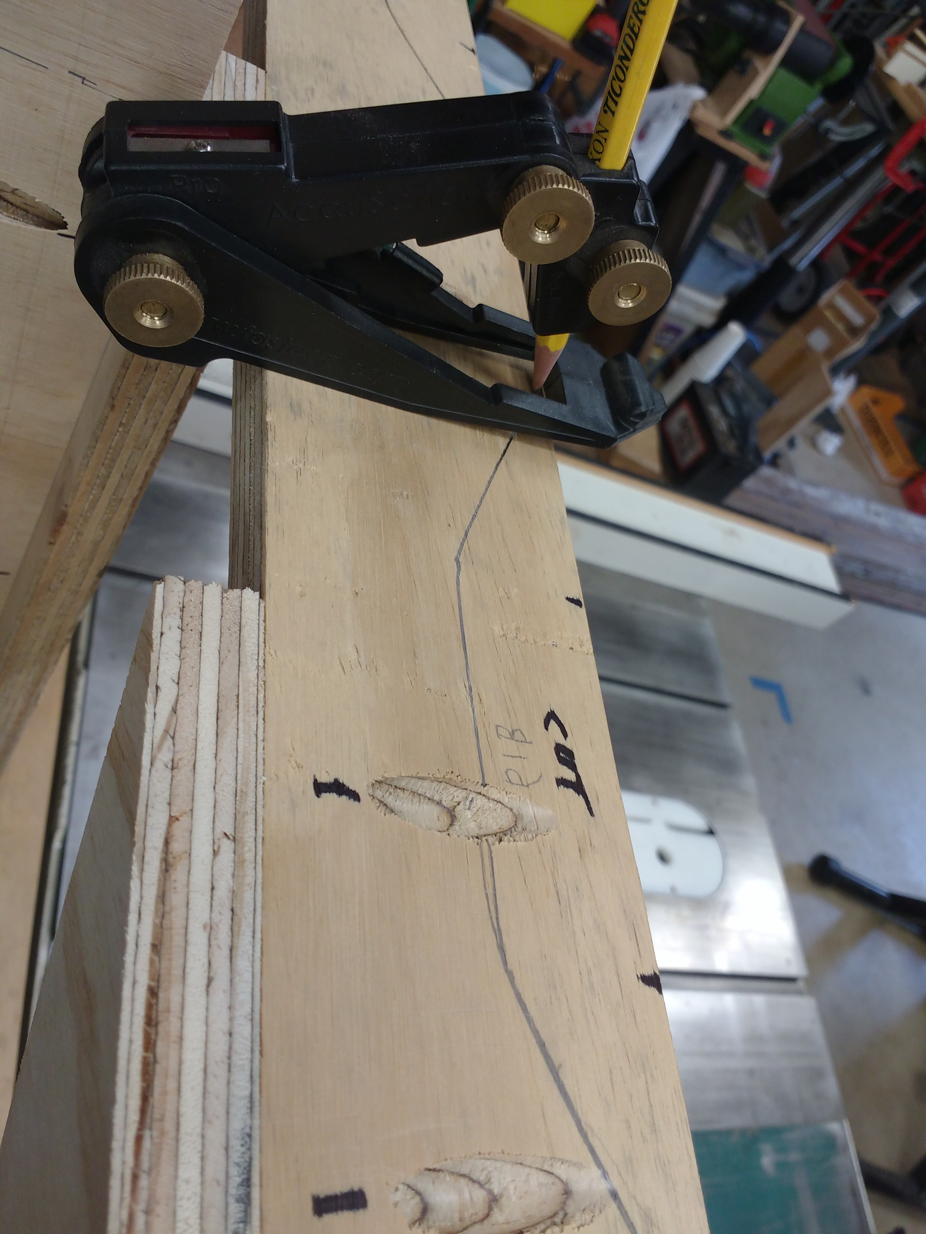

Still on the plasma templates for ventilation stuff; I had used a piece of scrap plywood held up against the side of the little 20 foot container and marked off where the ribs and valleys of the siding came, initially just to verify that all 5 of the containers used the same spacing so I'd only need to build one template of each size -
Next I used that same piece of ply to figure out the best way to "scribe" the edge so it would conform to the sides - otherwise, I was concerned that the plasma torch would find a way to get UNDER the template where it was about 1-1/4" away from the steel (think "Murphy's Law") so I played around with the plywood and a cabinet scribing tool I already had; found out if I left the end pin off the tool and "jackknifed" the pencil, it would touch down in a valley with the pencil right at the same height as the peak (this is a GOOD thing :D)
IMG_20180808_142055580.jpg IMG_20180808_141937192.jpg IMG_20180808_135358875.jpg
If any of this isn't clear, don't hesitate to ask - I sometimes forget just how far outside the box my thought processes can get (WHAT box??!? :laughing:) - gotta go "spray some gray" (paint, that is) - as hot as it is, it'll probly dry BEFORE it gets to my "mil spec lego blocks" :rolleyes: ...Steve

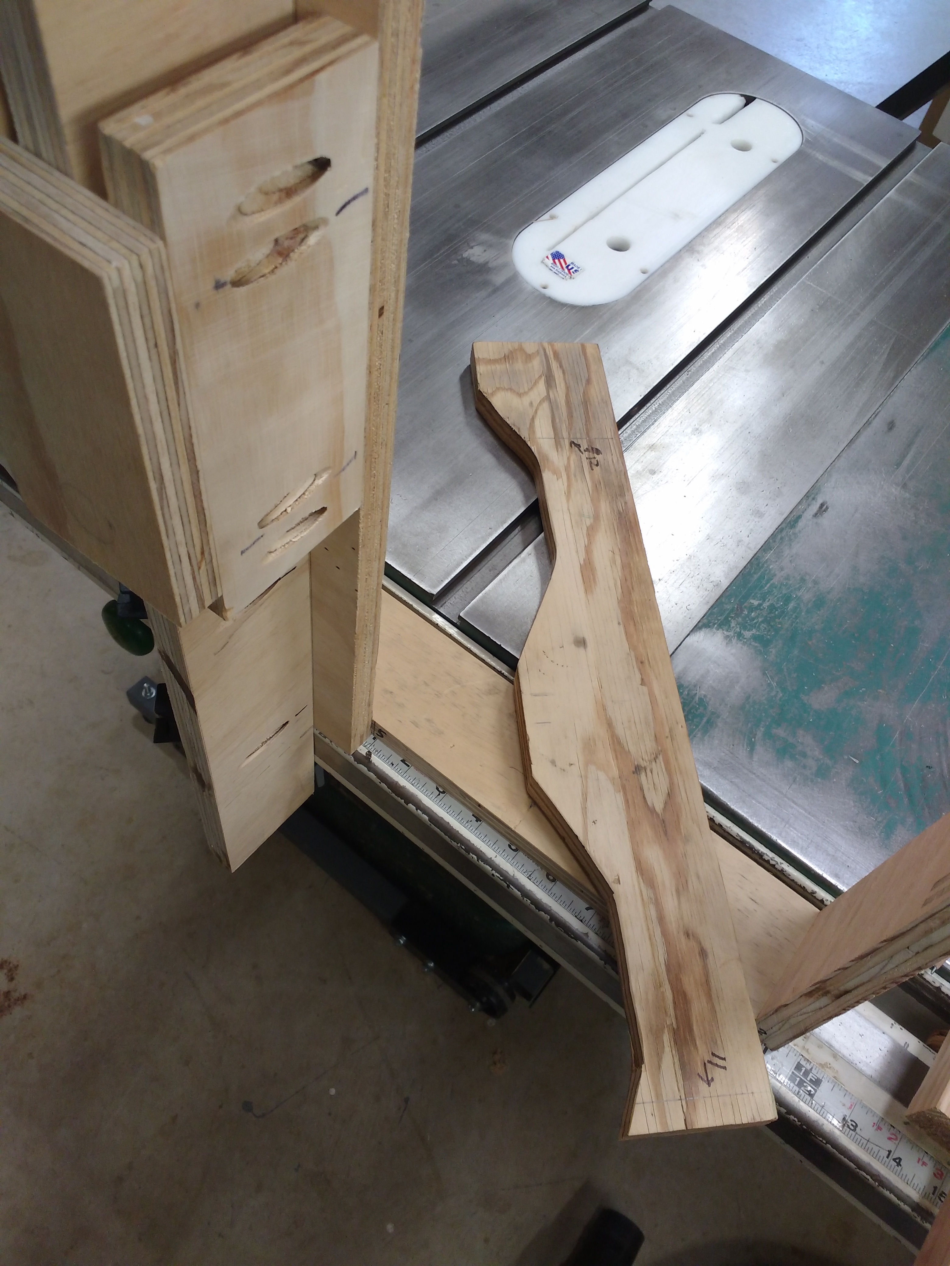

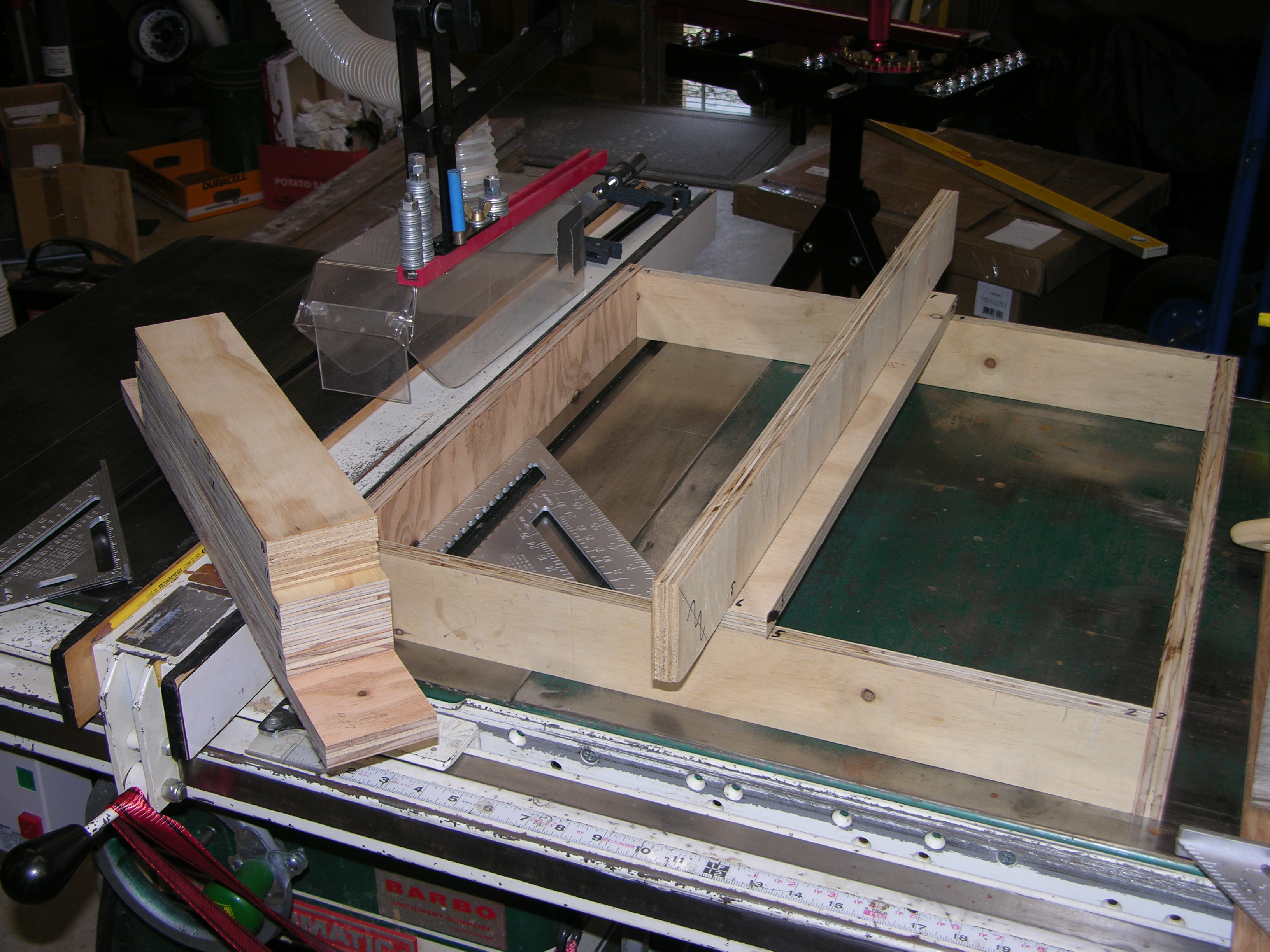

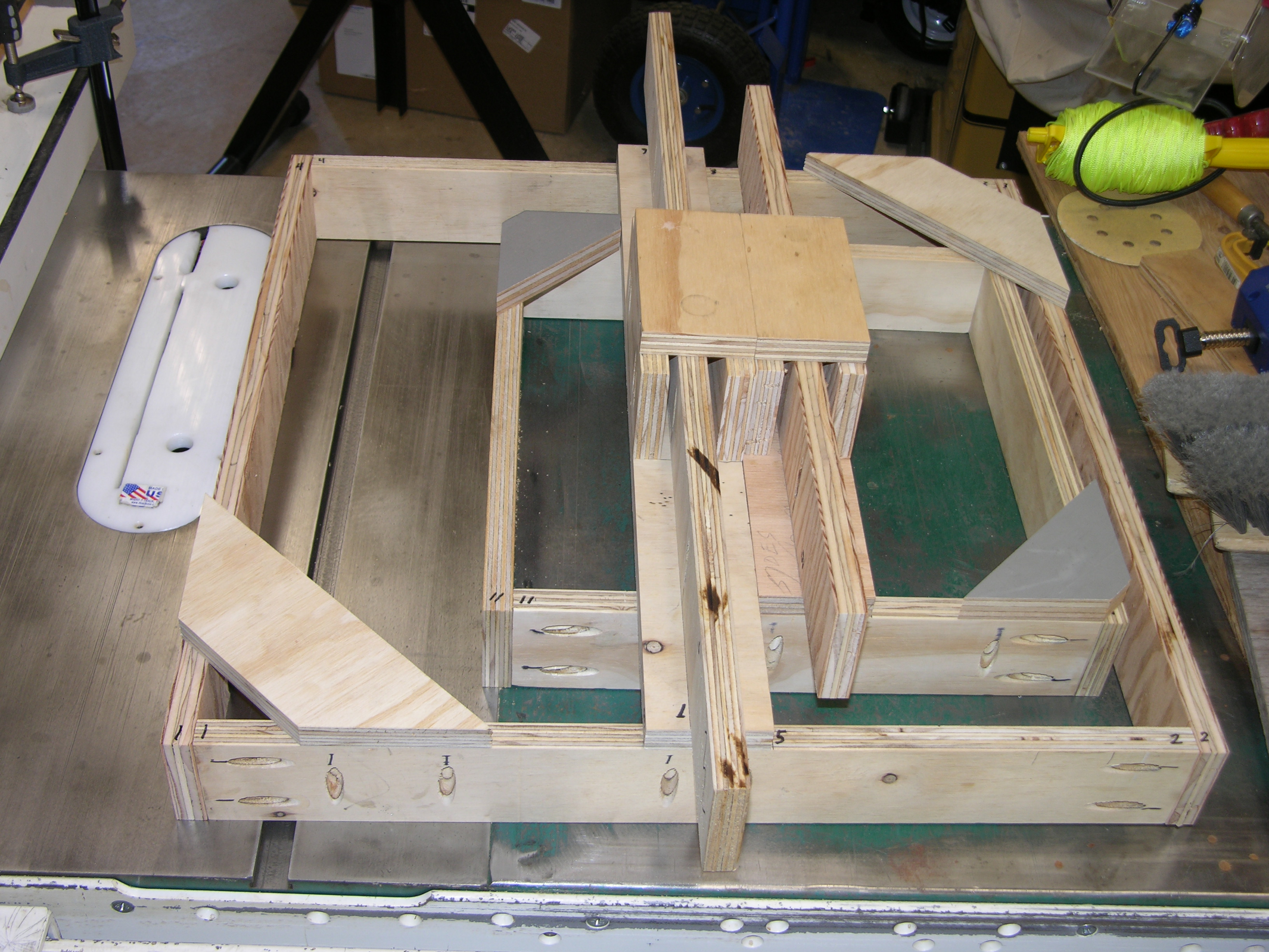

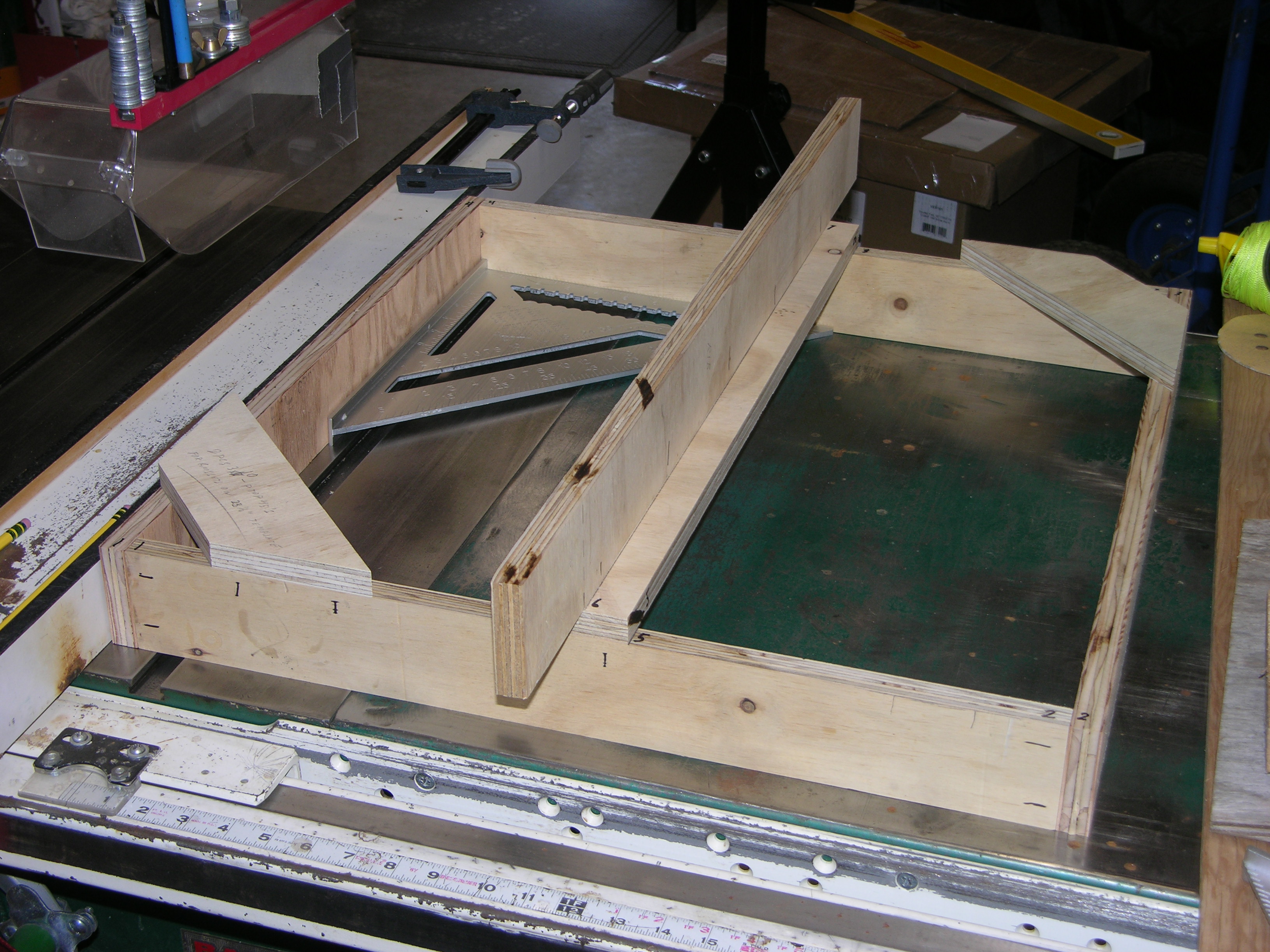

If you look at the last pic in my previous post, you'll notice a pocket screw hole in an area that will get cut AWAY in order to fit the template to the side of a container :confused: - these templates are NOT glued, only pocket screwed, which made me kinda nervous about the guide SHIFTING while in use :thumbdown:
This is ONLY a problem for the smaller of the two templates; the 24" one will have the two side rails AND the center "pusher" area still at FULL DEPTH, so no loss of strength on THAT one.
My solution - break out the glue, make some EXACTLY 90* inner cleats, make some EXTERIOR 90* clamping blocks, glue 'em in (with a few more screws for good measure :laughing:) - the pics -
IMG_20180809_122944870_HDR.jpg IMG_20180809_123006898.jpg IMG_20180809_123355077_HDR.jpg IMG_20180809_124040226.jpg IMG_20180809_124941447_HDR.jpg
The explanations -

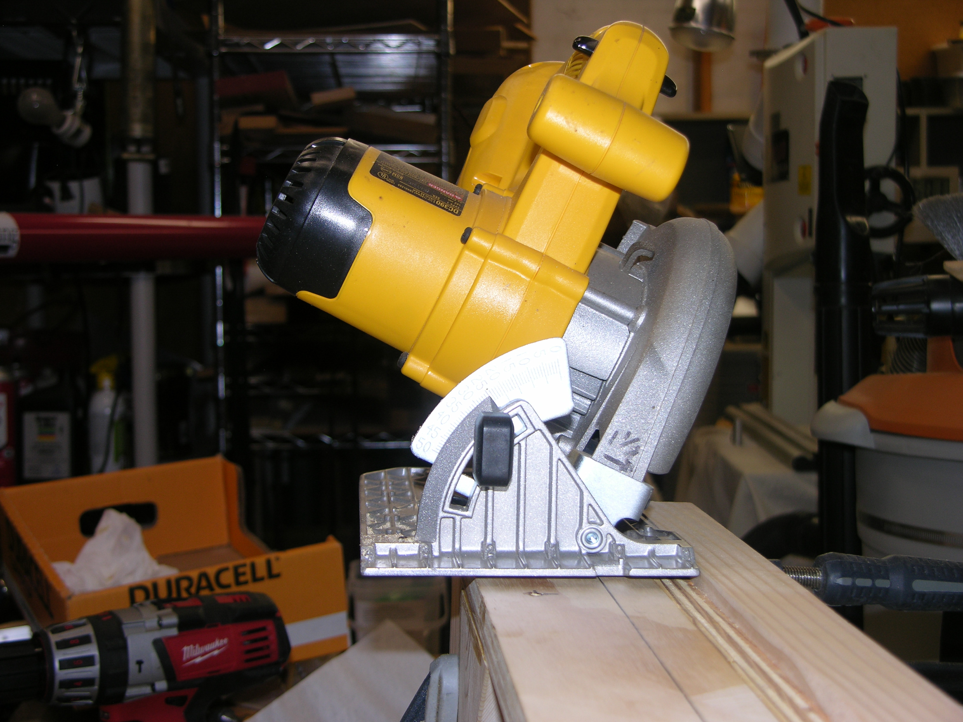

pic 1; I'm using a couple of the features of the 12" DeWalt, Makita and Bosch saws (maybe others) - one is the bevel, I hadn't needed that before. The other is the depth stop - this allows you to slide the saw but keep the blade at an adjustable height OFF the table, so you can do things like quickie dadoes, or (in this case) cut a 90* Vee in a piece of wood to make an outside corner clamping block. Also in that pic is a "bandaid", it's that blue groovy-lookin' thing
Multi Track for Jigs and Custom Fences-Multi Track - Rockler Woodworking Tools
Normally I use those ON EDGE for a longer fence, etc; use 'em on the woodworking drill press, router table(s), miter saw, various jigs - they've gotten more expensive than when I got 'em, think I have 4 or 5 of 'em and some of the track (scroll down on that Rockler page)

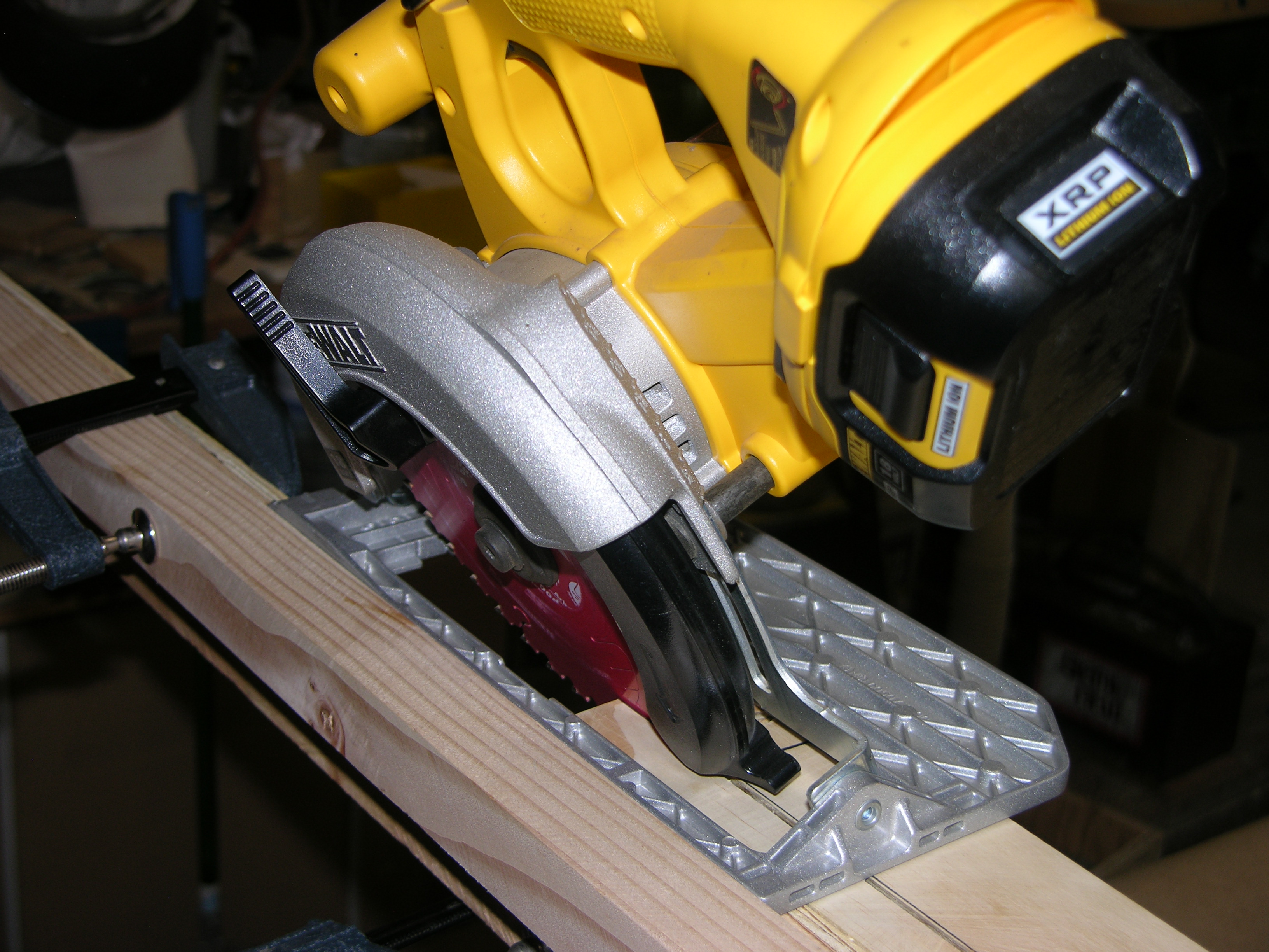

For THIS application, I found out that the DeWalt saw will NOT cut to its preset depth all the way to the fence - so I used the blue things to "shim out" the fence by 3", and it just made it. That way I could preset the blade depth at a 45* angle and cut the Vee out by flipping the board..
Pic 2 - Closer shot, getting ready for the first cut
Pic 3 - REALLY close shot, second cut after flipping the board (easier than swapping to RIGHT side bevel each time)
Pic 4 - One piece of scrap ply was long enough for 3 blocks (woulda been 4 if I'd thought a bit more)
Pic 5 - This is what lets you NOT cut all the way thru when that's what you need - notice the wing nut near the top of the pic, that's the lock for the knurled head screw just below it which sets depth - below that near the bottom of the pic is the stop itself, seen in the STOP position - to disable that, you just swing that stop up and back and it stays out of the way. Bosch and Makita have the same function but it looks a little different, I couldn't find anything about the Milwaukee or new Delta "cruiser" about this.

And what kind of color did you use on the steel blocks, looks like crap, might as well been battleship grey, I had in mine candy apple red with blue stripes for a leveling reverence indicator.

The "fancy" parts are what make it work; the purpose is to accurately transfer the NON-flat profile of anything to a SECOND piece that needs to FOLLOW that profile - IOW, make ONE thing fit the SHAPE of ANOTHER thing - these are typically used to trace the shape of a not-so-straight wall, onto the side of a kitchen cabinet and then CUT OUT that shape on the cabinet side so it MATCHES the wall...
AccuScribe PRO Scribing Tool | Rockler Woodworking and Hardware

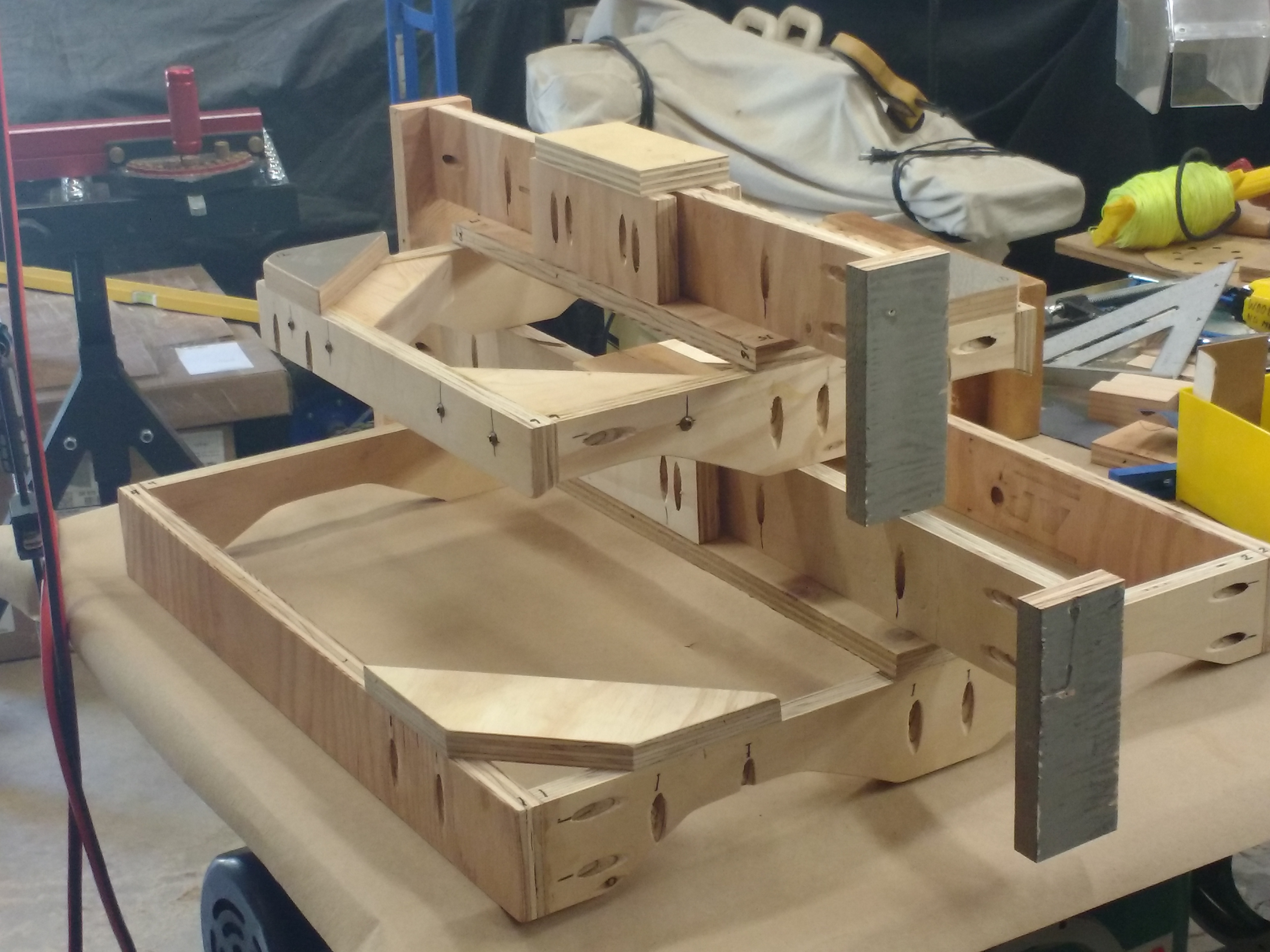

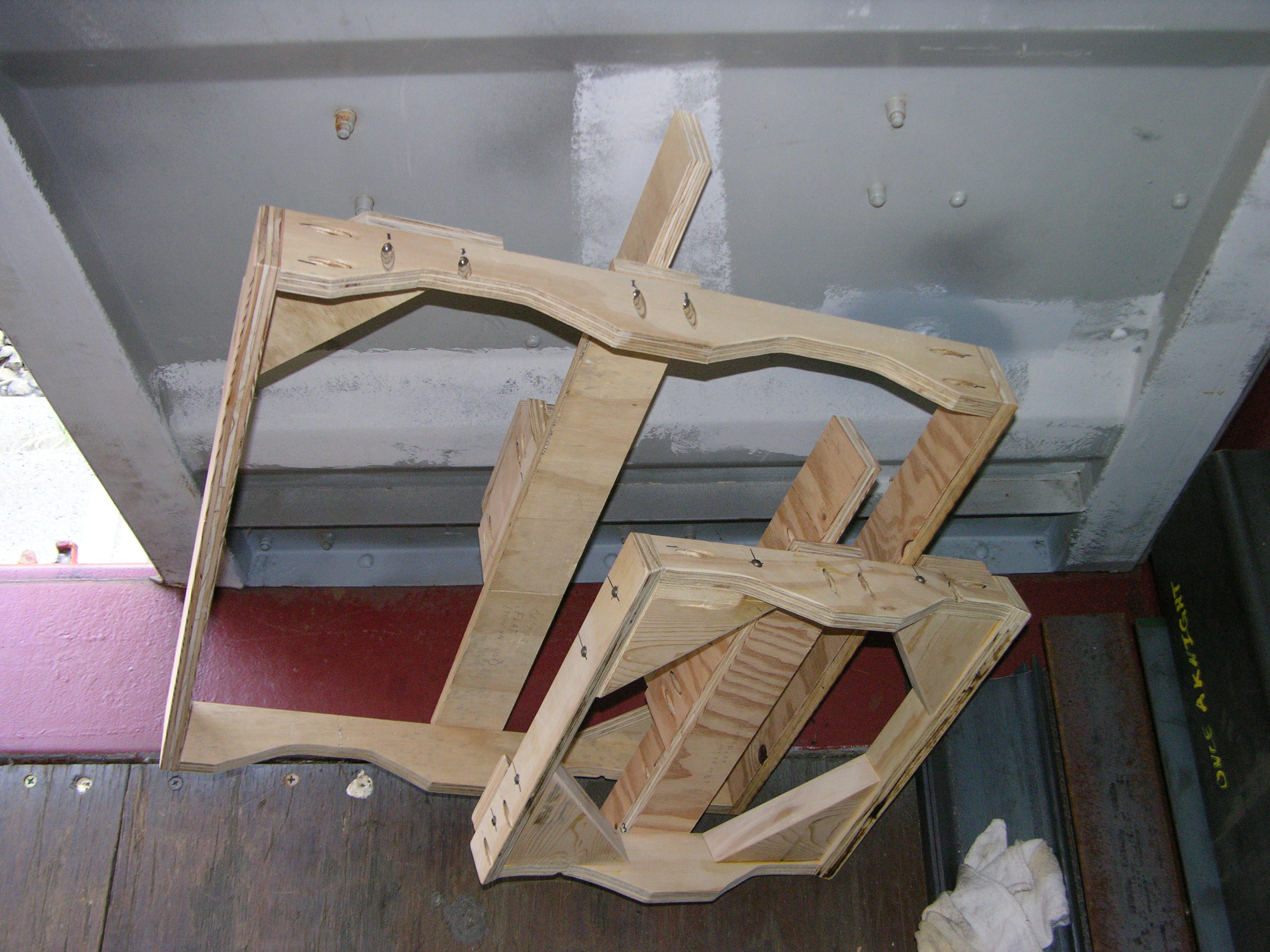

The wood frames I'm making will match the corrugations of the steel walls of the containers, and each frame is 1 inch smaller each dimension than the HOLE I need to cut (a "window") so the plasma torch can ride along the edges of the frame and cut the correct size hole for the fan (16" square) and the louver inlet vent (24" square)
These are NOT going to be PART of the install, only a PATTERN so I don't screw up the container wall. I had thought about just using zip disks, but the thought of cutting 4 feet of 13 gauge cor-ten steel (per hole) by holding a side grinder over my head long enough to do that, from INSIDE a container that tends to be well over 100 degrees inside even on a cloudy day, does NOT appeal to me - I'd rather spend LONGER than that in a cooler place making an accurate template, then cutting that ACCURATE hole in about 5 MINUTES or less with the plasma.
Any actual FRAME installed in the hole (like an outside drip molding for example) will be STEEL, fully welded primed and painted. The end result will be a full exchange of all air in each of the containers once every two minutes, with the exhaust fan pulling out the hottest air from the NON-door end, near the ceiling while "make-up" air is brought in thru the 24" square, motorized louvers near the ground on the door end.
When it's done it'll all be controlled by a thermostat. This should keep the containers reasonably comfortable even in pretty warm days, instead of them reaching 140 degrees at the far end (I've actually MEASURED it that hot)

The gray - I guess beauty's in the eye of the beholder; that color goes well with the sorta brick red-brown of the containers, and the BOSS likes it :laughing:

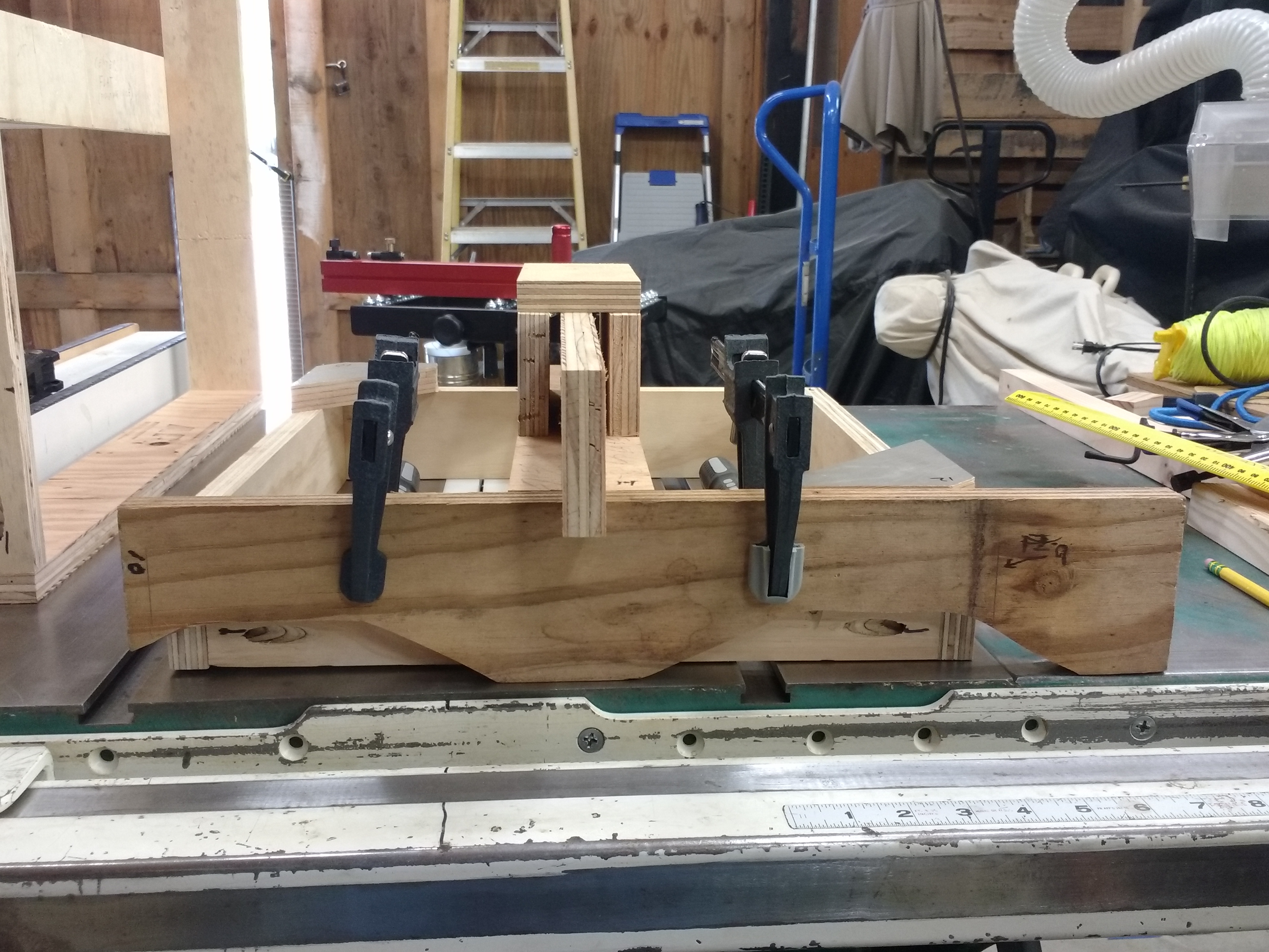

As usual, the weather man LIED - it was 93 in the shop when I quit, woulda gave up sooner if it wasn't for a healthy dose of bull-headedness and a 30" pedestal fan on high, aimed right at my head :laughing:
Here's the results of my stubbornness; these pics should help clarify what I tried to explain in the previous post - if not, I'll explain later when I'm not drug backward thru a knothole :thumbdown: ...Steve
OK, fine; the SHORT version - imagine one of these
Amazon.com: Stoneman Sports QSP-36 Sparehand Steel Adjustable Cargo Bar for Trucks Vans and SUVs, Red Finish: Sports & Outdoors
in place of my hand in the bottom pics - then picture a plasma torch being drug around the outside of the wood frame til a piece of the wall falls out (this will be done from the INSIDE) -
Now, if that happens BEFORE I do one final step, the template would fall out along with the piece of corrugated wall - NOT good, so there will be 2 more "spider legs" screwed to the protruding ends of those long boards across the center of each template; those will ALSO touch the wall - that way, when the cut is finished those "spider legs" will hold the template where it is, and only the cut out piece will fall (I hope) :D

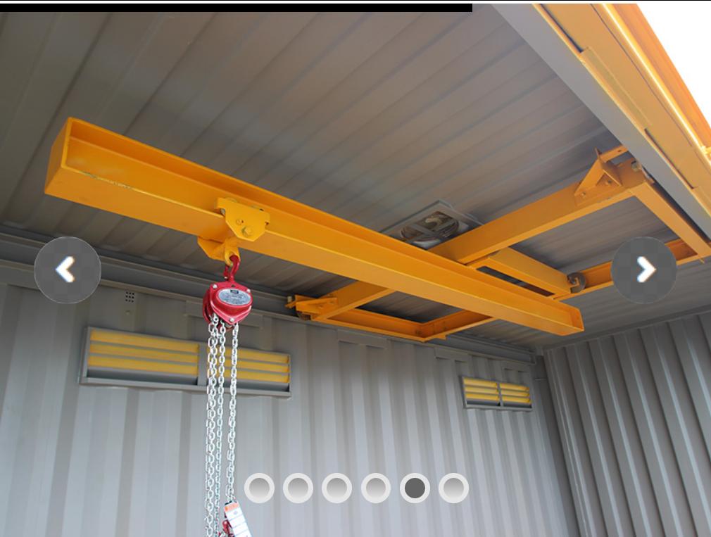

Got my hair whacked this morning, then found this pic
On this site
Dangerous Goods Container with Gantry System
I'd been thinking of a way to extend the container crane OUTSIDE the box a bit to make it easier to transfer things in/out of the container, looks like a few mods to my design could pull this off. Good thing I'm nowhere near actually BUILDING the thing yet :laughing: ... Steve
