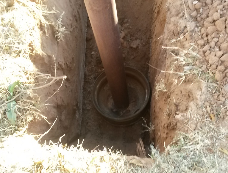

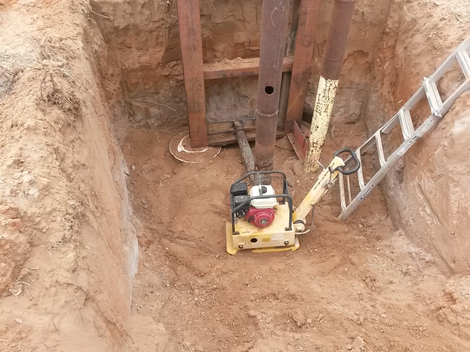

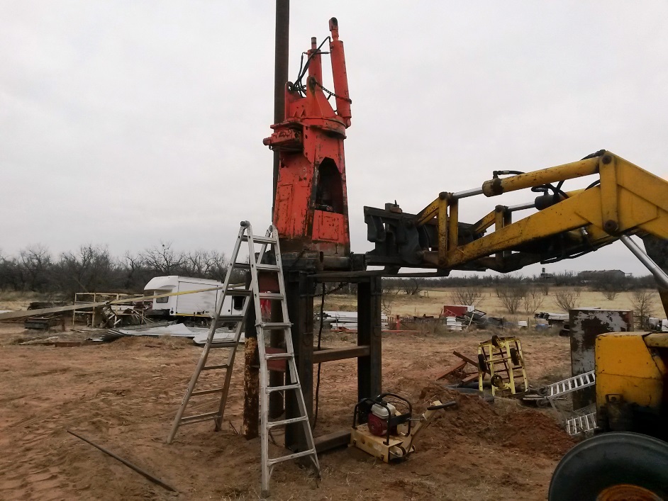

first I planted 10 steel trees as my neighbor calls them because I gave them roots and planted them as much as 8 feet in the ground to get down to a hard sub layer of blue or whiteish yellow clay
This is the roots for the corner post on the S/W corner it had such a frame work because there will be a crane mounted on it later
Not using concrete to set them in but I used several bags or Portland in each layer as I back filled the hole adding just a little water as well
Each 6 to 8" layer was compacted with my plate packer
Trust me these columns are not going anywhere especially this one
setting the pedestal base for the crane

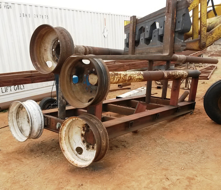

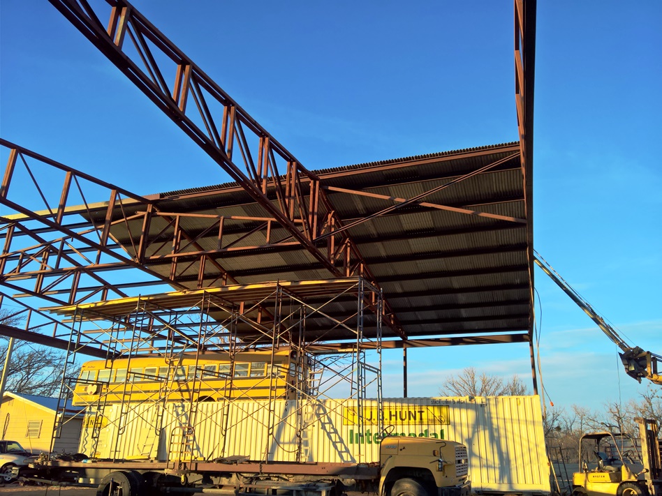

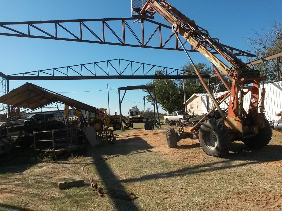

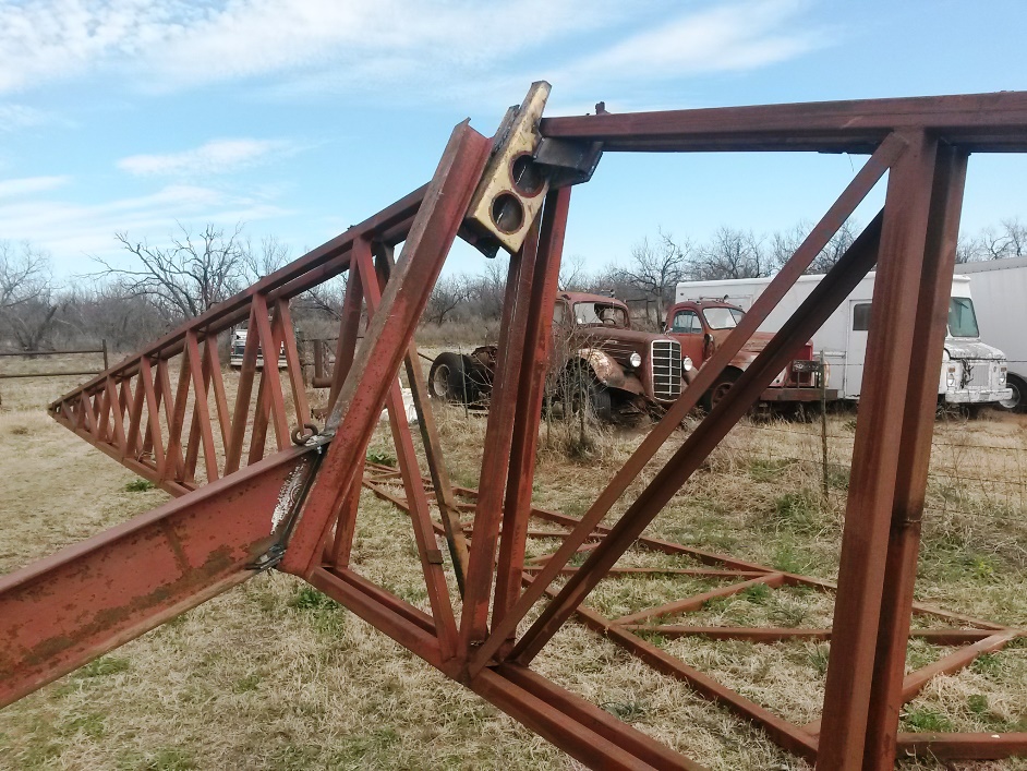

I had 11 trusses from an old building that I tore down many of them were damaged because the building collapsed from a heavy snow fall 10 years ago so I doubled them and I repaired them then modified my fork extension boom to handle them
A friend showed up with a skytrack to help set the trusses

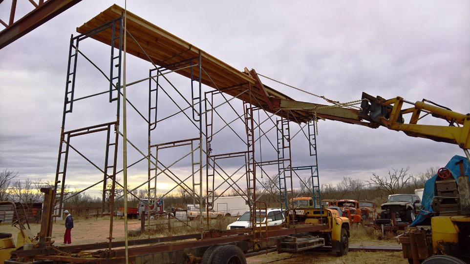

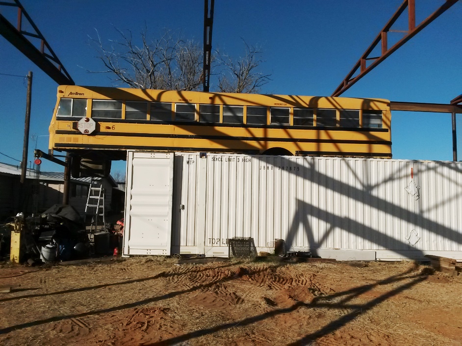

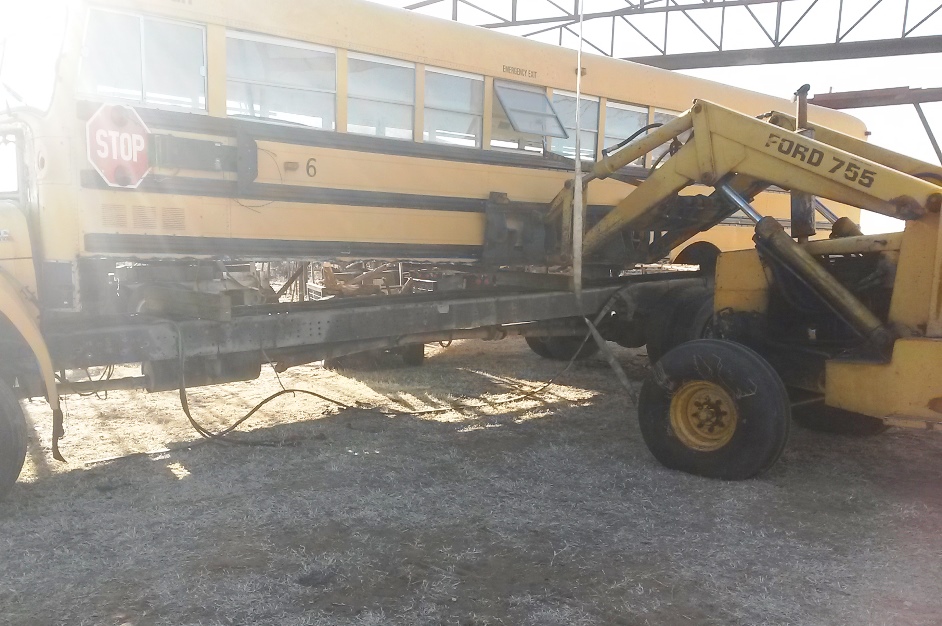

Later I stripped the body off of a school bus the bus body will become an office or storage
I used the chassis to make a rolling scaffold platform
I used the forks on the backhoe to raise the school bus to the top of my container
Placing the platform on the rolling scaffold

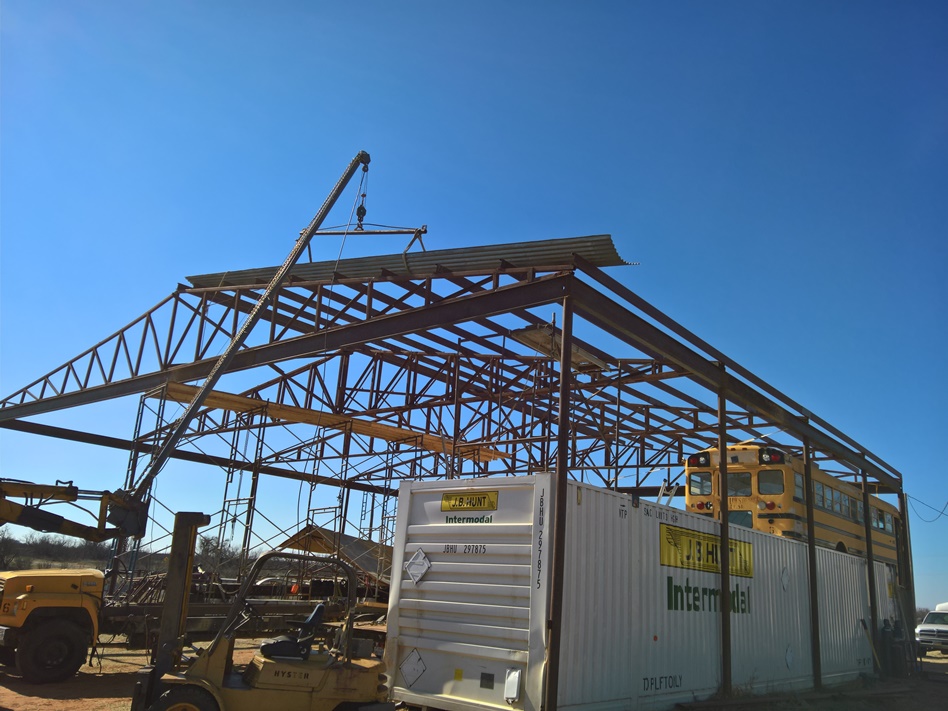

I built a Gin pole rig with a hoist and snach blocks to fly the purlin

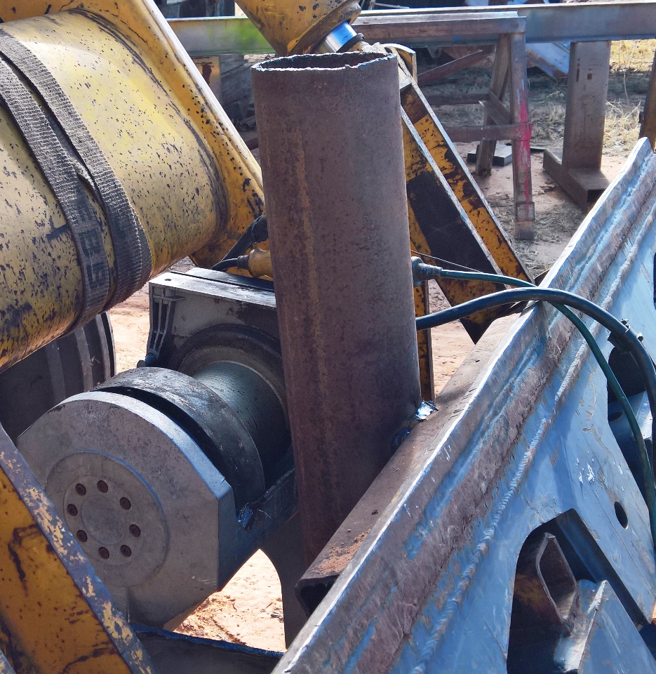

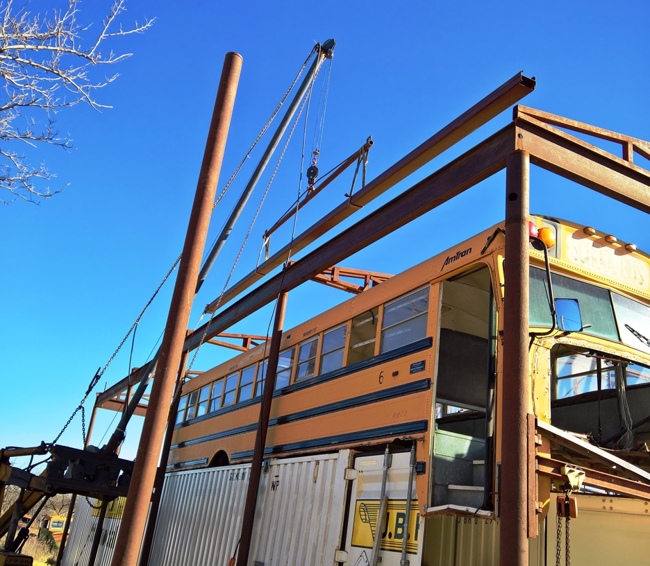

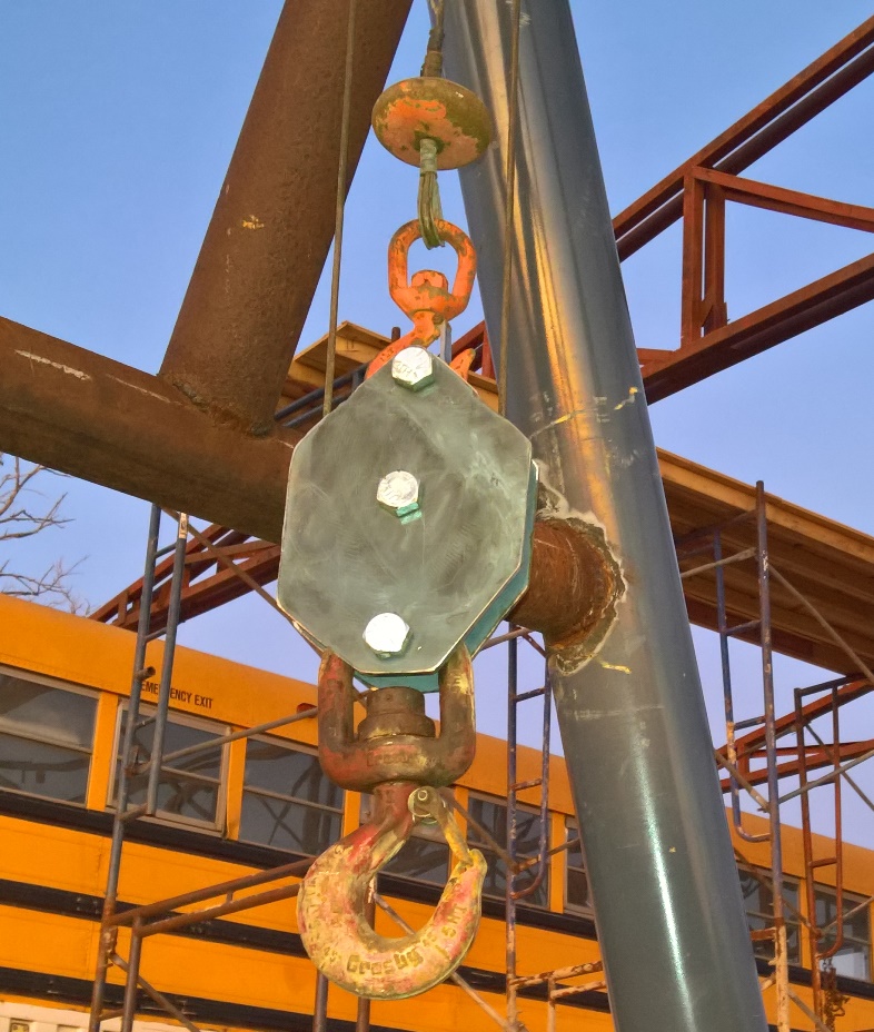

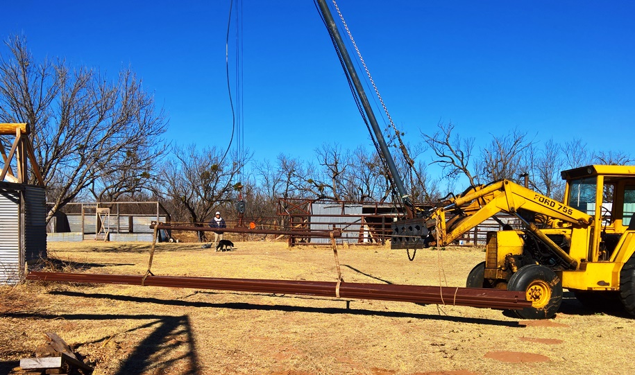

I built a gin pole rig with a hoist and snatch blocks to fly the purlin
the pole mount is welded to the back of the fork carriage and not in the way of using my forks
the hoist pins on and can be removed when no longer needed
the pole is 4 1/2" pipe with a 1/2" wall thickness 26 feet long
the hoist is a roofing hoist with 4 to 500 lb rated cap electric brake to hold 1500 lbs on the cable at the drum
the cable hook is 1 1/2 ton the hook on the 6" snatch block I made is 5 ton
10 30 ft long 6" purlin on the hook
Half of the purlin on one side now in place

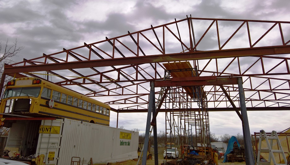

It takes a while to build something this size by yourself the only help I had was 2 days hanging the 12" I beam top plate frame and setting 4 of the 5 trusses the rest has been completely by myself with my wife watching for fire or if I happened to get hurt she could call a neighbor to come assist her in getting me down or in the house or to drive me to town.

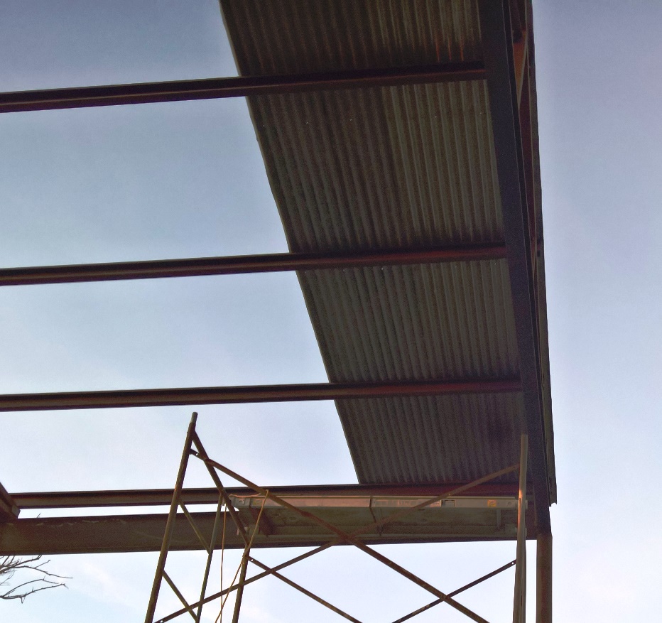

Coming along slowly on the 11th of Jan. I managed to get the first sheet of metal up on the roof
then got the second one up on the 14th
Getting the first one laid meant having to work from scaffold on both ends the second was a little better because by then there was a way to walk up and down
yesterday was the first day I was able to get the winds to cooperate so I could fly a small bundle up making the count of sheets on the roof at 9 then flew up another load and finished out the day with a total of 15 sheets. Dragging and positioning 36 foot long 3 foot wide sheets by one's self makes for a lot of walking and dragging as they are somewhere between 80 & 100 lbs each and the area of each is half the area of a parachute or as much area as a competition sky divers chute so even a nearly calm wind of around 10 MPH is more than 1 person should be trying to struggle against
But at least there is over 1440 sq feet of coverage up there now

Have a couple good days in on the building of course there are always a dozen other chores to do everyday to limit ones work on a project such as this.
but yesterday and the day before I managed to move lift stage move lift weld and move the bus scaffold again
today turned out to be another of those climb up climb down walk back and forth run the back hoe Armstrong the steering of the bus scaffold climb up over and over
I'm thinking I would get less of a work out in a Gould's GYM with a retired Drill sergeant as a trainer Almost any cardiologist will tell you that once you reach a certain age you absolutely need to walk a mile or 2 every day and climb several flights of stairs. But none of them have ever thought about doing this while clambering over steel trusses 20 odd feet in the air while pushing or dragging 3 to 6 80 lb purlin in place My cardiologist would have heart failure just thinking about it.
All purlin are on top of the building now
7 are welded in on 1 section and 3 welded in on the other section so I guess all in all I managed to get 5 welded in place today at times the wind did get bad enough to make me head for the ground but it mostly cooperated

That bus scaffolding is pure genius!!!
