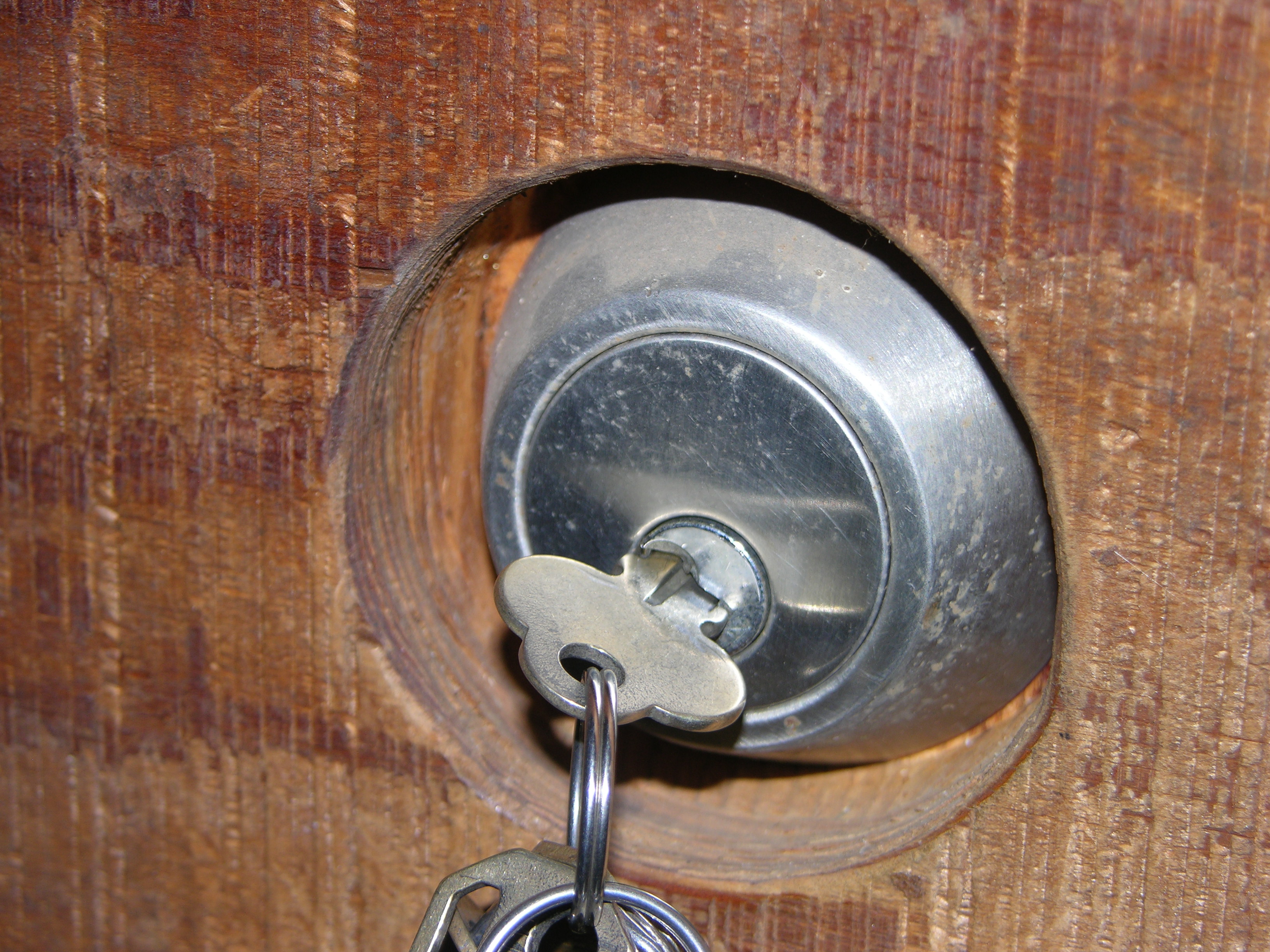

Locks - you did better'n me; only found one schlage "kit" to extend one of their keypad type locks to 4"...
I built a similar door for my recording studio years ago, 2x4 frame, 5/8 rough-sawn siding on outside and 3/4" MDF on the inside (mostly for sound deadening) - the 48" wide door was pretty heavy, so I used 4 LARGE barn door hinges. Door was hinged on one of the 6x6's (studio is the rest of my wood shop, which was converted from a pole barn) - on the hinge side I ran 5/8"x6" lag bolts into the hinge post every foot til 1-1/2" stuck out, then cut the heads off, used a plunge router and cut pockets into the door frame for each headless bolt - so when the door is shut, it's like a bank vault - go ahead and take the hinges off if you can - ain't gonna help, and by then me and my "12-barrel double gauge" will probly be there to "help" ya ...
On the latch side I used a regular lock set and a 1" deadbolt - in the wall frame I put blocking at the lock level, for 3 studs each side of the door to resist spreading enough to defeat the deadbolt.
To get around the extra thickness, I used a big forstner bit and countersunk both the deadbolt and the regular lockset - don't remember what the effective thickness ended up, but I really like having them recessed, seems like it'd slow somebody down a bit...
I'm all locked up for the night, but I'll see if I can shoot a couple pics manana - dunno how much it'll help, looks like almost everything now is dang key pads.

As promised, only ONE day late :D - explanations in previous post - gotta go stack a cord of firewood, might rain in a couple hours... Steve
BTW, that 48" door still fits perfectly, no sag at all after about 24 years :thumbsup:

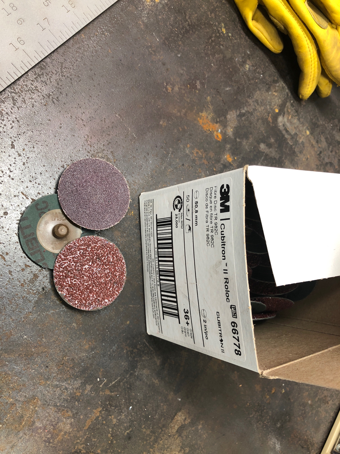

My cutting straight job on steel is still hard and hot on my hands and pants, I needed to cut around 2' long but could only get about 12'' before I had to stop and regroup. Making wood stove brick holders to hold 1-1/4" thick, the angle bar was 3/8"x2"x3" if you do the math you'll come to the conclusion of a mathematical error which cost me time and money, least I found out how to make fire brick holders the wrong way.............

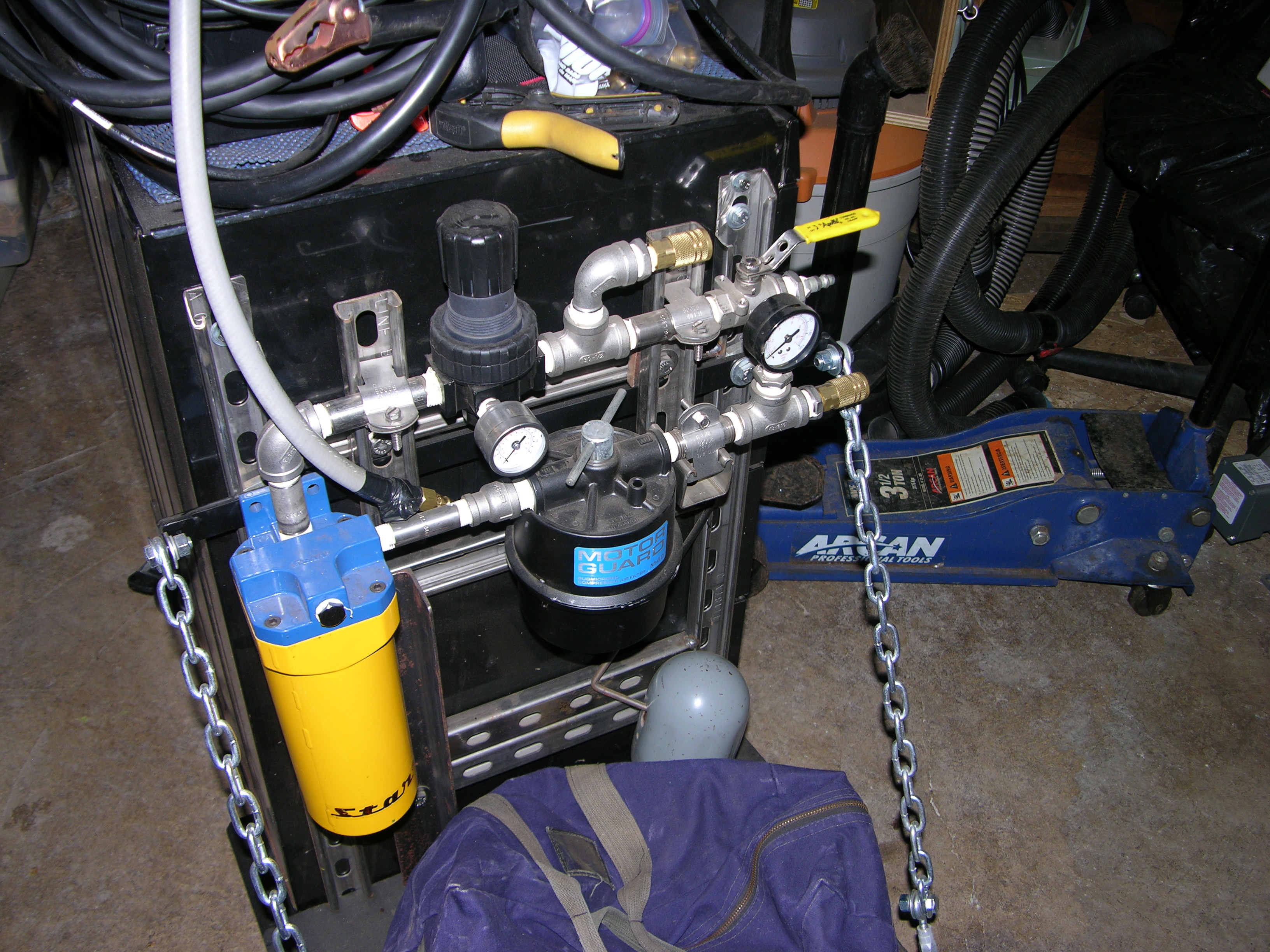

Compressing makes air HOT - (otherwise diesel engines wouldn't work :laughing:)
Hot air holds a LOT more moisture than cold air, so -
All that moisture laden air gets past your tank and into the lines,'specially during heavy use -
The further the wet air gets from the compressor, the cooler it gets -
Cool air has a "lower dewpoint", so now the air can't hold as much water, so -
The cooler water drops out into the hose on the way to your tools, so -
Continuing to use the tools causes that fast-moving air to CARRY (NOT absorb) the water in the hoses along with the air...
A filter HELPS some, but the only SURE way is to COOL the air BEFORE you use it - things like inter-coolers and AFTER-coolers actually WORK, but ain't cheap or easy fixes -
Til I get a few dozen more alligators clubbed, I'm in the same boat - right now my DevAire 5 horse 80 gal. has a built-in intercooler, an electric tank drain set to run 20 seconds every 20 minutes,
Electronic Automatic Tank Drain for Air Compressors - Air Compressor Accessories - Amazon.com
and one of these on the main output
Astro 2618 Air Control Unit, 12cfm Capacity - Air Compressor Accessories - Amazon.com
There's another one of those, along with one of these
Motor Guard M-1-KIT 1/2 NPT Clean Air Filter Kit - Air Compressor Accessories - Amazon.com
On my plasma cart -
Along with an onboard regulator to drop the compressor's 170# output down to 100 so the plasma doesn't get too excited :rolleyes:
And MOST of that stuff probably wouldn't be NECESSARY, if I finally got that "round tuit" goin' and did a proper after-cooler setup :rolleyes: - but at least, I don't hafta worry about remembering to empty the compressor tank, and the autodrain only adds about an hour per day of run time (which in my normal day is small taters :=) ... Steve

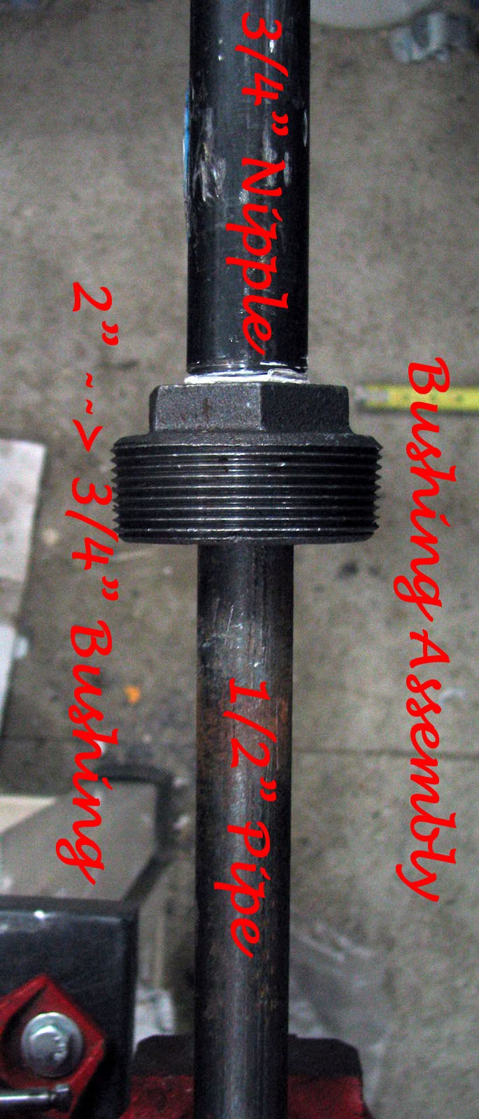

The previous link on "franzinator" has some good info, but could possibly be a little clearer - I tried to re-do some of the pics and add some comments last night, but my internet was down all day til several hours after bedtime; it's back up now, so here goes...
One of the confusions was ORIENTATION in the pics - I've changed them so ALL are shown as they should be when the unit is FINISHED and MOUNTED - in other words, everything in the edited pics is "right side up" - some of the PINK lettering doesn't show up as well, click to expand the pic may help... Steve
V-2-Pipe Threaded into Nipple_4780.jpg V-3-Bushing Assembly_4783.jpg V-4-Tee Assembly_4787.jpg V-5b-Top Half with Flow4788.JPG V-6-Drain Setup_4798.jpg V-7-Full Length_4802.jpg
