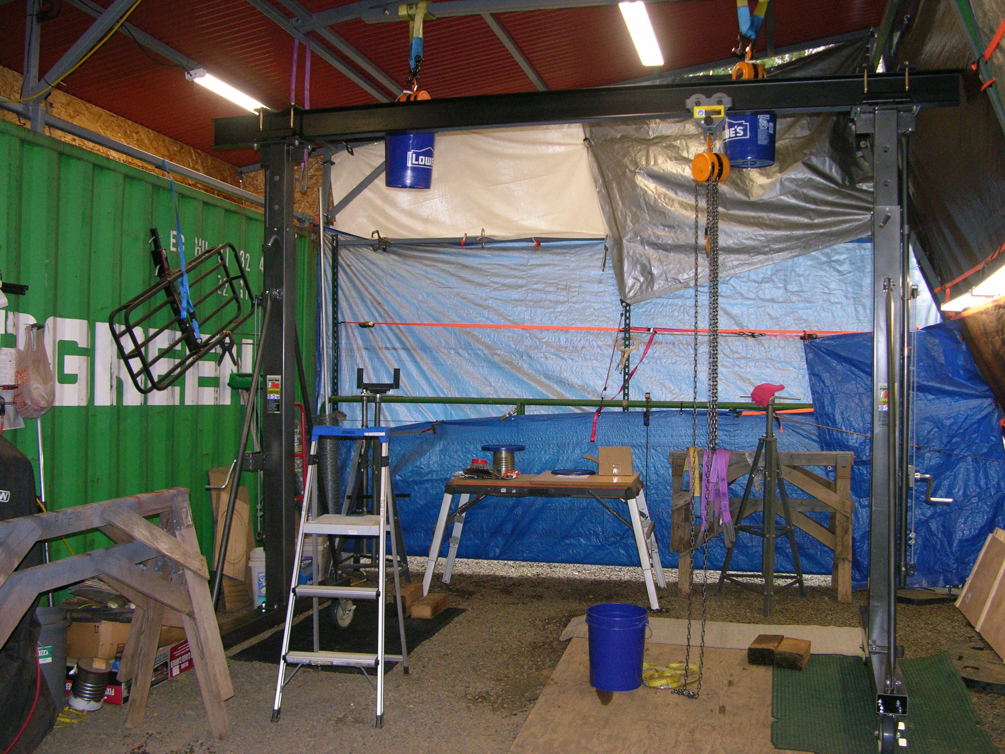

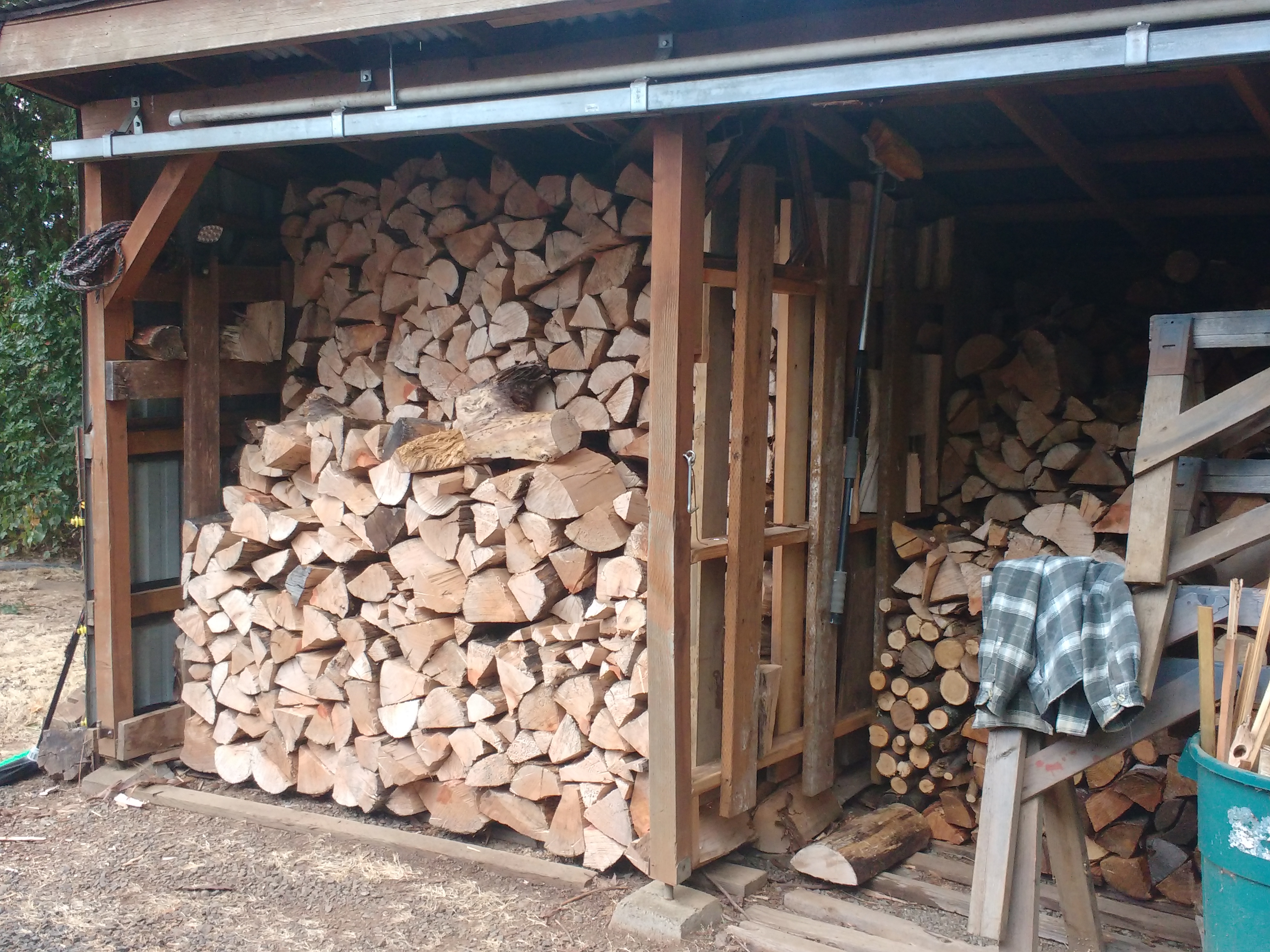

#1 grandson showed up right on time (10am), things looked like this by noon -
View attachment 571100 View attachment 571101...Steve
FIREWOOD............whats the hurry, oh your grandson showed up, send him over my way next month I have to get in 8 cord by myself, my sons didn't help me with a grandson just a grand daughter, ok for KP but not firewood, doubt she'll be much help in my sons shingle mill either tho he's gonna try........

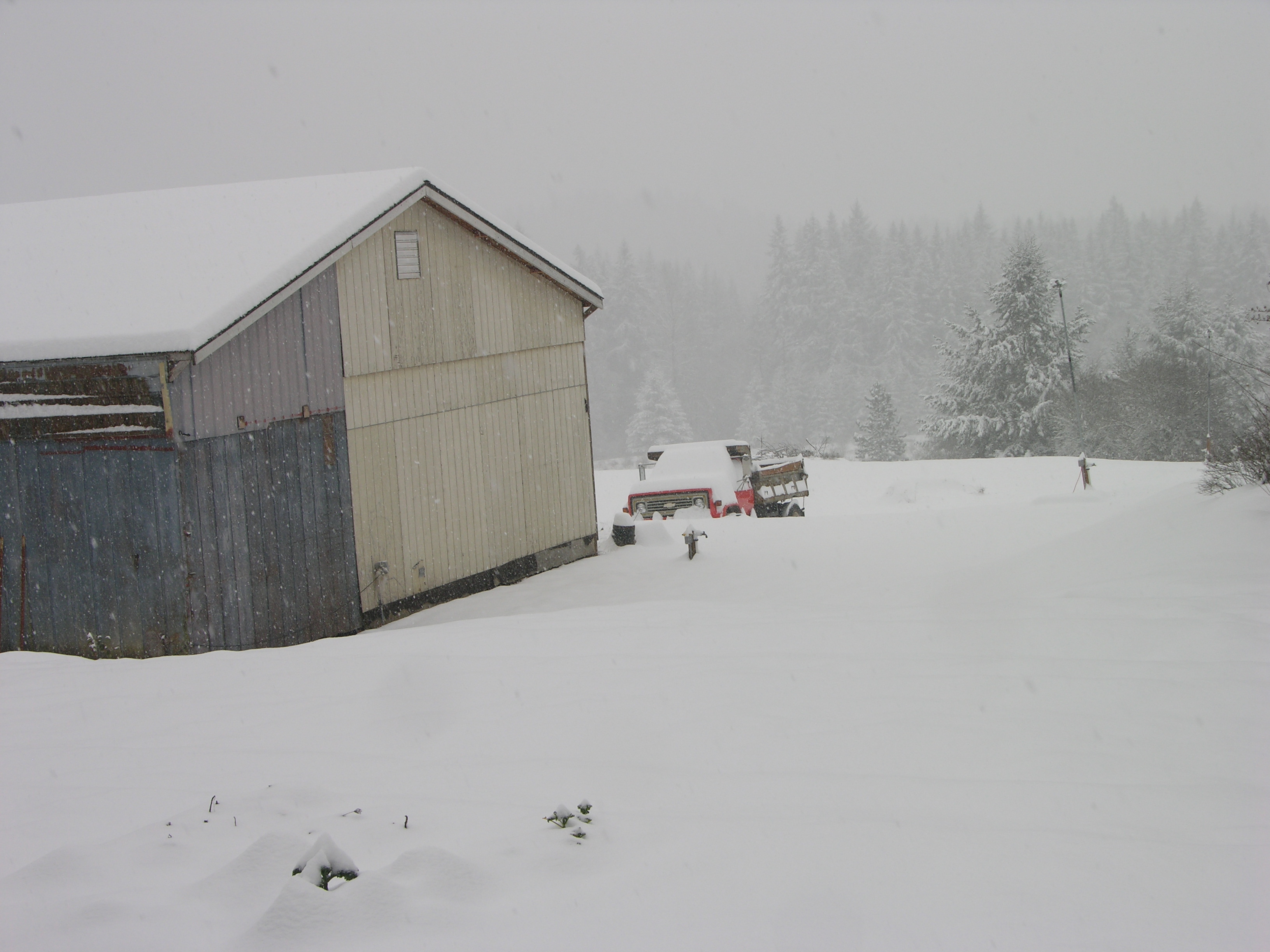

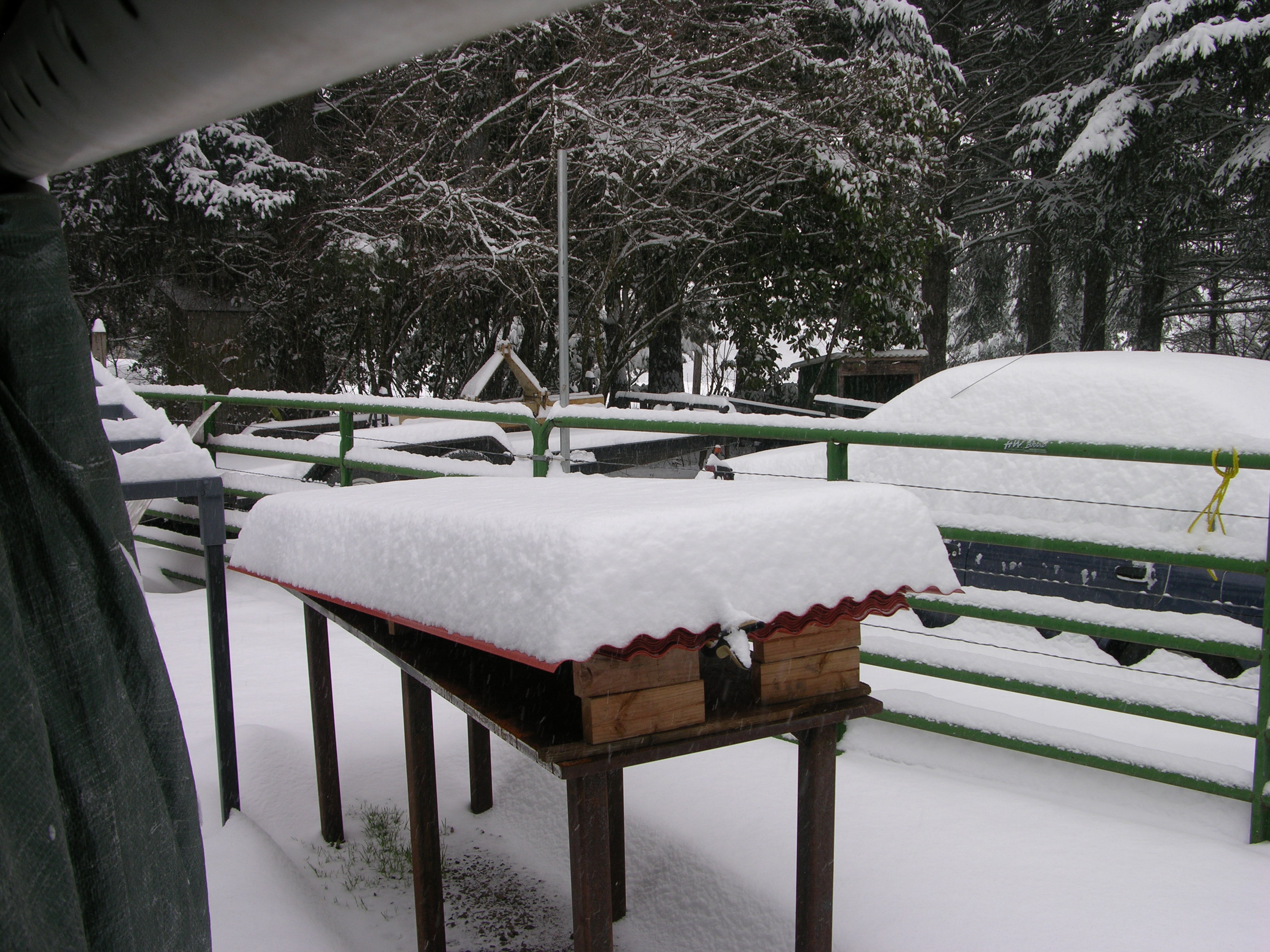

That was 2003; had about TWICE that in '79 right after we moved here, but normally if we get ANY snow it's a couple inches - usually just rain, followed by rain, followed by MORE rain, then rain, followed by rain, followed by MORE rain, ad liquidium...
- upside (I guess) is I'll only need to decide which INDOOR projects come next :rolleyes:
Did I mention I'm usually GLAD our place is on a HILL??!? :D:D:D
Been kinda lazy today; guess I'm not quite in the shape I wuz 30 years ago - odd, just 'cause some of those "lego blocks" weigh over 100 lbs with no obvious way to get outa movin' 'em by hand (er, I mean BACK :confused:) ...Steve
2003???????so that dump truck hasn't been moved in, wait let met do the math, 15 years.......... Guess you dont have much use for a snow plow, one good thing about rain you have no danger forest fires like California, plenty of water to drink, helps the garden grow, helps the Redwood trees grow, helps the grass grow, wow that's more then one thing, isn't you lucky..............If the Lego blocks are to heavy it's not to late to make new ones out of aluminum, just think how much fun that would be, cuts easy welds easy moves easy and the best part it'll gives you something more to do while your resting.............. Old or Old-ish? You know your getting old when you start thinking about the here after, you walk into a room and wonder what the heck your here after...............

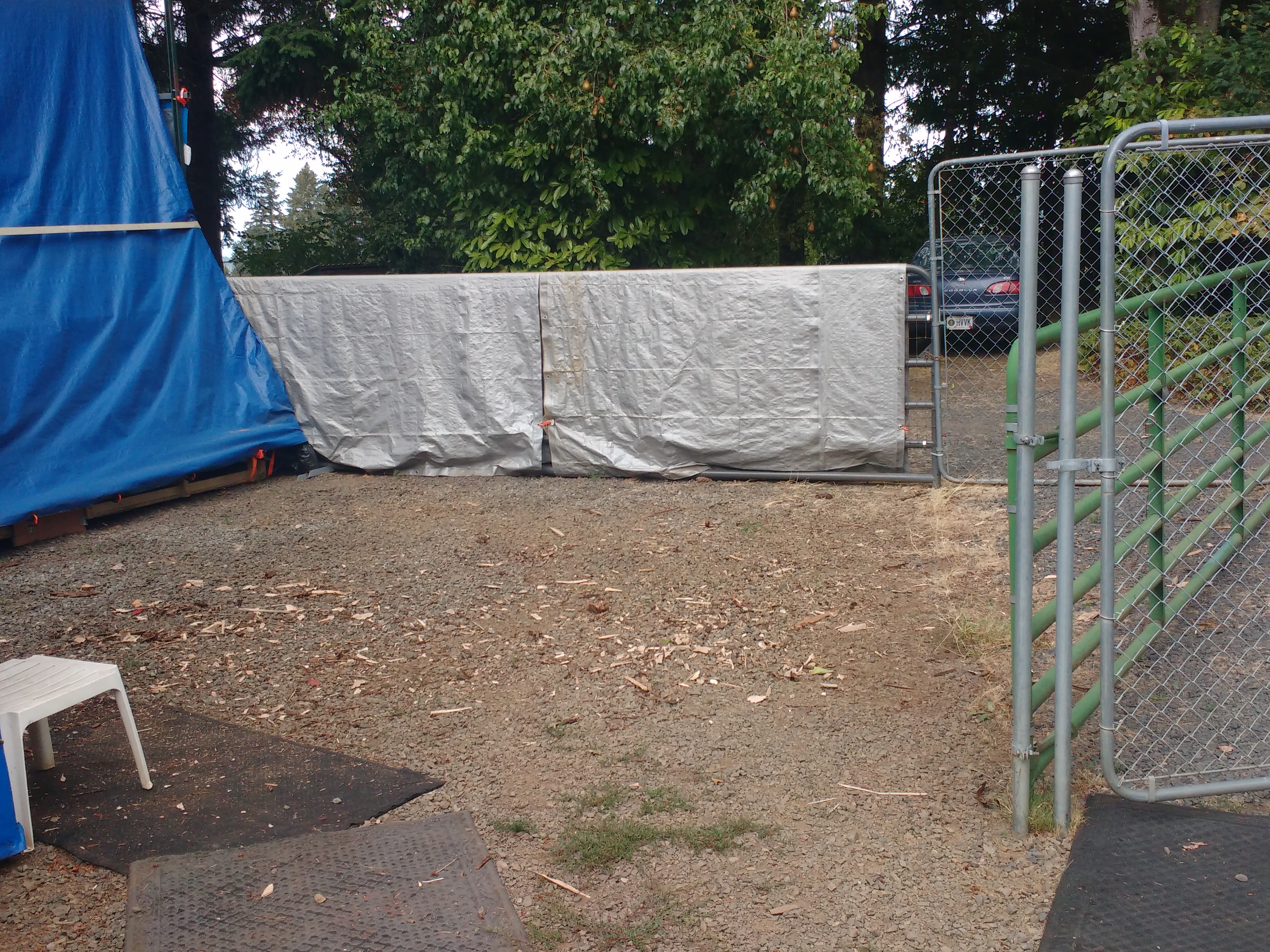

That's one 12'x16' Costco tarp, today I got a second one up (not shown in that pic) - each one's held out from the house by 5 12' 2x4's, clamped to every other rafter tail (up UNDER the roof) and to a second STAKE driven into the ground at the outer end. That gives me just over 9 feet from house to bottom of the tarps - I'll extend that "lean-to tent" clear to the other end of the house, so EVERYTHING I do will stay bone dry til the paint's dry. (Including ME...)
I also have enough of the led lights to run them full length, then they can get used elsewhere when it's done. Not clear in the pics, each pair of lights hangs on a 10' stick of 1" conduit, which is clamped to the 2x4 "tarp rafters" and angled out toward the house - Those give me enough light I can work til bedtime if I'm feelin' frisky (Ever seen a frisky 73 year old? Me neither :confused:
I'm gonna use one of the tall containers as a "paint booth", pre-prime EVERYTHING including the replacement sheathing (already in hand), then when it's ALL nailed up I'll spray the final color. This time it's gonna be a medium gray (few shades lighter than the mil-spec "lego blocks", with a slightly darker than sky blue trim.

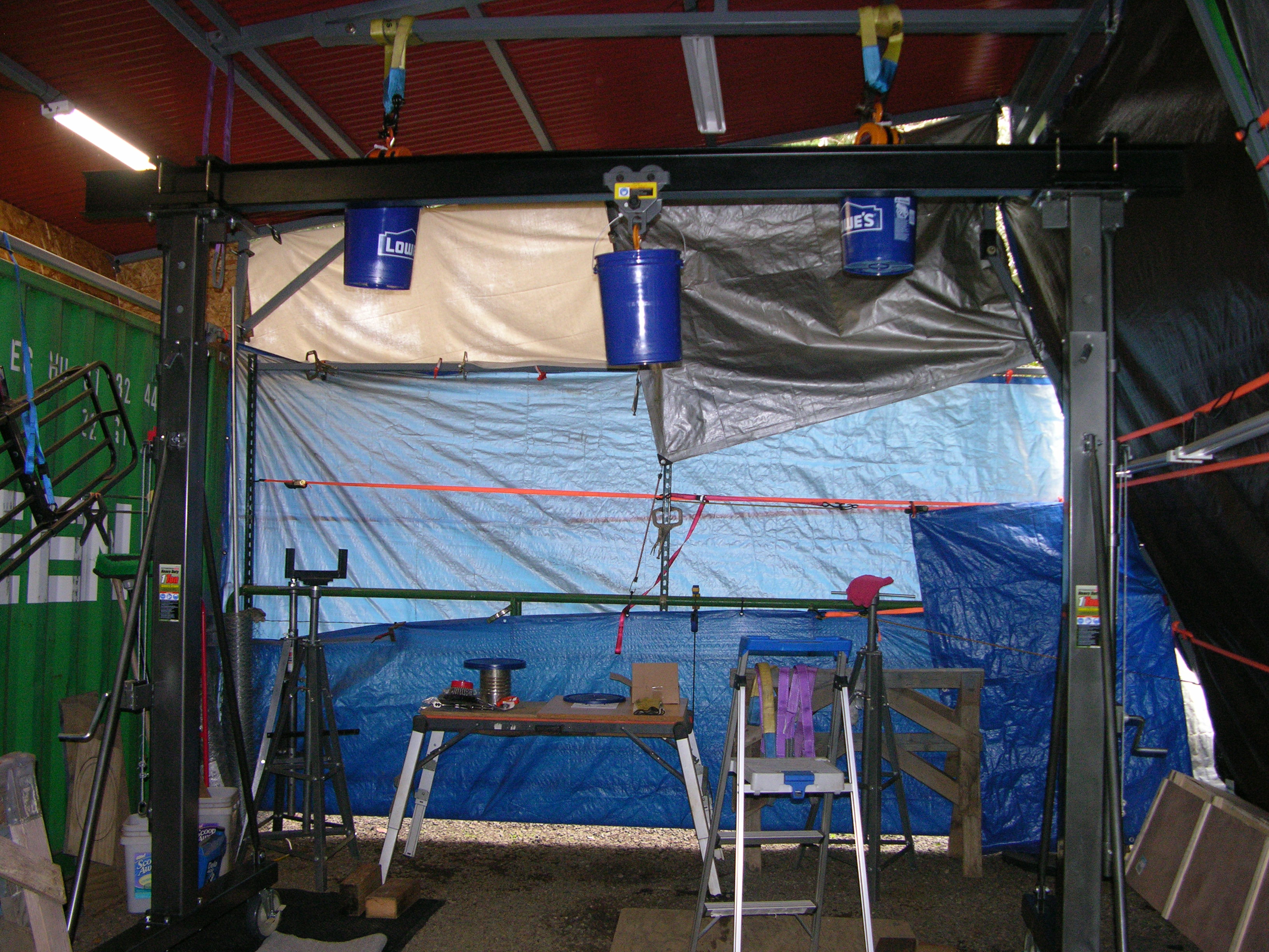

Did make a little progress in "getting ready to do stuff" :rolleyes: Rest of the tenting is almost done as of a couple days ago
The gap in the middle is where the sliding glass door is, that'll get its tarp ONLY when the weather actually makes it necessary. (And I have no doubt it WILL before I'm done)
Yesterday I got one of the hi-cube containers set up with lights/masking, and got 8 sheets of 1/2" CDX ply leaned up vertical (spaced down one side) - new airless sprayer will go in the container NEXT to it - then prime one side, let dry, flip, do other side. In between coats I'll finish stripping the rest of the old siding (36 feet left to do) then cut the sheathing 48" above where the sheathing SHOULD have stopped - then the pre-primed CDX will replace the bottom 4 feet of sheathing. (Can't WAIT to see what's under THAT :rolleyes:)
I'm using Kilz2 (un-thinned) for primer, I figure the anti-mildew can't hurt.
Then comes CORRECT flashing (as opposed to "NONE"/house wrap, pre-priming new siding (using same container "paint shop"), siding goes up (WITHOUT creating another "row housing for bugs" gap) and spray final color. Then new (pre-primed by me) trim, paint that, final caulk around windows...
Dang, I'm tired just TALKIN' about it :confused: ...Steve
