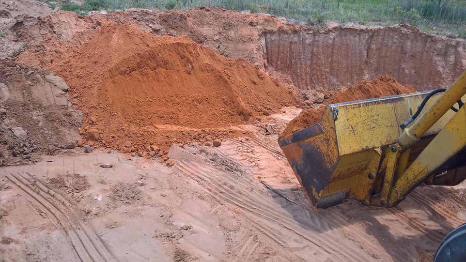

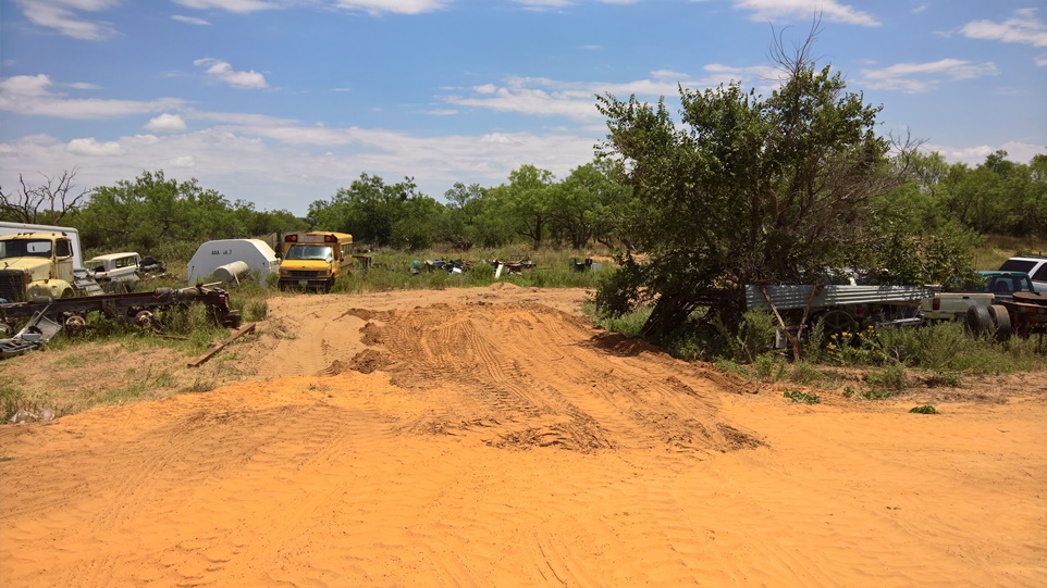

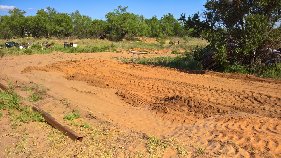

Started out this morning have to clear off an area of 20x30 by 4 feet deep to expose more good fill material before I could start excavating it after spending all that time I only excavated enough for about 20 loader buckets full
the shop floor this morning
This afternoon
I think I am going to have to make a spray bar to hang off the bumper of my pickup and water the fill down because it is getting dryer and not compacting as well

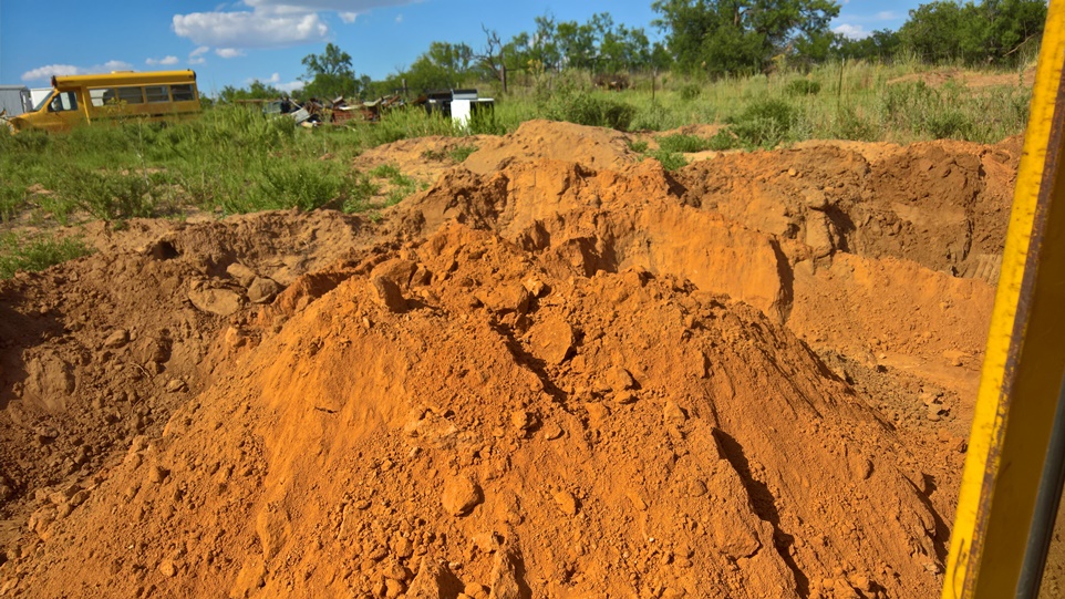

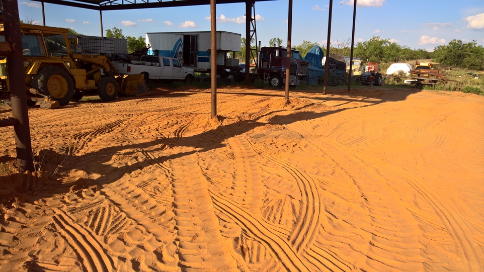

The more fill I excavate and spread the more I am glad not to be doing this with shovels and wheel barrows.

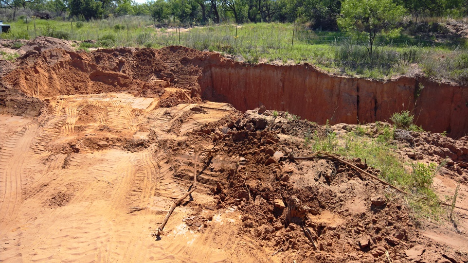

After having to replace a couple of damaged grease zerks topping off the fluids I sat about the now daily task of relocating part of the Earths crust.
First off I had to build my daily stock pile of fill since one of my personal indicators of whether or not I feel I have accomplished anything for the day is to run out of fill at the end of the day
the ever encreasing pit
the stock pile after several bucket fulls have been hauled
out of material again
Ok the second pile of the day
by the end of the day some 50 trips were made just to add this little bit
I spend more time spreading and driving back and forth over each thin layer of fill I put down than actually moving of material
And I really am going to have to start watering this stuff down

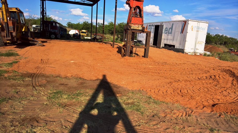

This morning my wife thought I had finally stripped the cogs off of the last remaining brain cell in my head when I told her I was going to arrange a few things which would eventually lead to adding another bay on the shop should ZI ever require it.
She said Frank you have already gone from building a 4000 sq ft shop to one that will be 6000 sq ft and you are no closer to completing it than you were before you decided to make it bigger.
Why do you think you want to make it larger now instead of latter if you need it.

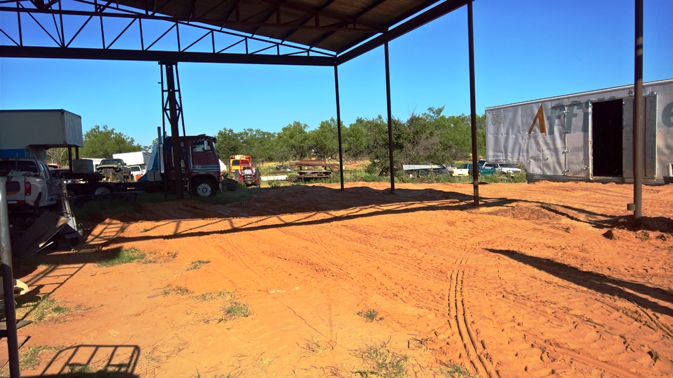

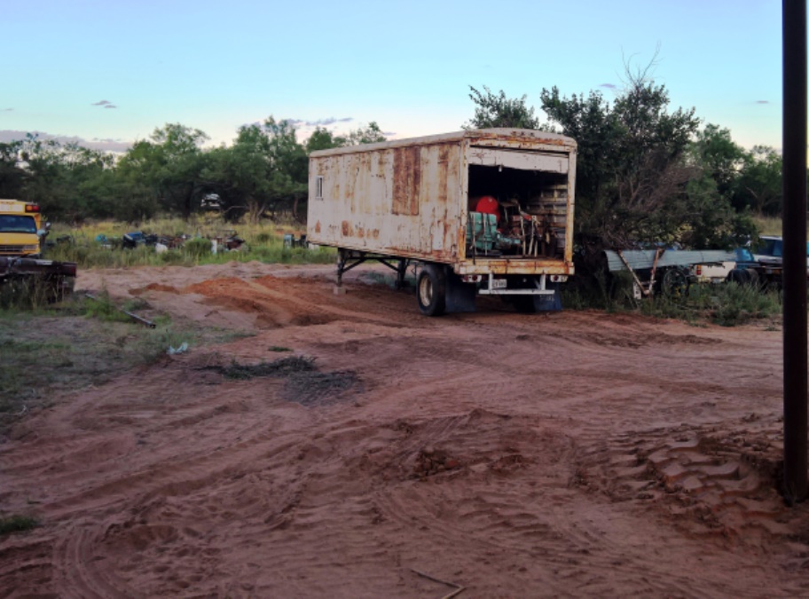

So this brings me to how I came up with the idea I have some storage van trailers that are parked just inside my fence out next to the highway in front of the shop. I will need to relocate them eventually any way, so why not pre plan on how to make best use of their storage capabilities. Right now they are full of stuff that most of it will be place in the shop once it is closer to completion. but where the trailers are located it is most difficult to transport materials or equipment from them.
So I decided to spend some time now and save even more time latter by relocating the trailers or at least prepare an area where I will be relocating them. To not do this might mean I would not be able to place them where I want them due to the amount of fill I still need to add, plus once I park and ground the tool room trailer it may be completely impossible to place one of them anyway.

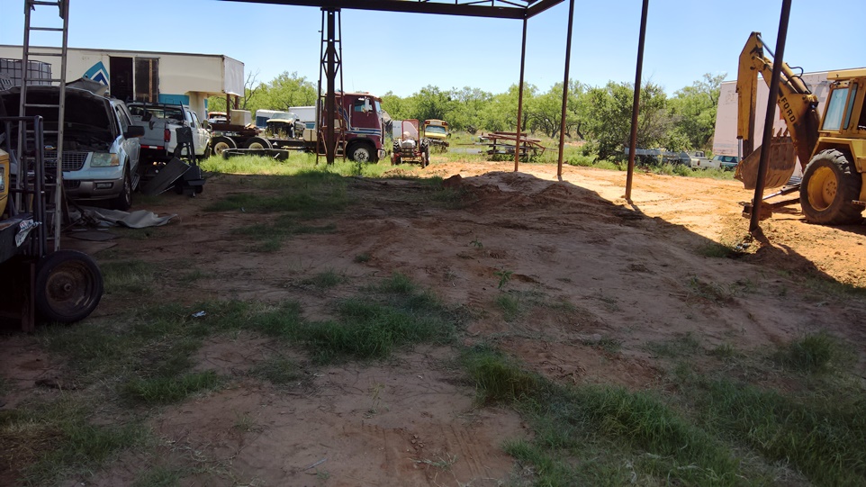

So I began the day moving a load of bar joists which will be used for the rood between the shop and the machine shop trailer. then I moved my forklift that has been parked at the end of the container on the North side of the shop ever since the container had been placed there.
Then I moved my steel rack and a lot of other materials which was in my way
then pushed off about a foot of the soft dirt and refilled with the rejected fill material I have been mining for the shop floor. Since the area will not be brought up to grade any time soon the reject fill would serve to harden up the soil enough to place the first trailer there Plus by leaving the area about 2 feet below the finished floor level once I remove the wheels and tires entry to the trailers will only be about a foot above the eventual slab Also I plan to put the trailers with about a 25 ft bay between them which may eventually be roofed over
And that is how the insane mind of the Frank functions
