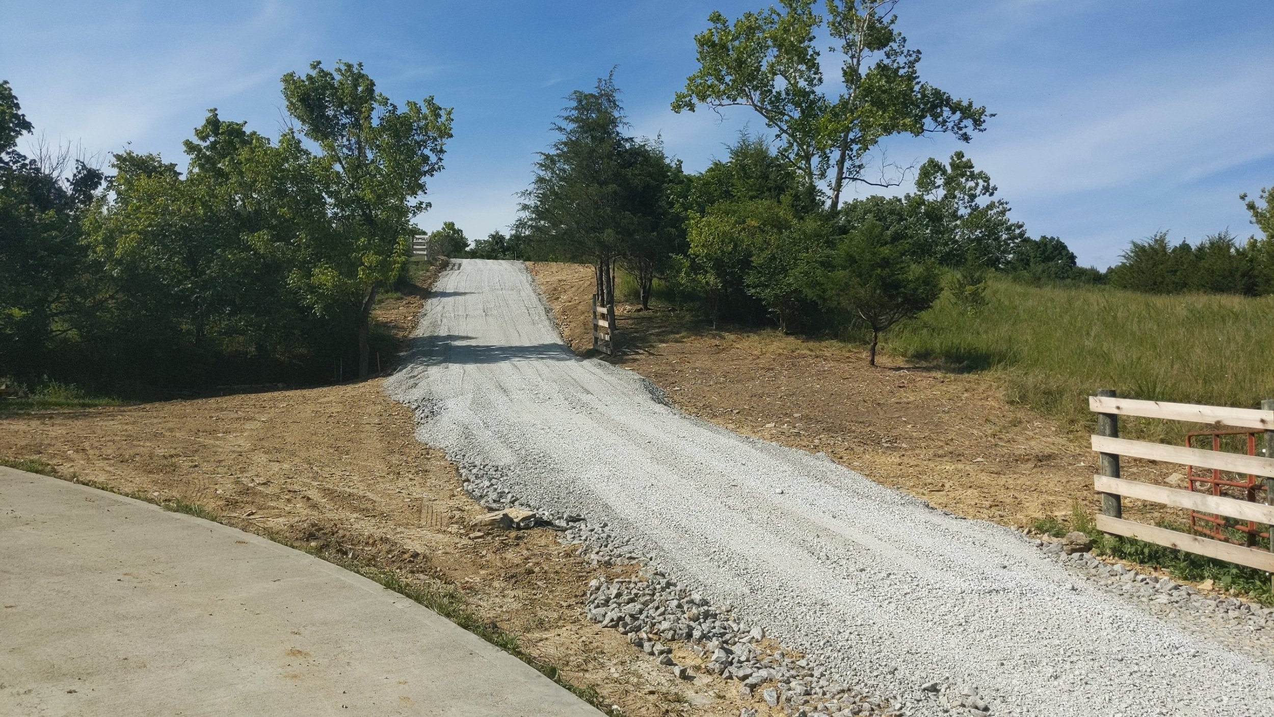

I'm getting crashed stone delivered and spread on my old gravel driveway. I will crown and level it. Then a guy with vibrating roller will come over and compact it. Would it be a good idea to have stone dust spread on top before compacting? Please share your experience/ideas/suggestions...
If you get crushed stone or gravel (which helps interlock) Smaller stone could be vibrated in the "lock in " the surface and make it smoother. Stone dust will just settle in/wash off the next rain event.

When I top dress my driveway I get screened gravel, commonly call #57 or #67 or fine screened. My driveway is too steep for crusher run and fines, the dust gets carried away to easily by the rain and you are left with loose rock.
My driveway climbs ~21' with 79' on the slope. I don't know if that's as steep as yours, but if I don't roll it wet both the fines and the smaller rock will wash down hill in a inch per hour rain. If I roll it wet with a slight crown, even a 4" per hr rain doesn't cause much damage. I use a poly 46" lawn roller behind my BX multiple passes and I go SLOW.
