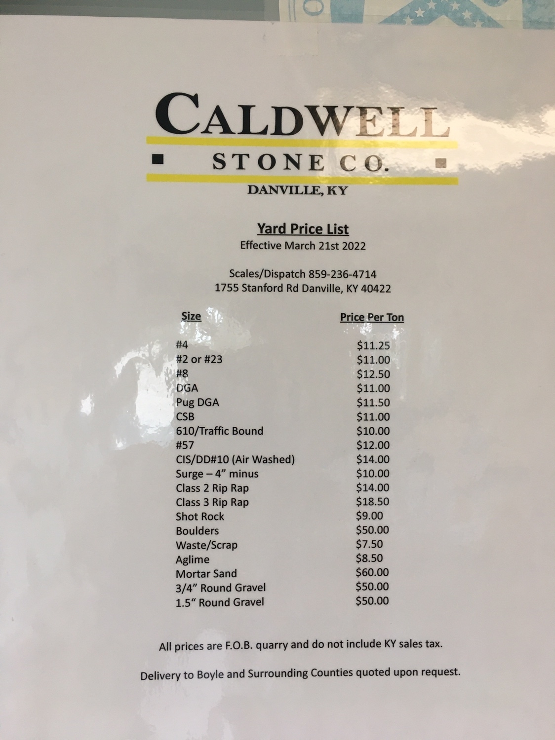

Ive noticed that road base is called by different names depending on your location.
Here we use DGA which stands for dense grade aggregate. If you want to get a high level of compaction then you get DGA that has been run through a PUG mill. This is basically mixing water into the DGA. This mixture will compact like concrete.
All rock in our area is sold by weight and the price varies by the size.
I sure prices are up some this year but these prices were good this spring.
I am not sure of your existing drive but when building a road you first cut out all the organics, meaning the topsoil is removed to the clay. Fabric is laid followed by #4s then the DGA. This is an over simplification of the process and doesn’t address drainage.
