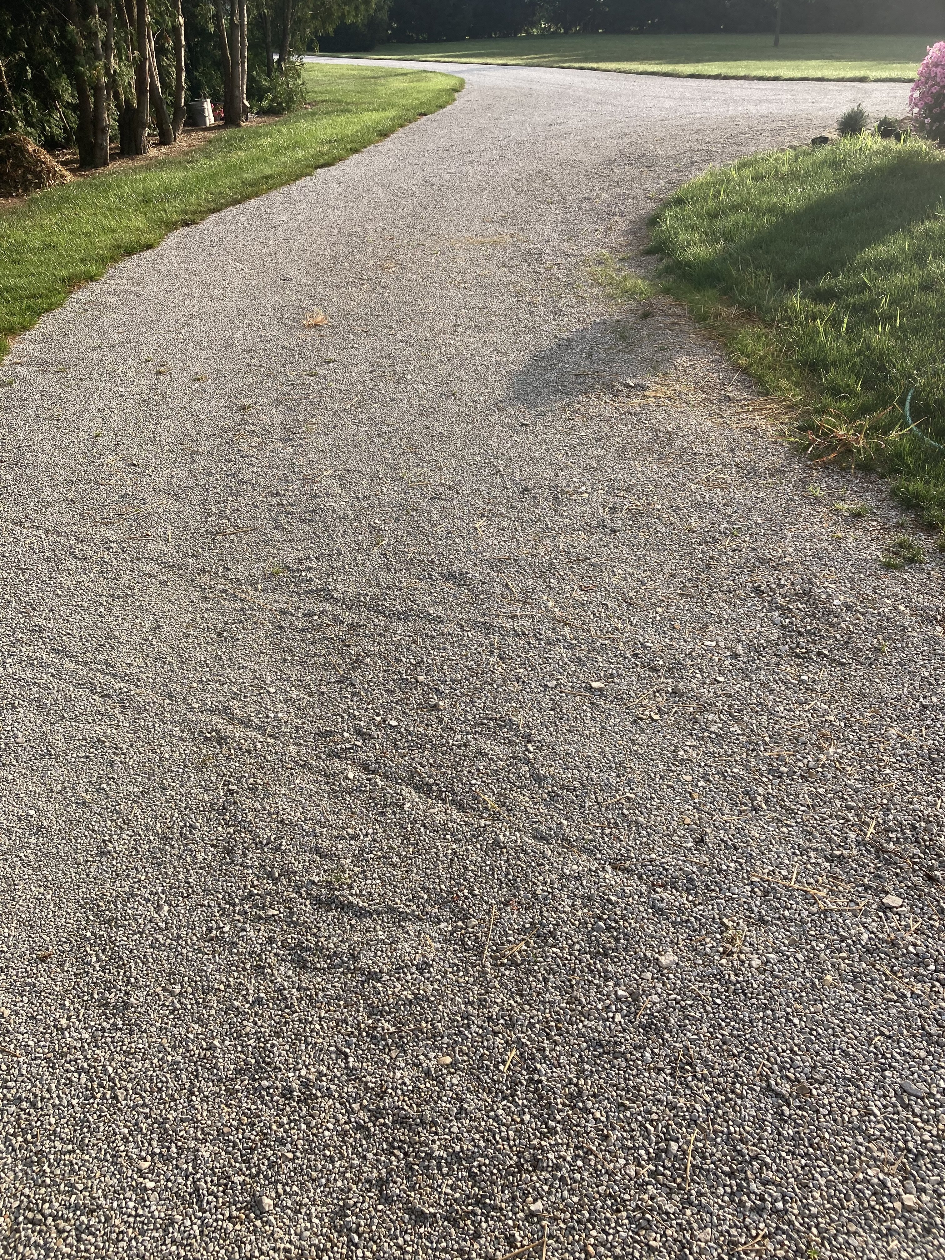

I'm getting crashed stone delivered and spread on my old gravel driveway. I will crown and level it. Then a guy with vibrating roller will come over and compact it. Would it be a good idea to have stone dust spread on top before compacting? Please share your experience/ideas/suggestions...

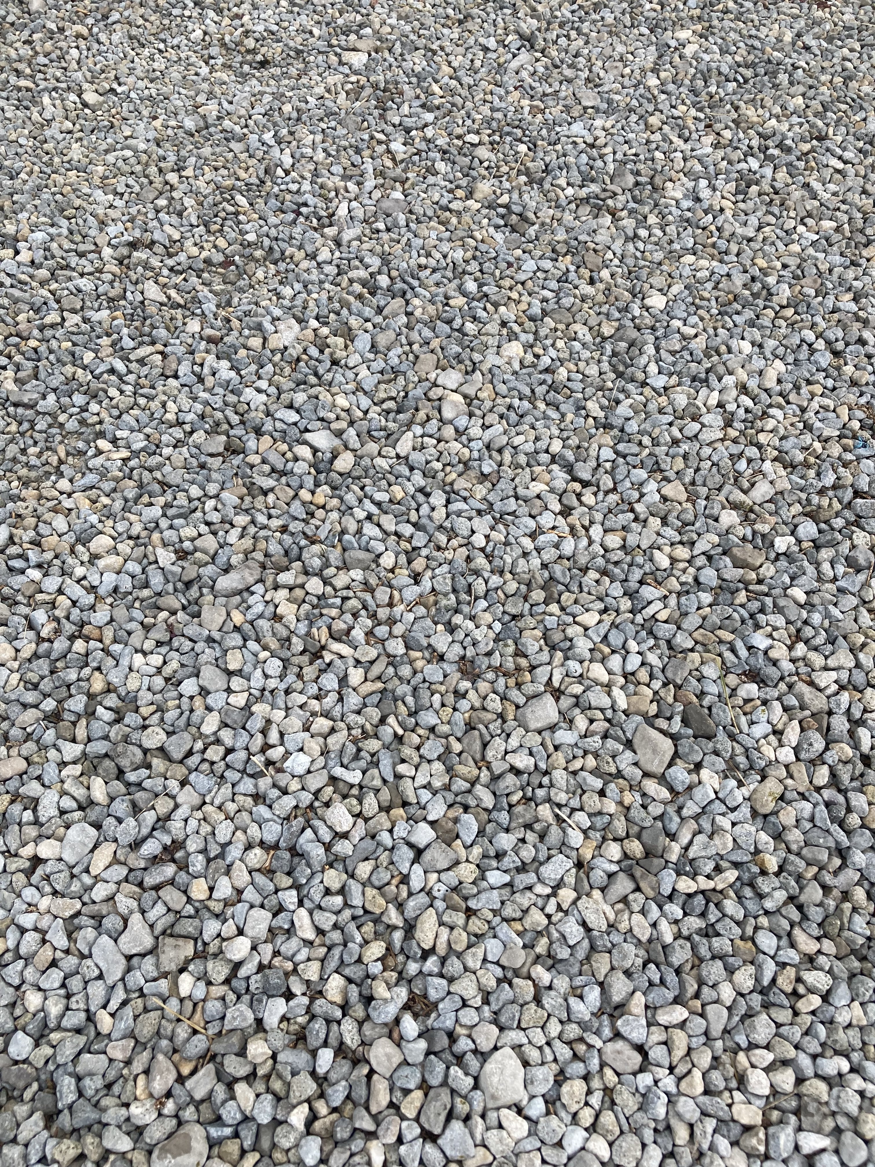

If you're taking time to spread crushed stone, and I'm assuming it's clean/washed stone, compact it, then ADD stone dust, you are simply trying to make "crusher run" topping. That twice the work, and twice the delivery and spreading costs.
As you know, stone/crushed rock has 999 different names, numbers, sizes, colors, preferences from region to region, and supply yard to yard, quarry to quarry. It's confusing.
I put down generically called "3/4-minus." It's roughly 3/4" down to dust, with a few 1" stones intermixed
..not perfect screening. It spread easily, packs super well, and isn't really too muddy or dusty in rain or dry times.
I topcoated with what's called #10 block fill...it's like little sharp edged washed stones, 3/8" and smaller, but no dust. It packs crazy hard and really keeps dust and mud down, and doesn't really spin out if driving on it. Easy to rake or smooth if some truck happens to slip a wheel.
Make it easy and efficient...loosen up that base you have now with scarifiers...no sense in putting avocado oil on Teflon and expecting it to stick.

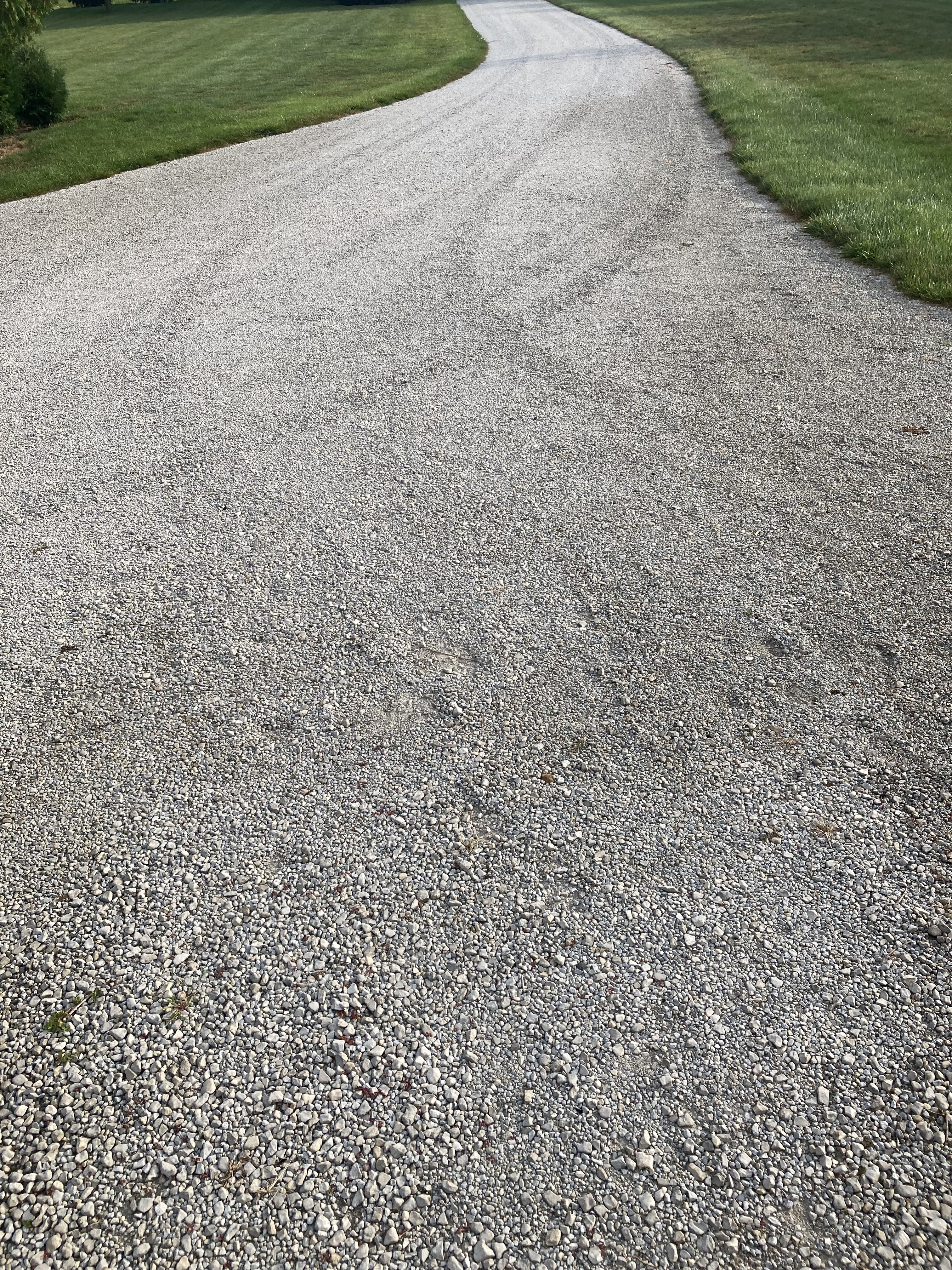

Yeah I do wish the names were standard across the region. Here in Kentucky it's called "dense grade". It's a mixture of stone from pea gravel size up to nearly #57 size, with power mixed in. If it's wet, it'll compact very well and it's almost like driving on pavement.
However, as soon as the weather turns very dry it'll go to dust and fly around a LOT and potholes pop up quickly. That's been a big problem here this year due to moderate drought conditions.
Generally about 24 hours after a rain I can run over the road with my land plane and it'll smooth everything back out and make it nice to drive on again for several weeks.
