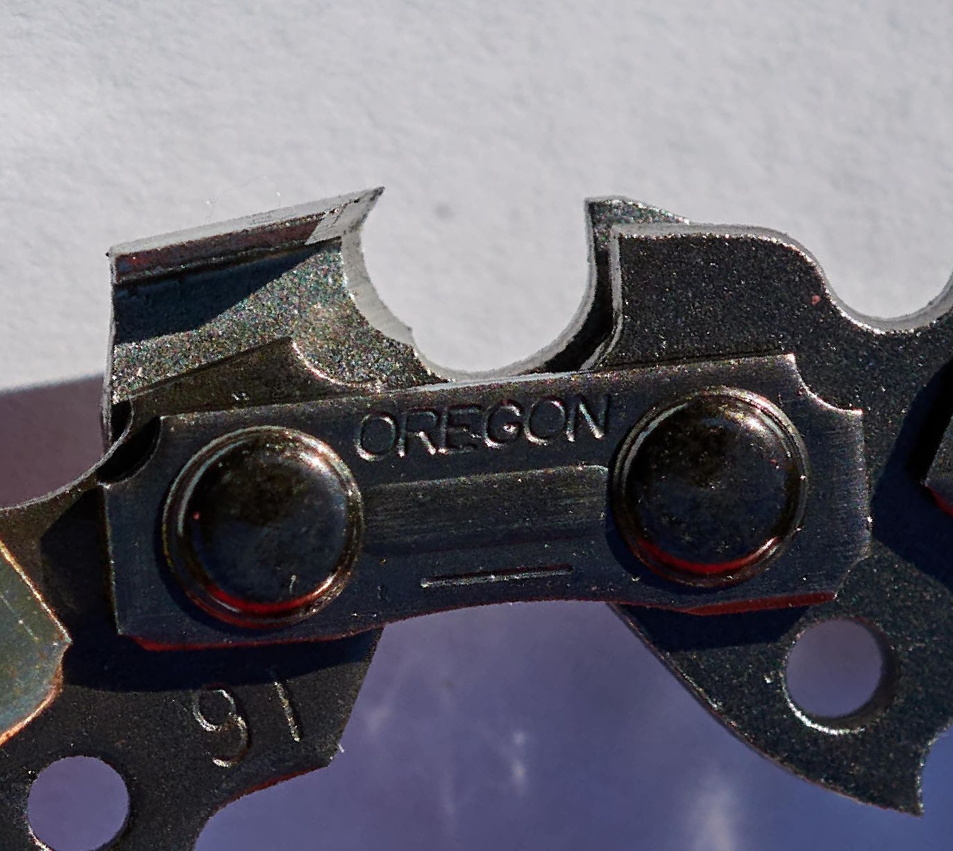

This a new factory gullet profile out of the package for my echo. The package says to use a 5/32 file to sharpen. I don't know what chain you have.

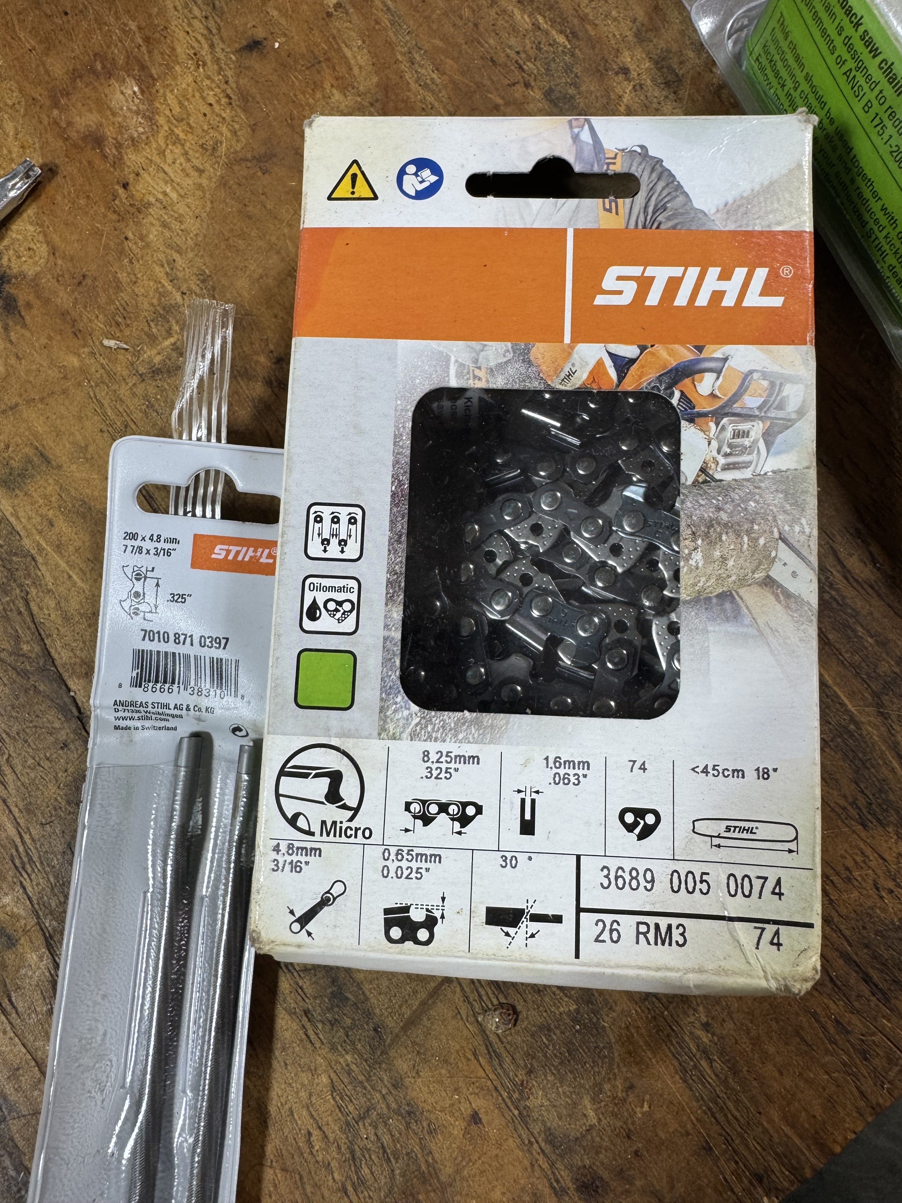

I’m using the correct file, here is a picture of a new chain on the tag on the files I bought.

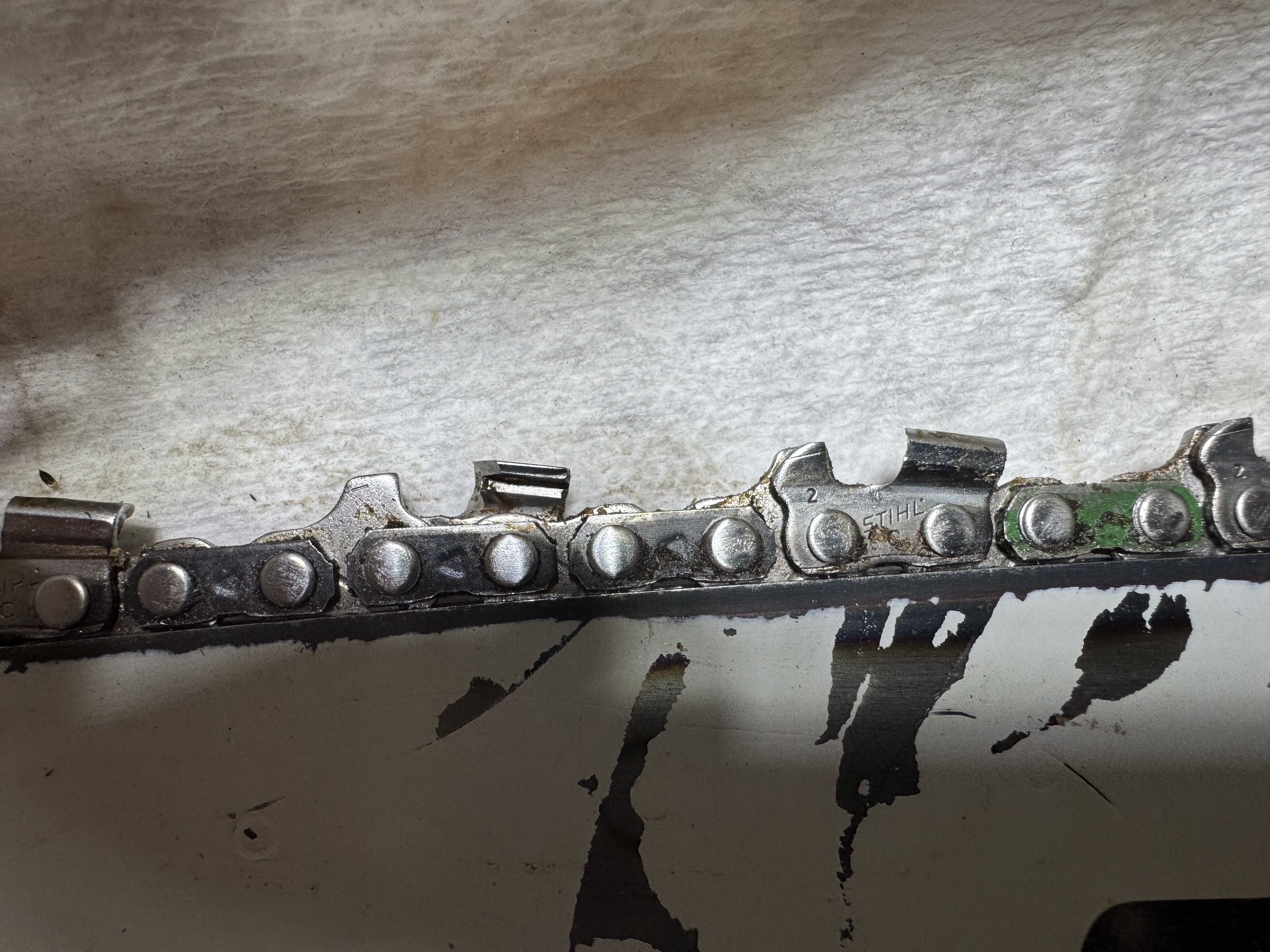

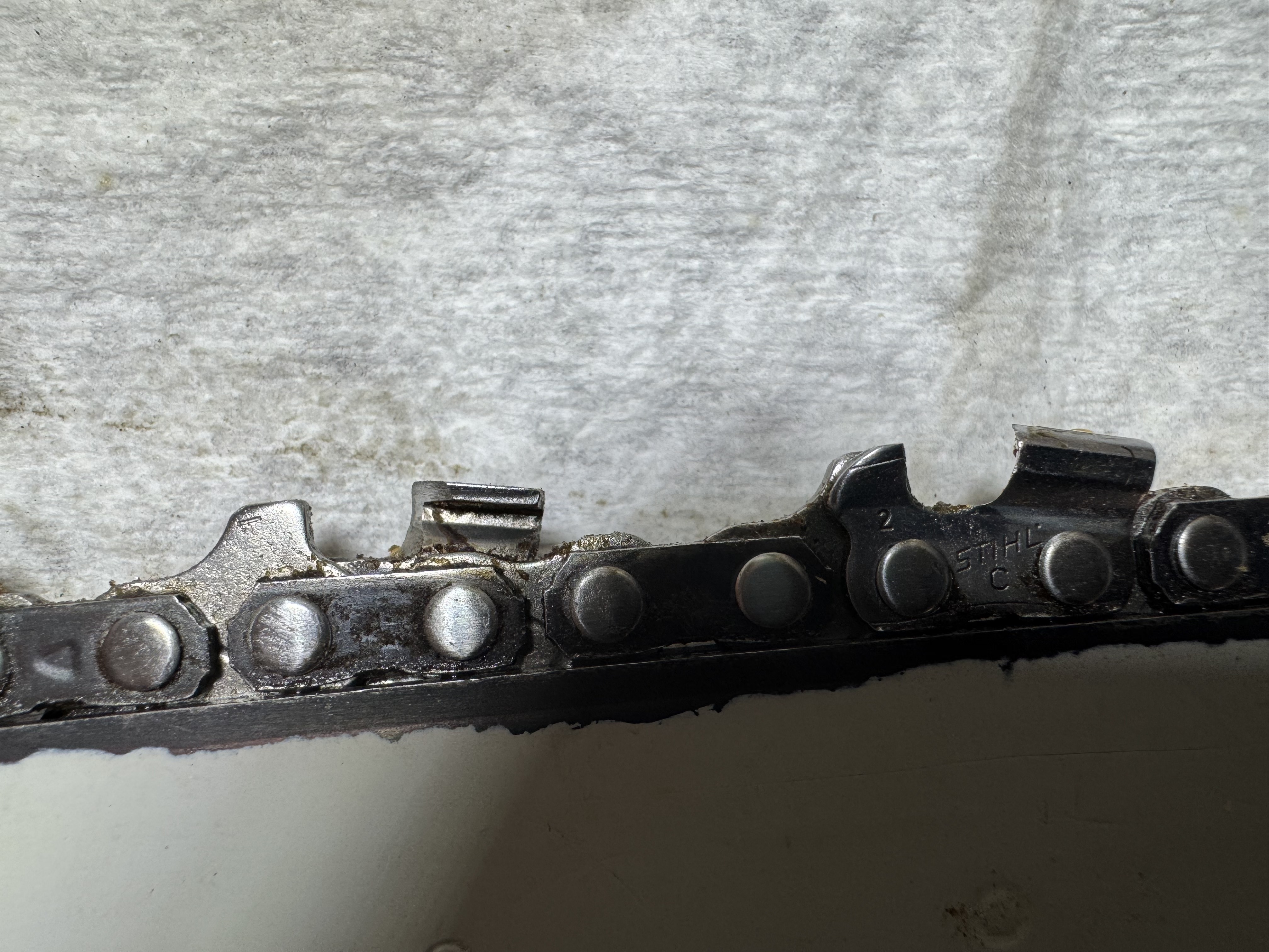

A couple of pictures of teeth. I compared to my new chain. I feel the first picture I’m close on the sharpening, the second one the tooth seems straight up and down with no curve.
   / Chain sharpening difference? #84
Are you sharpening only using a file by eye? I think what has happened is the correct profile got lost while sharpening previously. In my situation, I'd cheat and use the electric grinder to get back a uniform profile.
I suspect the guys who successfully sharpen only using a file have done it so much that they've trained their muscle memory to be almost machine like in their sharpening technique.
Tempted to say cut with it if it cuts okay, but try to get the C back next sharpening?

I made pictures of my chain that I hand sharpened. After looking at them, I can't claim mine looks any better than yours (post #83).

Almost looks like you need a little more head tilt for the leading edge.
What’s that mean exactly? Have the file tilted up a little? I do tilt it up a little but maybe I need more.
