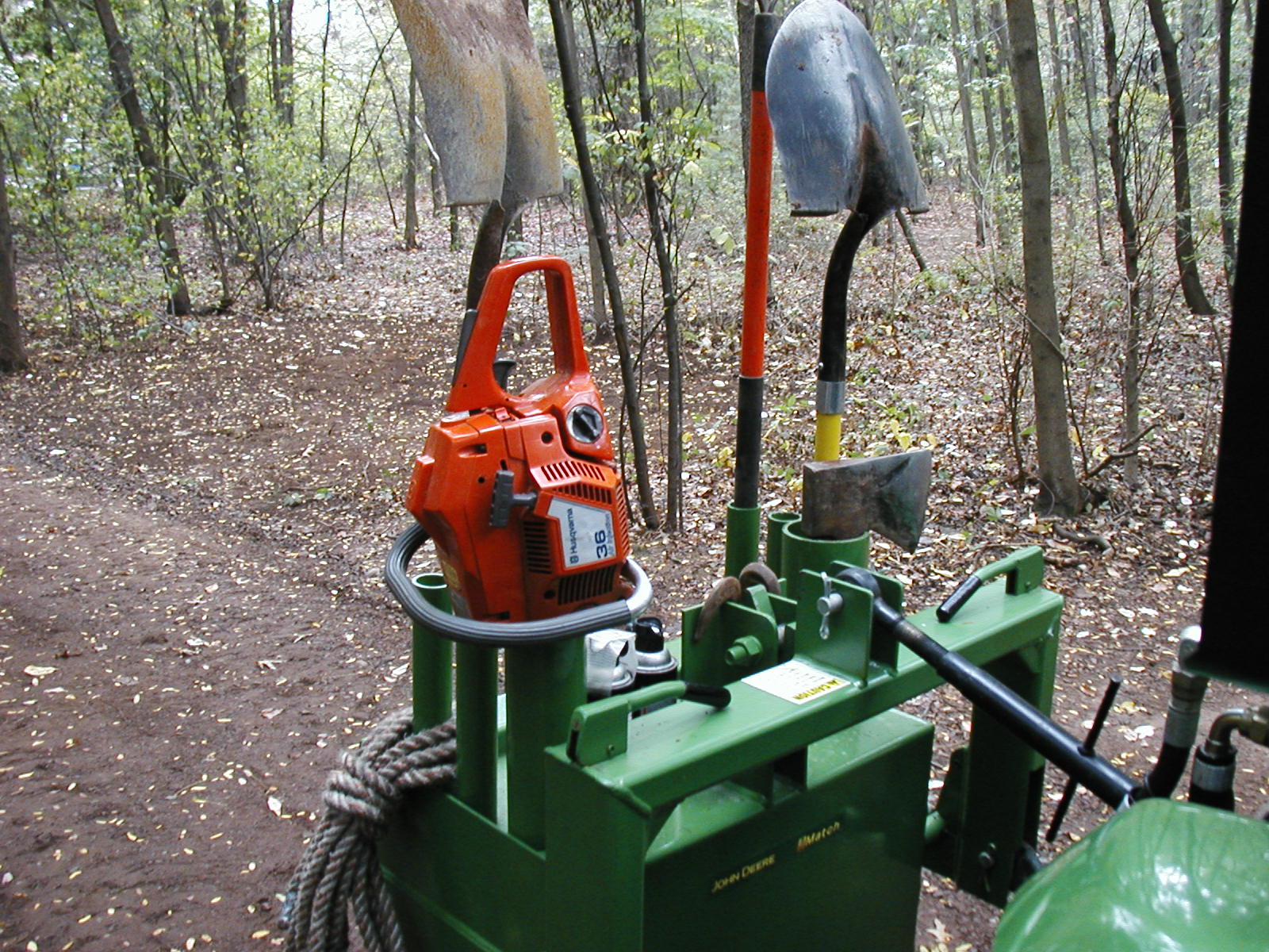

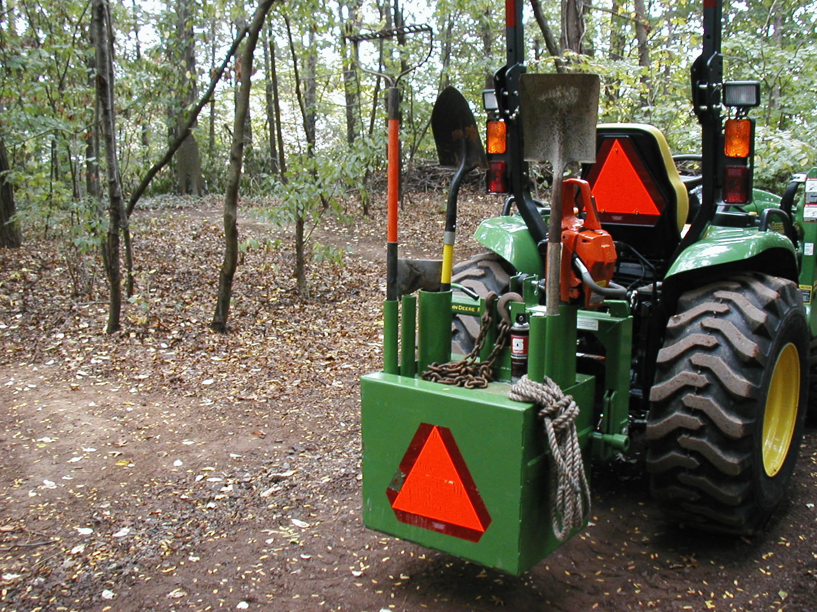

I put a piece of 4" Pvc pipe in my ballast box for multi use and the small saw fits, have not tried bigger saws.
Pic shows saw in 3" pipe, this is my kick around saw, don't know if this set up would be ok for a premium saw.
