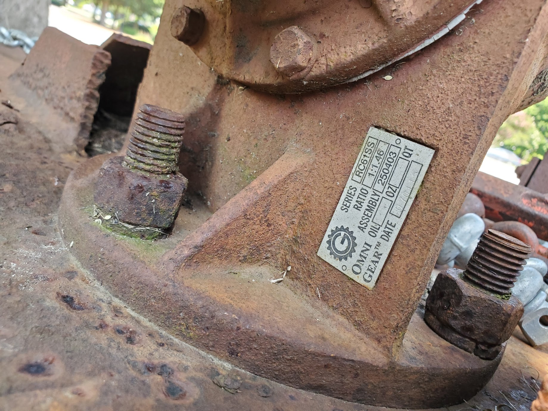

The rotary cutter is in rougher shape than I realized. I bought it as an after-thought. I said, "what will you take for both the flail and the bush hog". The number sounded good so I went with it. I got a new wheel welded on it but I still need to replace one of the hitch pins (one of them is CAT 2). I found several cracked welds under the unit that I want to correct while I'm working on it. Also, I thought it was only heavily rusted in one area (directly in front of the gearbox, under PTO shaft) but there is a good bit of rust all under the cutter. Makes me wonder if it got salt under it at some point. I know the oil leaks out the lower seal so I am going to go ahead and replace that. Any idea how to source an oil seal for this thing? I can't find a parts diagram anywhere.
RC61SS
250403
I can get to the oil seal from here, correct?

Nope, nope nope, you have to remove the gearbox from the upper weldment then remove the bolts to remove the seal retainer.
you need to scrub the metal around the gear box mounting with a wire brush to bare metal and then pour alcohol or safety solvent on the upper weldment mounting plate to clean it more and then scrub it again and look for cracks in the metal as the plate may have stress cracks in it.
You can call Omni Gear in Houston, Texas and obtain the right seal from them for this right angle gearbox. Since you have gone this far you should remove both seals and replace them.
Make sure you have all the information from the identification tag on a piece of paper in front of you when you call them in Houston, Texas to obtain the right seal number part or the generic National Oil Seal part number.
Omni Gear main number
1-713-635-6331
Just keep in mind that quite often the shafts are worn enough that the new seals may not hold oil- I know its not what you want to hear but its better to know this in advance and then you can decide whether you want to replace the gearbox as the inner gears and bearings are very worn. Ask them for a replacement gear box price as long as you are talking to them as well.

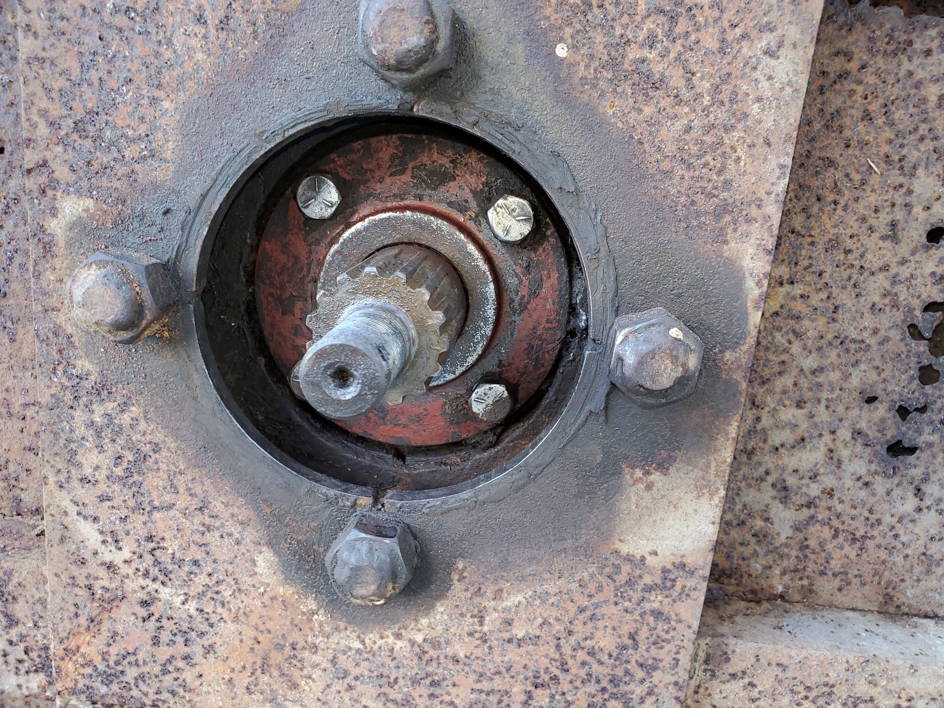

Really?? That is mind boggling that I can't just pull that plate off the bottom, remove oil seal from plate, replace oil seal, slide oil seal back over shaft, bolt plate back to gearbox. Pretty sure that is how my last gearbox worked, anyway.

You always risk tearing the seal and breaking the spring. You need a seal driver to properly and squarely drive the seal in place. White PVC pipe works well for this as long as you have the right inside diameter PVC pipe.

OK, so as long as I'm careful I can go at it from the bottom? That is what I was thinking, I'm really not wanting to pull that gearbox off if I don't have to.

I pulled the bolts out the bottom plate but I have no way to pry the plate off. Any ideas? I can't grab it from the side. May end up pulling the gearbox anyway. Or just filling with grease as much as I don't want to do that..
   / Buying used flail mower (JD or Ford) #68
If you fill it with 00 grease you might be set, depending on how much it leaks. 00 grease is the consistency of yogurt, and it is less likely to leak than gear oil. I've used it to fill a gearbox so it wouldn't leak anymore.
