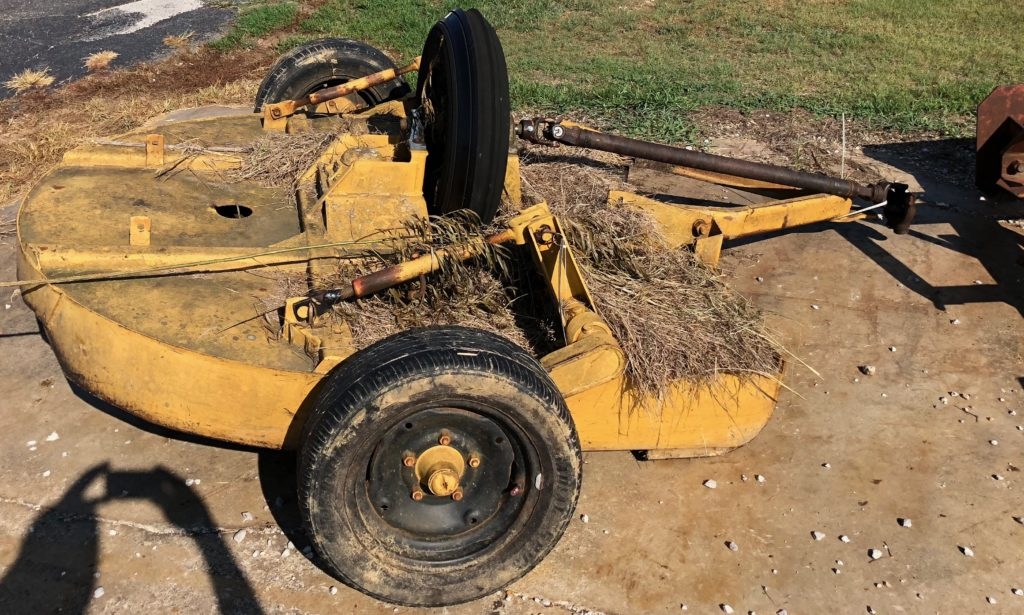

`would having a hyd top link help in this set up? so that it could be adjusted on the fly?
   / Mower operation #22
In my experience a top link cylinder is a must have for any tractor. It allows you to change the angle of engagement at any time while mowing, raking, scraping... anything you do with the rear attachments.
It makes a tractor so much more versatile - actually usable.
   / Mower operation #23
was thinking the same. certainly true in my own case, but not familiar with this type cutter. feel the HTL also reduces safety risk dismounting every time an adj is needed. i'll never go back... regards
   / Mower operation #24
After scalping a spot a time or two with a rotary cutter you'll usually have it leveled off enough to not scalp it the next time you mow:). Seriously though I have never had a problem with a 3 point mower as long as I left some slack in the third link to allow for contour changes.
   / Mower operation #25
Does your tractor have draft control? One can put enough lift pressure to keep top link tight but not enough to lift the implement, a must with rotary cutters to prevent the scalping, etc.
   / Mower operation #26
This is what I was referring to, I no longer have one but my neighbor does. Good if what you are cutting is thick, if you are looking to have it down like a lawn then a finish mower will follow the ground contours if it has casters on all four corners like the Landpride 2572 I sold to another neighbor before I realized the Mott SHD72 was NOT going to give the cut I thought it would.
That's a Sidewinder mower. Great mower.
