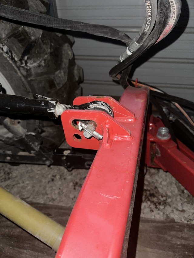

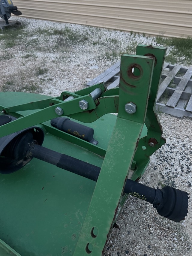

Pictures of the top link attachments, and just as a test I tried both without the top link attached to see what happens and the only difference I noticed is I could not pick up the implement.

The green rotary cutter has a toggle in the bars from the top of the hitch to the back of the mower. That is supposed to pivot to allow the mower to pivot on the lower pins and tilt up in the back. This is good when you back into a hill or drive forwards into a dip. Sometimes the bolts are too tight and that will prevent the link from moving and letting the mower deck pivot. The toggle, if it is working, has the same effect as a chain top link.
My rotary has the same type of pivot and I wind up running it so the 3pt lower arms keep the front of the mower up and the rear wheel follows the countour of the ground. The back of the mower should be closer to the ground than the front when on a level surface. If the front of the mower is digging into the ground you're running the 3pt too low.
I don't have a flail but my understanding is that the rear roller should let the mower follow the contour of the ground and keep the blades out of the dirt.
This is the opposite of what the manual states for the rotary cutter and I’ve been setting the front height to 4.5” which I don’t think is too low. The toggle assembly is loose, so it should work. I’ll have to experiment this week and see if I can get anything to change.

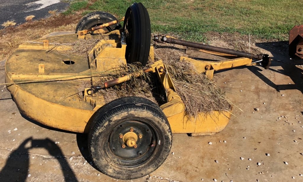

This is what I was referring to, I no longer have one but my neighbor does. Good if what you are cutting is thick, if you are looking to have it down like a lawn then a finish mower will follow the ground contours if it has casters on all four corners like the Landpride 2572 I sold to another neighbor before I realized the Mott SHD72 was NOT going to give the cut I thought it would.
