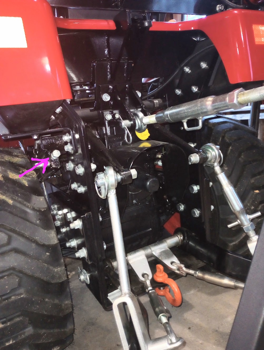

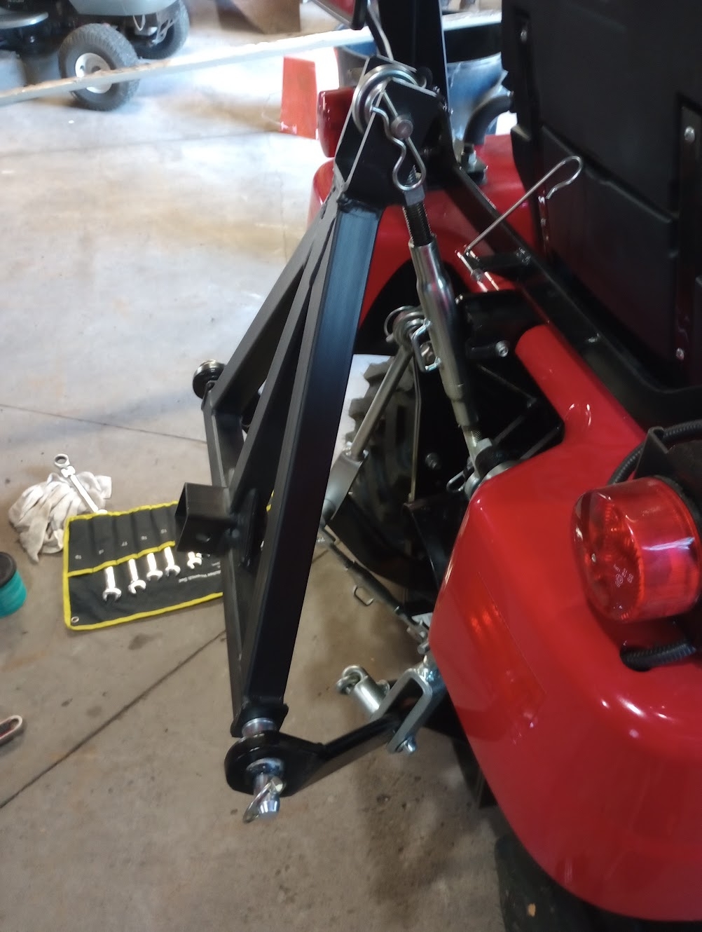

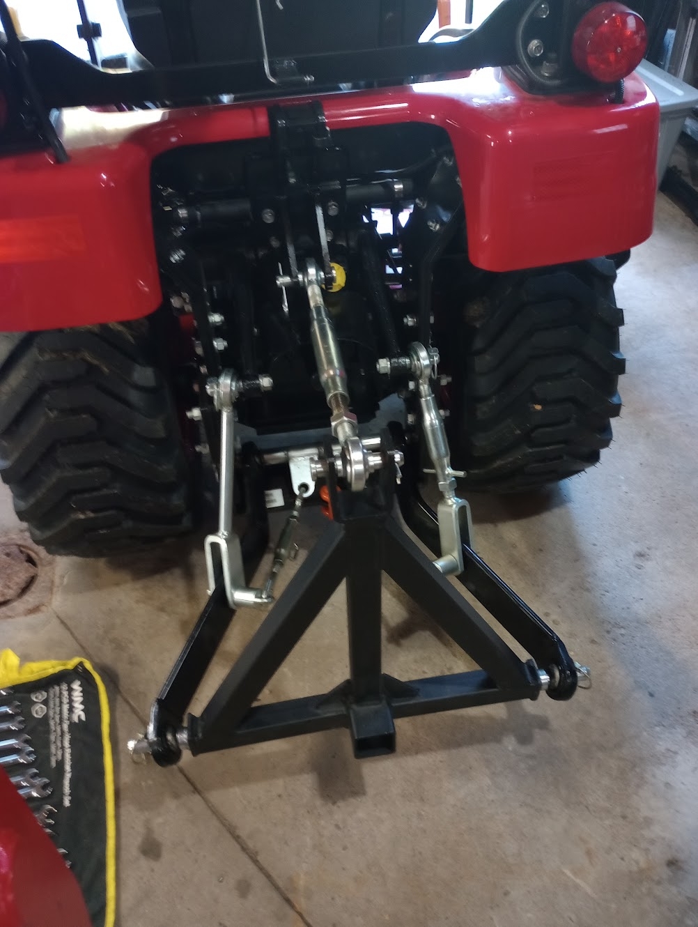

Forgive my ignorance as my TYM T224 is the first 3-point equipped machine I've owned. So far I've only used the below pictured hitch attachment on it. What I can't figure out is, if I'm not careful on how high I raise the 3-pt with this hitch attached, the top link goes high enough to slam against the tractor's frame/x-member.
There is what I thought was a max height adjustment set bolt/jamb nut (purple arrow pointing to it, 3rd pic down), but adjusting that has had no effect. There are no additional holes for the top link and there is absolutely nothing in the operator's manual on it.

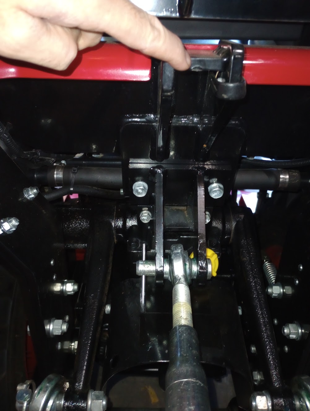

My finger is pointing to the dent and broken paint from the few times I went too high with the mowing deck and this hitch on at the same time. The 3-pt moves about 75% of it's travel before the deck moves it's ~6" between full up and full down.

Turn the adjuster on the top link to make it longer. Enough so your attachment is plumb. That will change the angle of your top link and give it more clearance.

I suspect this tractor has what is often called a "limited cat 1" 3 pt hitch.
This means the distance between the lower arms and top link is shorter than a regular cat 1 hitch. So when using a regular cat 1 implement just like that one in the picture, which has the regular spacing between the lower pins and top link pin, tends to push the top link way too high.

What about a longer different top link? Would that get it out far enough to not hit? Take a pic with the top link OFF and with the hitch raised all the way. What's a straight line from a vertical implement to the top link hole look like then?

I appreciate all the suggestions. I think I got it figured out. That jamb nut hard stop I mentioned above with the purple arrow pointing to it is the stop, but if I adjust it in too far, the MMM won't achieve it's full 6" raised height. Once mowing season is over and I don't need the deck anymore, I'll be able to adjust it so the top leak isn't able to top itself out against the chassis on the tractor.

Still looks like a longer top link would keep it from hitting.
