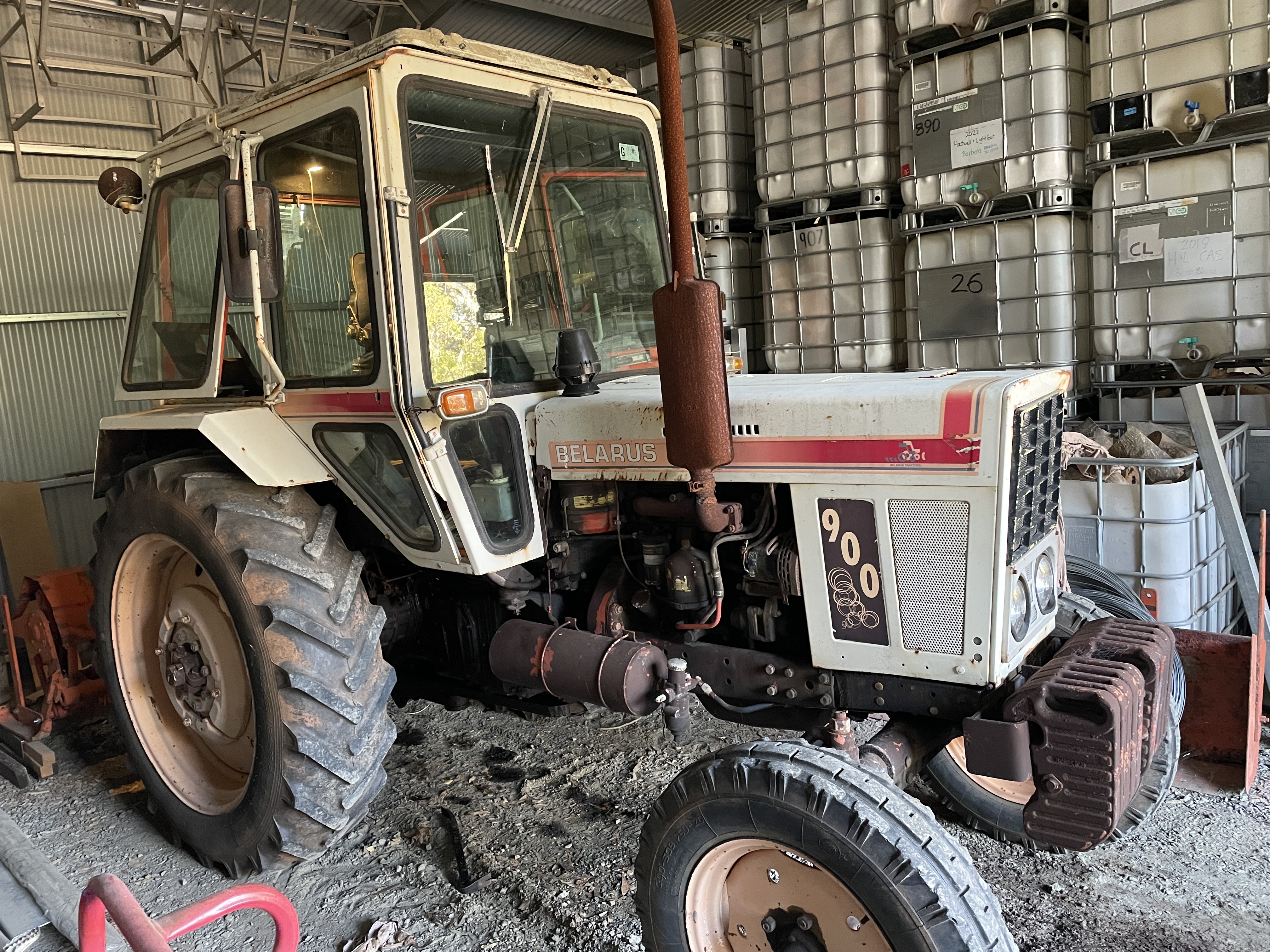

I've bought a cheap Belarus 900 that appears to be a 1986 model. I've found a manual for the later tractors, which is somewhat useful for my year model, but there's a few differences in the pictures and description.
Does anyone know how the 3-point is supposed to operate? On every other tractor I've driven there's one lever to raise and lower the hitch, but with this tractor I can make the hitch raise and lower with both a lever beside the seat and the outermost lever of what the manual calls a hydraulic distributor.
When I bought the tractor, I could just get my spader implement raised by using both levers at the same time and revving the motor pretty high. Oil was running out of the 3-point ram though (it's an external cylinder, also different to every other tractor I've driven), so I've rebuilt the ram with new seals and replaced. Now, I can get the hitch to go up and down without a load, but not with the spader attached. The ram no longer leaks and cracking what I think is a bleed port, as well as the hydraulic hoses, runs clean oil with no apparent air.
It's hard to troubleshoot when it seems the hitch responds to a random set of movement with two levers that each have four positions.

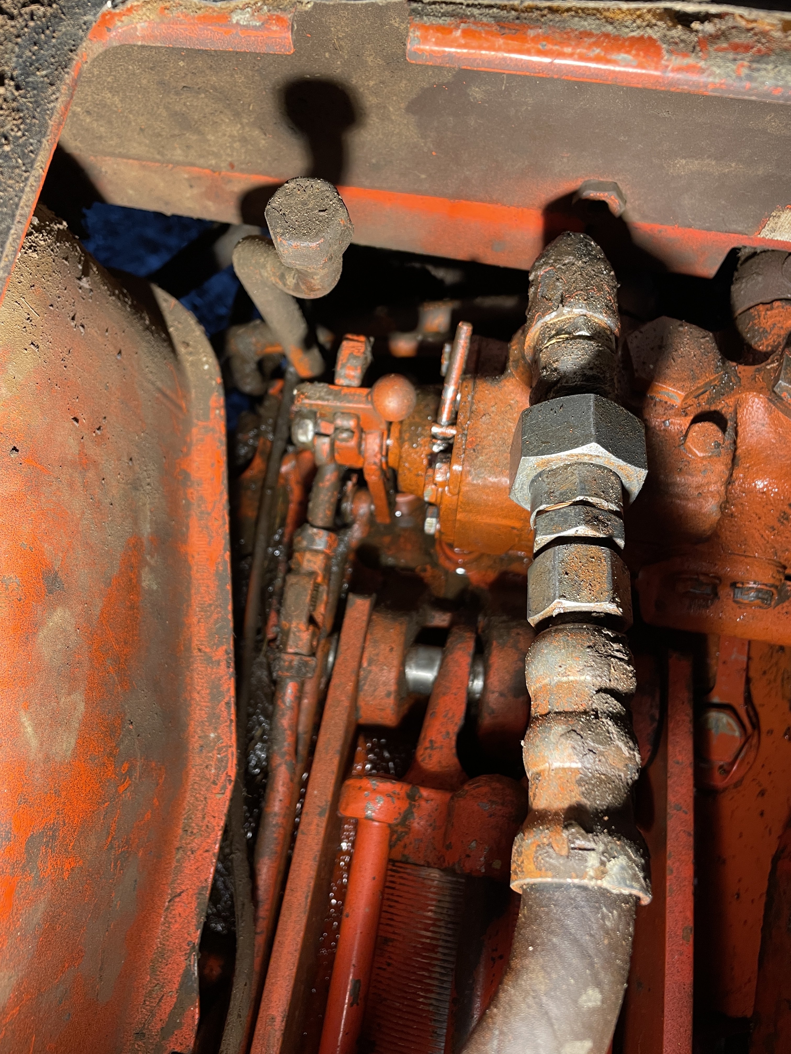

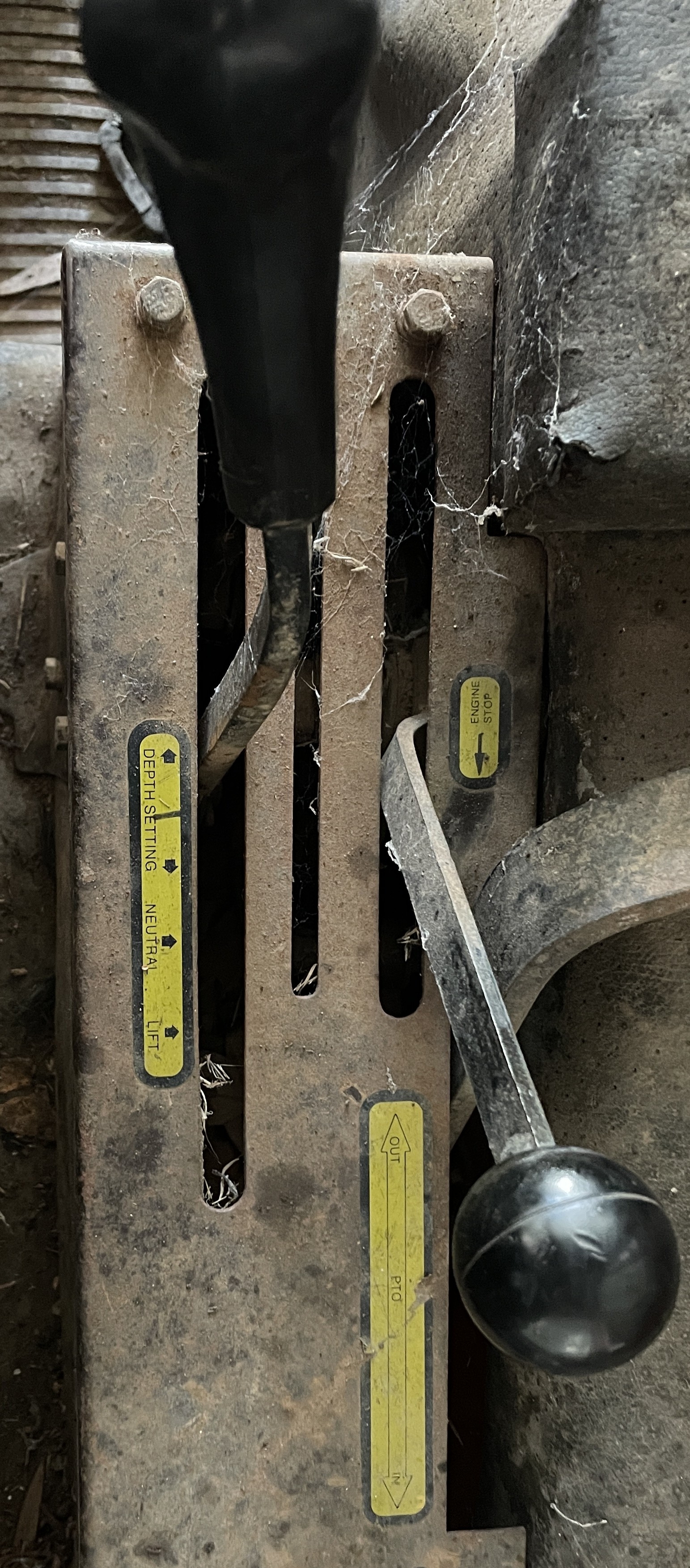

I've made a little progress. I've managed to get the hitch to lift, but only very slowly and at high engine rpm. The hitch will hold in position if I let go of the third lever, but If I let the rpm drop before I let go, the hitch will drop rapidly back down. At this stage I don't know if I've got a dodgy hydraulic pump.
I've also looked closer under the seat.
The placard refers to the knob (1) that controls the PTO. I still am not sure what 2 and 3 are doing. 2 has three positions and 3 is a flip-flop lever.

OK, the little plate/selector with the ball on top is the "position" and "draft" option, at least on the ones I have seen. And I think the small lever to the right controls the speed of the lift...I think.
The PTO setting, if I am guessing correctly, refers to your tractor having both 540 and 1000 RPM capability. Assuming you have both PTO tailshafts, naturally. Now, I think (again) that the crooked vertical rod with bolt head on it would change the gearing internal to the transmission case to use either 540 or 1000 PTO outputs. But some I have seen simply have a long rod sticking horizontally out the side beneath the operator platform to accomplish this (still doing the same thing inside the trans case). I would verify this in a manual before I'd put a bunch of force on that however.
You do not have the set-up I described earlier seen on an eighties tractor in the states. In fact, the inboard lever in your picture should raise and lower the lift unless there is a problem with adjustment or some other remote or control lever position is causing the lift to fight with it. One other thing to check is the dipstick on the hydraulic tank. It only holds about five gallons - doesn't take much of a leak to get low... And the hydraulic filter is under the tank top cover - definitely check that if having flow problems. Matter of fact, I would take out the drain plug on the tank and change out the fluid anyway since this tractor is new to you.
The Russian hydraulic pump at the rear of the engine is robust. If you want to check function for sure, make up a coupler with a hydraulic gauge to plug into one of the hydraulic ports and activate the hydraulic circuit. Should read something like 2200-2600 PSI. But don't stand in front of the port when you do that since you might be creating a dangerous missile if the coupler is not fully seated. Be careful, or if unsure, ask a mechanic to do it.
