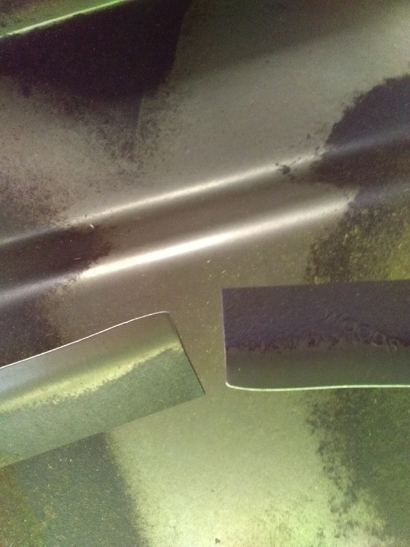

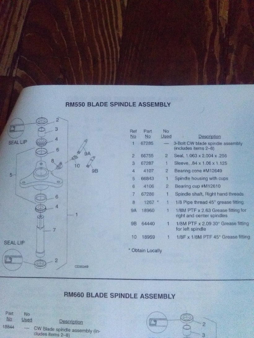

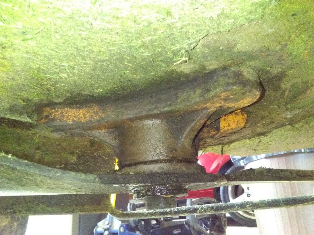

Thank you all for looking at this and offering so much input. Sandman/Smokey - attaching the spindle assembly diagram in case it helps. Is there something I would look for externally or would it be wobbly or making a sound if there was an internal issue with the spindle? I'll try to get the belt off at some point this week and see if everything is still spinning smoothly; it is a spring tensioner so I can't adjust the tension. I can move the belt quite a bit (see pictures) but not sure what is normal - I know the tensioner is tight enough to make it a pain to get the belt back on!

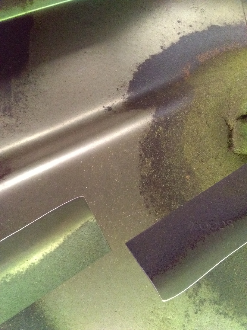

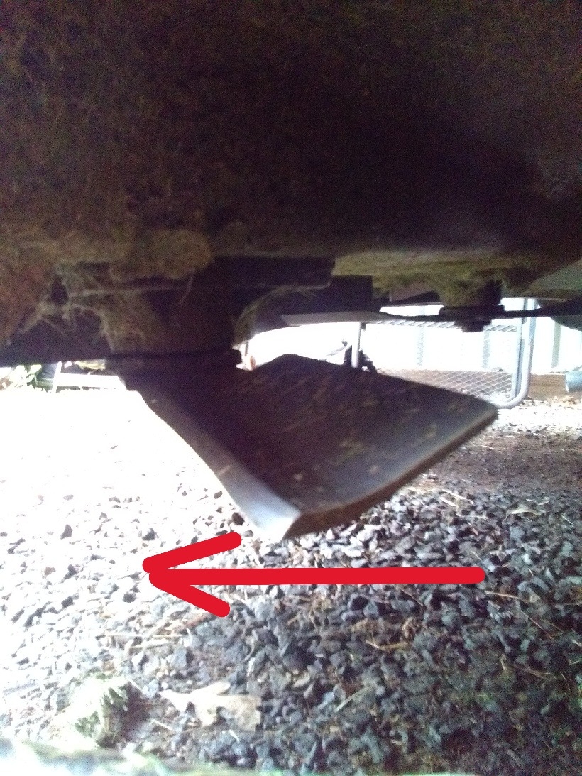

Sixdogs - I think the blades are on correct - the spindles spin clockwise and I attached another picture showing which way the blade spins. Let me know if I'm wrong though.

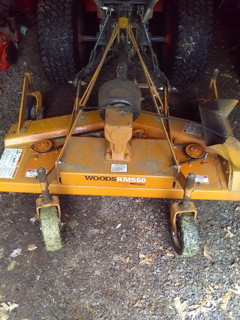

Eco - I think everything looks pretty straight - attached another picture of the mower for reference and nothing looks too far off to me?
Jaygyver - I'll clean the spindle and see if anything looks out of sorts under there and will get some more blade measurements and report back. Will also check blade bolt tightness. And I agree, I've spent many hours trying to figure out how the mower is managing to cut like this and it has me stumped.

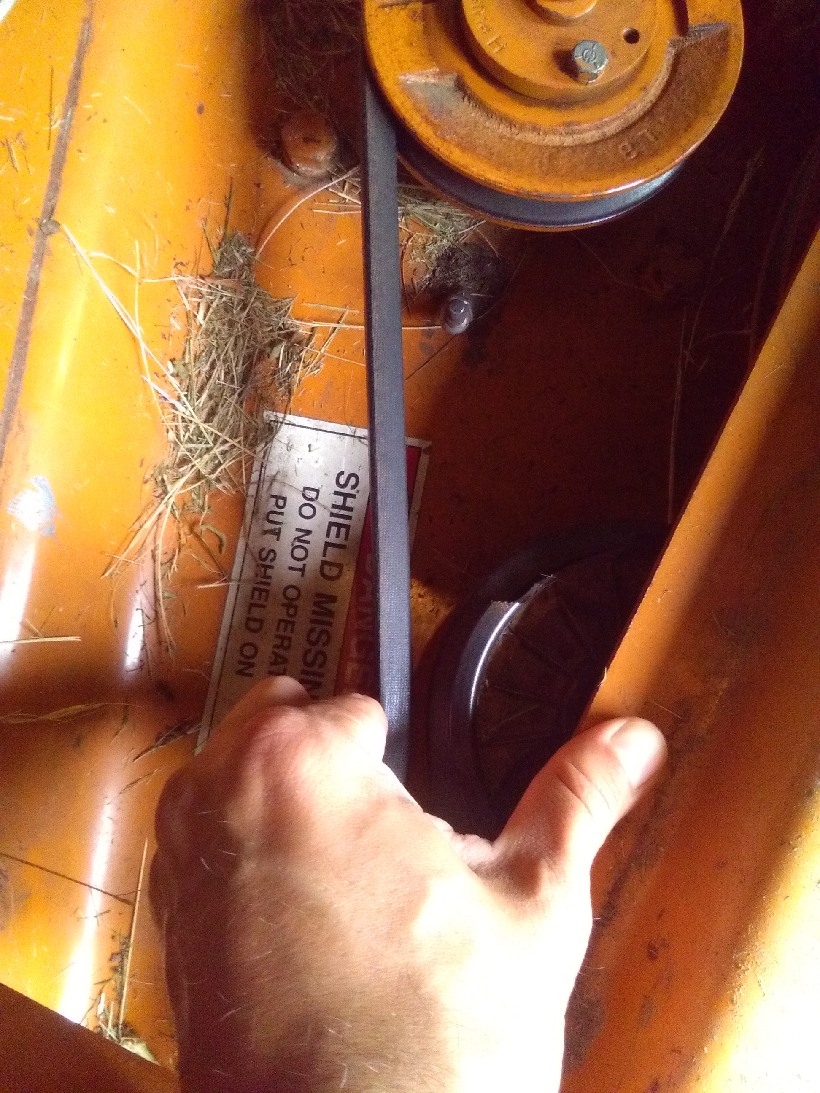

I vote for a slipping drive belt. Either the belt is shot, or the tensioner is weak, or both. Get a can of Belt Grip and apply liberally. Go mow and see if there is a difference. The pitch (whine) of the deck at 540 should remain the same at no load and under load.

When you pull the belt off to inspect its condition, note the exact position of the idler pulley that is spring loaded. Make sure that pulley with spring isn't at its maximum travel point. Consider adding another spring to help the original pull the belt tight (and keep it tight!!) just to see if belt loosening during mowing is the issue.
If the belt looks good, consider changing it out anyway. Keep the old one as a spare. Just a cheap and easy way to double check a worn belt, to see if that makes a difference. Belts are good at hiding their shortcomings.

My first thought when seeing the picture of your mower was it's put together backwards, lol. Most woods mowers ive seen, and my 990, the flat side is the front which makes the angled or v side of the deck the back. 550s seem to be the opposite tho, from pics I found.

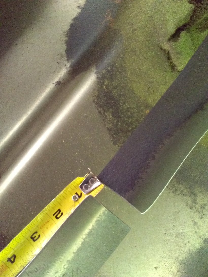

Took additional height measurements of the right blade with it positioned side-to-side instead of front-to-back and the outside height was 3.75" and the inside height was 3.25" - is that a concern? Attached are some pictures of the spindle housing underneath the mower - I didn't see anything alarming.
I guess we've determined there is some slipping based on the 'mark the spindle' test but the question I have is if the belt is slipping and that is what is causing this issue, why would it only be missing grass on half the width of the blade? If slipping was the issue, it seems like it would miss grass the entire width of the blade.
I put a brand new Woods belt on it a while back and it did not fix the issue so if it is in fact slipping, I'm thinking it is likely a tension issue. I can check where the tensioner pulley travel is. Sandman, are you suggesting adding another full-size spring to the tensioner or hooking a smaller spring onto the existing spring to help it out. For what it's worth, I did have two tractor repair guys look at this thing and neither said the belt tension seemed loose.
Is there a decent aftermarket belt out there? Hoping not to have to drop a hundred bucks on another Woods belt.
Trying to think outside the box here - if I go through heavy grass, it will miss on the left side of the right blade and also the left side of the left blade (the forward swipe of the blade). The section it misses looks to be in line with the left side of each rear tire. Could the weight distribution on the rear tires be off somehow, applying excess weight to the left side of the tire and mashing down the grass? Nothing looks off and, as I said, high suction blades didn't help the issue so I'm thinking this is not the problem - just throwing it out there.

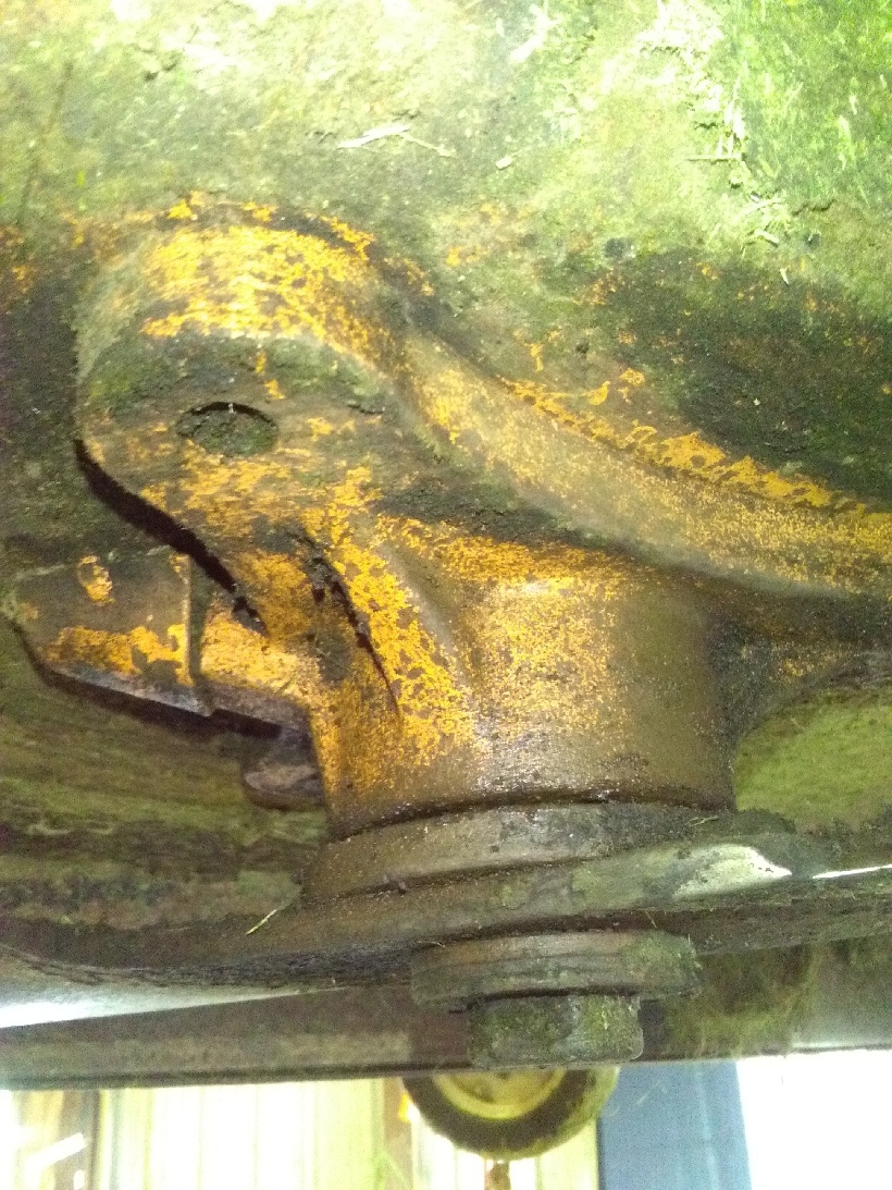

I did exchange emails with Woods a while back and their feedback was to make sure the cupped washers were still cupped; if not, they could be allowing the blade to slip on the spindle. The blades are on there so tightly, I can't see how they could possibly be slipping on the spindle. Plus, my question with any kind of slippage is, if the blades are slipping on the spindle, why would it just be missing grass on half the blade and not the whole width of the blade? Maybe it is worth replacing the washers just in case.
They also said it just looked like the mower was having trouble picking up the grass the tires ran over and to slow my mowing speed. If that was the case, I figure high-suction blades would fix the issue but they didn't. As it sits, I can get a decent cut if I travel super slow, like a quarter MPH, but that's just not normal.

Judging solely on the two images you were so kind
in uploading to the forum for us to look at it appears
to me that one arbor/spindle appears to have only 2
flat washers and the other arbor/spindle has three flat washers.
If you are not using a torque wrench and blue Loctite
to secure the bolt for the arbor/spindle and a heavy
block of wood to keep the blade from spinning it will slip,
been there done that with the heavy welded 4 caster
Wheel Horse mower decks.
If the compression washers are flat they have lost their
ability to maintain the compression strength to hold the
mower blades in place.
I would suggest to you that you invest in spare compression
washers, a high quality torque wrench and a bottle of blue Loctite
to secure the arbor/spindle bolts and a 4" by 4" or 6" by 6" block of
wood to hold the blades in place.
