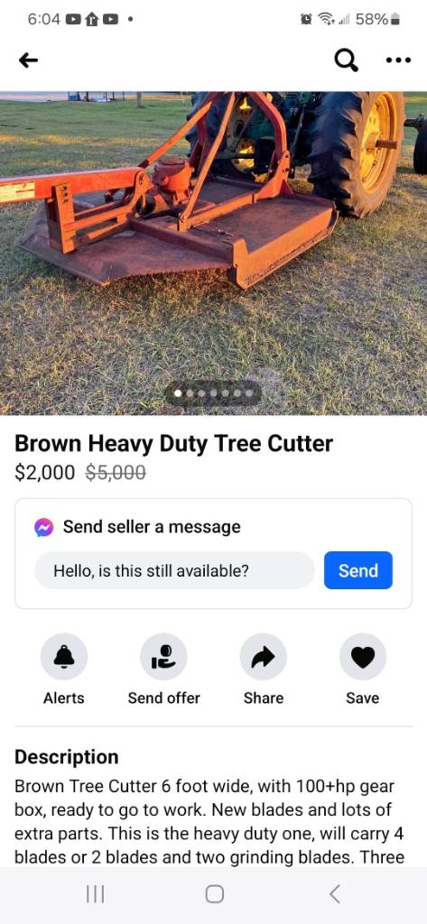

Where is the best place to find used implements in Georgia?
I don't have a truck, but like you said if I can save $1k it's worth making a friend who has one.
Facebook market place is where I generally LOOK for used equipment. You can get some good deals if you are patient. Lots of junk and some scams too, but generally the real deals can be found.
Facebook Market place. Middle Georgia and SW Georgia have a lot of older stuff available. Not so much North or South East-Coastal Georgia.
Somethings, like a Box Blade, it looks like it's in one piece, it is fine; no moving parts. A plow or disk, pretty similar, although bearings in a disc can and do go bad, and they aren't really that cheap when you replace 12 or 16. Bushhogs, the gear box costs as much to replace as the whole impliment, so, you definitely want to check that everything spins freely, and blades and deck are in OK condition. Flail mowers, the teeth/hammers/blades aren't expensive, until you look at ordering 60 of them, then $4.50 a piece adds up; the biggest issue for a flail mower, is that the mail axle/drum/shaft part isn't bent or out of balance, and the gear box as well.
Tillers, honestly, it same, gear box, and rotating assembly, and no missing, or broken paddles.
