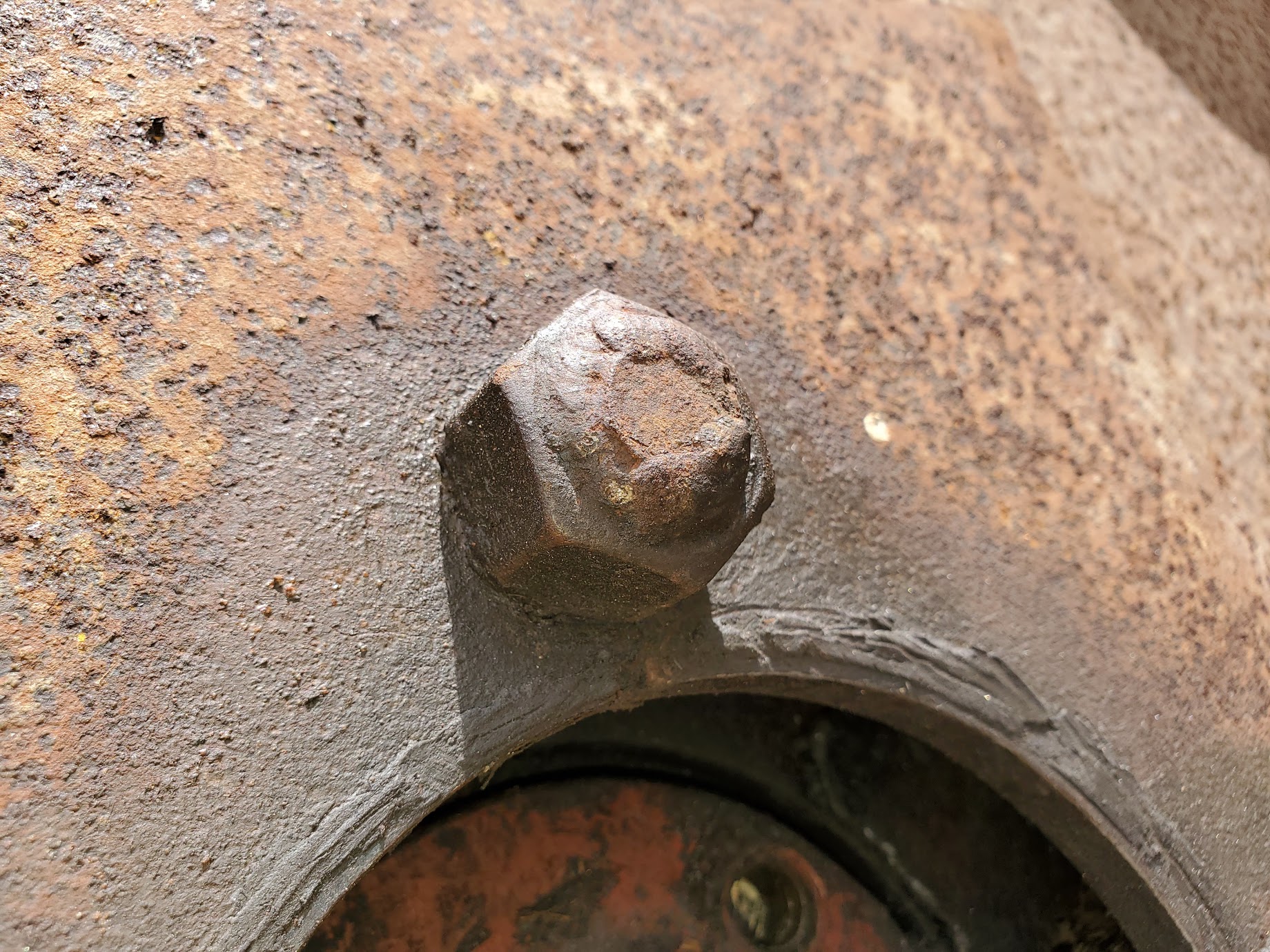

I couldn't get the plate off the bottom of the rotary cutter gearbox due to it being recessed with very little clearance on the sides of the plate. At first glance, I thought that the protruding threads were beat up under the cutter but I saw, after I ground one completely off, that it was actually welded. :laughing:
It took finding a second set of hands but I got three of the four bolts off. One of them obliterated the threads. It took a lot of penetrating oil, and about 1500 ft*lbs to get the nuts off due to all the rust/corrosion. I'm not sure if you can call a piece of all-thread with a nut welded to the end a bolt but I will. I probably need to replace those bolts as I don't have taps/dies to clean them up, I didn't measure diameter but they have 1-1/4" hex heads. Going to pull the gearbox as soon as I get a helper back out there..

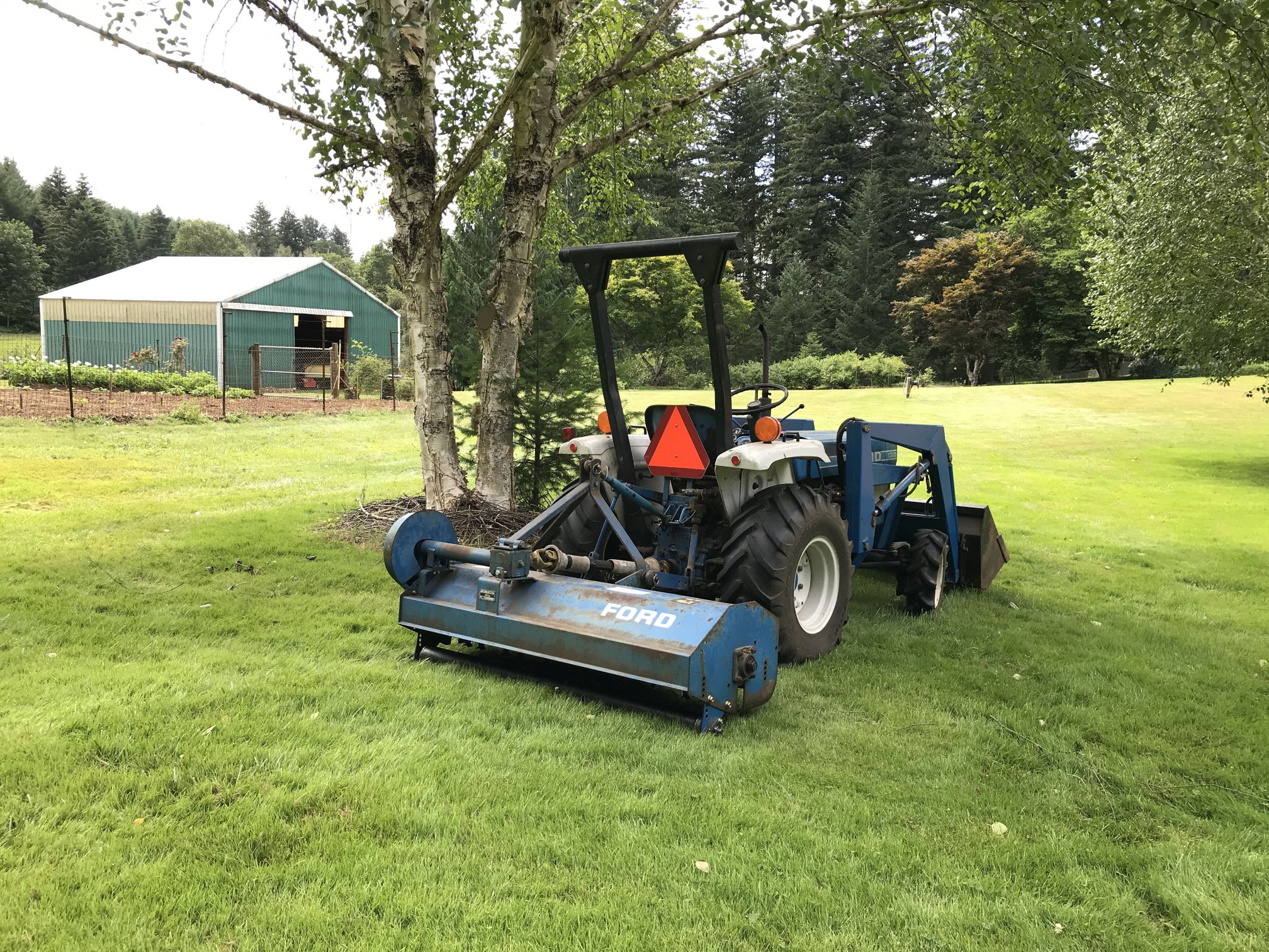

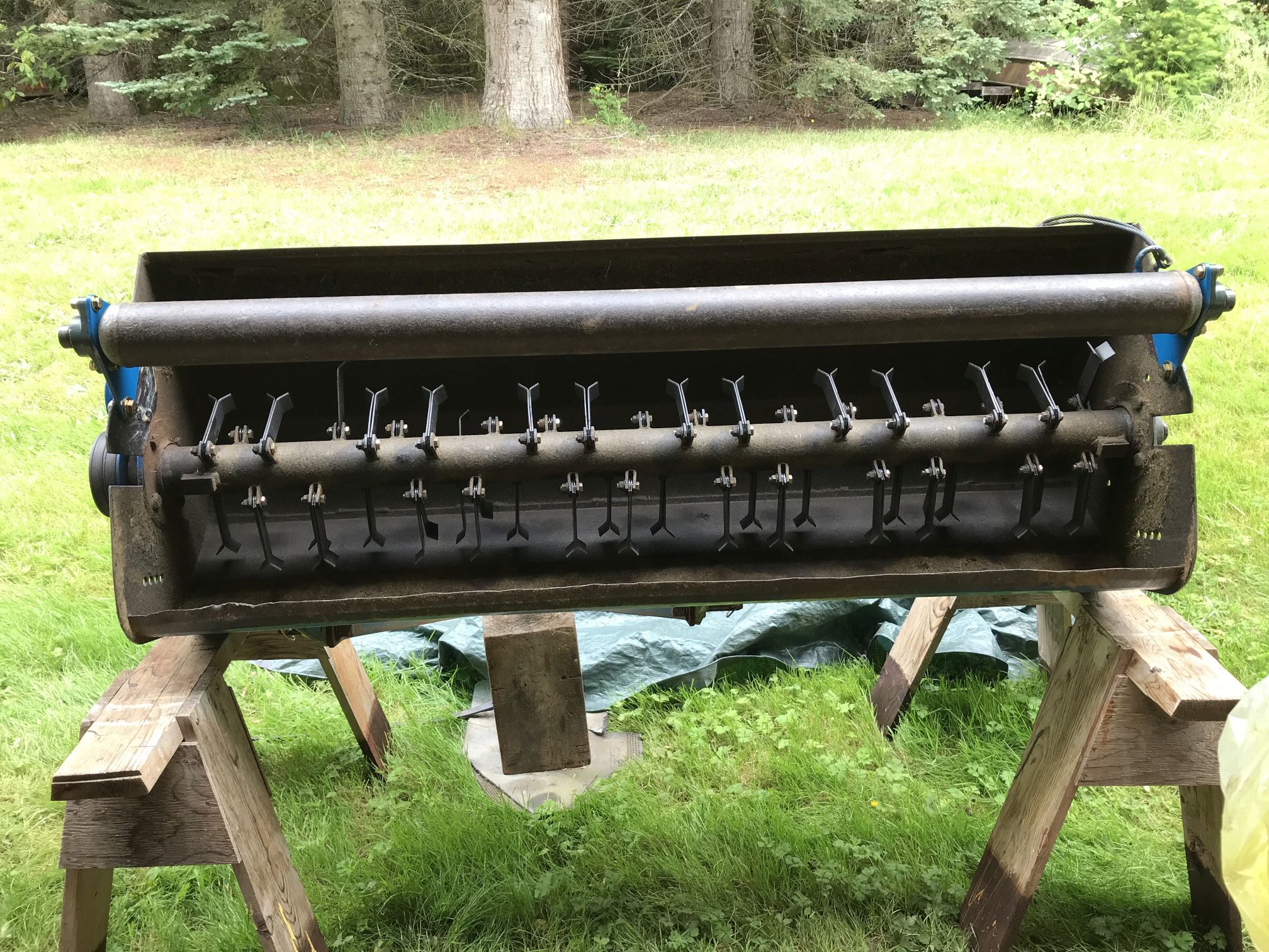

Ford 917L (60 inch cut) flail mower is a nice fit with my Ford 1310 (19 HP engine, manual transmission) and in 2 - 2.5 foot tall grass it uses clearly less power than my 48 inch John Deere brush hog rotary mower.
917L is a light duty mower and was intended for side slicer flails as shown in my photo below.

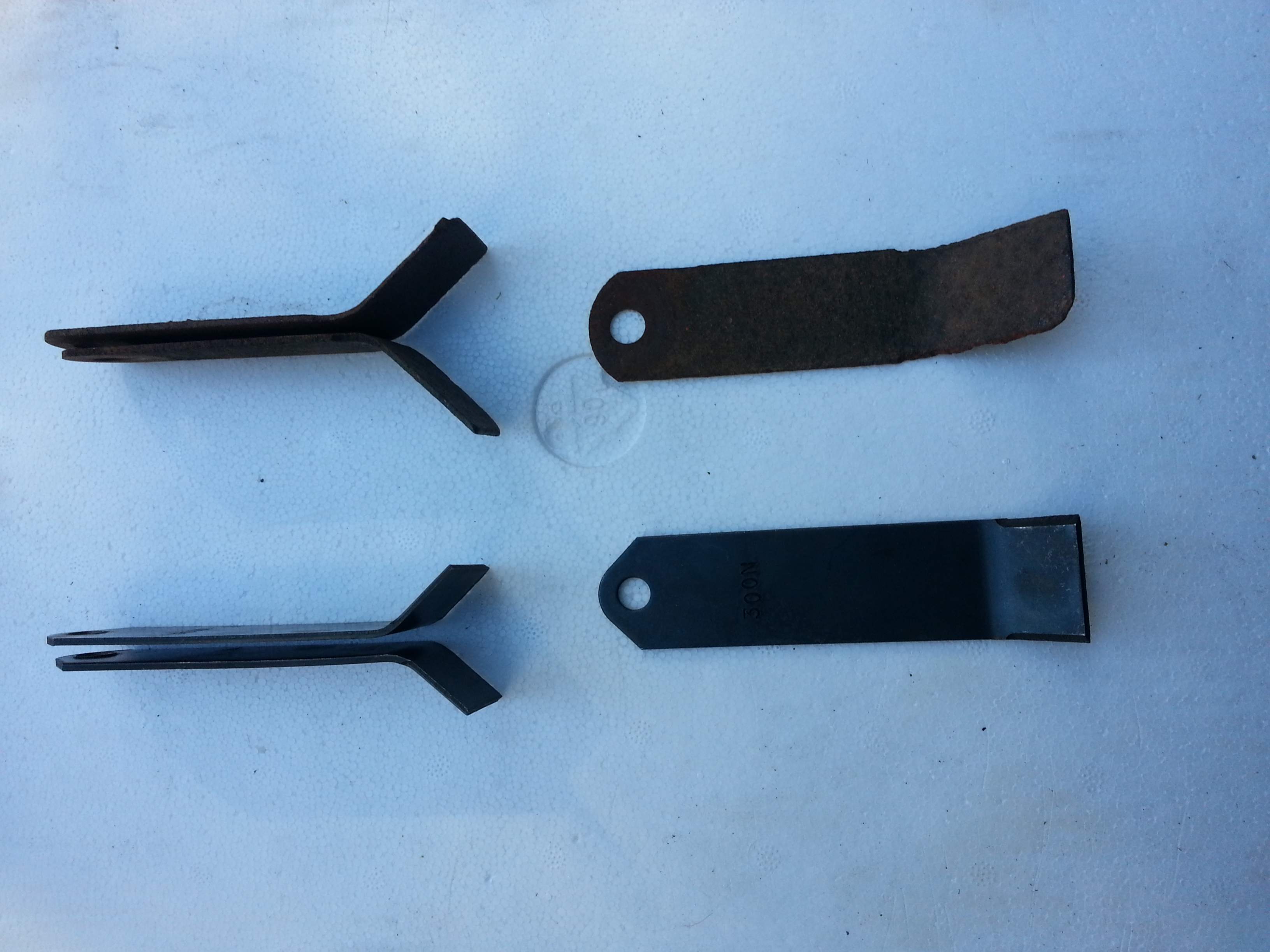

Alamo/Mott MH386 flails can be used for replacements.
Mowers with other type or style flails would most likely require more HP.

New Holland CNH 86509415 vs. Alamo/Mott MH386 replacement flails:
