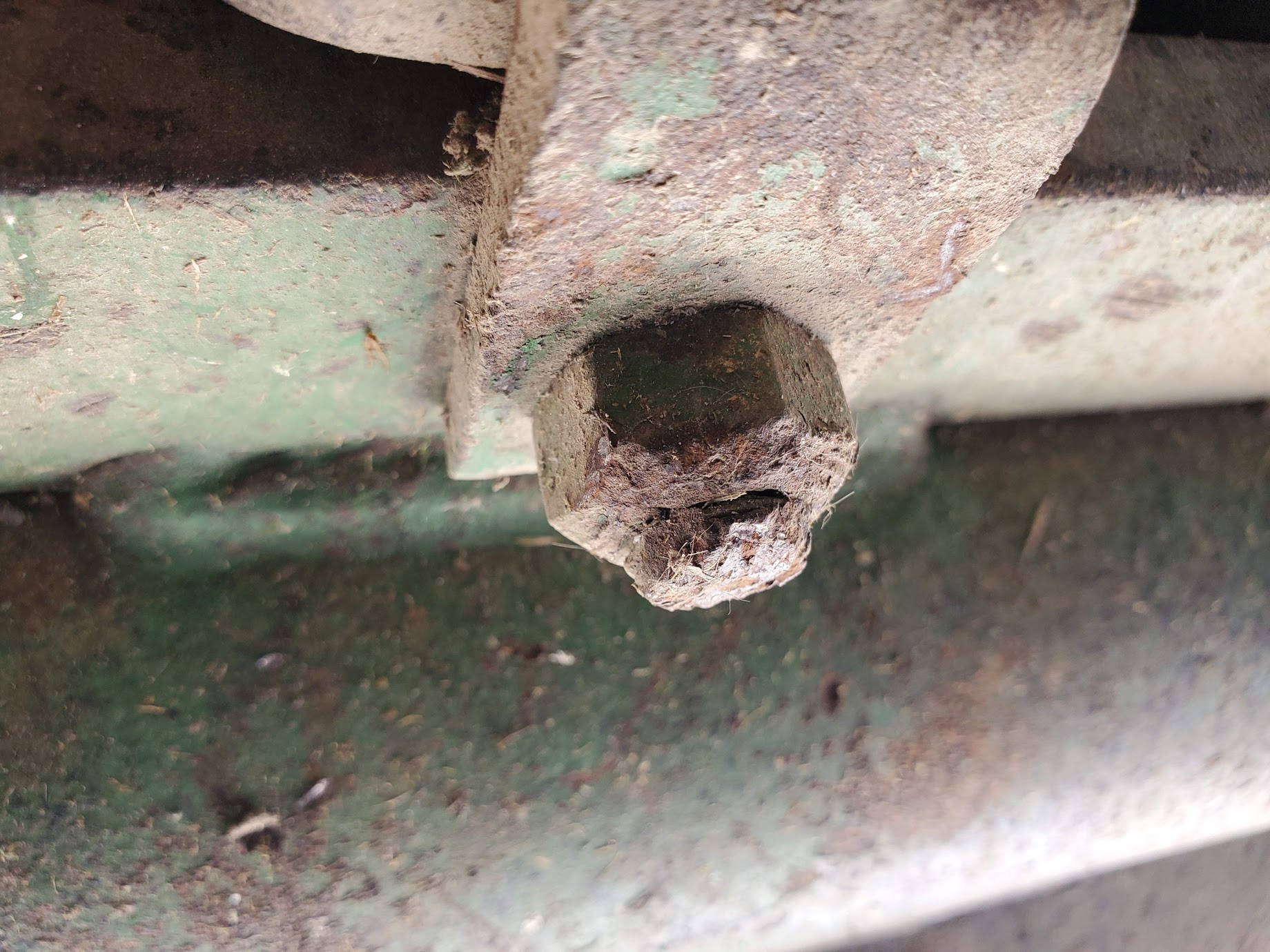

Also, flipping the knives around on the flail was a real PIA. Basically, the protruding part of the bolt was beaten up and had to be ground off before I could take the nuts off the bolts. They were pretty bad. Super time consuming..

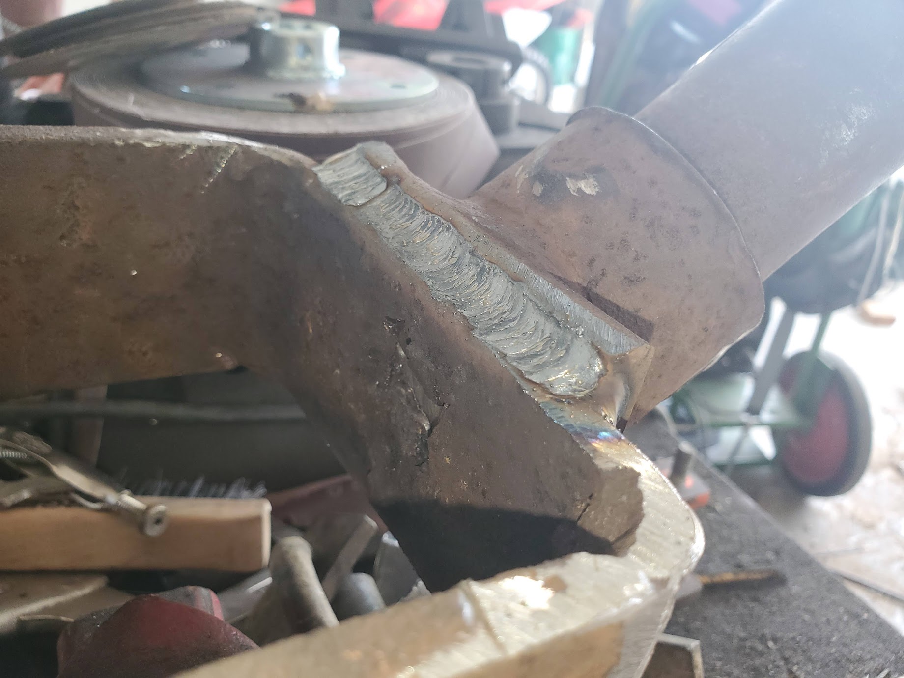

Good looking weld.
My mower had pins with cotter keys. A lot easier to take apart and a lot cheaper if you have to replace a few.

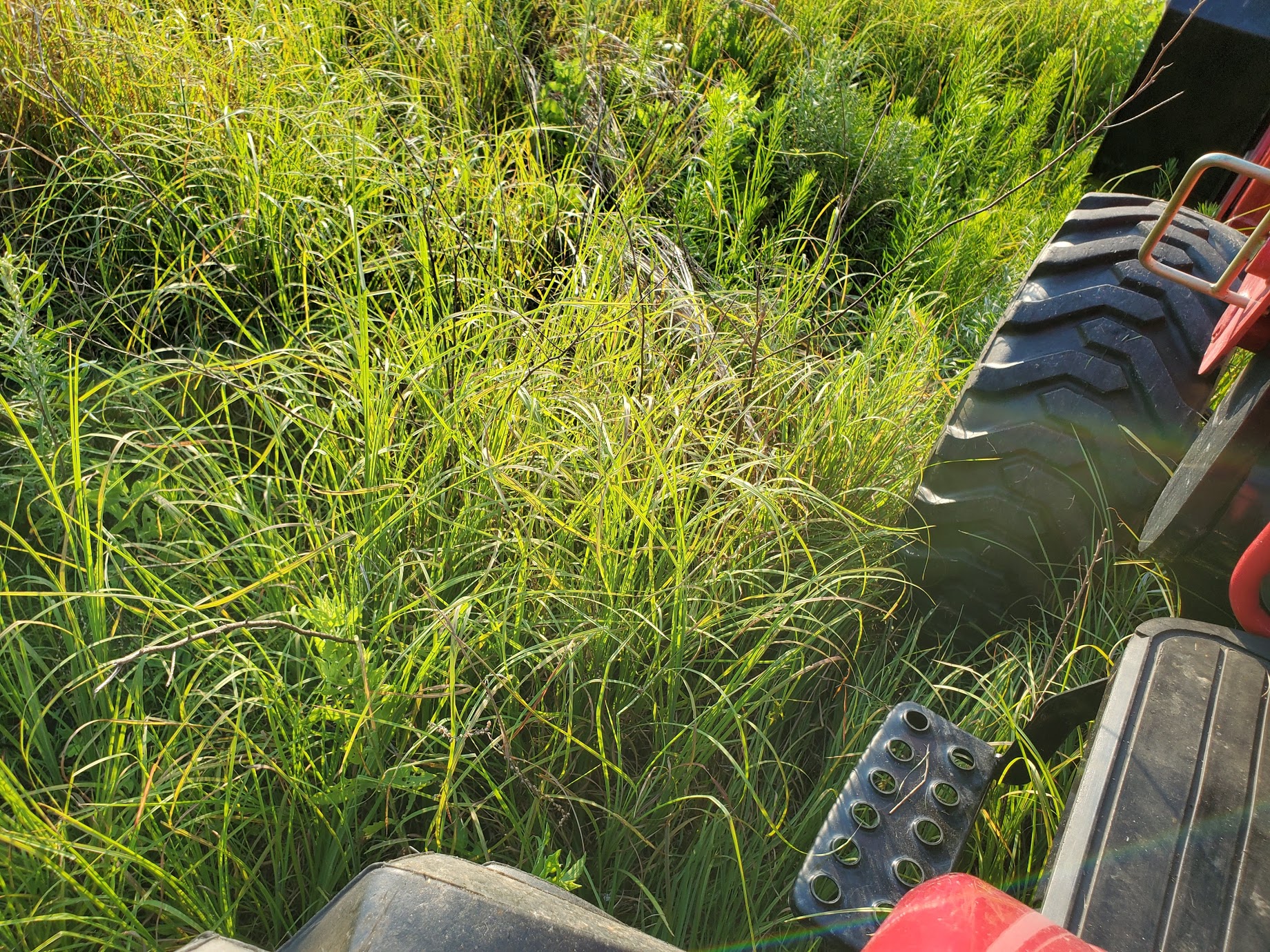

The thickest stuff on my property, it is some kind of grass that only grows in one area, I had to cut in M-2. Interestingly, the belt starts chirping the same time the tractor starts dropping RPM. I've got a replacement belt and replacement bearings coming this week for spares.
Some of the stuff I cut really should have been done with the rotary, I felt bad hitting some of the saplings and hearing the blades clanking all around. Should have left all saplings for the rotary and grass/weeds for the flail. Just to conserve them knives..
One last thought - I had a conversation with a guy once who was trying to sandblast an old jeep which had been coated in that rubber undercoat paint. He said that he had the hardest time getting the stuff off, that it was a perfect storm for the sandblaster. Would it make sense to rubber coat high wear areas under the cutter to protect the steel? I have a LOT of sand where I'm at and it is going to be years before I get grass to cover it all up.
BTW, this is the stuff that was giving it a fit -

Aw, that stuff is for sisssy flail mowers. My grass and weeds are much thicker and taller and interspersed with Buick hubcaps, logs, DeSoto hood parts and the occasional B&S lawn mower engine. My M-F has about 36 PTO HP running a Chicomm 60 flail with hammers. In the thick stuff, I sometimes need to run in the lowest gear I have in the gearbox. But, the flail makes mulch out of most anything in its path.
