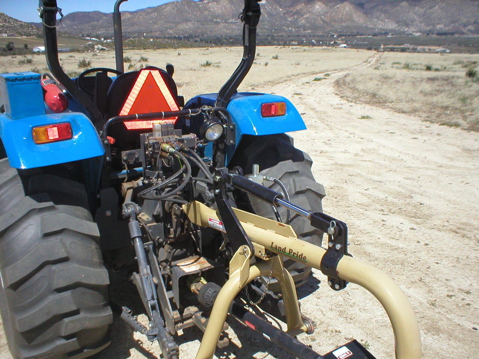

I somewhat regret having gotten a 3pt post hole digger - I'm also in the NorCal foothills though possibly higher elevation than you; half the year the phd won't dig at all. Hydraulic ssqa augers come up all the time at auction (eg Hibid) and go for less than you're likely to spend on the 3ph version. Won't be a rocket with the CUT's flow rate but it'll be sufficient (when I do use my 3ph auger, I'm usually at slightly above idle), and being able to push down would be a game-changer. YMMV, of course; I have this ridiculous clay but if you're loam then the 3ph will be fine.

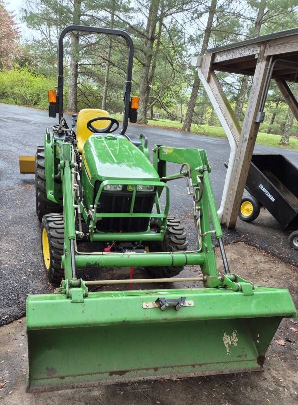

I helped a friend buy a used tractor last summer. I found a JD3038E with about 900 hrs on it. FEL and Box scraper. We added 2 rear remotes.
He loves it. Handles his mowing, grading, road maintenance, and tree work well on his hilly property.
I ran it some when it first arrived. I'm 6 ft tall and I found it cramped. He's smaller so that's okay. He says the loader does not lift much.
We paid less than half the new price and he loves it.

Not to get the thread sidetracked, but get a down pressure kit for your 3pt PHD and your digging issues will disappear.

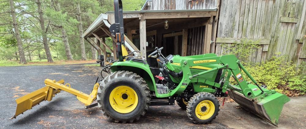

I have a 2017 3038e I bought new, now has 400 hours on it.
The 3039R has a lift capacity of 2194 lbs compared to the 3038E's 1356 lbs so if that's a concern I'd go with the R. I put an AG module on it so now it's around 50 hp and I boosted hydraulic pressure a bit also.
The R is about $5K higher than the E.
I've been very happy with mine and have lots of attachments. I bought mine with a 9.5 ft backhoe, bush hog and Danuser auger.
My place is hilly but in Virginia.
For me it's worked well.
