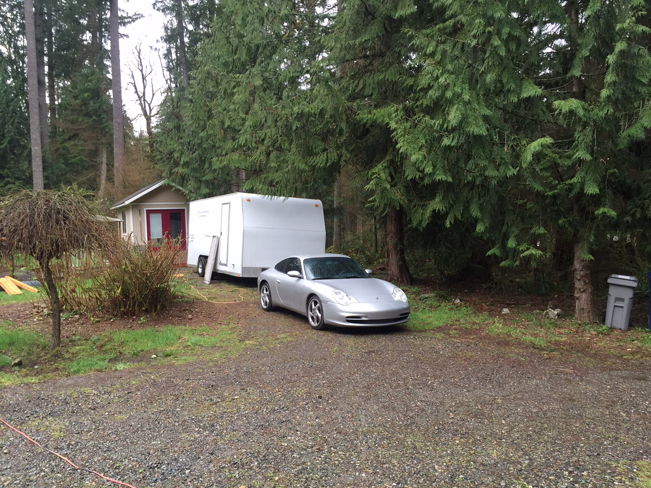

Just got my first tractor; New Holland T1510. Jumping to get going on it! Got five acres heavily wooded, fallen trees & underbrush. Heaven...
Have about a half acre cleared with driveway, parking, etc. Due to the somewhat wet weather here in the great Northwest, it tends to get chewed up pretty quickly. Hence, I need to get an attachment for the tractor to refinish the drive / parking areas frequently. "She" is skeptical of course, but I have to park my 911 out there.
So, box blade scraper or rear grading blade? Tractor has 30 hp to pull with...

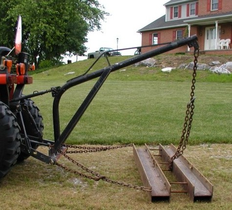

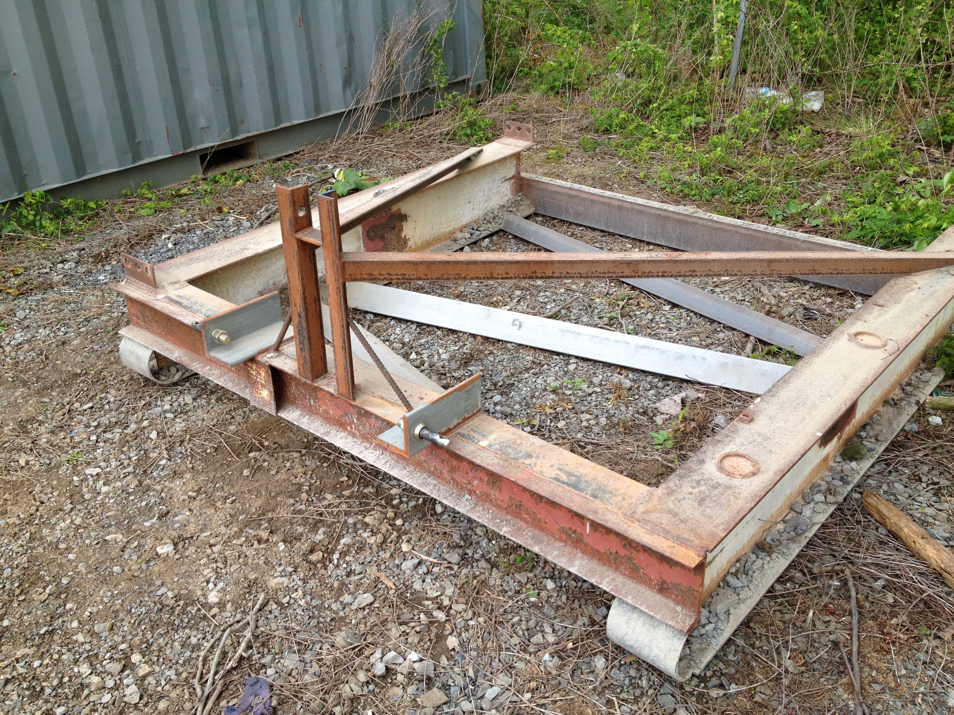

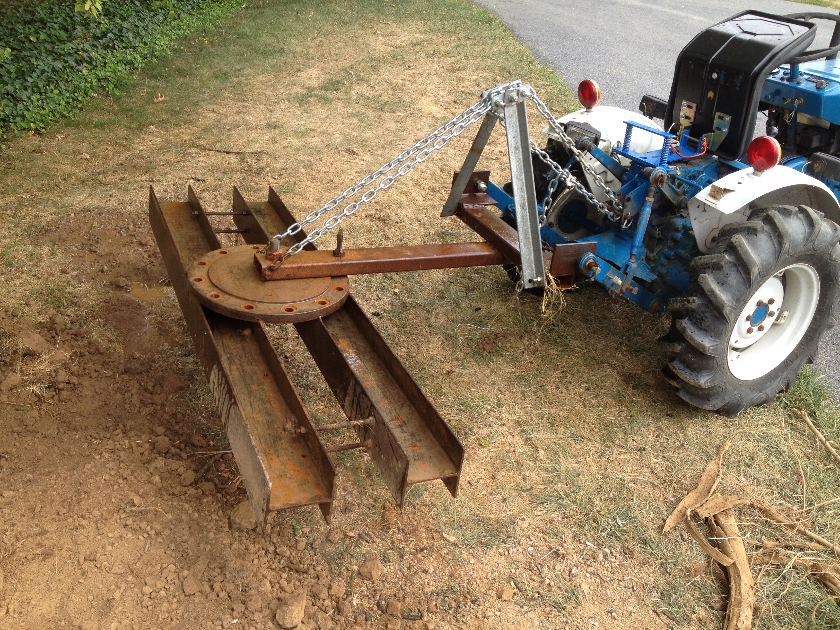

I had a project that involved leveling and redistributing a fair amount of material. I bought a used box scraper, did the project and sold it for what I paid the previous year. It would have done OK at fixing gravel driveways but something like the homebrew "landplanes" below work better for me.
The big large one is used at work. We have a lot of gravel areas to take care of. I recently had the guys shorten it because I was concerned about the stress being put on the Montana's topling attachment point.
The smaller one is used at home. It started life as a more cumbersome piece that required using it chained to my boom pole. One day I saw the big rusty blind flange wasting away on a pile at work and thought it could be put to good use.

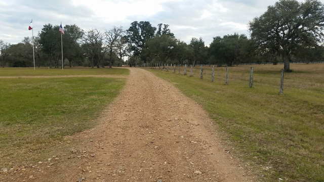

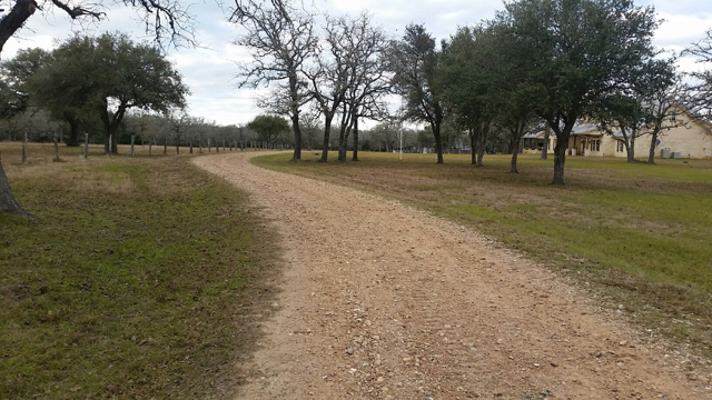

I have three implements that I've used for maintenance of my mile long gravel driveway. Land Pride RB3596(rear blade), Bush Hog RO720(roll over box blade) & Land Pride GS2584(Land Plane Grading Scraper). The rear blade is great for snow removal in the winter and rates a zero for summer driveway maintenance - too light at only 565 pounds. The ROBB is great for moving larger amounts of material on & around the driveway. The LPGS is great for smoothing & top dragging the driveway when I'm done with all the other fooling around. Both the ROBB & the LPGS have scarifiers if and when I need to repair big potholes.
I have found that a hydraulic top link is also a fantastic addition for dirt engagement implements. It allows me to make adjustments "on the fly" without having to start/stop/adjust so very many times to obtain the correct "angle of attack". Now, with this hyd top link, I can acheive the correct adjustment and not the - "well, that looks good enough" position, after many tries.

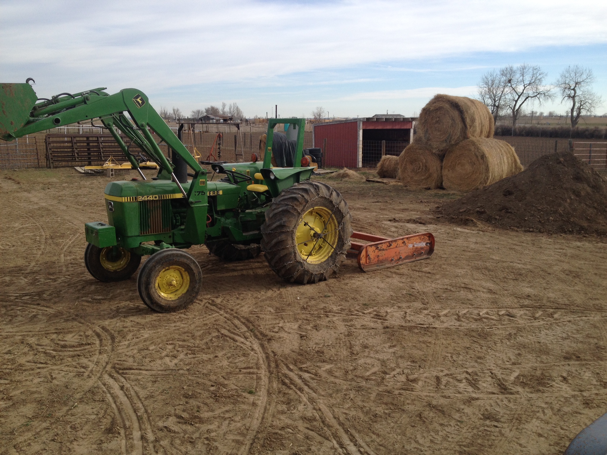

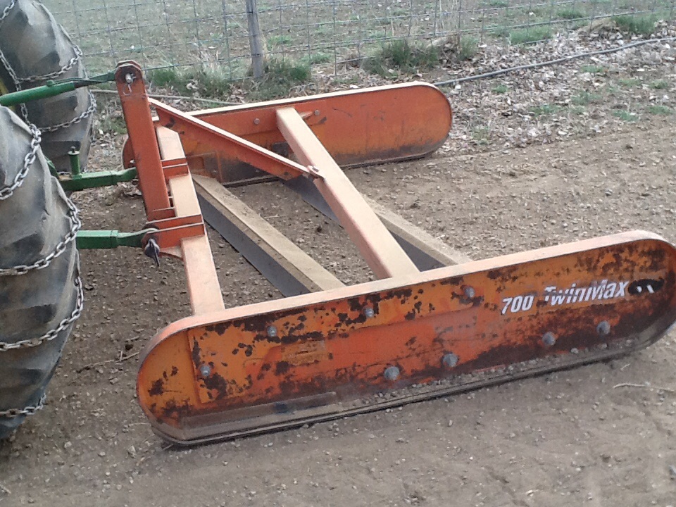

I maintain a shared access driveway and just used land plane to smooth winter ruts and dips.
I rented this one for $75/day - you might check rental places so you can test drive some of these - land plane vs box blade vs scraper.
I don't have a box blade but it is on my wish list and will be joining the horde of pulltoys.
/ Box Blade or Rear Grader Blade? #14

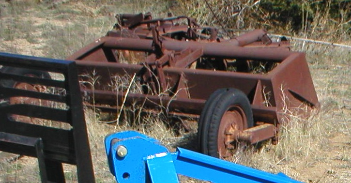

Brian,
This attracted my attention. Got it working yet?
We used to have about an 8 foot one but it was only used for touch-up work on flood irrigated land. No roads to maintain. I'd like to hear your experience using it on your roads compared to the other implements.
Bruce
/ Box Blade or Rear Grader Blade? #15
Brian,
Bruce
Bruce, we have never used it. Got it with a bunch of other stuff and it sits where it sets for the last 12+ years. Honestly, with all the different implements that I have, there is no reason to spend any time fooling with that particular piece.
