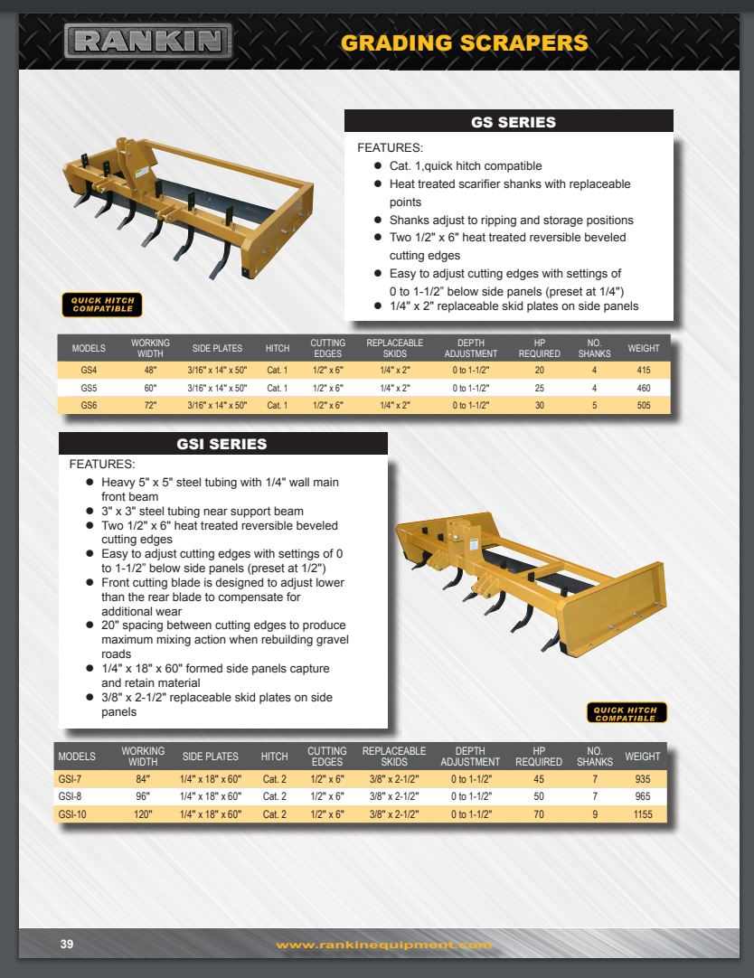

We have no idea how to help yopu with using the blade if we don't know what it looks like. It sounds unconventional to me. I just drop mine on gravel, be it a pile or spread out and drag. If I have bumps etc, I do run the draft control. Running one of these is seriously as easy as falling off a rock.

I guess I must be too dumb to fall off a rock (but then, as a rock climber for years, I guess that must be a good thing).
As per my first post, it's a Rankin Gs-5
Here is their website:

His attachment picture as requested >
It's very similar to the landpride landplane posted in the beginning of the thread. I'm here to tell this implement is not the best option for loose gravel. You would be better off getting some more practice with the boxscraper. Remember with any rear attachment a flat work area under the tires is important. Sometime you have to work backwards to make that flat surface then pull the gravel in over the flattened area. There are tons of videos on you tube showing box blade tips and tricks.

Land planes are great for ruining a freshly spread gravel road. Absolutely worthless on fresh gravel, you can make them slightly less bad by raising the cutting edges or extending your top link to raise the front of the implement.
A box blade with the top link extended to raise the cutting edge slightly above the rear facing edge does a much better job on fresh gravel. Especially if you have a hydraulic side link on your 3 point that you can adjust as you go to mach the angle of the road. Hydraulic top link makes it even better.

I'm late to the party here but wanted to agree with earlier comments to simply adjust the angle with your top link. Set your 3-pt hitch all the way down, then use the top link until the front blade is up off the ground a tiny bit. With less bite on the front blade, you'll pull up far less material but should still do a nice job smoothing with the rear blade.
My 1000' gravel driveway is all loose stone (21A with no fines, a.k.a. 3/4"-minus clean/washed), and my land plane doesn't come anywhere close to overflowing the sides when I pull it down my drive. Maybe you just have too much loose stone on top since it's so fresh. Give it some time driving and mixing with dirt and debris, and it will pack down some and stop overflowing your land plane. Maybe I've just never had this problem because I'm too cheap to buy thousands of dollars of gravel at a time lol.
