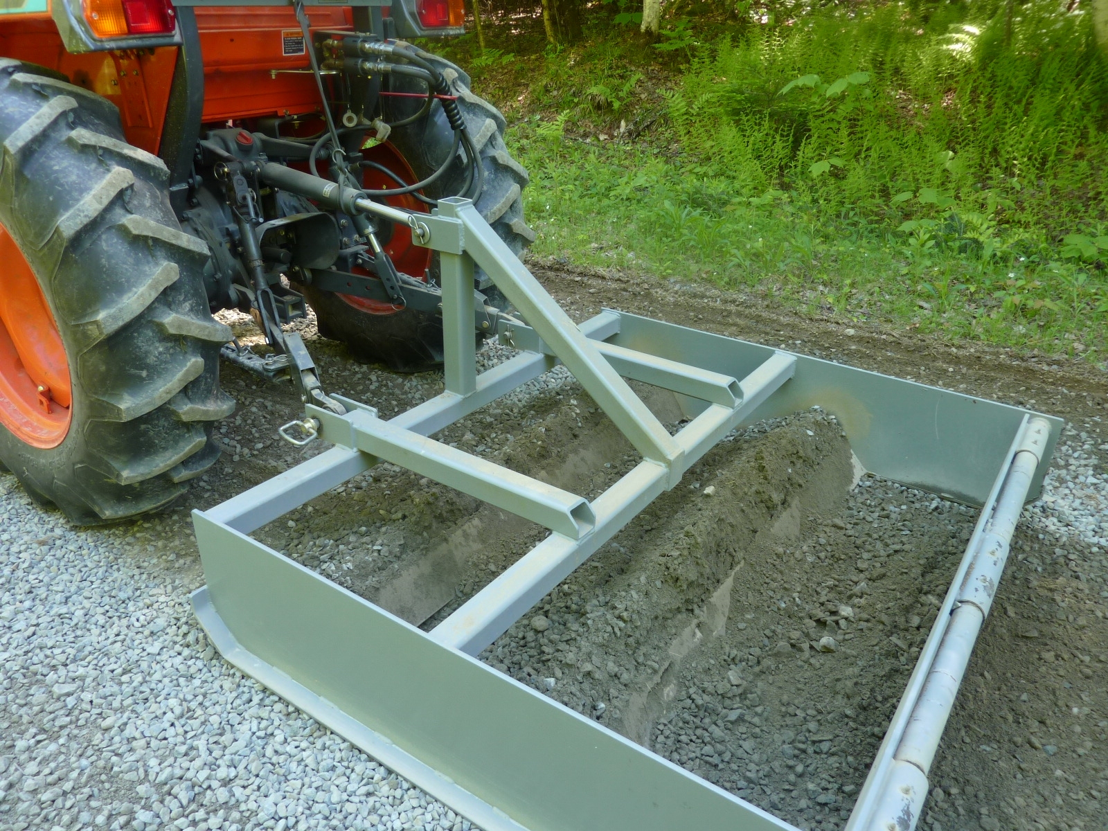

My driveway stays pretty solid after grading with my yard box. i have the to link long enough so the blade is 1" higher than the reverse blade behind it, so the front blade cuts of humps and fills in low spots, then the reverse blade does the dragging and leveling.
It's very easy to recreate the crown by adjusting the leveling link. I would never consider using the scarifier teeth to loosen the solid bed.
