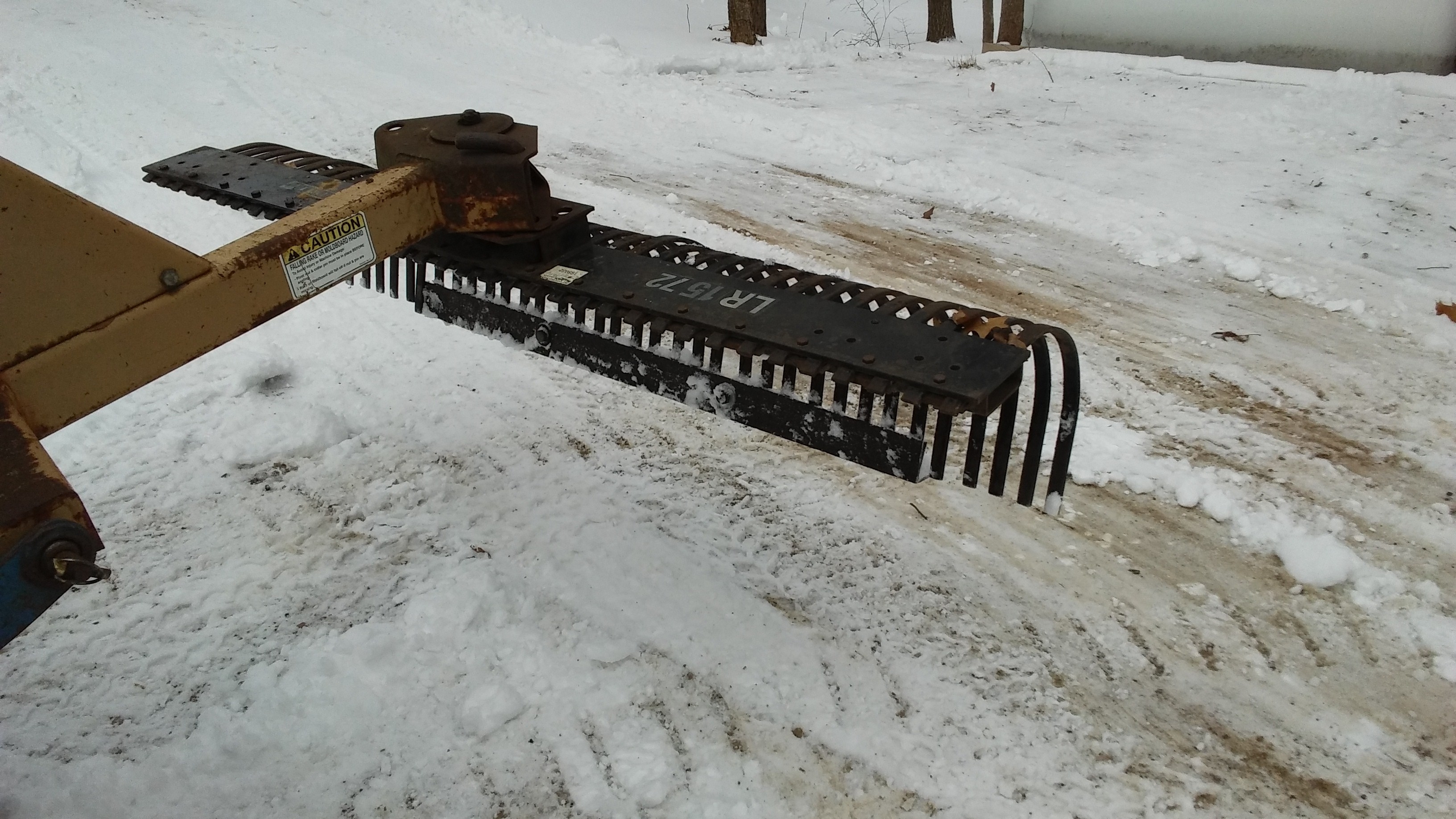

With 1/2 mile gravel drive/private road I tried the PVC pipe and steel conduit.
Neither worked for very long.
I then clamped some 2" angle iron to my york rake & was surprised by the results.
Now I have angle iron bolted to or replacing the cutting edge on front & rear blades.
I can even plow snow from grass areas without tearing it up. York Rake.jpg20201019_124540.jpg

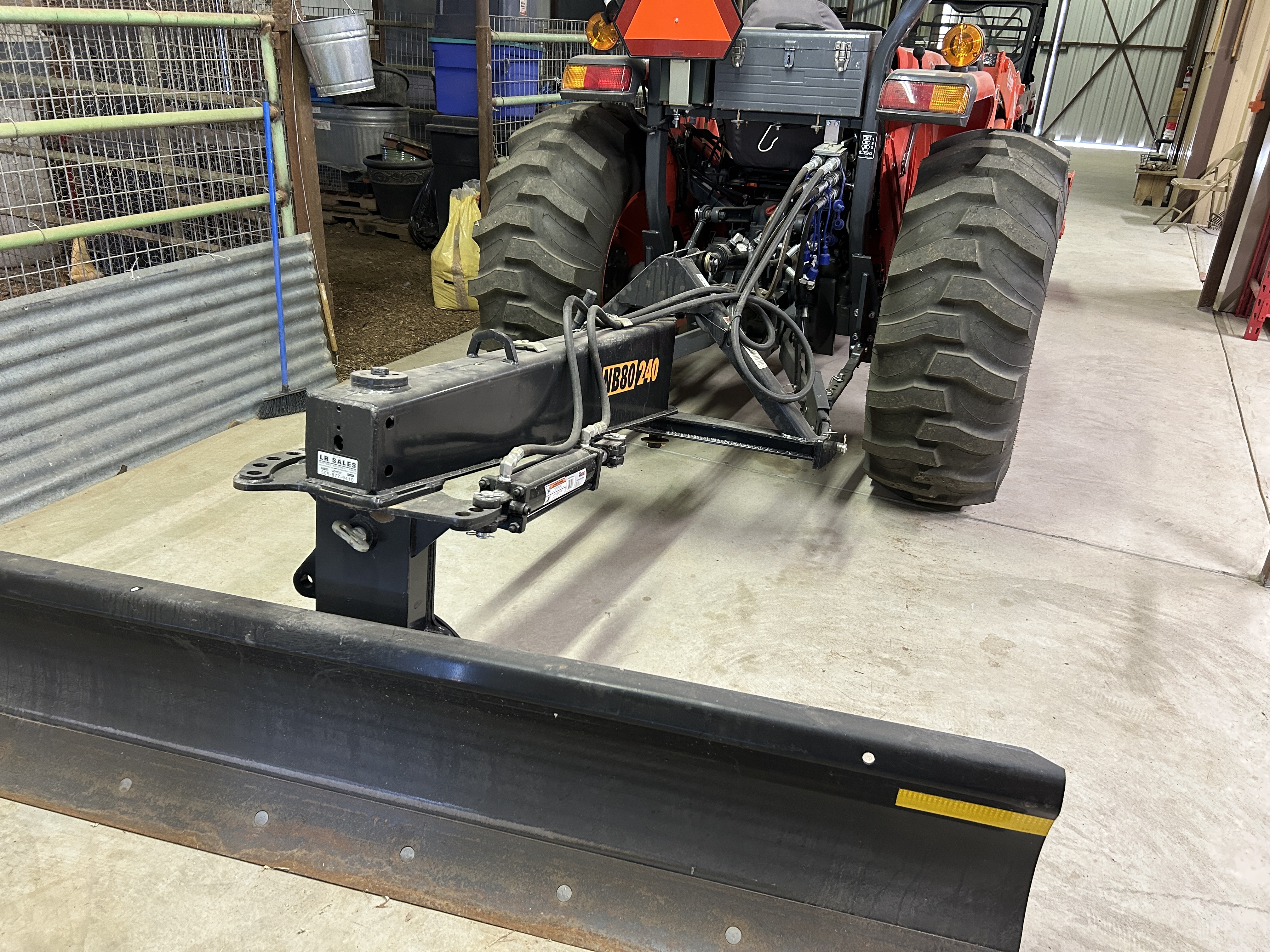

I have a few miles of gravel road that I need to plow - conditions are often soft. It's full of ups and downs, like a roller coaster, so being able to float my rear blade would make life a LOT easier. Turning the blade around does not work well because the rear of the blade is full of uneven edges due to all the reinforcing, so it just gathers snow.
It's a very heavy attachment, probably close to 1,600lbs and I'm hoping the pipe will allow the blade to "glide" over the gravel without digging in and messing it up too much.
I have done just that. I would use a larger pipe. Mine is 4" and I wish it 6". Get the thickest wall you can get. After 8 years of use mine is wearing thin wear it contacts the ground. I had a welding shop cut a slot in the pipe and it fits over the cutting edge on the snow plow. 3 steel straps bolt it to the plow and allow me to attach or remove it. I wish there were covers over the ends as it collects stones and dirt when the blade it angled. Works great to clear snow from my gravel driveway and grass areas with out destroying the sod or pushing all the stone off my driveway.
