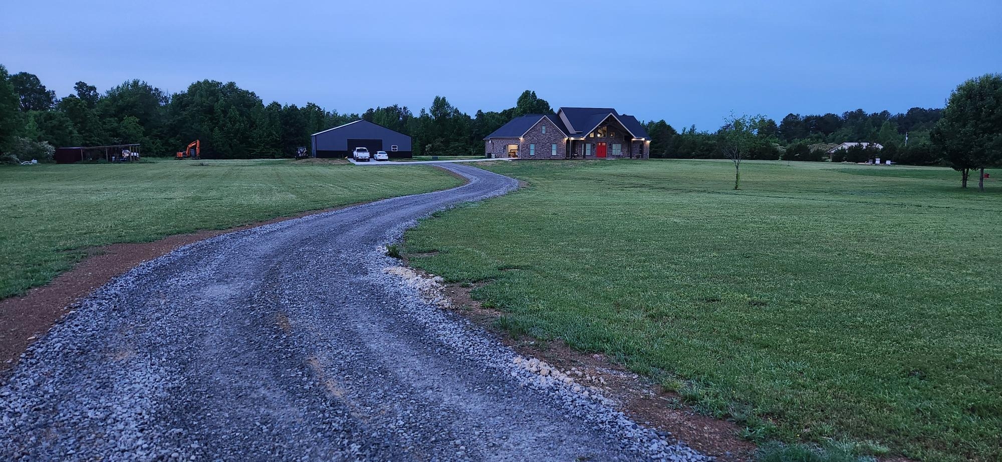

Can we get some more pics of the driveway and property? Maybe even a video of you sloshing your way through it all? :)

Your posting those photos of your driveway helped a lot. Makes it much easier to tell what has a chance of working.

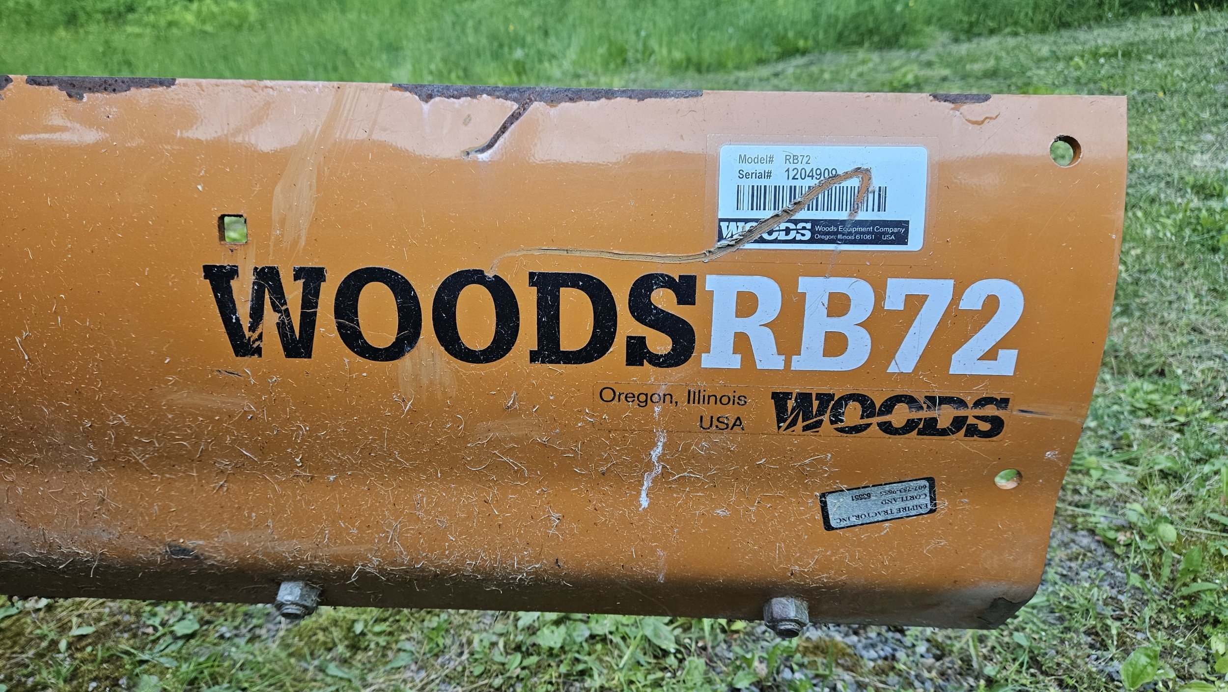

Today I bought a Woods RB72 Rear Blade. It looks pretty neat and for about $700. I tried locating the documentation for it, but Woods only lists RB72.50, which I suspect it is a newer release. I intend to purchase the blade end cap from Messicks, just need to figure out what's going on with their microfiche, something is wrong with the part numbers:
Thanks everyone for the feedback and recommendations. I am very happy and satisfied with the purchase. And glad that a few users highlighted the importance of getting a fully adjustable blade. Here is my new RB72:

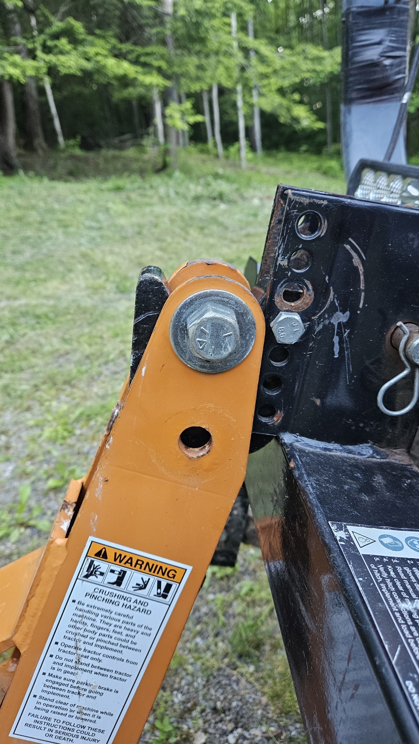

This is my very first time playing with the 3-point hitch and I need to confirm a few things:
1. currently I have NO pins locking the RB to the quick hitch. Is this correct, just locked in place by its 450 lbs?

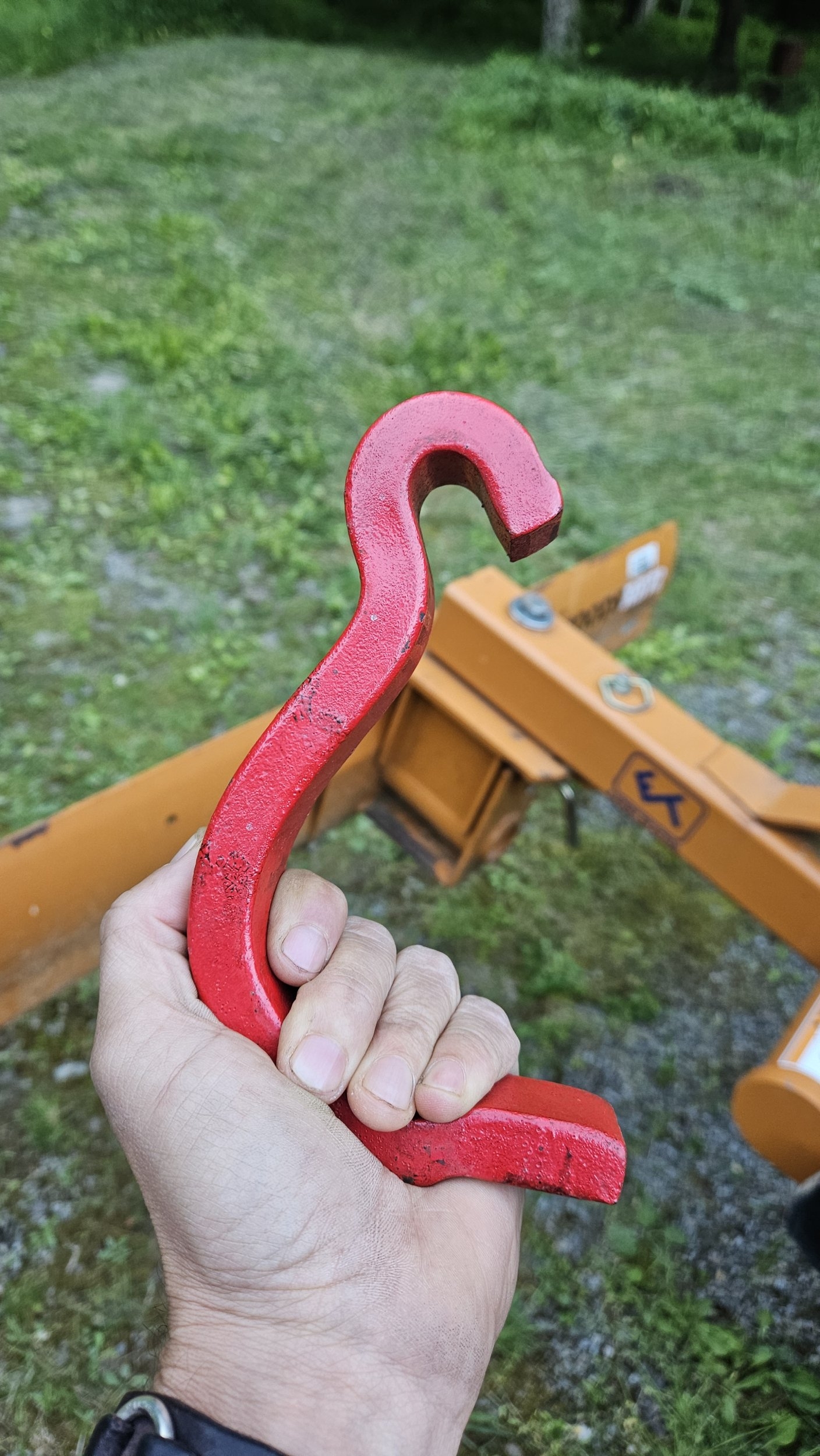

2. It came with a red metal hook that I can't figure out whether even belongs to the blade. Any idea what this could be or where it goes?

The red hook looks exactly like some pieces I've found on old RR beds, just painted; other than that, no idea.
On the pin topic, get 2 (or 4, you'll set them down and loose them) standard snap pins from any farm supply store for the ends of the pins.

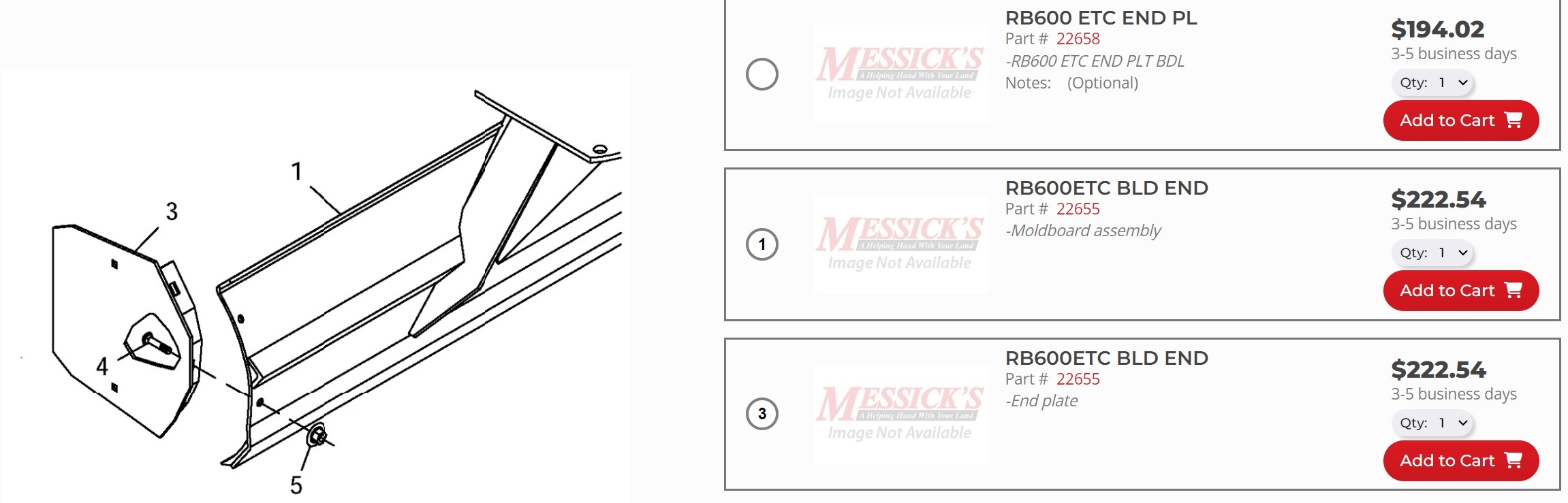

Moldboard end plates; Woods RB72 Rear Blade (Woods) Parts Diagrams
   / [KUBOTA B3200] Grader Blade / Box Blade Recommendation for Driveway Maintenance #110
Here is your parts diagram, it's grouped with the landscape rake two; but the top two diagrams are your blade
   / [KUBOTA B3200] Grader Blade / Box Blade Recommendation for Driveway Maintenance #111
For the end plates; it 'looks' like you need item 3, 4, and 5. I can't tell if item 3 (the actual end plate) comes as a pair or if you need two? For $222.54; I would home that is both ends, but I would call and/or email to confirm if I were you.

Here is the end assembly detail. There is also a skid shoe assembly available, I believe for snow plowing? For the price of those skid shoes, I would only order if you find yourself needing them, they aren't cheap.
Anyways; once you pick up a hand full of hitch pins; play/practice with the new blade to get a feel for it. They do require patience...

"1. currently I have NO pins locking the RB to the quick hitch. Is this correct, just locked in place by its 450 lbs?"
Yes and no; you do need the pins I showed above to prevent it side shifting and falling out. If you haven't used any 3 point attachments; you'll need to play with your top link, right side adjustable link, and your side sway turn buckles. You want to start out with both bottom links equal length (you'll play with this later maybe); the main "beam" roughly parallel to the ground when lowered, which you get my playing with top link length; and some "flex" in the side to side swing; But not much. Maybe 1-2" of total play or so; not locked down solid; but not flopping in the breeze.

I don't use linch pins in those lower implement pins, because the quick hitch spacing between its lower hooks is just wide enough to match the implement and the implement can't shift sideways.
There are sleeves available to bring the implement pins up to the diameter that fits snugly in the quick hitch hooks. I don't use them.
That's 2 less categories of things to fuss with.

That 3pt quick hitch looks like someone put a category 2 size quick hitch onto your category 1 tractor. Is that possible or are all quick hitches that way? I njust use the original 3pt on the tractor, myself.
Anyway, our big tractor is Cat 2. That size is made for larger tractors and implements. I guess the one you have will work ok if the quick hitch isn't too wide for the sway adjustments on your tractor.
However, a Cat 2 size will definitely put the top link too high. Read up on how the Ferguson 3pt geometey is supposed to work, and you will see that the whole point is that the implement and arms stay close to parallel when it is operating. That allows changes in depth to be made without making changes in angle of attack. Ol Harry Ferguson really was a genius
It looks like the top link connection on your quick hitch is adjustable, so put it closer to correct.
You can buy 3pt bushings at any tractor store to make those category 1 pins on the blade to properly fit the oversize caegory 2 hooks on the quick hitch. 3pt bushings are cheap and you need them to fit much better than they are now. Check if the top link bushing is the same as the lower arms. Often it is not.
Oh...and that RED HANDLE?? Glad you got one. Mine is missing. Put it in the tractor tool box. You'll see what it's for when you adjust the blade.
Go slow. Using a 3 way blade has a longer learning curve and more subtle adjustments than you think. The first few days you will likely just make a mess. Stick with it.
At the least, get the right pins & bushings for that quick hitch so that the blade doesn't slop around. The blade needs to be tight to the tractor because that way you are using tractor weight to hold the blade in cutting position instead of just the implement weight. I wonder if it will work at all if sloppy....
Here's an idea: If you have problems, try running the blade without that intermediate quick hitch; I bet it's easier to learn how to control it that way. Yours is not a big heavy category 2 ag field tractor, and mounting the blade closer closer to your tractor increases the leverage that the tractor has available to hold then blade without being pushed sideways. You can always add the quick hitch once you get it working right. The weight might even be an advantage once you get it fit up right.
