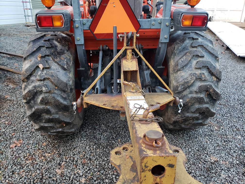

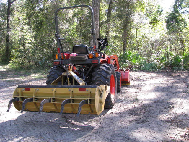

L3560 R4 tire spread, outside-to-outside, is 62" with narrowest wheel spread.
If you go with one of the heaviest 60" box blade available (650 pounds)
air inflated tires will serve you well. (Consider air rather than liquid if you will cross residential lawns.)
If you go with a heavy 72" box blade (700 pounds) you MAY wish to opt for "loaded" rear tires for enhanced traction as your box blade payload will be potentially heavier.

Can you show me where the outside to outside on the R4 is 62in, because the narrowest I've been able to get was 70in
(Real life, not copy and pasting tractordata).

My 2012 L3560, just sold, had 62" R4 rear tire width.
The Bush Hog (brand) rollover Box Blade pictured in Post #32 is 60"/64" wide. You can see the box blade is just a mite wider than the tires because the 64" overall box blade width is slightly wider than the 60" operating width.
Your L3560 Operator's Manual will show the wheel position and hub position required for 62" rear tire width. You must have both wheels and hubs oriented appropriately. Adjustable rear wheel hubs are uncommon on compact-category tractors

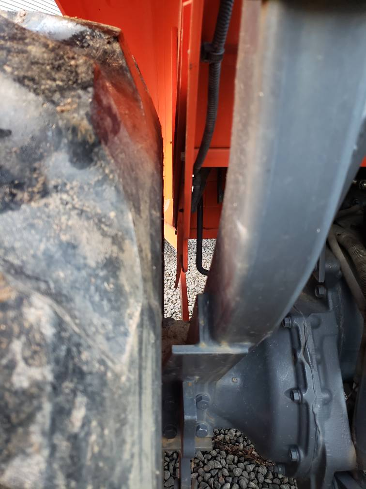

Any pictures of how yours was configured, all the manuals give are track width not overall width.
Here's my L3240 which uses the same tires, wheels and rear axle as the L3560.
As you can see the fenders prevent going any narrower and the outside width is 70in.
Sent from my SM-G715U1 using TractorByNet mobile app

The L3560 Operator's Manual, which went to the new owner of my L3560 tractor, contains diagrams showing wheel and hub orientation for each of four wheel/tire spreads with R4 tires.
With the ground level fueling introduced with the /60 models the wheel components and possibly undercarriage components MAY be distinct from the /40 models. I do not know this; just speculating.

Yes I'm familiar with the wheel setup diagrams for both the L3560 and L3240, neither show overall width.
That's why I asked you if you could show me how yours was set up since there doesn't appear to be any way to get narrower then 70in with the R4's from my experiences.
Sorry I upset you, but I just wanted actual examples rather then copies from tractor data as it doesn't have the relevant information.
