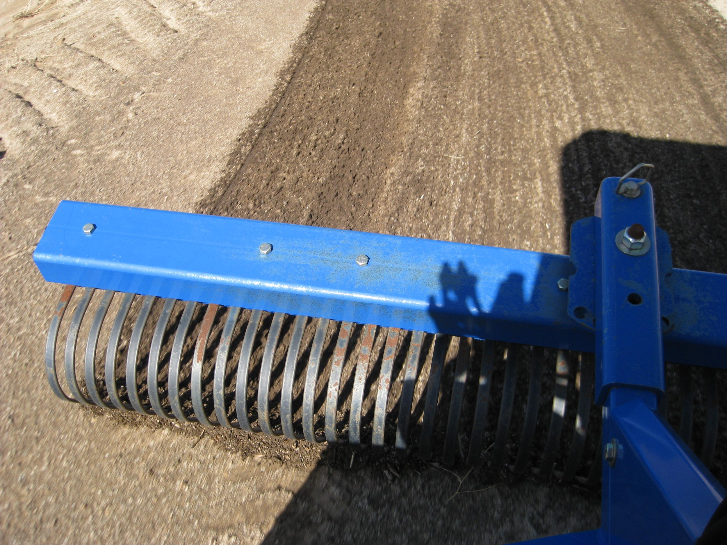

One of the secrets of grading, get the correct size and as heavy as you can afford that the tractor can handle at full capacity 90% of the time in your conditions.
My 2 cents, a LPGS (Land plane grading scraper) is by far the best road maintenance implement 99% of the time, it cut my maintenance time by more than half and I have over a mile of road to maintain.
I believe that the OP would be best off getting an 800 pound plus rear blade such as a Land Pride RBT35 or 40 series 96" wide or equivalent to start with. Simply because he needs to rough cut new areas as well as reshape existing parts of his road.
No doubt that a 1000lb box blade could be well used in this process, sort of why I have all 3.
I started out with a rear blade, then the box blade, then a landscape rake, then the LPGS, then upgraded the rear blade.
Each has it's intended use and is best at that. You can get by without all 3 or 4 if you want to consider a heavy landscape rake. If I could only have one, then it would be my LP RBT45108. 2nd implement without any doubts, a LPGS.
A top & tilt set is a HUGE benefit using some of these implements, if not all of them. ;)
