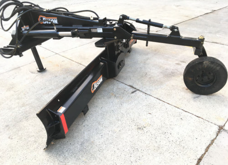

A little update. I've ordered a C8 Road Boss LPGS (1200lbs). Unfortunately it's a 4-5 week wait on that. Hopefully it will get here before the snow does!
Also, just purchased a used Bison 270 XHD 9ft rear blade with tail wheel kit. It has hydraulic height adjustment on the tail wheel and hydraulic tilt on the blade. The blade angle and offset are manual, but they do sell a cylinder kit for it if I feel the need. It is indeed a beast of a blade at over 1,800lbs with the tail wheel kit.
The only catch is the dealer wanted $2800 to freight it to me, just one state over (650 miles). Ouch! That's almost as much as the blade itself, so I guess I'll be going for a drive. But..... I have to wait until my tractor (and pallet forks) arrive, so I have a way to unload the blade off the rental trailer when I get it home.
So things are slowly falling into place. I can't wait to tackle this project. Time to start clearing out the barn to make space.
This is just a stock photo, but it looks a lot like this.
   / What implement(s) to repair and maintain two miles of gravel road? #14
If only you had a trailer....oh, never mind.
For the blade angle and offset, look at what Surplus Center has with the correct strokes, or close to it. Ideally also with the correct ends, but those aren't too hard to modify if you have a welder.
It may not be for a couple of days, but I could measure the ones on mine.
