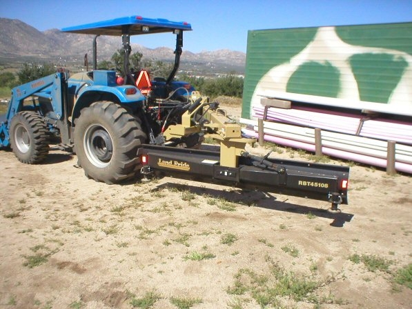

Thanks for the tips! On the subject of skid shoes, the blade that I purchased has been modified (see pic). I'm not sure if those vertical pipes, that have been bolted and welded on (where the factory shoes would normally go) are there to accommodate a different type of shoe? The dealer said they though maybe it was some sort of depth gauge. Any ideas?

Looks like they made mounts for regular round ones, common on lighter blades.
I did a bit of searching, but I think I'm going to have to wait until the blade arrives so I can measure the ID of that tubing to make sure whatever I order will fit.
