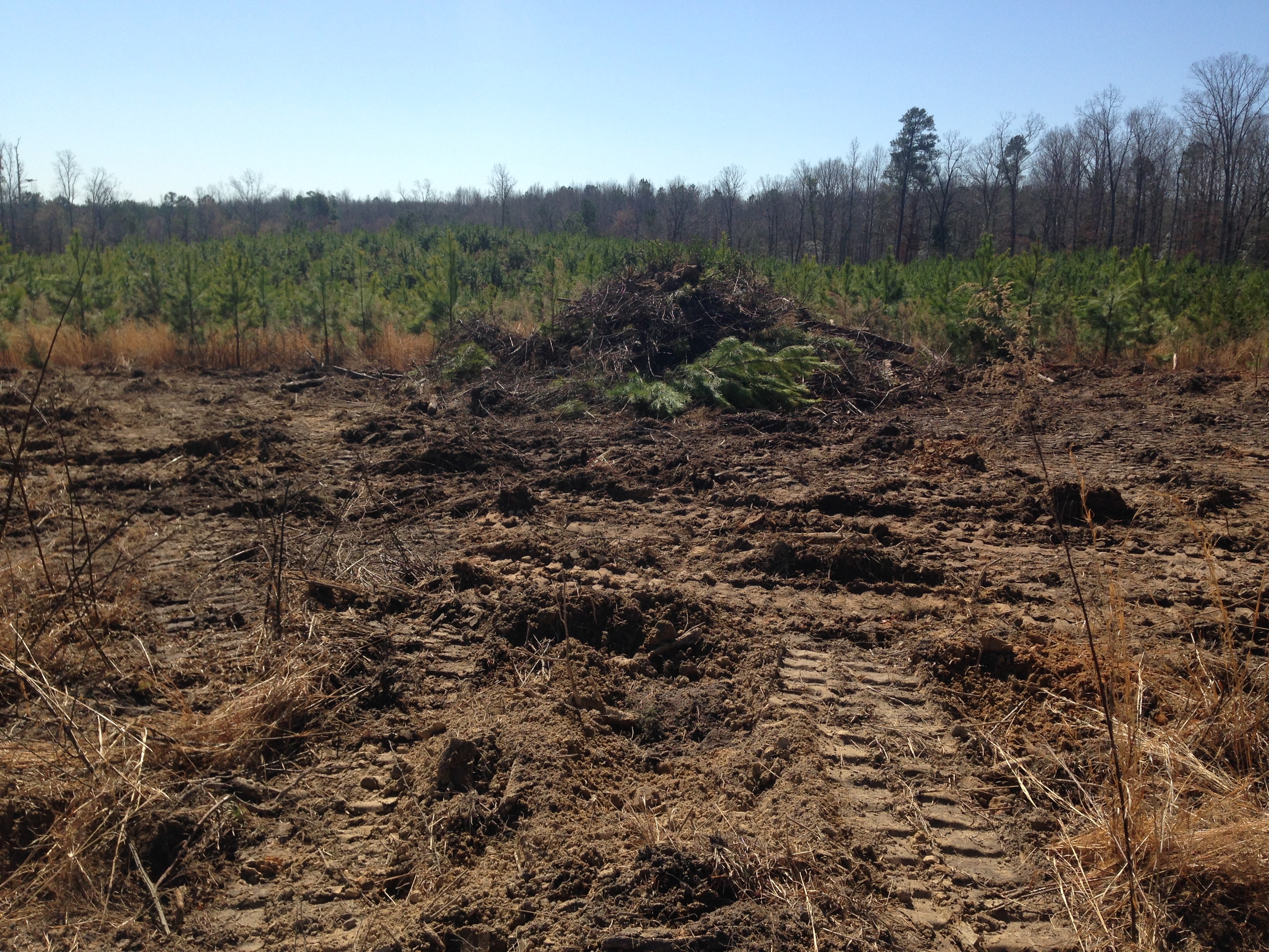

If you have stumps, and want to improve the grade.
Get a dozer in.
A Box blade won't touch a mature tree stump and root.

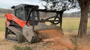

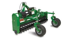

Not sure how "rough" the plot is you are dealing with. If it isn't too bad rent a power rake like this
If you have lots of root debris and humps these forestry mulchers do a great job
The mulcher will level soil and pulverize wood debris and is good for reclaiming large areas, you can pull down humps and fill low spots. Rent a machine with a head and teeth designed for ground engagement like the Fecon/Bobcat.
The power rake is great for finer work before seeding grass or laying sod but it will pull out roots and rocks leaving you nice piles to dispose of.
For smaller areas the power rake might do the job for you.

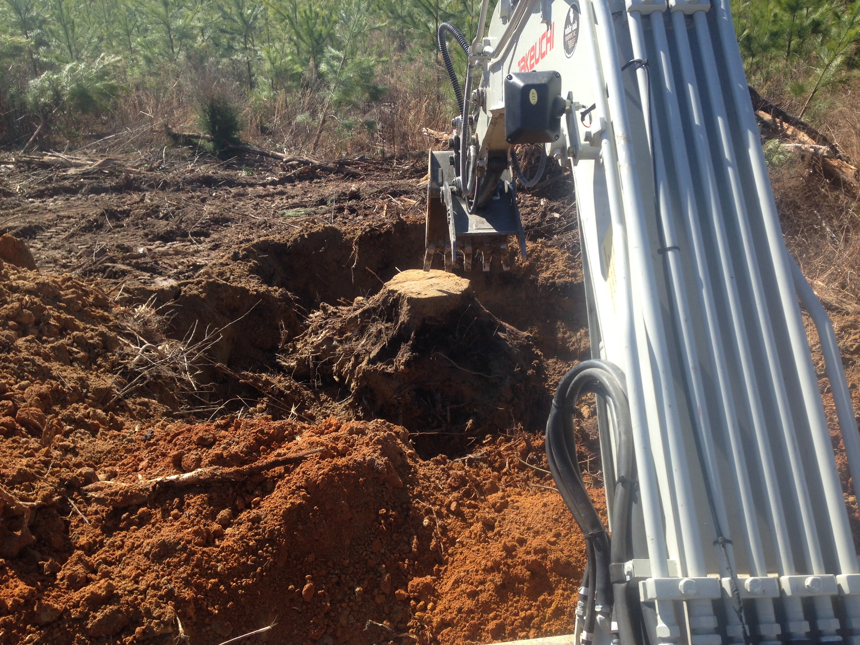

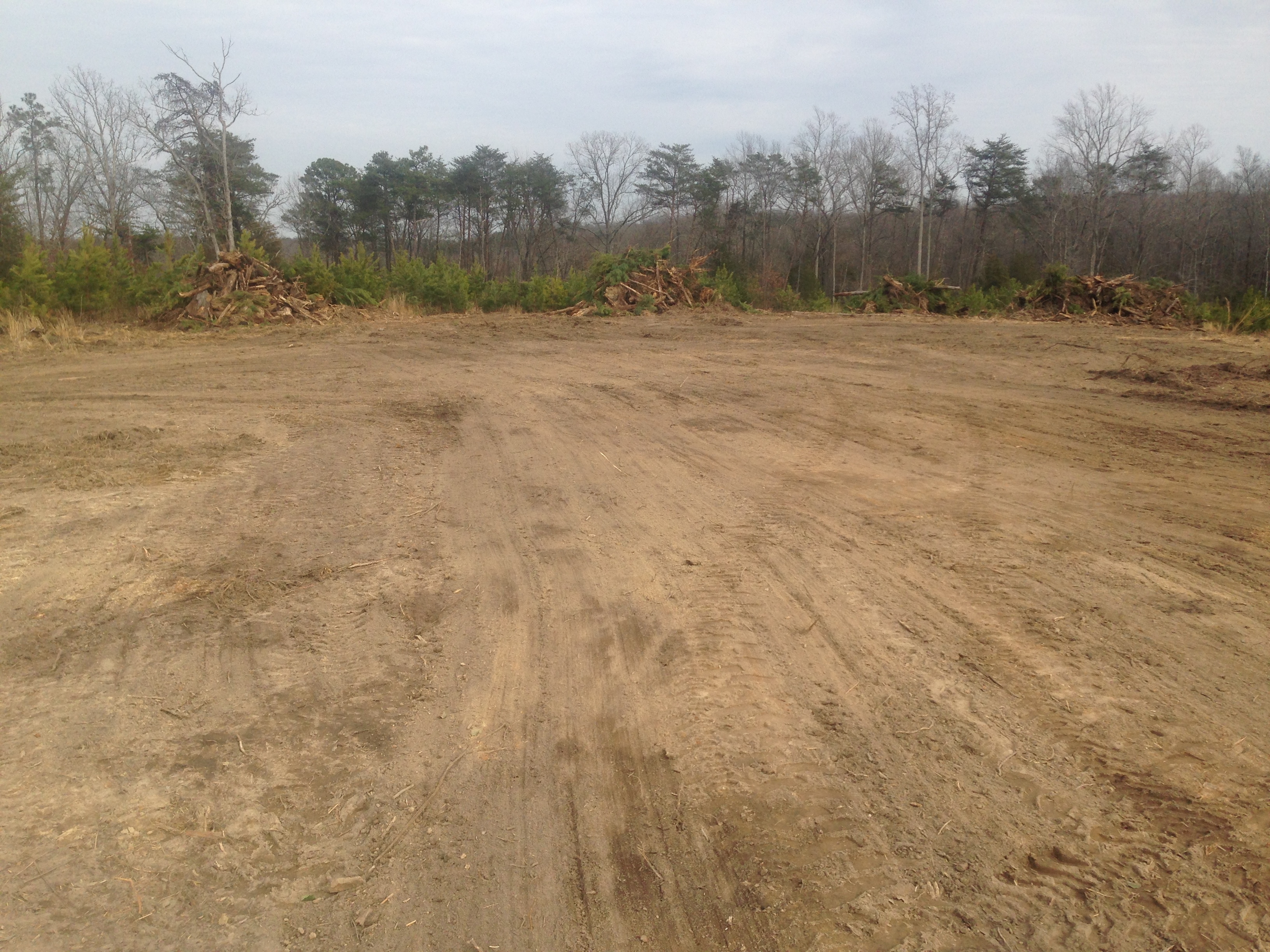

I cleared 2 1/2 acres with the biggest mini-ex I could rent with blade on it. I dug out big stumps and then used the blade to rough level everything. Then I used my tractor and box blade/pulveriser to do the final grade.

2 weeks straight, around 10 hours a day. I was vibrating for a couple of days after.
That's an impressive project. How long did it take? What's a pulverizer?

Yours are rotting. When I dug mine they were fresh. Took 35 to 40 minutes a stump. You will probably get it done a lot faster. Depends on how much you like running equipment. LOL
