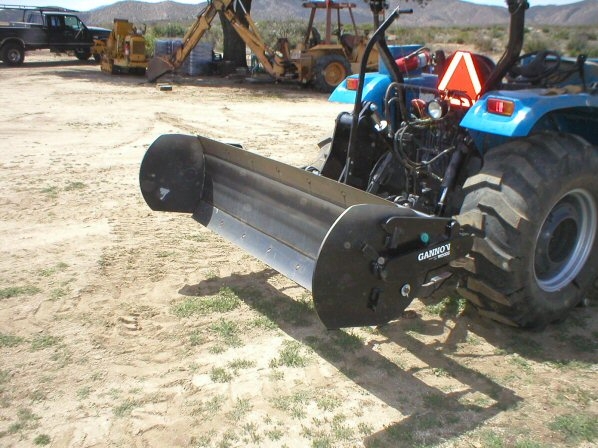

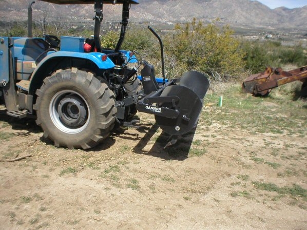

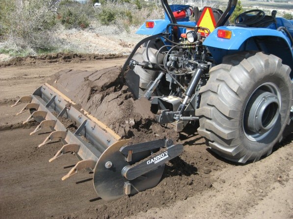

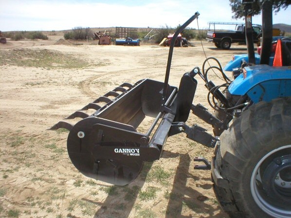

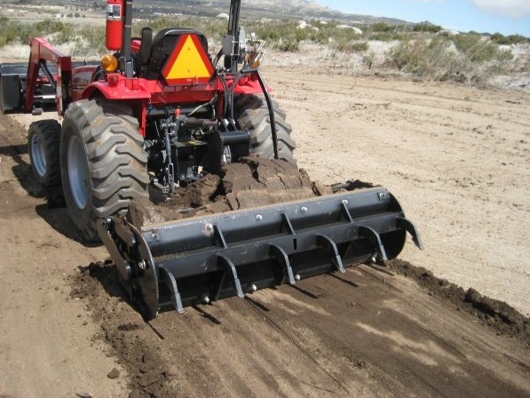

Roll-over box blades are great (y)(y) and I'm a hydraulics guy.
My first question, do you have your tires filled?
Filling the tires makes a day & night difference as far as the capabilities of your tractor.
I have all 4 tires filled on both my 75 HP (81"ROBB) and 32HP machines. (65"ROBB)
I believe that I would get a 72" unit for your DK.
Also, learn how to best use your draft control, (this will take some experimenting) and your days of bogging down will be gone.

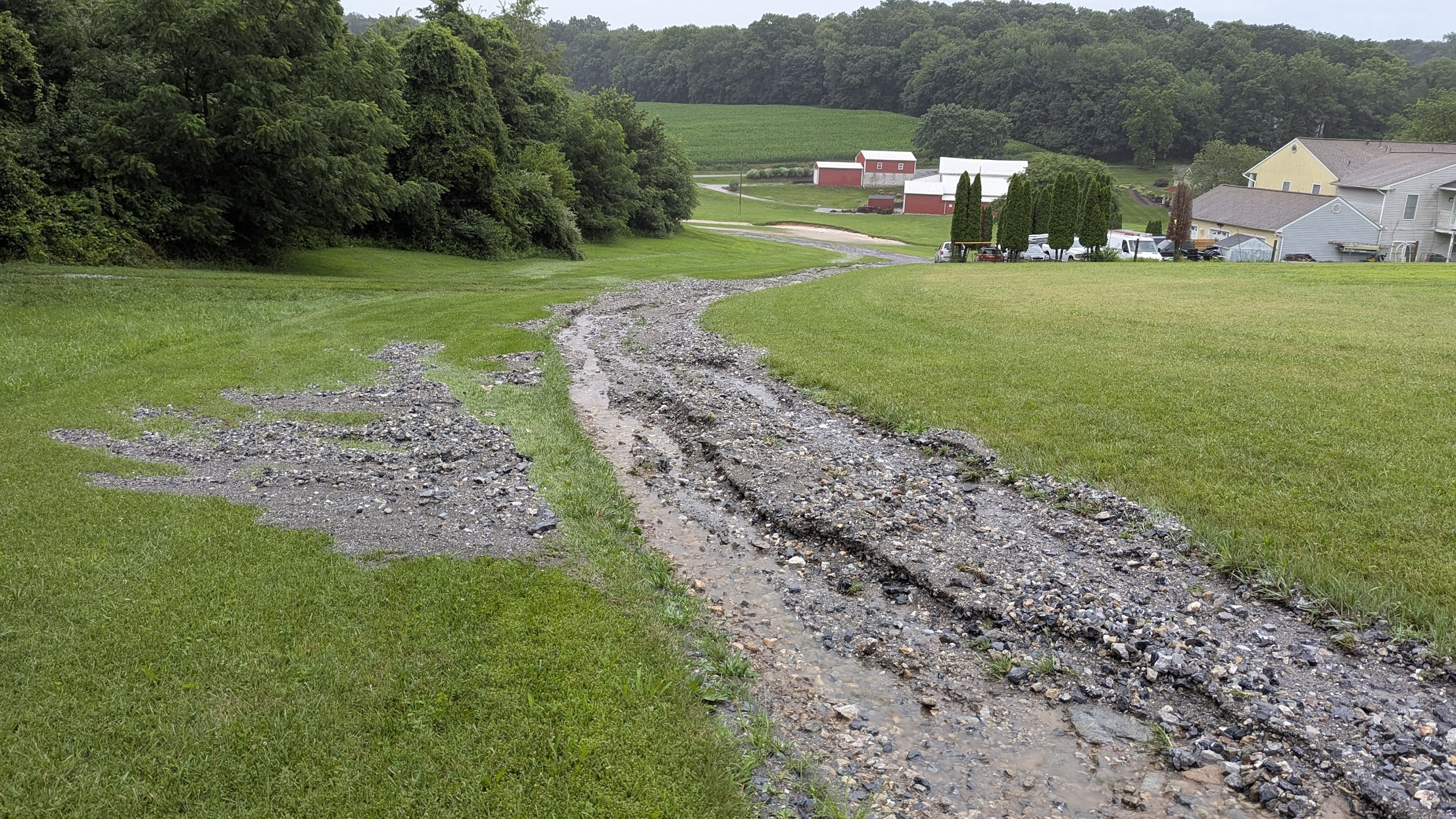

@anomad Speaking of the hard rains. Im in PA and we got hammered Wednesday evening with rain. This is what I had to clean up Thursday morning. The washouts were over a foot deep all the way down to the neighbor's house. Its asphalt millings beyond that. It's hard to tell from the photo but it does have a decent grade from top to bottom. We probably got 4-6" of rain in a bit over an hour. It's the worst I had it wash in 15 years. Took 4 hours to get it all filled in again. The water at the stream was overflowing the driveway at the through pipe. Luckily the pipe didn't get washed out.

@TractorNoob85 Same exact thing here. Most thunderstorms just require a jiffy touch up. Everything was blown out like nothing I had ever seen yesterday.
I'd say go small so you have all the power at your disposal. And if you figure out an easy way to mine that gravel out in your grass let me know! LOL. I'll be mining with a shovel tomorrow for sure.

If you put water bars in and diverted the water off of the road, any chance that that would help? Although the burms make it a pain to grade. :unsure:
/ Box Blade Suggestion #11
Water bars are a must! Yes. Those are directed into the culverts. And we even scratch in little tiny ones with a hoe if there is heavy rain in the forecast. For example, my sister saw the thunderstorm coming on her phone and scratched in her little ditches. Only one got blown out. Fixing her road up will only take a few minutes except where the culvert pipe overflowed.

I'm no landscaper but water bars in a driveway sound like a pain to resurface. The driveway would never feel smooth. I do like the idea of something that holds the rock in place though. What you don't see in the picture is behind me is more hill and a large corn field. Water from the field runs down the hill and into the driveway since it's lower than the banks. Imo, the driveway needs raised above the level of the banks and crowned correctly for runoff with ditches dug on one side or both with large rock for the runoff to collect and drain. I've been kicking around the idea of blacktop millings. I'm assuming it's going to be costly though.

If you try to take too much bite into the gravel that is still packed, you are going to experience loss of traction. Ease up on the angle and depth of cut.
If you can pitch the road surface to one side or the other or crown it to both sides, sometimes you can avoid using water bars, but you have to keep it pitched or it will wash. Precision matters here.

If you are not going to add water bars, then at least slant your driveway slightly sideways so the water doesn't run down the middle of the driveway. Have it run off to the downhill side.
