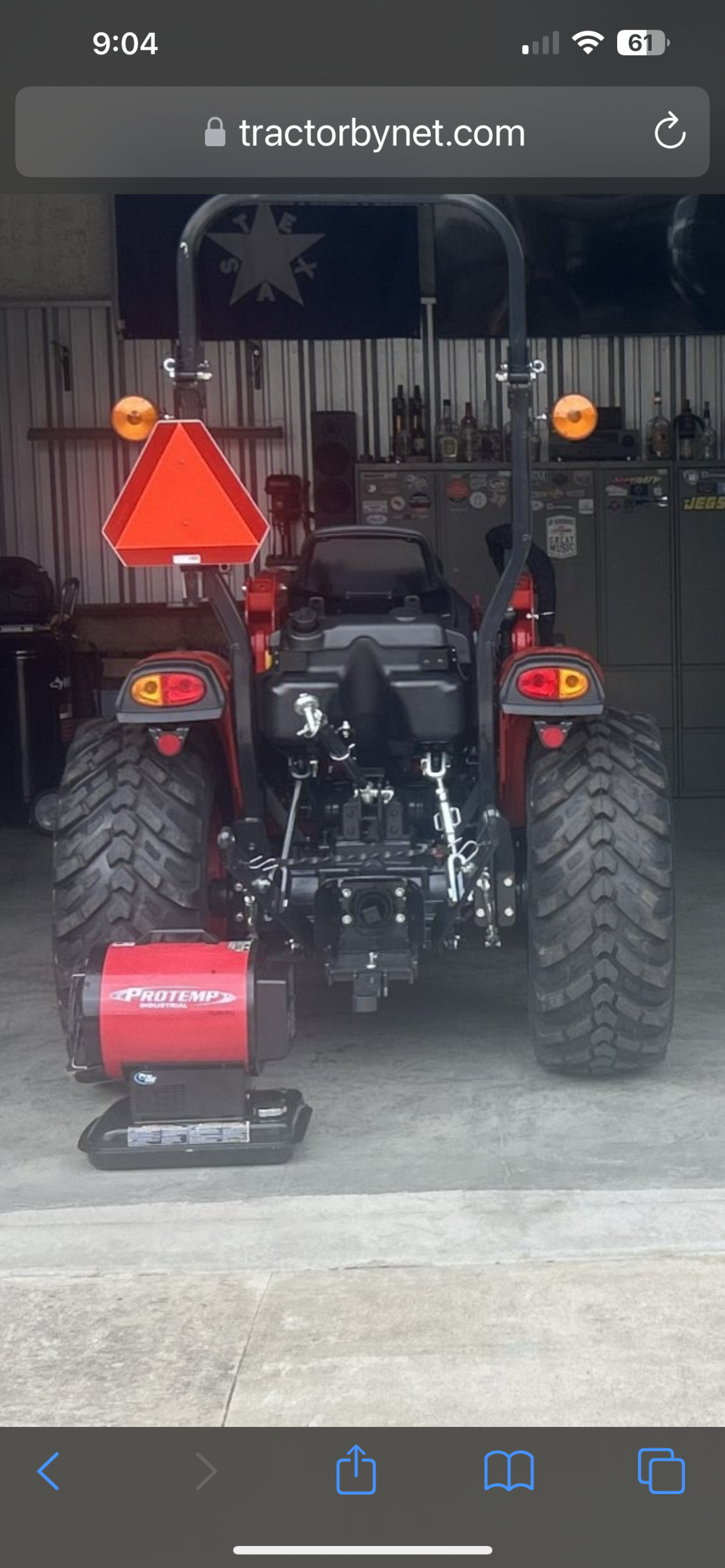

I got my rotary cutter, found a deal on a 2022 RCR1260. Now I’m looking for a box blade. I read you want the box wider than the rear of tractor in order to cover tracks. I’ve seen a lot of 5’ box blades on Kioti CK2620’s. When I measure my rear tire width,from outside to outside, total width is 63-64” so would I need a 66” or a 72”? I got a good lead on a killer deal for a 60” but don’t want to regret it. I have a 2023 Kioti CK2620 with R14 tires.

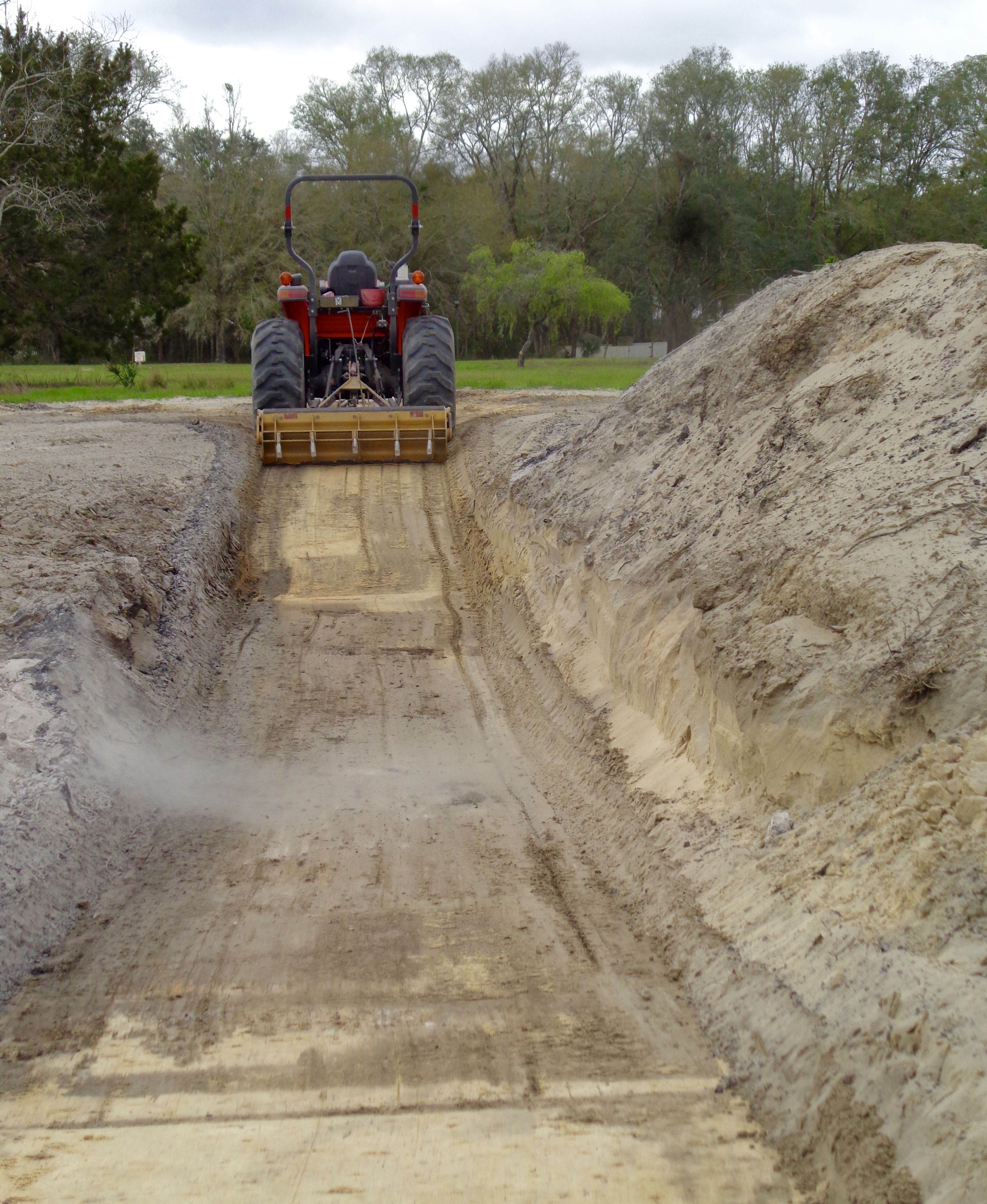

Big advantage to cover your tracks?
If your BB is much narrower than your tire spread, and you pull in one alley repeatedly, your tires will soon be up on narrow ledges and the centered BB will not touch the ground.
Tractor tire weight will mash down minor differences of 1" to 1-1/2" per side.
In the attached photo, two years old, the 60" wide community burn pit is now 40" below grade. You can't do below grade work like this if your Box Blade is narrower than tractor's tire spread.
Note: Bush Hog (brand) Rollover Box Blade.

Post a picture of your rear wheels please. Also, a full rear view without any implement.

Don't over think this. Buy a box blade that will cover your tires. Your tractor is capable to do the work.
I got a lead on a 60” Frontier BB5060, for under $501 without rippers, or a 60” Heavy duty atlas with rippers for 600$. 66” doesn’t seem to common in the used market. Not for those prices atleast.
