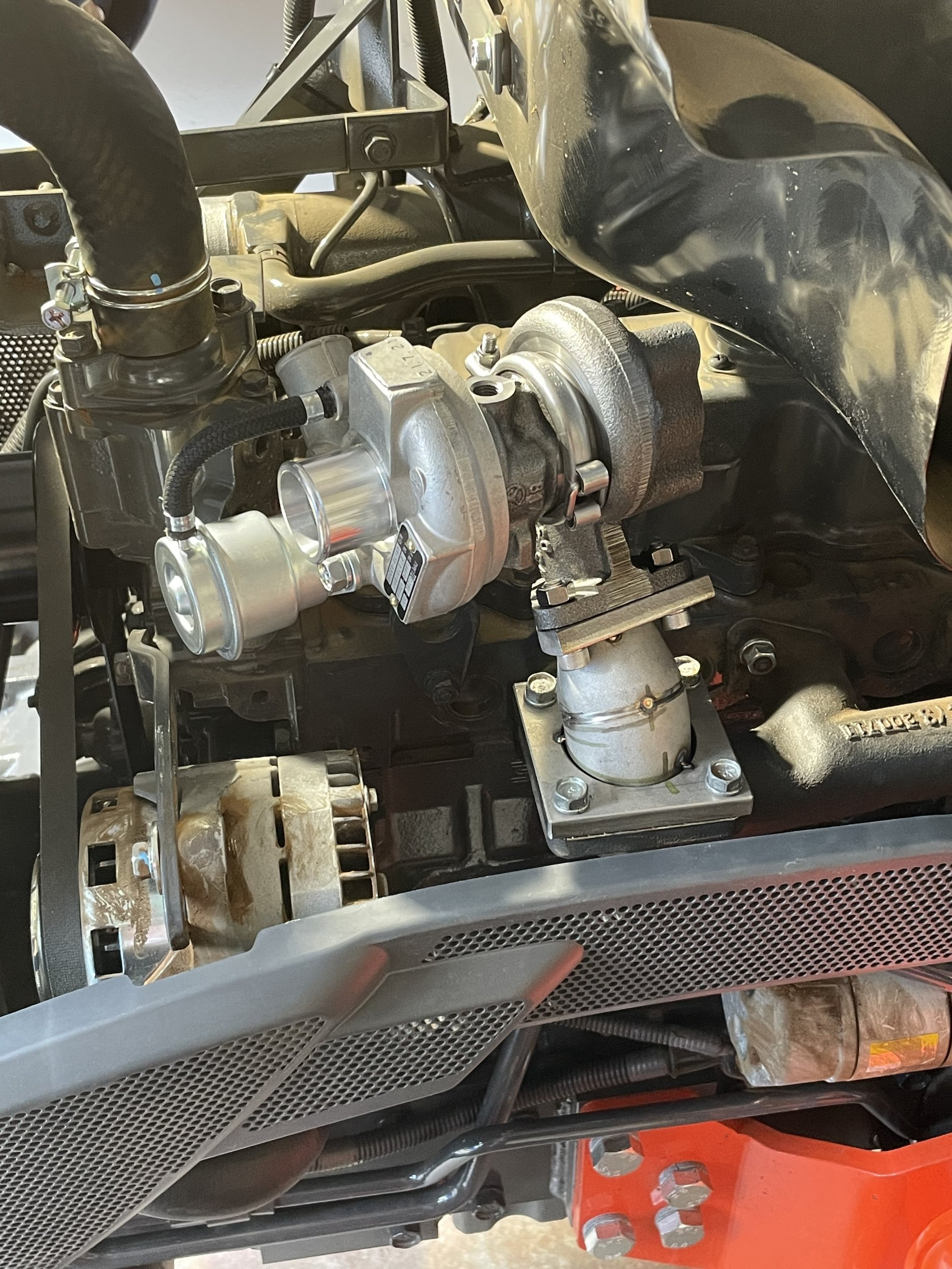

Plus, if you need more power for your L2501…I have an answer to that;
It’ll be running 45-50HP.
