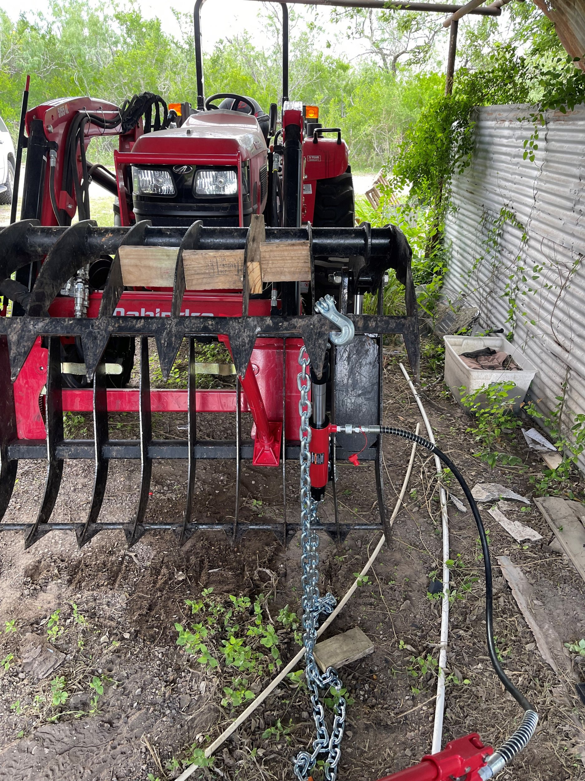

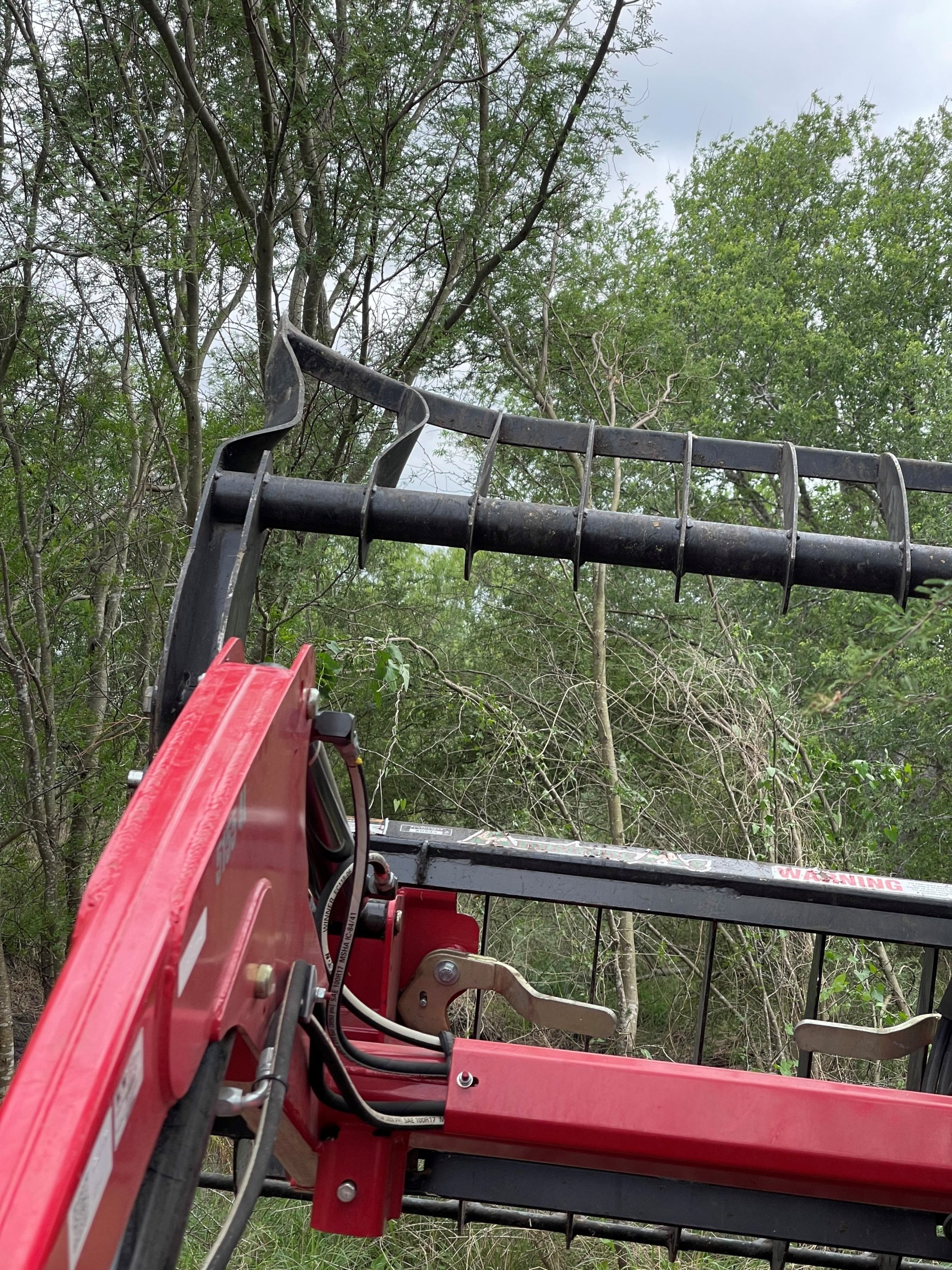

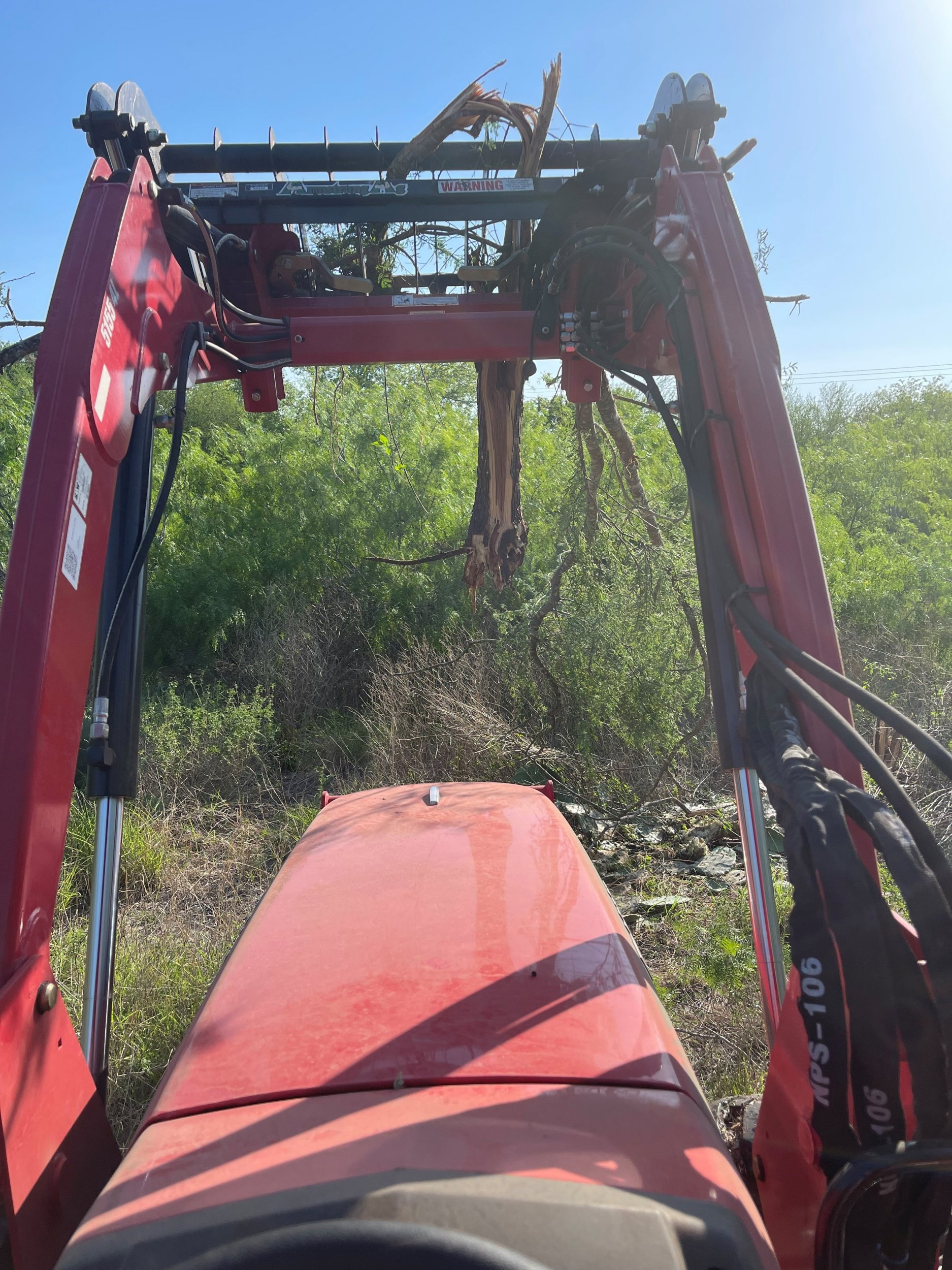

have you looked at Armstrong Agg i have their cheapest BRG mini which is made for 20 to 35 hp tractors on my 7000# beast and have beat on it a lot tearing huisache trees up to 6" out of the ground. I got the MINI to be the weak link so that i tear up a $2000 grapple and not my $9000 FEL. and it has worked so far. I bent the heck out of the grapple doing some thing i should not have done but the portapower fixed it. tree puller would probably be a better option for pulling trees.

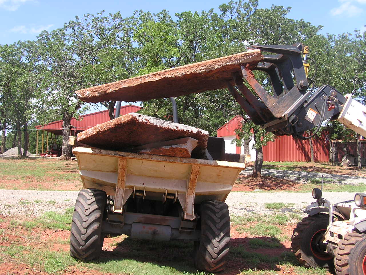

Here's a tbn post I made on the subject 4 1/2 years ago. Wow, how time flies!!
Which Grapple Guide
Concerning strength.. Can't hide WICKED!!

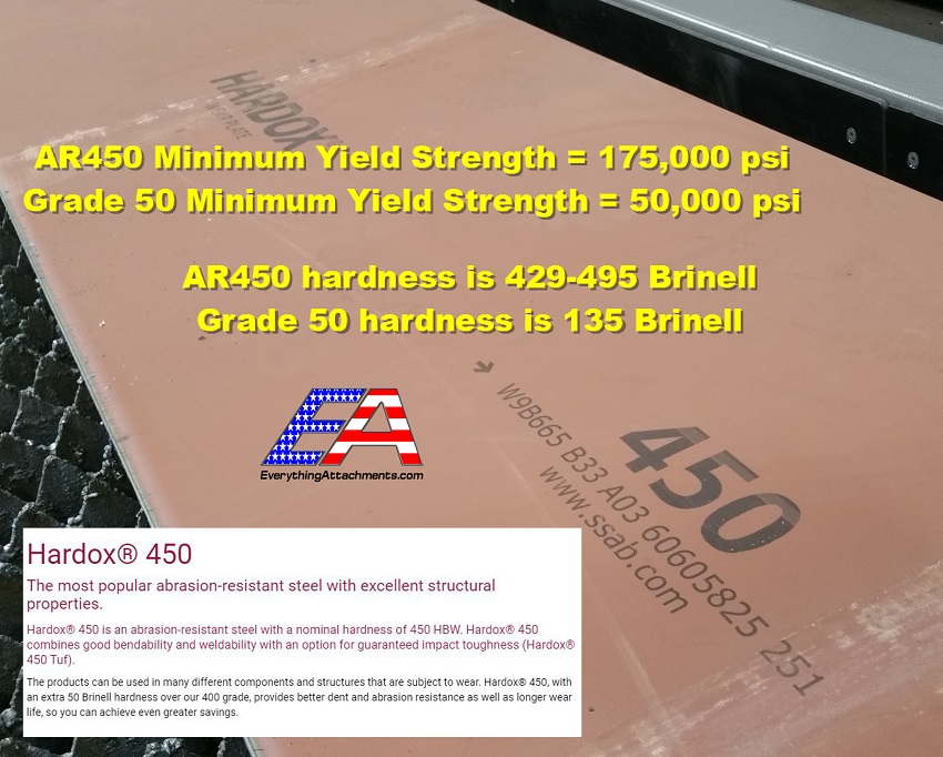

Travis,
Are they made of AR400 steel?
The flat steel on all of our rake style Wicked Grapples is Hardox AR450, and we also use it where needed on the longer bottom models.
Also, the Wicked 55 and Wicked 60 features this horizontal Hardox channel which greatly increases it's ability to smooth while back dragging, and obviously also increases the Wicked grip ability.
Travis
What's so special about Hardox?
