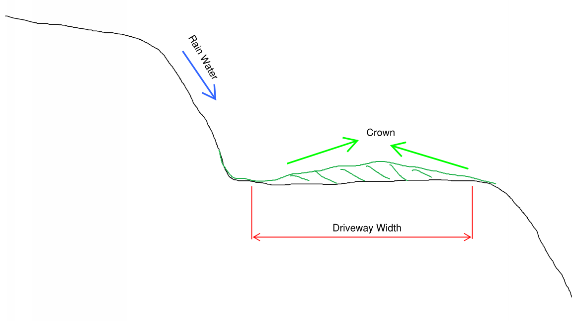

Crowned x Sloped Road: could you expand a bit on this or point me to good literature that explains exactly the cons and pro's of each; costs differences; degree of complexity and energy spend building these two solutions? I need to understand this better.
My commitment to the cause is solid. I am even trying to learn as much as I can about all of this.
If your road , is as it appears, I would choose the 3rd drawing (but point the pink arrow the other way).No ditching required. See out sloping in attachment
Well hey, kudos to you sir. I don't understand how we don't see crazy ruts all of that drive in your pic, if you do drive on it daily?
Sorry if my first reply was harsh, I've learned over the years here to be blunt with newer members to get their perspectives aligned with the true challenges they will face, so I made the assumption that you were just getting started here.
Personally I like a proper full crown on the road bed, draining to each side. This is the best way to keep the road bed consistently drier, as it sheds water the best, and thus also lends itself to less erosion of your gravel material. However, in a bench cut into a hillside, this does mean that you need to add culverts periodically that will take the runoff water back under the road and away. These culverts can be tricky to get right, and do require maintenance over time - best if you can avoid them when possible. How long is your total drive, and how much length of it is bench cut into the hillside like the first pic? Edit: 955 yards?!? half a mile in that muck? Dang!
If not going with a full road crown, then outslope is easier to manage than inslope. Inslope means you are putting a LOT of water into your hillside ditch, that again needs to be evacuated before it's too crazy.
Enjoy your excavator rental! I always got mine (Bobcat E35, a ~8000 lb machine) with both a 12" and 24" bucket. The 12" bucket is for digging trees out, but at that narrow size, can clog up with clay sometimes. 24" is a good size for shaping ditches and slopes, but will make pulling trees out more difficult. Either way, get a hydraulic thumb as well, so that you can grab roots/stumps/trees and toss them around. With 2-3 days of work, you can definitely achieve a wider driveway bed, with shaped crown and uphill side ditches! You might need to put 20+ hours on the machine though. Plan for continuous work with it, and then cleaning things up with your tractor afterwards.
Maybe add your rough location to your user profile, so that everyone can see it on the left side of your posts. This will help us understand your soils/rocks, weather conditions, and local gravel options, which do vary quite a bit.
Very good literature. Thank you!
And I totally see how the arrow in my drawing is misleading - yes, it should point reversed.
I am trying to learn more about the ditching and the complexity around doing it. But good to know there are simpler options without the ditching.
Thank you!
Very clear and I am seeing my options a little better.
The total length is 955 yards. I need to measure lengths of road that are in desperate need of repair - not the entire length is bad.
Very clear. And thank you for the language: inslope x outslope. I believe outslope is this drawing here but with the arrow pointing to the correct direction:
