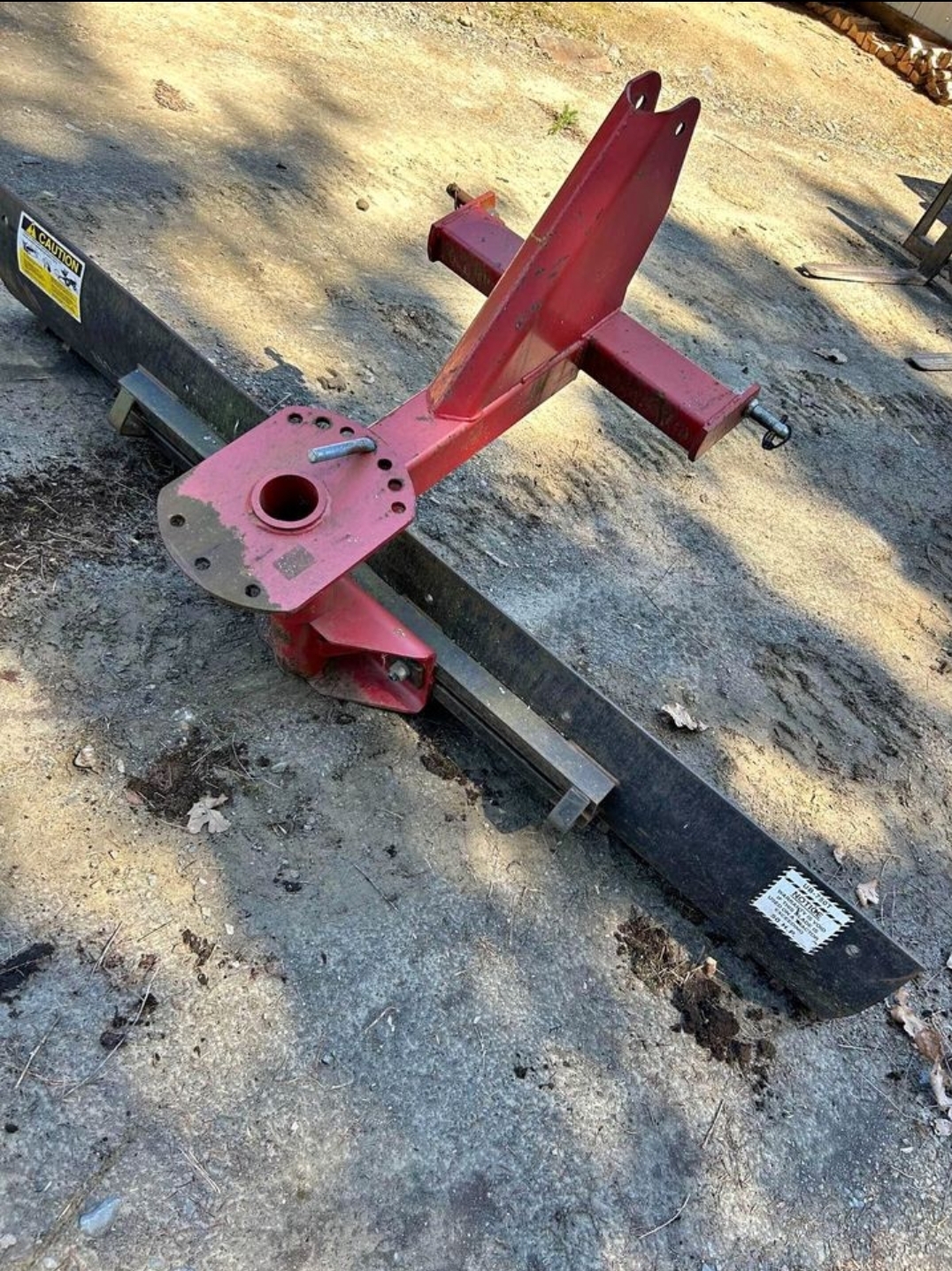

How about a blade? What length should I get? I just came across a 7 footer back blade for $350:
The general advice here on TBN is to buy the size box blade that covers your rear tire width by a couple inches, but don't go bigger. A 6' unit with the scarifiers down will easily stop your little B3200 dead in its tracks. A 5' probably will too, but a little less often, haha. The other factor is when driving through the forest, a 6' unit will bonk into trees more. Keep it tight.
Yes, I understand the compromise and limitations. And the attachment originally is intended for driveway maintenance only - but you are correct, in the future we could use it on the forest.

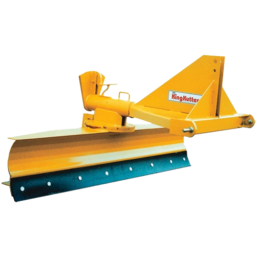

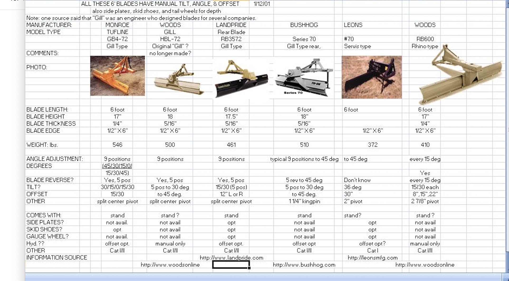

If you want the most versatile implement, a 6 foot 3-way rear blade with tilt, angle, and offset is the standard. The 3-way adjustment allows you to do trenching, crowning, and reduces the pull force required when the load gets heavy.
I don't know much about rear blades, or anything tractor related, to be honest.
But I came across this 7' rear blade and it seems to have a adjustment. Could you explain me what this adjustment is (tilt, angle or offset) and if this blade would be adequate to create drainage swales if I chose to go this route?
