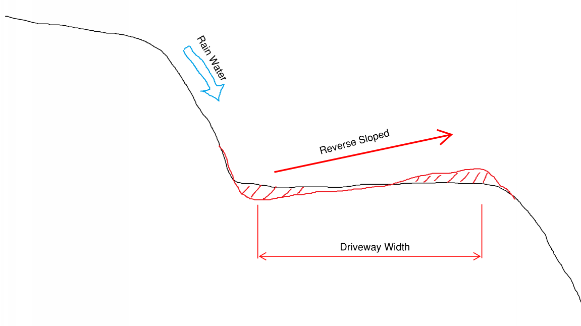

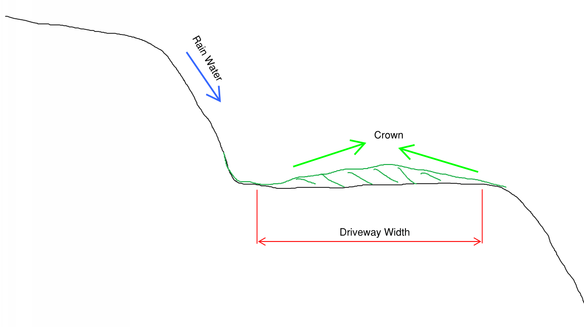

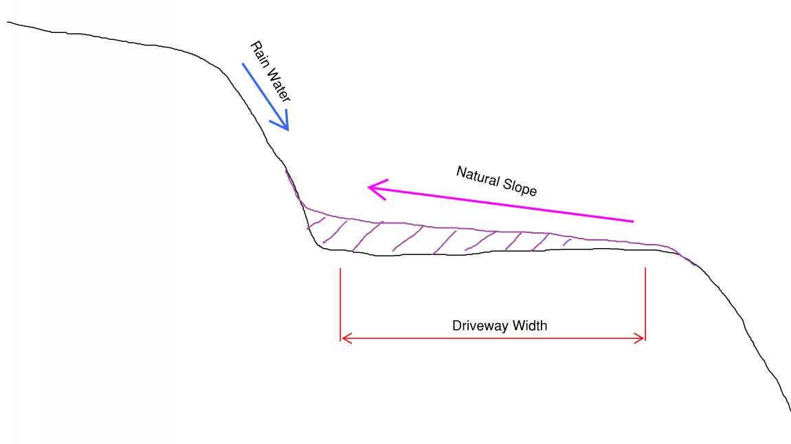

You need a 12' wide, crowned or sloped road bed, with drainage/ditches on each side.
Drainage on each side and 12' wide is not going to happen. God bless you and I hope one day we'll do it. But not for now.
Crowned x Sloped Road: could you expand a bit on this or point me to good literature that explains exactly the cons and pro's of each; costs differences; degree of complexity and energy spend building these two solutions? I need to understand this better.
