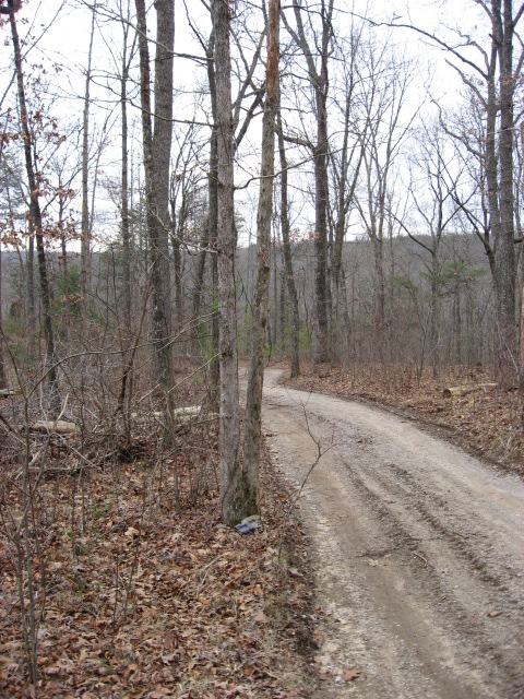

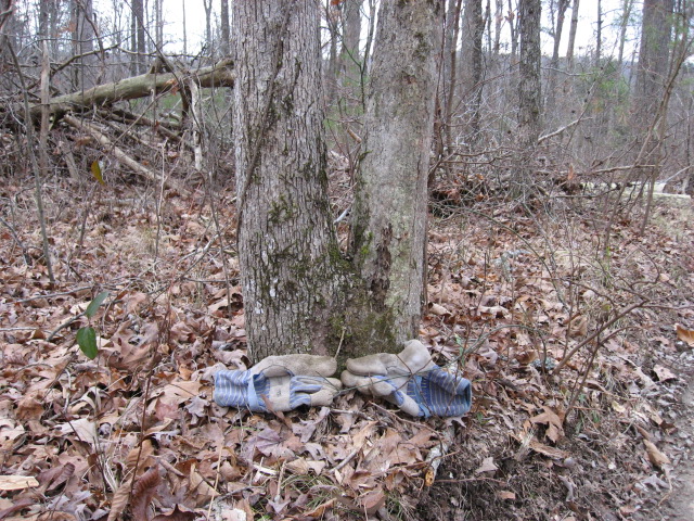

/ Best Way To Remove This Tree
#53

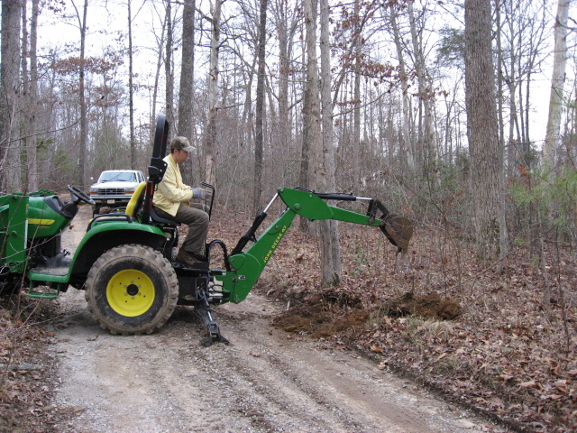

For some practice on taking down a tree, I chose small tree on the side of my road that is preventing me from creating a proper ditch. This tree was about 30 feet high but not very big around. It has a double trunk. I placed a glove in front of the tree for a perspective on size. If you look down the road in the background on the right side you can see the bigger tree that is the main subject of this post.

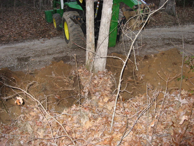

#54

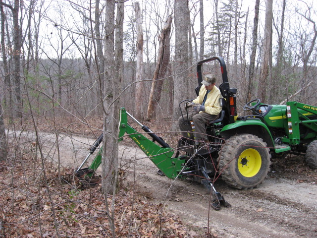

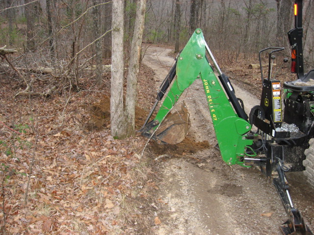

Here are some pictures of digging the trench on the side of the tree to which the tree will fall.
#55

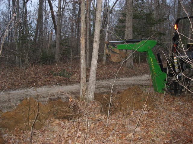

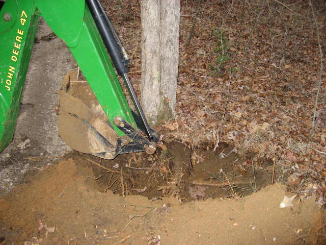

Here's the first trench completed. I dug as close to the root ball as I could. The roots on this little tree weren't too big so I was able to dig very close to the trunk.

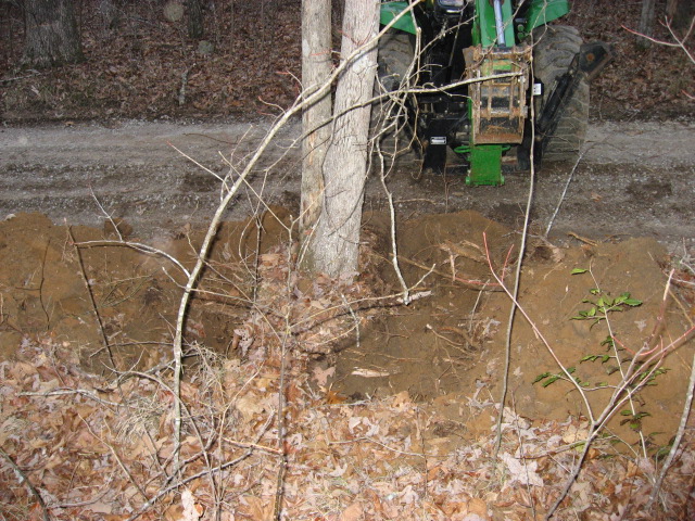

#56

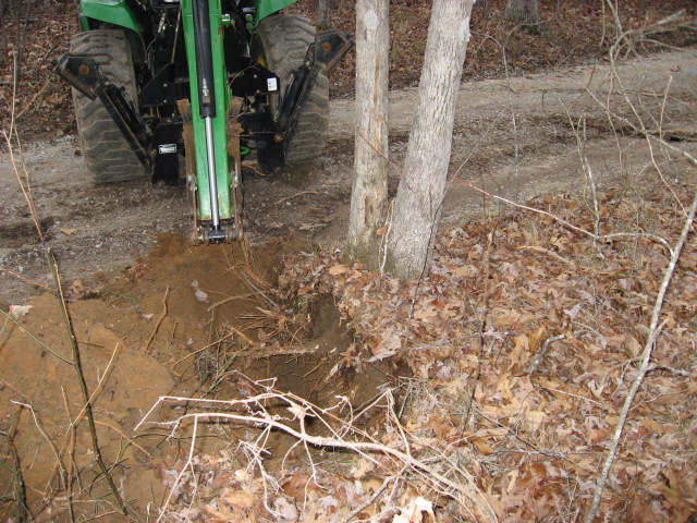

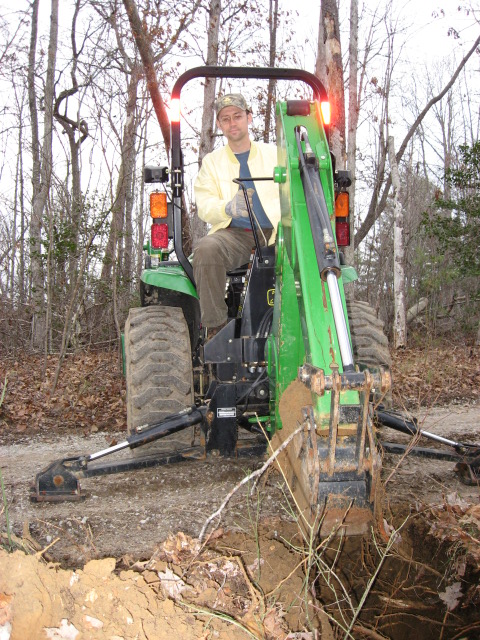

I repositioned the backhoe to dig the trench on the other side of the tree. Although this tree is small, the roots were still tough enough that I had to be careful or I would drag my tractor toward the tree by taking too agressive of bites.
#57

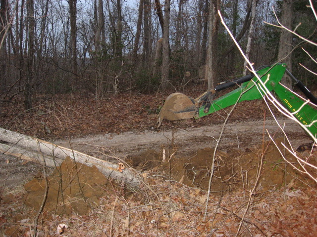

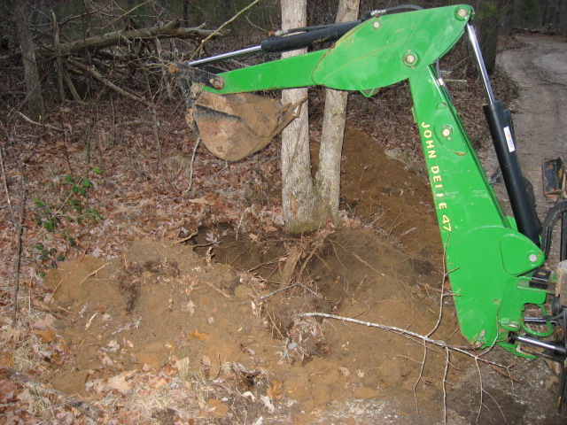

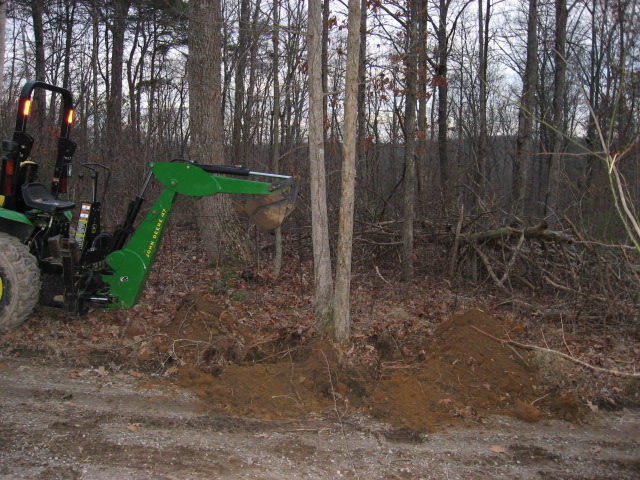

Here are pictures of the two completed trenches. It is important to note that I dig not dig entirely around the tree. Using Eddie's method as I understand it leaves roots in the ground on either side of the tree. These roots act as hinges when you push the tree over. I was amazed at the control with which the tree fell using the remaining roots acting as guides.

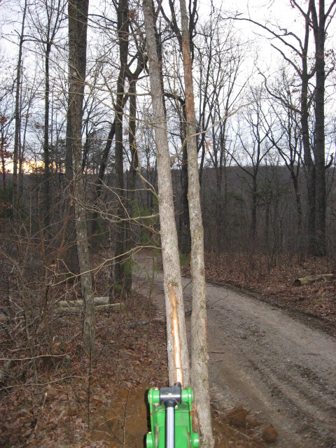

#59
Here's the backhoe pushing on the tree. It takes a little experimenting to find the sweet spot that is just the right place to push.

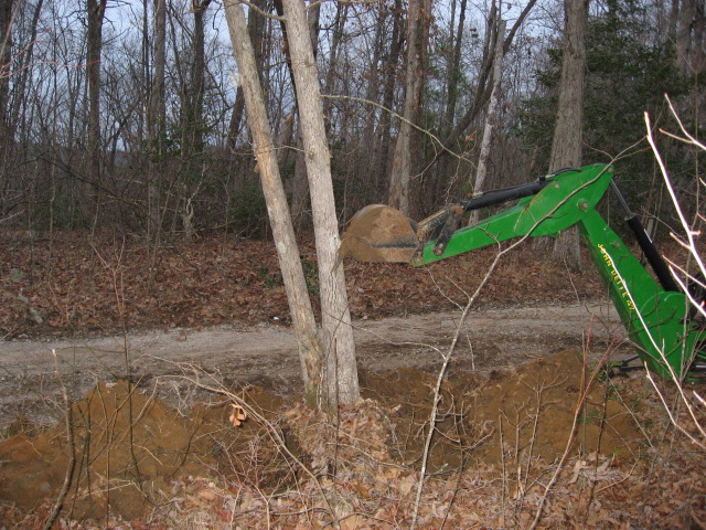

#60

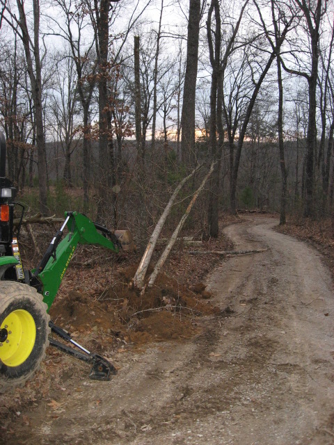

Once I had started pushing on the tree I realized that I was pushing it parallel to the road. I wanted the tree to fall in the road, not beside it. Thus I decided to stop pushing and reposition the tractor a little to get a slightly different angle. However, as soon as I removed the force of the bucket on the tree, the tree fell right over beside the road instead of into the road.
