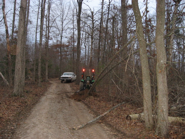

I might drop another practice tree this Saturday. Here's a picture of the next practice tree. Look at the bottom right hand corner of Practice_Tree2.jpg. See the pair of trees on the side of the road. I'm not sure if I'm dealing here with one tree with a shared root ball or two separate trees.
All,
I'd sure like some suggestions from all you guys on how to attack this pair of trunks with my backhoe. It looks a little more complicated than my first tree.
This tree, like my first practice tree, is also preventing me from creating a proper ditch and is causing the road to wash. Practice_Tree2.jpg is a picture of the road after grading with my box blade. See CUT Box Blade Newbie - Road Pictures for the thread on my first attempt at grading a road (this road). Road Before Grading Showing Washout By Double Practice Tree shows the practice tree on the left. The big tree that is my final target is down the road on the right (although in the distance it looks smaller than the double practice tree).
However, before I can tackle my next tree, I need to re-set the electric pole at the camper site Electric Pole. This is a 16 foot pole the electrician put up last week. It's only 2 feet in the ground and he didn't use any concrete. I'm hoping I'll have time on Saturday to re-set the electric pole and drop another tree. But we'll see.
