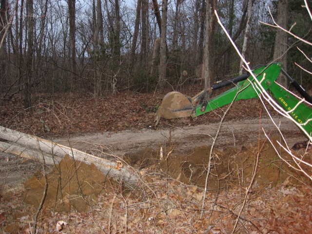

I pulled out my copy of this book and reread the land clearing section again as well. The concern I have with cutting both sides of the tree is that it makes the tree less stable which could be dangerous. With cutting the roots on the tractor side per The Book, that should keep the tree from falling back on the tractor. BUT, it sure seems like it would be harder to push the tree down.
The Book recommends pushing the tree down without cutting roots. The larger trees require digging.
I was suprised that Obeds 46 BH pushed the tree over. I thought my 48 BH would have trouble pushing it down.
After reading this thread, The Book, and doing some thinking, I think what I'll try is to push it down per The Book. Don't think that will work on most trees with my BH but I'll try. Then dig out on the tractor side and push Per The Book. When that does not work I'll dig on both sides as least resort.

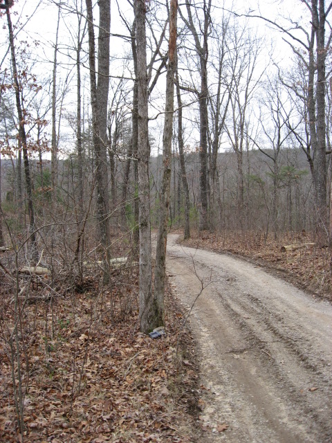

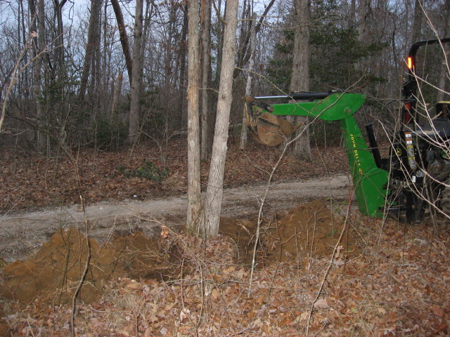

Obed,

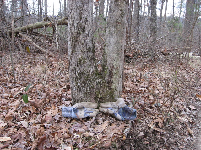

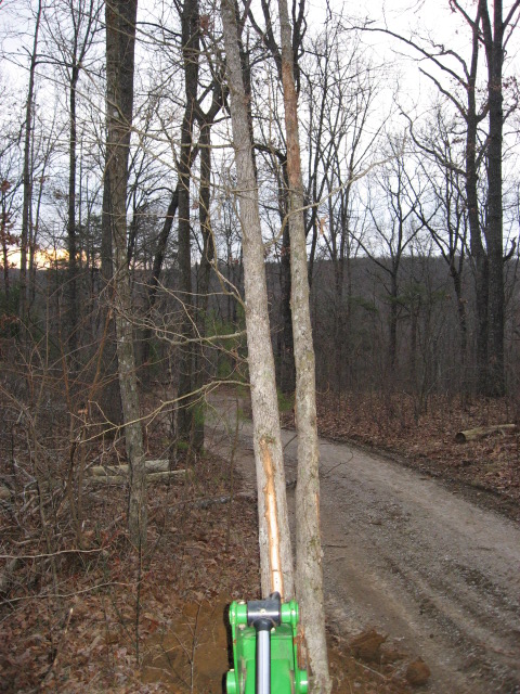

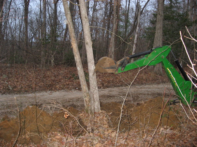

I'm not too exited about how close together those two trees are. From the picture, it looks like they are too close together to get the bucket in between them. It also looks like the further one has a nice lean to it down your road.
I would prefer to lay it down on the road, but sometimes that's not always an option. In this case, and based on just this one picture, I think it should go over into the trees away from the road.
Dig your trench for the fall side on the oposite side of the road. Sice this is two trees, dit it deeper and longer. You really can't dig it too big, but there is a point where it wont matter anymore.
Dig your second trench on your push side, along the side of the road. Again, go a little deeper and longer than the last one.
Try to push it over. Two trees will hold each other up and make it tougher. If it won't push over, cut the next two trenches in.
I've read where your bucket isn't able to under cut the roots, so I understand that, but get whatever you can out from under them.
You still might have trouble pushing them over. One will always fall easier than the other. They will both go together to a point, but you might have to change trees until you find the weaker one. Push that one over and the other will go real easy.
Go slow, take out plenty of dirt and be careful.
Eddie

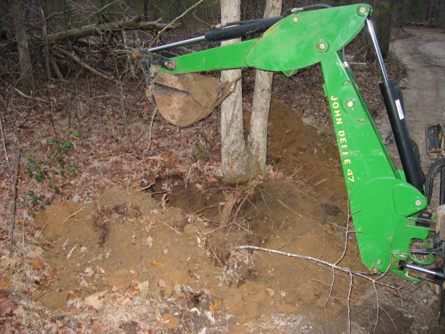

Maybe Eddie can give us some advice here.
Somehow I think it might be safer to dig first, then push. My reasoning is that if I break some roots by pushing, I can't see which ones, and having the tree come over while digging is clearly less safe than while pushing.
Now, I have a FOPS, and a fair amount of reach on my hoe, which makes me more comfortable. With only a ROPS, I would be a lot more comfortable with digging around a "virgin" tree than a stressed one.
Your already broken-off tree is going to be harder to push over than a full tree. A lot of the weight is gone.
I think my broken off tree is too big to go without digging. The part remaining has a bend that is heading downhill. But I don't think that will be enough to get it to move. Also its a sweetgum and they have tap roots. I'm going to give the tree a budge with the BH and watch it laugh at me. Then I'll dig. :D
With my 48 BH pushing without digging is only going to work on 3-6 inch tress. Maybe. I just don't think it has the ooppmh. But the book aid to push first. :D So I'll try to see if it possible with little trees.
I have spent anywhere from 5 minutes to at least 8 hours digging up a single stump. If I can use the BH to get the tree down that will a huge timesafer. Unfortunately I still have lots of 24-36 inch stumps that I'll dig up. They seem to get easier as they age and rot. :)

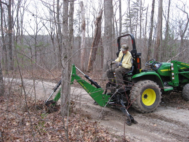

This may already have been suggested but anyway, get a "spotter".
Get someone to watch you, the tree, the tractor, and anything else while taking down the big tree.
They should be away from the action far enough to see everything yet close enough to get your attention if something is not right. Get them a referee whistle or air horn and to use it if they see trouble.
For you the tractor or chain saw operator-
Keep your escape route in mind. As you are focused on the task, listen for noises that don't sound right, or for someone shouting, or for a warning.
If something goes wrong, where will you go?
Be quick of mind and fleet of feet as needed.
Saws and tractors can be replaced, you are one of a kind.

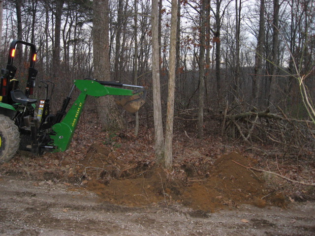

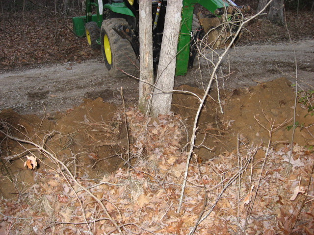

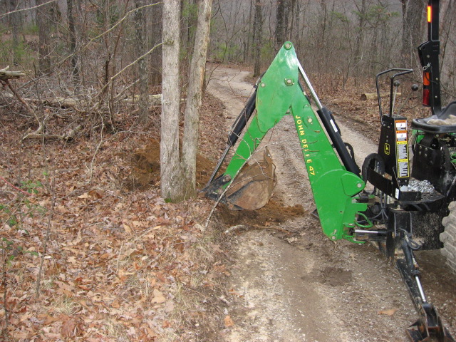

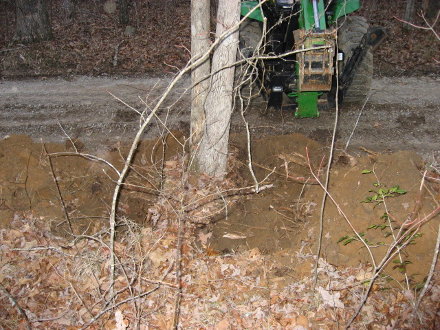

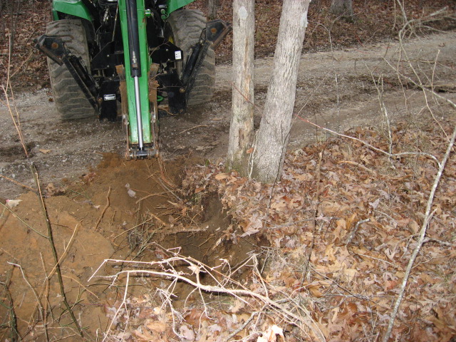

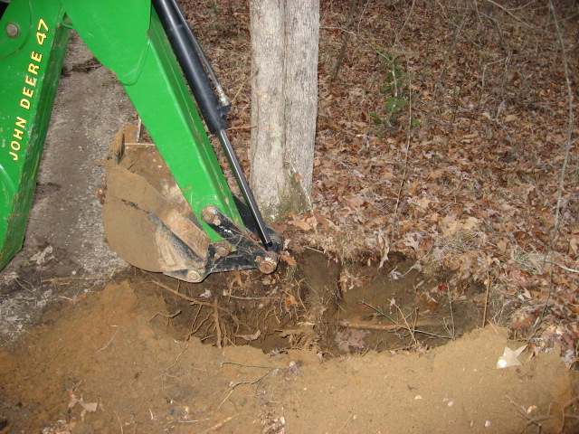

When I dig the "fall" side trench, I usually have the tractor sitting about where the tree will eventually land. If I feel the need to get right under the roots & I can't reach from there, I'll move over & get it diagonally after the trench is as deep & wide as I want it. Strangely enough, it's possible to be too CLOSE to what you're digging. Setting the tractor a little further back may allow you to get under the root ball better.
I noticed the size of your bucket. I'd say it's the ideal size for the job. I can't really tell from your pictures, does that bucket have teeth or a cutting edge? I've found that the perfect bucket for tree work is about 10" wide with a cutting edge. This makes it easy to chop through roots on the way down. If the edge of the bucked is even moderately sharp, you can whittle away at some pretty big roots & save a lot of digging.
On your second practice tree(s):
Looks like two trees to me.
Can you get the tractor in behind those trees? (opposite side from the road)
If so, I'd drop them directly across the road. Dig the "fall" side trench for both trees, then work on the smaller trunk first. You'll know if they both need to go together by the time you finish digging up the edge of the road.
Hehehe...I'm writing as I read again. Eddie & I have opposite ideas as to which way those two trees need to go. Either direction is right. Just depends on what you want to do after they're down. On the road makes it easier to dispose of them. In the bush makes it easier to ignore them.

Judging by the action shots, I suspect he has that half way covered. I'd recommend getting a couple of those little aerosol horns for the spotter to carry. Tractors & chainsaws are noisy.
