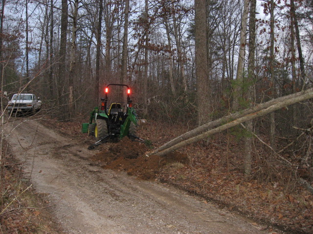

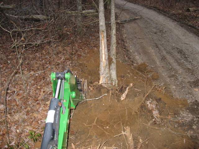

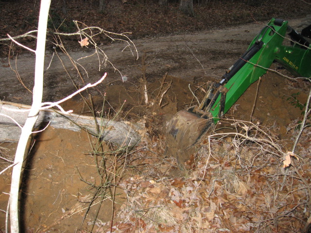

Notice that the tree is not lying completely on the ground yet. The guide roots on each side of the tree are still holding. Thus I took a few bites on the remaining roots on each side of the tree. The tree laid flat on the ground once these roots were cut.

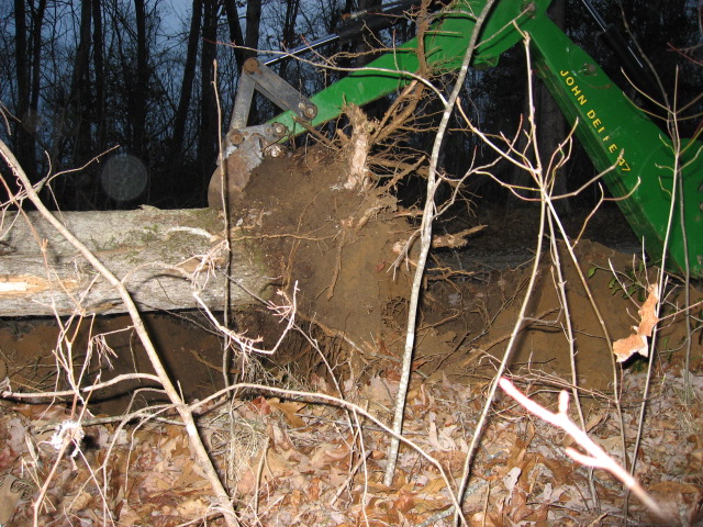

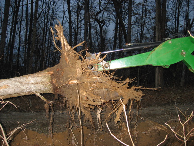

Here's the prize! After cutting the roots on each side I then cleaned as much dirt of the root ball with the backhoe.

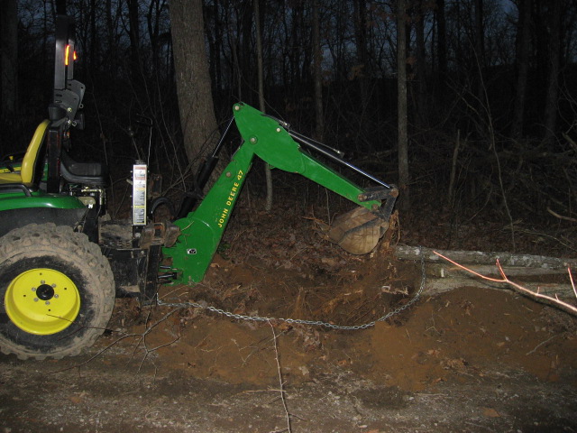

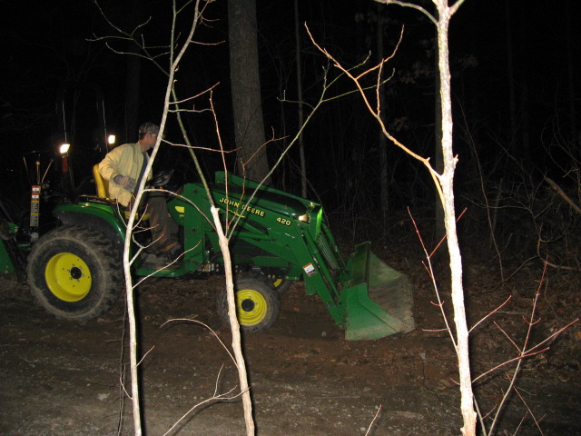

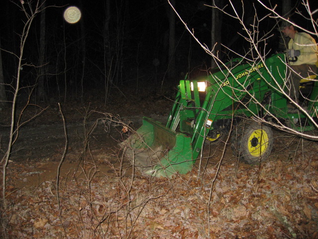

I hooked a chain around the tree and dragged it off to my stump dump. Then I filled in the whole with the FEL. You can't tell a tree was ever there!
