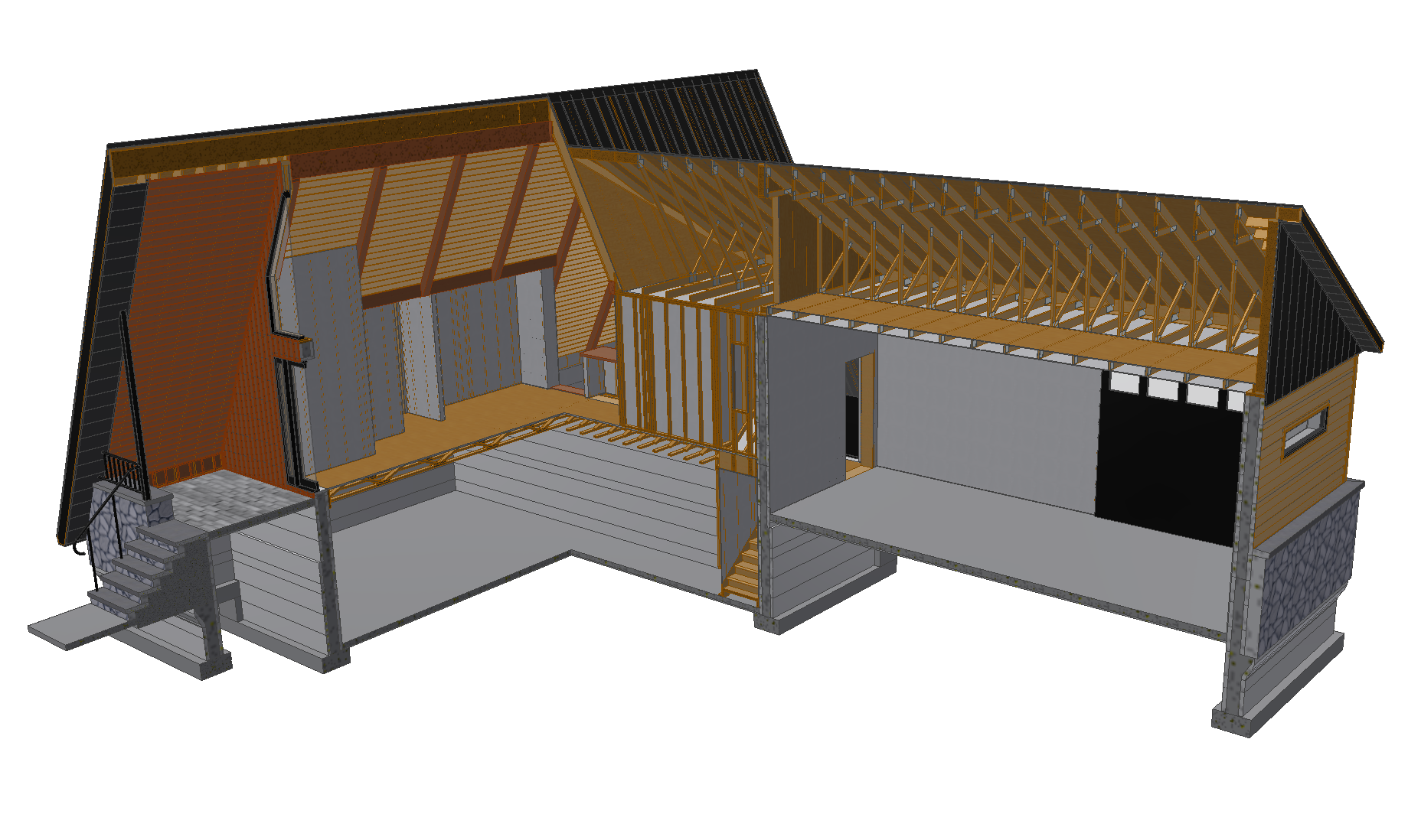

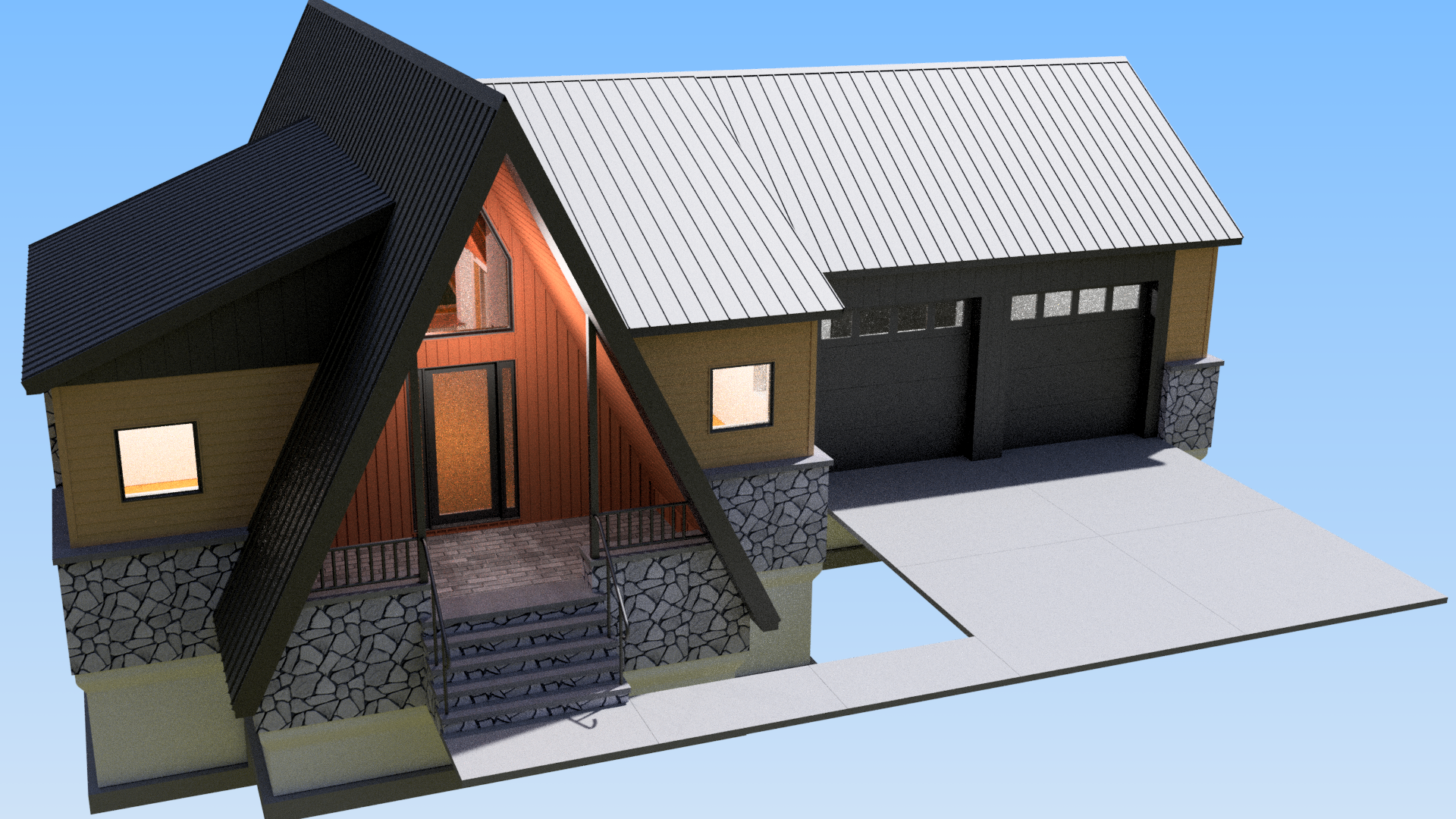

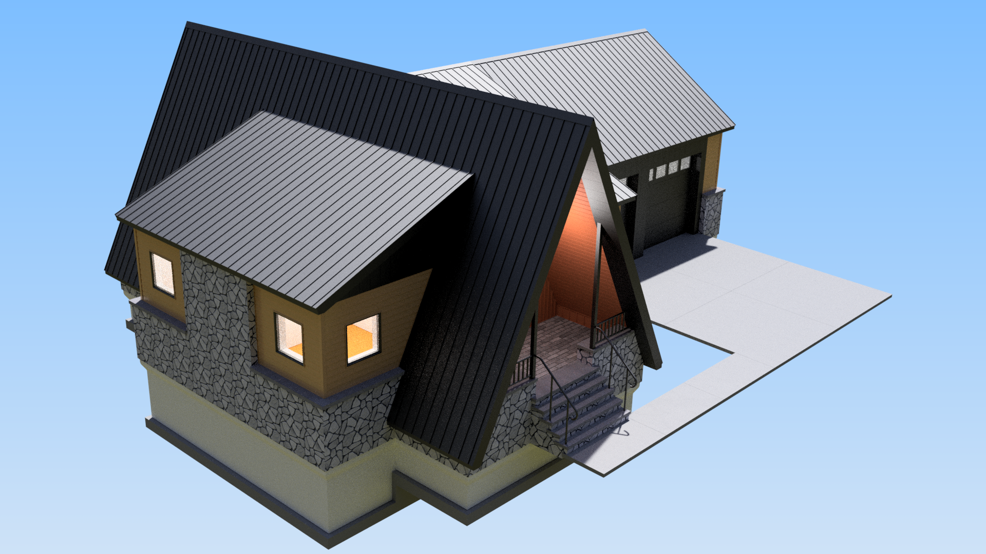

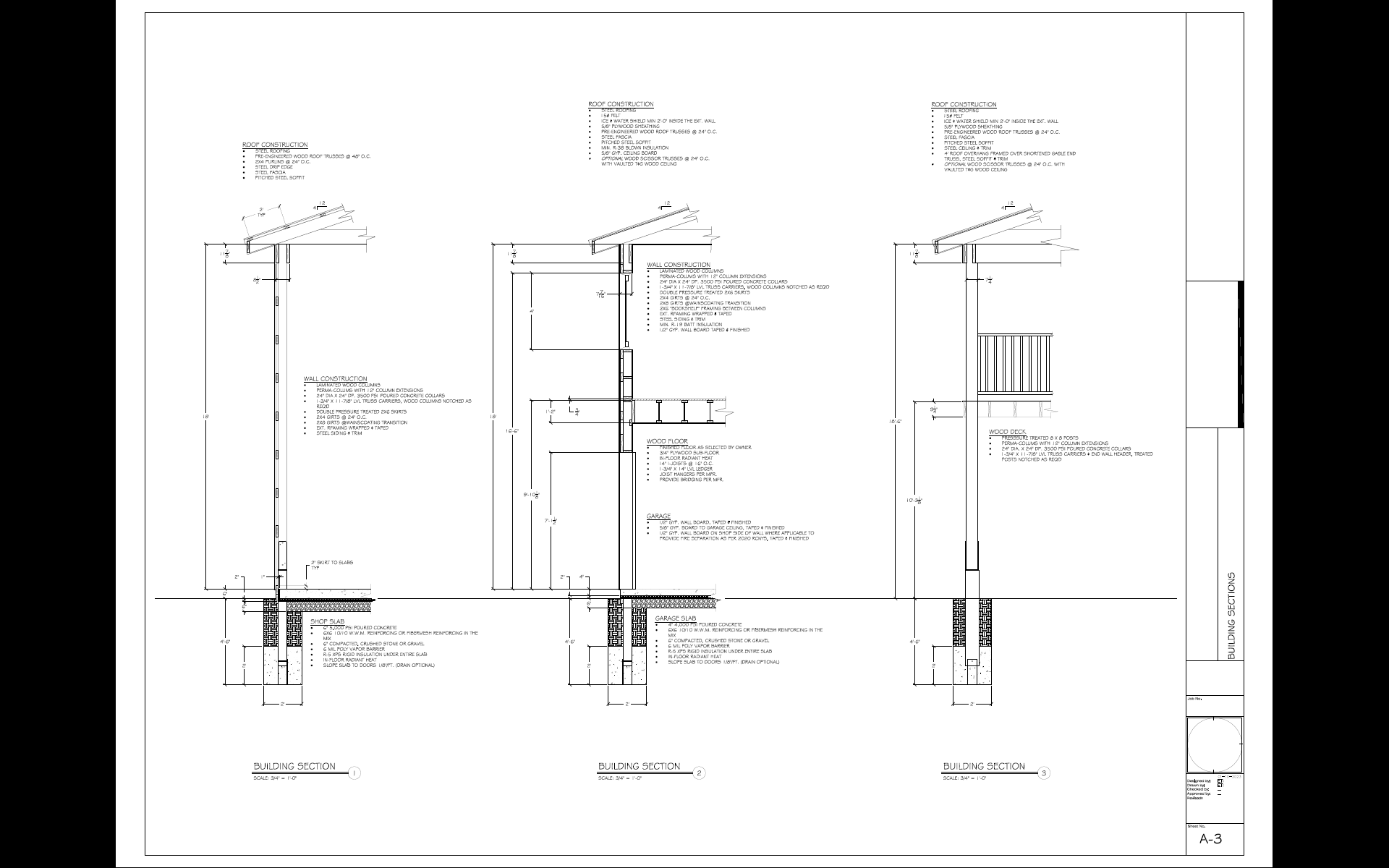

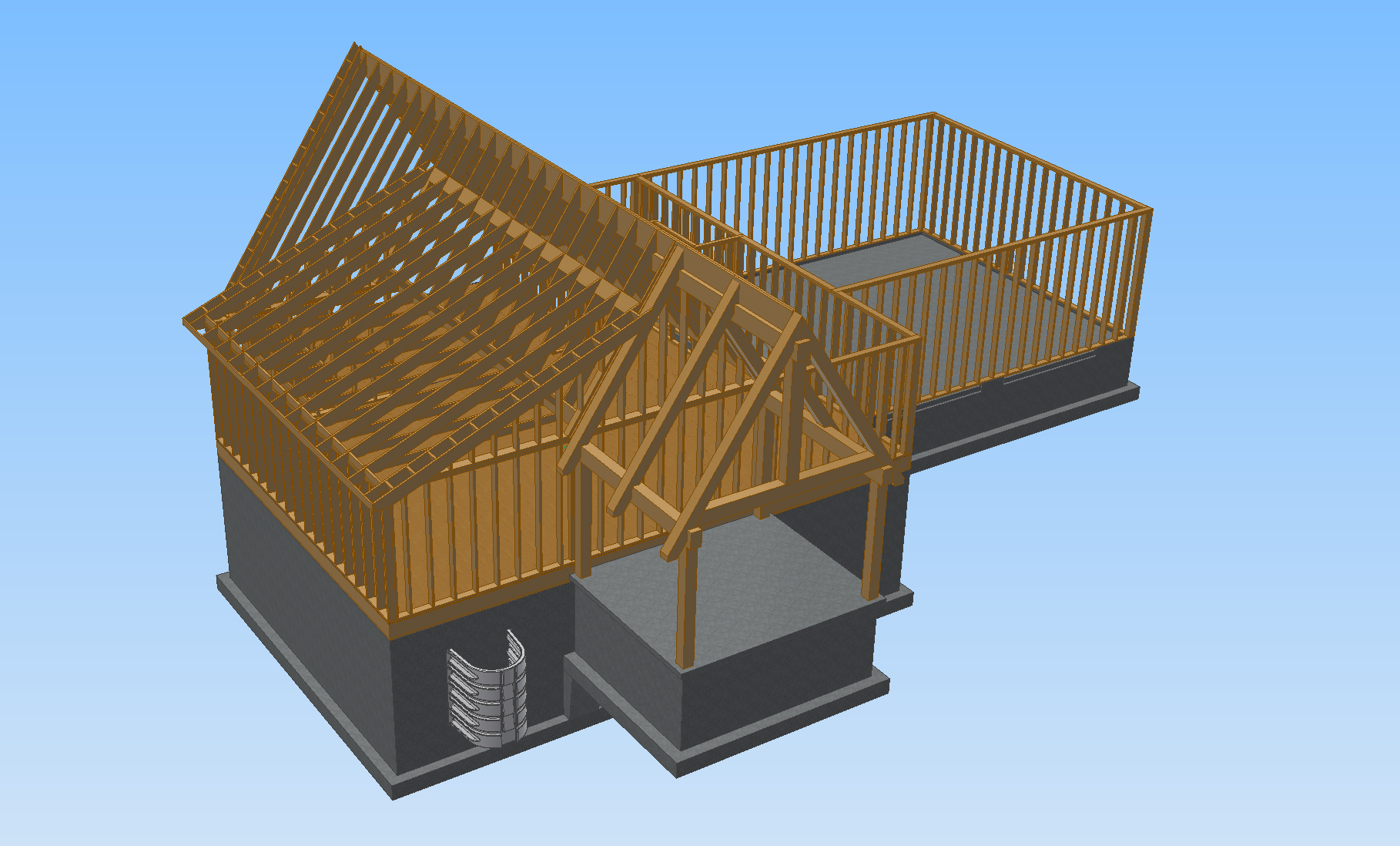

When the ICF estimate came back so high, I did start working on a stripped down stick frame version:
Poured foundation walls, 8ft 1st story walls instead of 9ft. Just a parking garage, no car lift, so "normal" 4" slab. 18-12 pitch on the faux a-frame as opposed to 24-12, no natural stone veneer, etc.
If the ICF estimate comes in still too high this time maybe I'll revisit this version.
Love the drawings. Wish you were our next door neighbor when wife was trying to figure out our floorplan. She would have baked you a great batch of cookies for your designs. :)

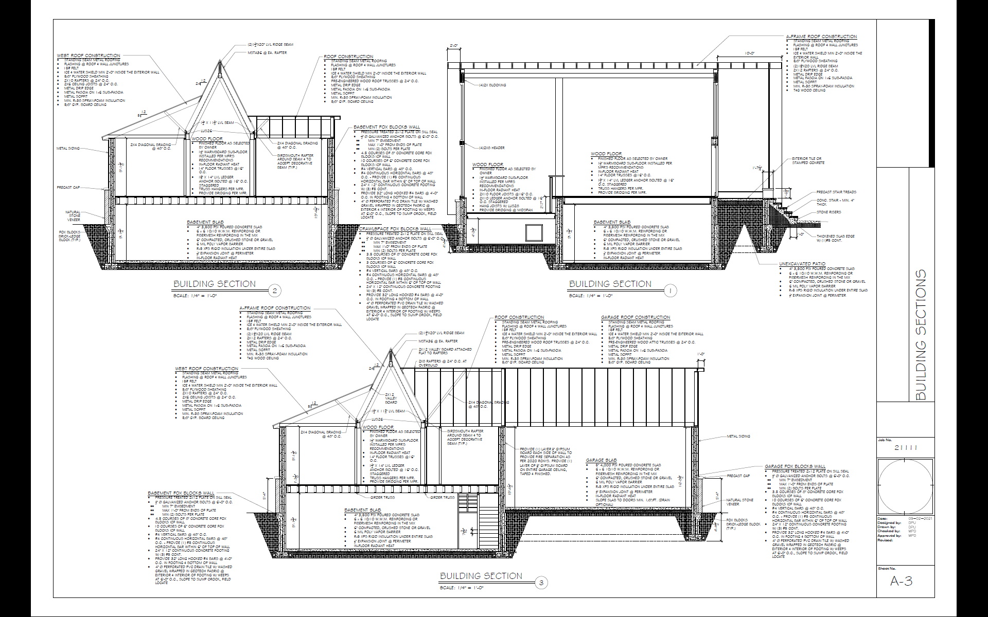

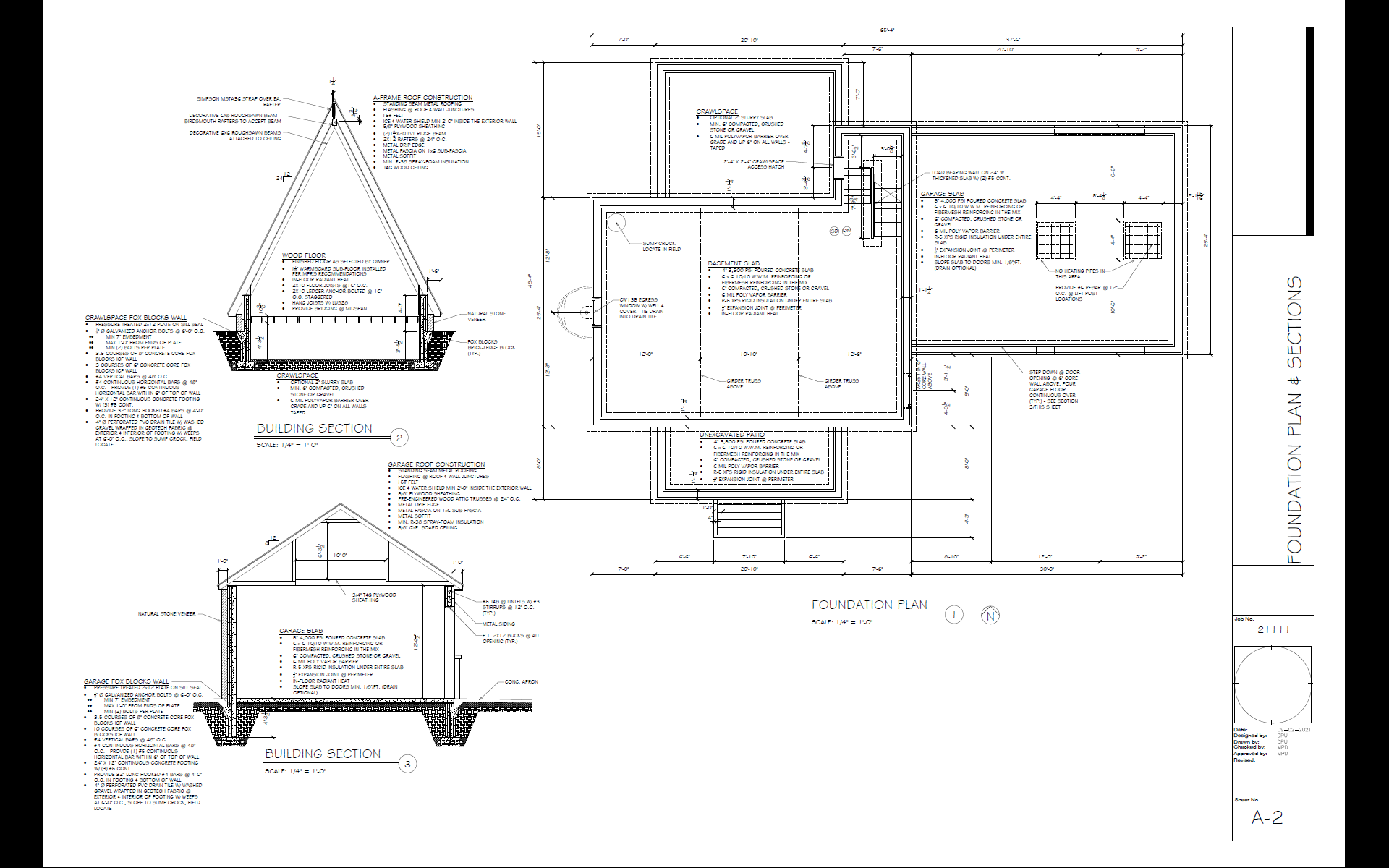

   / Barndominium/Shop or "real" House? #76

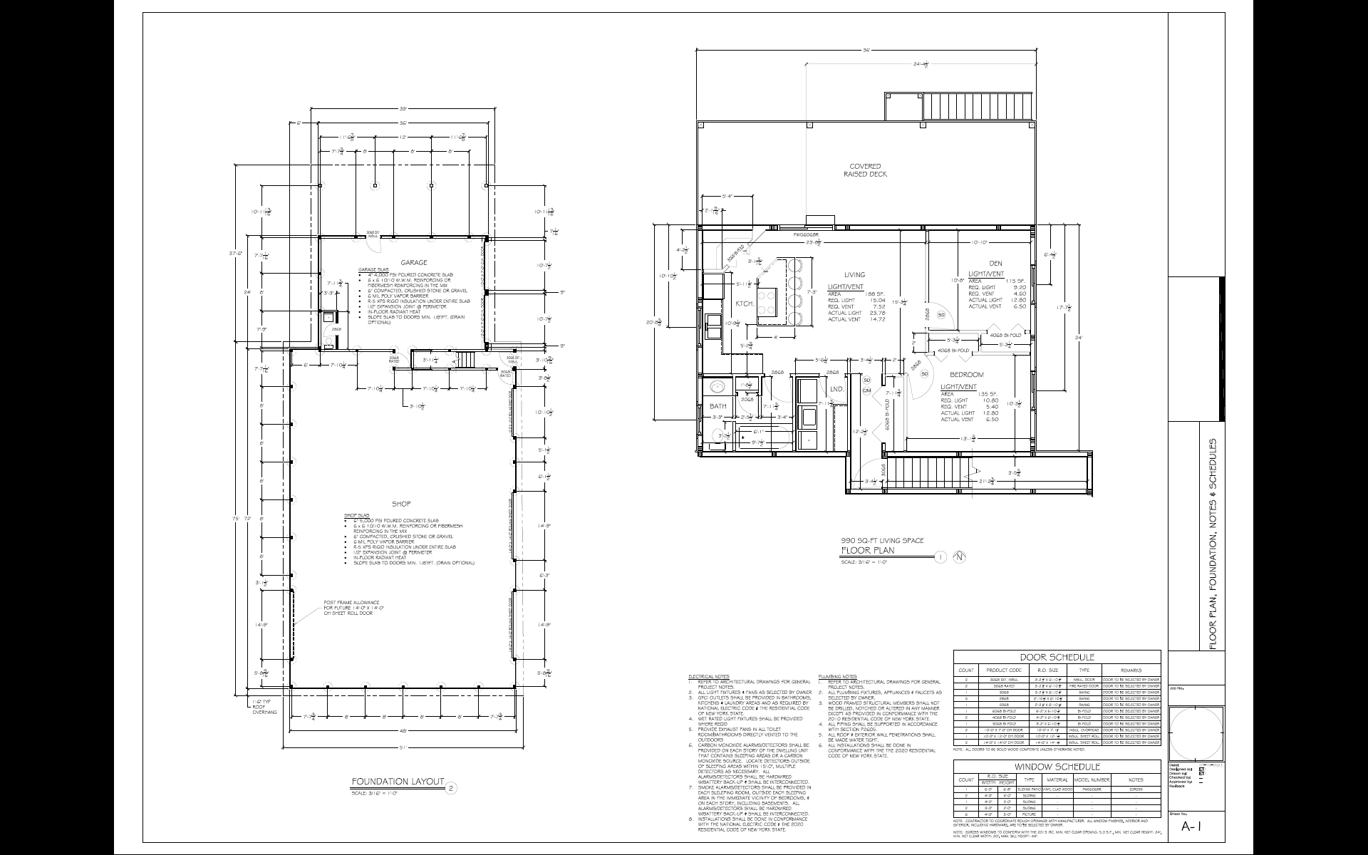

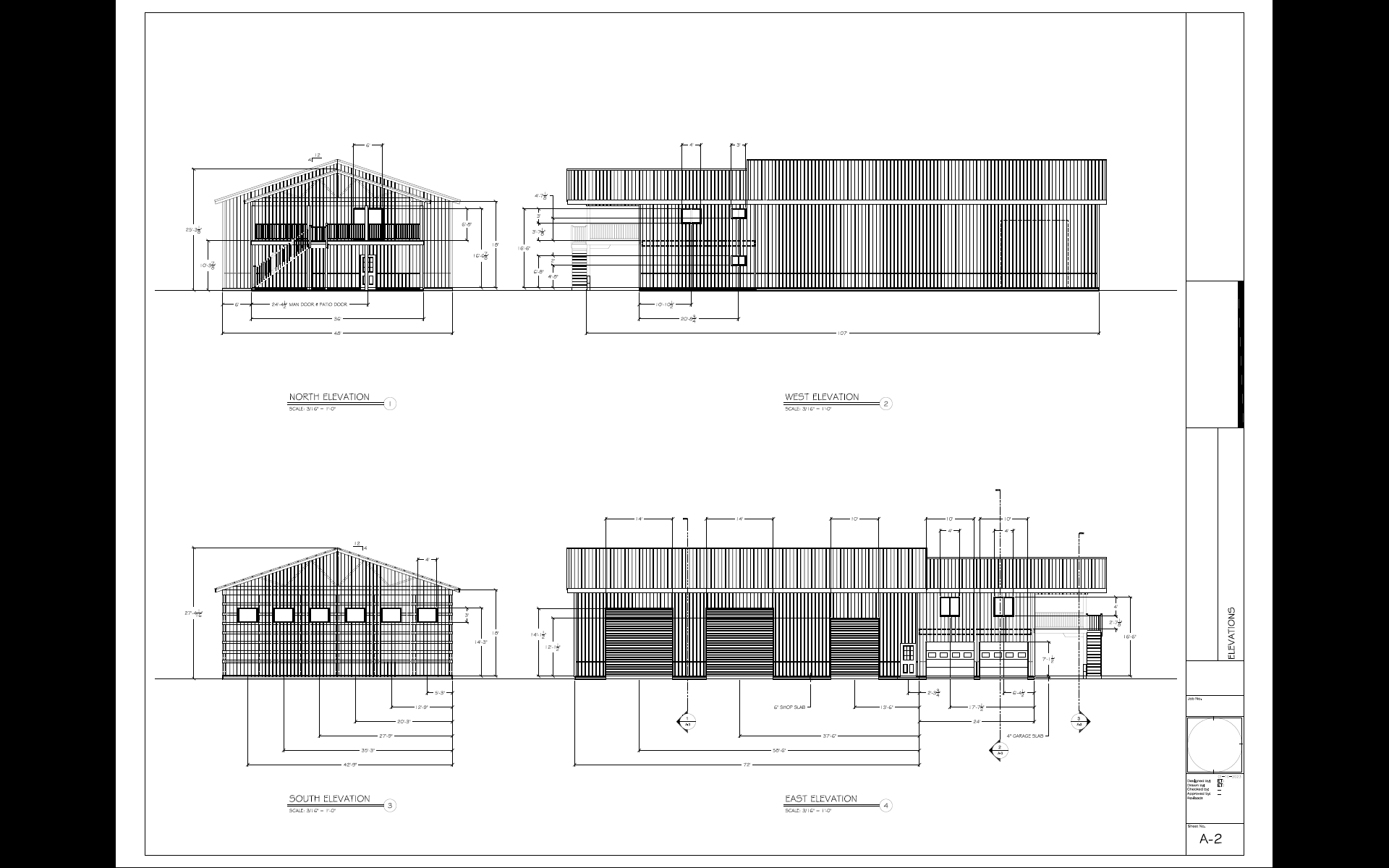

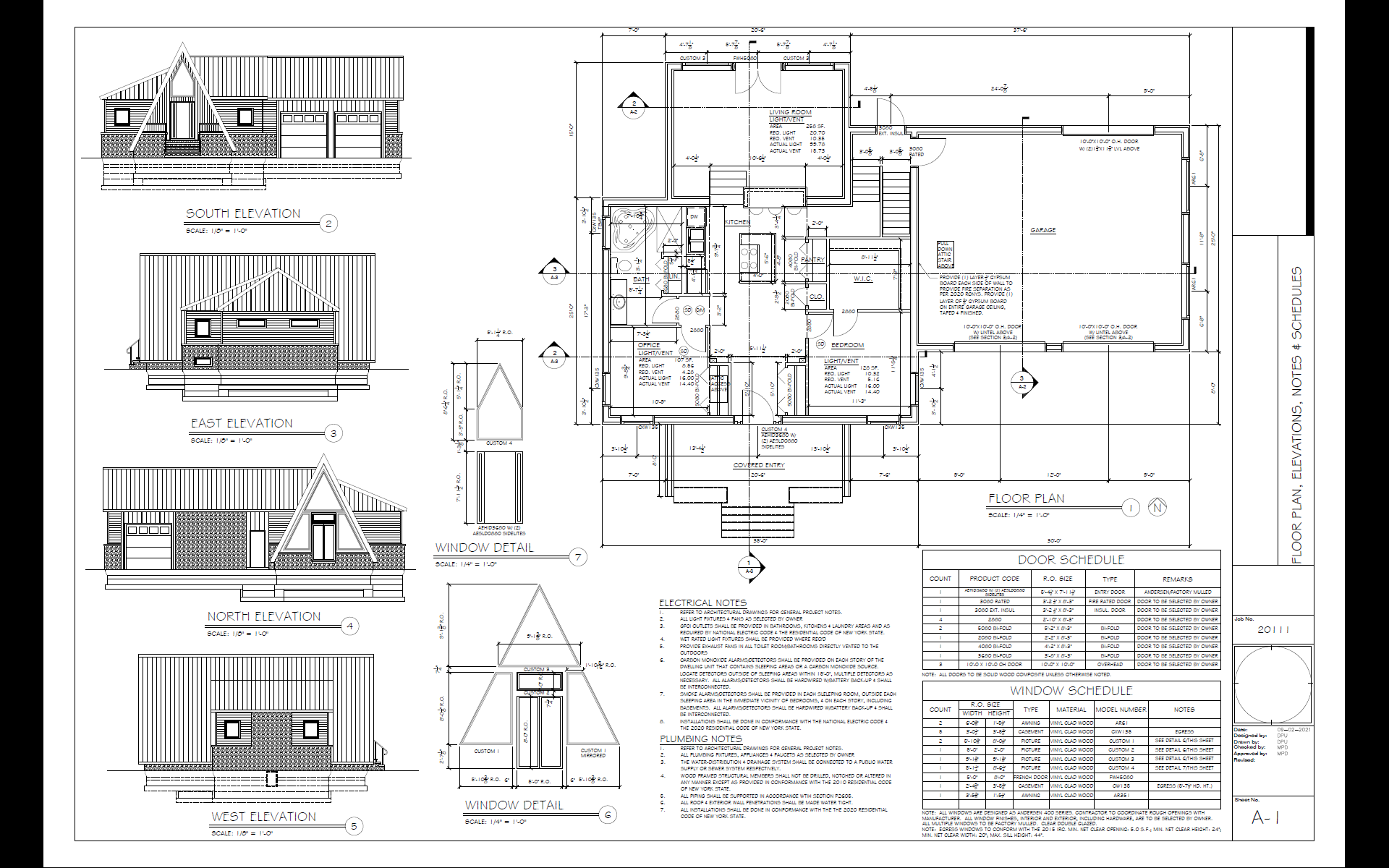

So, been wanting to build at a lot that I have owned for nearly 20 years now. I think I am finally in a position to do so, albeit at the worst time to build... That's my luck.
I have attached my shop/living space design. Talked to various residential and post frame builders. Many of them suggest bookshelf framing the garage and upper living space portion of the structure. Most of them recommend sheathing the garage and living space walls with 7/16" OSB and the living space roof with 5/8" OSB before the steel siding and roofing is installed. One of the builders thinks that's just a waste of money and that the steel provides the anti-racking for wind loads just fine. Thoughts? Will drywall in the living space be subject to more cracking without the sheathing?
The 10 X 12 OH door bay will be for a 2 post asymmetric truck lift. The 14 X 14 sheet roll doors will be in a 48 X 48 area where I'd like to have a 5-7 ton bridge crane someday. Want to go with sheet roll doors to make sure the doors do not interfere with the future shop crane.
The living space is minimal, per the municipality, I cannot go under 900 sq-ft living space, this design ends up at around 990 sq-ft.
I have also attached an ICF design as the "real" house option. Both designs are of my own making, but RA's have looked at both and they will be stamped, which is required in my area.
One of the builders is looking at both of these designs and will be pricing out the builds for me. (For either design I will be helping with labor wherever I can digging my own trenches, etc, but I do have a fulltime job) If they are similar in cost, what would you build? This would be my final residence, so the decision is a life decision...
I really want a shop ASAP because I am almost 50 years old and sick of working on my equipment outside in the weather.
At the same time, a "real" house would be nice as opposed to living in a barn. Not to mention it is an upper story with stairs that I will have to deal with the rest of my life.
If I were to build the ICF house, that puts out my shop probably at least another 5 years.
The ICF house design has a decent garage and will have provisions in the floor for the asymmetric truck lift. So I will have somewhat of a shop to tide me over until I put up a larger structure for working on my equipment. (Not an contractor of any sort, equipment is personal/hobby stuff).
