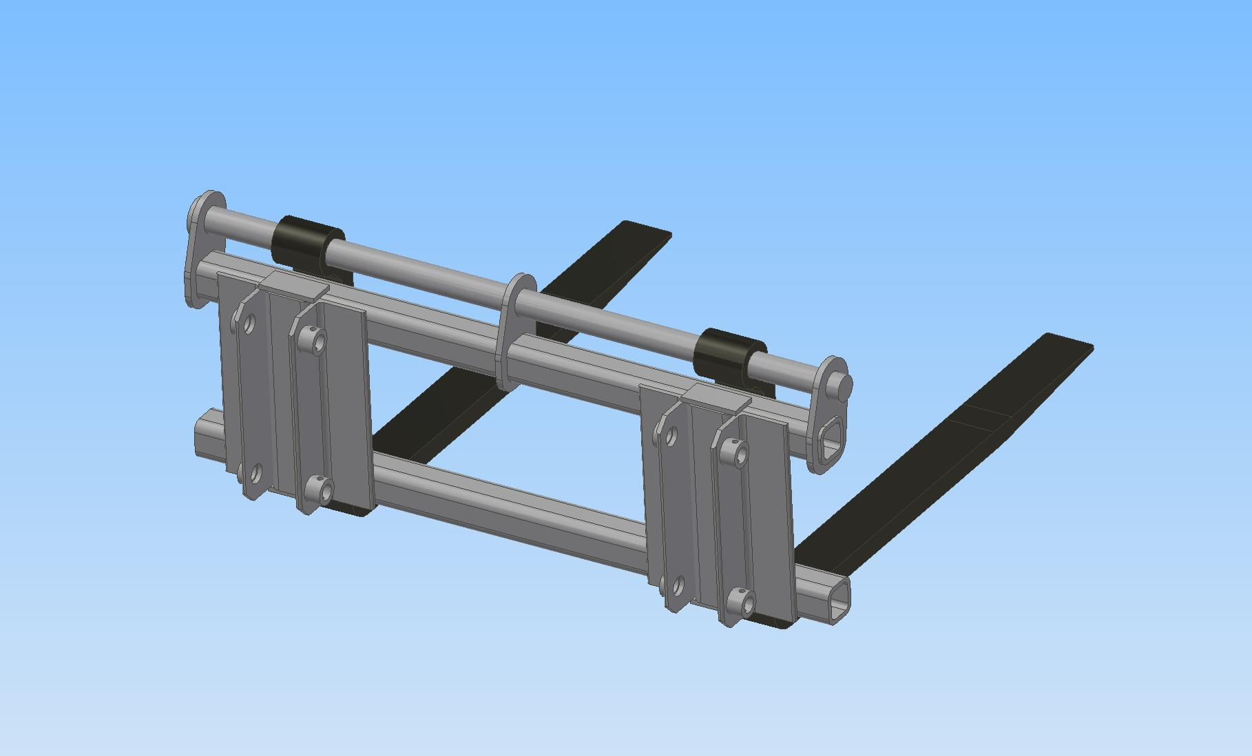

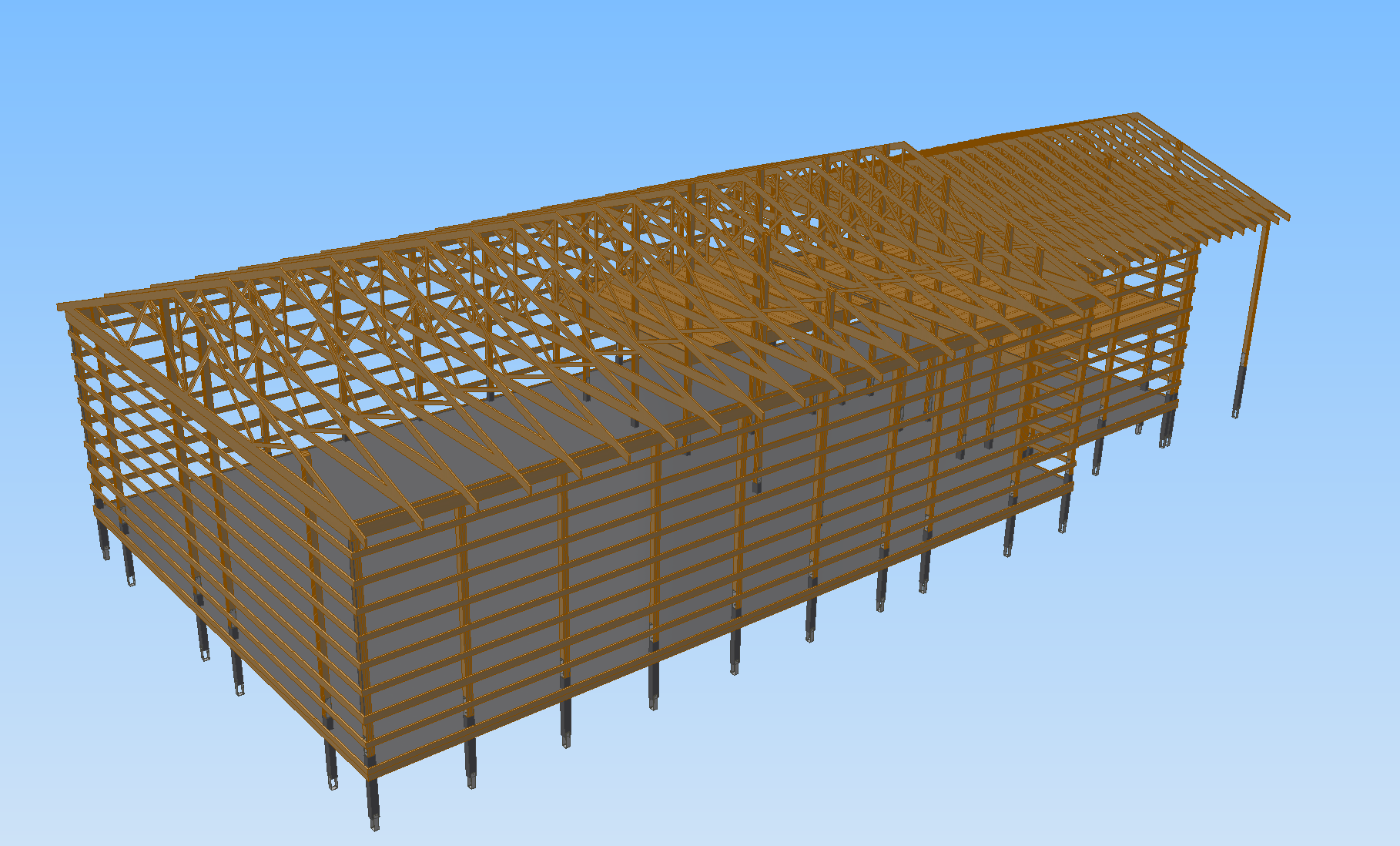

The attached renders is what I had in mind when I first designed the ICF house. I soon realized all the "fancy" stuff like natural stone veneer, clear span floor diaphragm via the floor trusses etc, caused the build cost to skyrocket. The faux A-Frame was another feature that cause builders to freak out. So I'm thinking, be it ICF or stick frame, that design while only being 1243 sq-ft is very expensive to build due to the way I designed the home. So I'm very curious to hear what this latest builder has to say for the build cost of that design. I've only had one builder give me an estimate on that ICF design and he came in at $460/sq-ft! All the other builders at the time no-quoted the build...
What design software are you using?

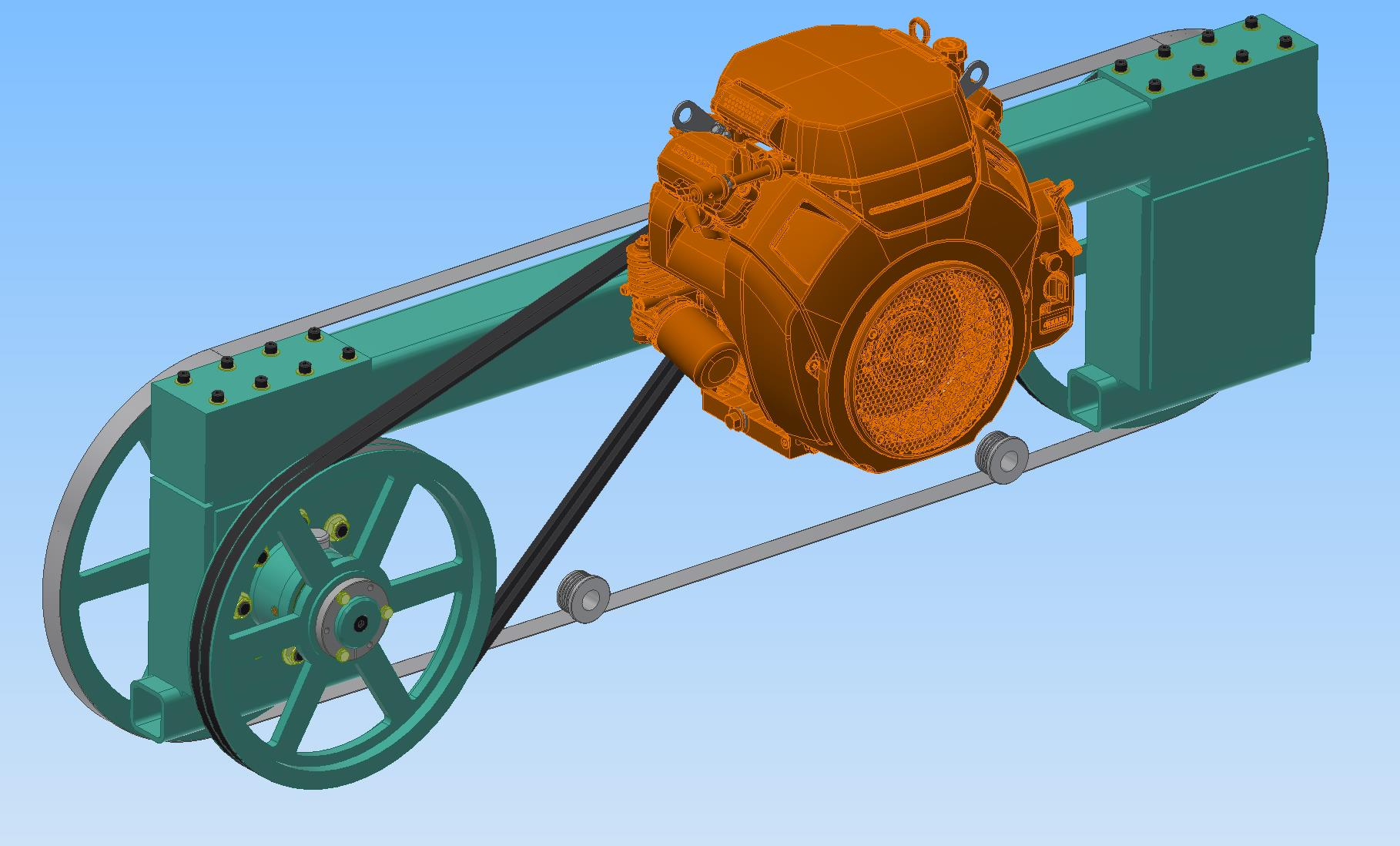

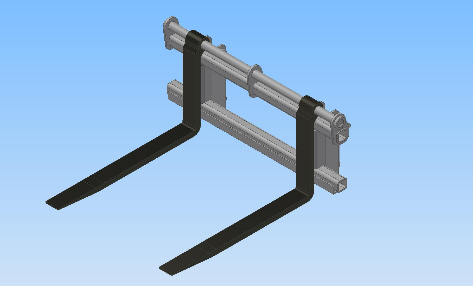

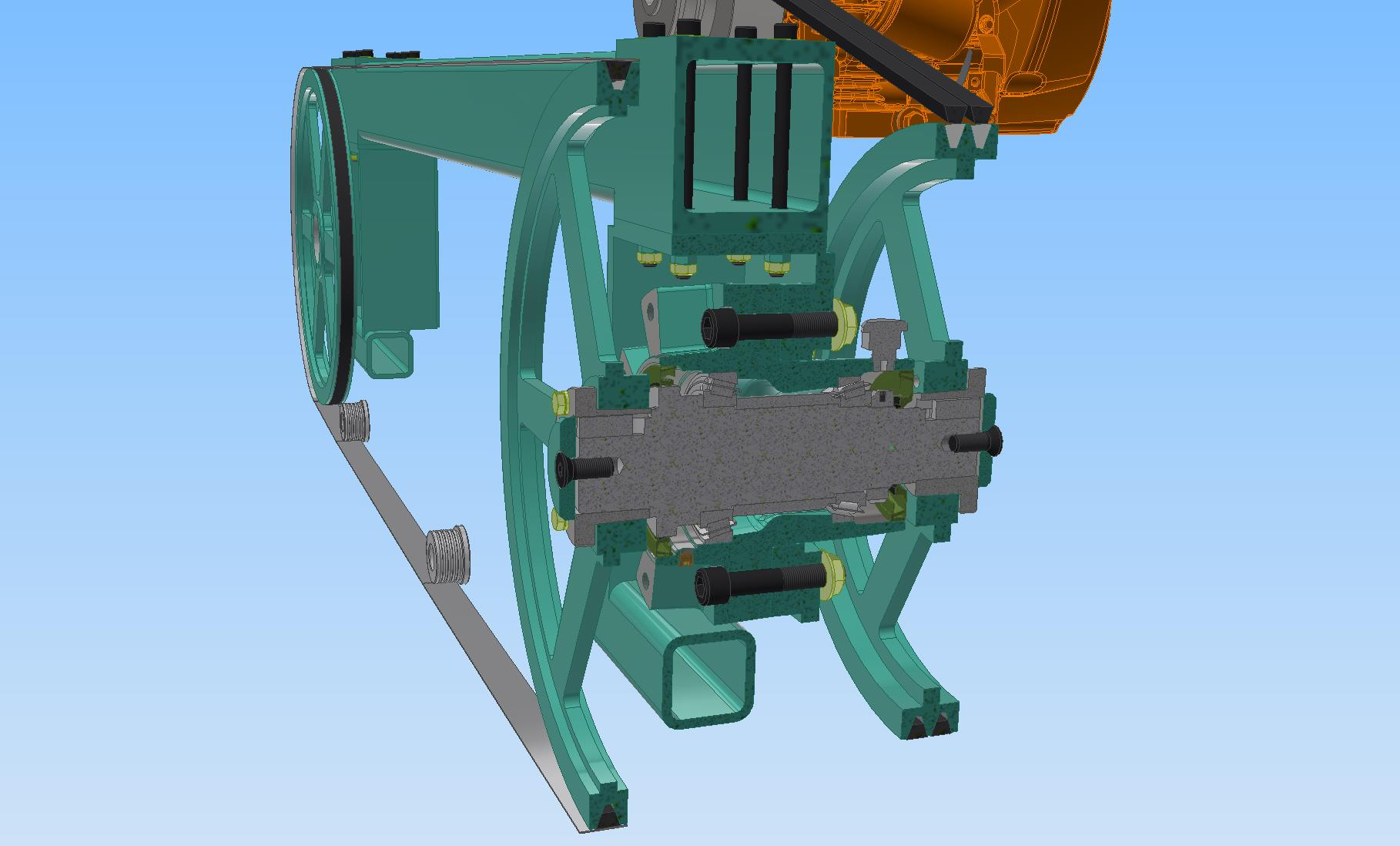

I'm a mechanical design engineer, so I use primarily AutoCAD for 2D work and Autodesk Inventor for 3D work. Inventor is not really for architecture but it's what I know...

I used SolidWorks about 24 years ago, but then my company switched to Inventor. I have tried the Home Designer software but didn't like it. I also have access to Autodesk Revit, which is what *should* be used for architecture, but it's quite a different animal from SolidWorks/Inventor. I didn't want to put in the time to learn it, so just used Inventor.
It's a bit overkill, a house can be designed in 2D in AutoCAD, but modeling things in 3D first helps me to visualize what I think I want etc...
I use 3D design for every project, it just helps me when I'm actually building/fabricating, knowing that I went through everything step by step in CAD before cutting, welding, etc
I simply have endless projects... It's really why I need a shop badly and am heavily leaning towards the Barndo build...

My ICF design has a full basement under the main living space. It's only a crawl space under the living room. I could add that as part of the basement, but it adds a decent amount of cost. And yes, I have to go a min of 42" below grade for the footing up here in WNY.
But add in the extra 32in I need to get down to the footing, then another slab under the living room. I mean yeah, I hate wasting that, even hate wasting the area under the front porch. If I had more money I would increase the footprint of the basement.
The estimate I received back on this ICF design in 2021 was $460/sq-ft ($570k to build a 1243 sq-ft home, nope, I can't afford that), the builders' estimate for all the ICF and concrete (not including the stone veneer) was $120k. I'm curious what this new builder comes back with for an estimate in 2023.

You mean a Barndominium? The building inspector was the one who turned me on to the idea. Once my design is complete after tentatively selecting a builder and optimizing the build per the way that particular builder wants to construct it, I have to have a Registered Architect inspect my plans and stamp them. That's the stage where all the legalities are ironed out.
Now, I will say, my design might be stretching the definition of a "Barndominium".
The ICF design has already been stamped by an RA, it's ready to go, I just can't afford to build it.
