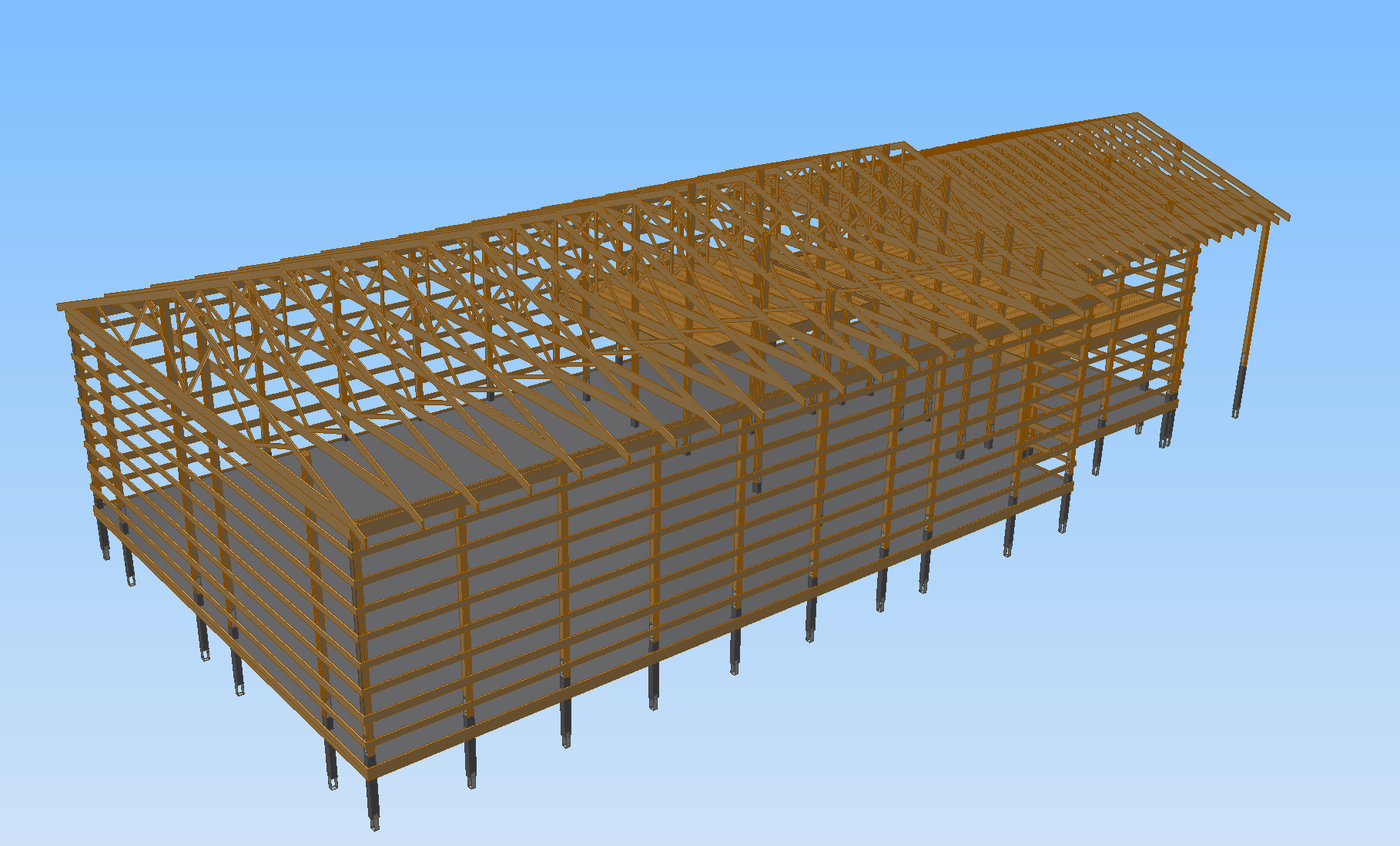

What design software are you using?
I'm a mechanical design engineer, so I use primarily AutoCAD for 2D work and Autodesk Inventor for 3D work. Inventor is not really for architecture but it's what I know...

I used SolidWorks about 24 years ago, but then my company switched to Inventor. I have tried the Home Designer software but didn't like it. I also have access to Autodesk Revit, which is what *should* be used for architecture, but it's quite a different animal from SolidWorks/Inventor. I didn't want to put in the time to learn it, so just used Inventor.
It's a bit overkill, a house can be designed in 2D in AutoCAD, but modeling things in 3D first helps me to visualize what I think I want etc...
I use 3D design for every project, it just helps me when I'm actually building/fabricating, knowing that I went through everything step by step in CAD before cutting, welding, etc
I simply have endless projects... It's really why I need a shop badly and am heavily leaning towards the Barndo build...
