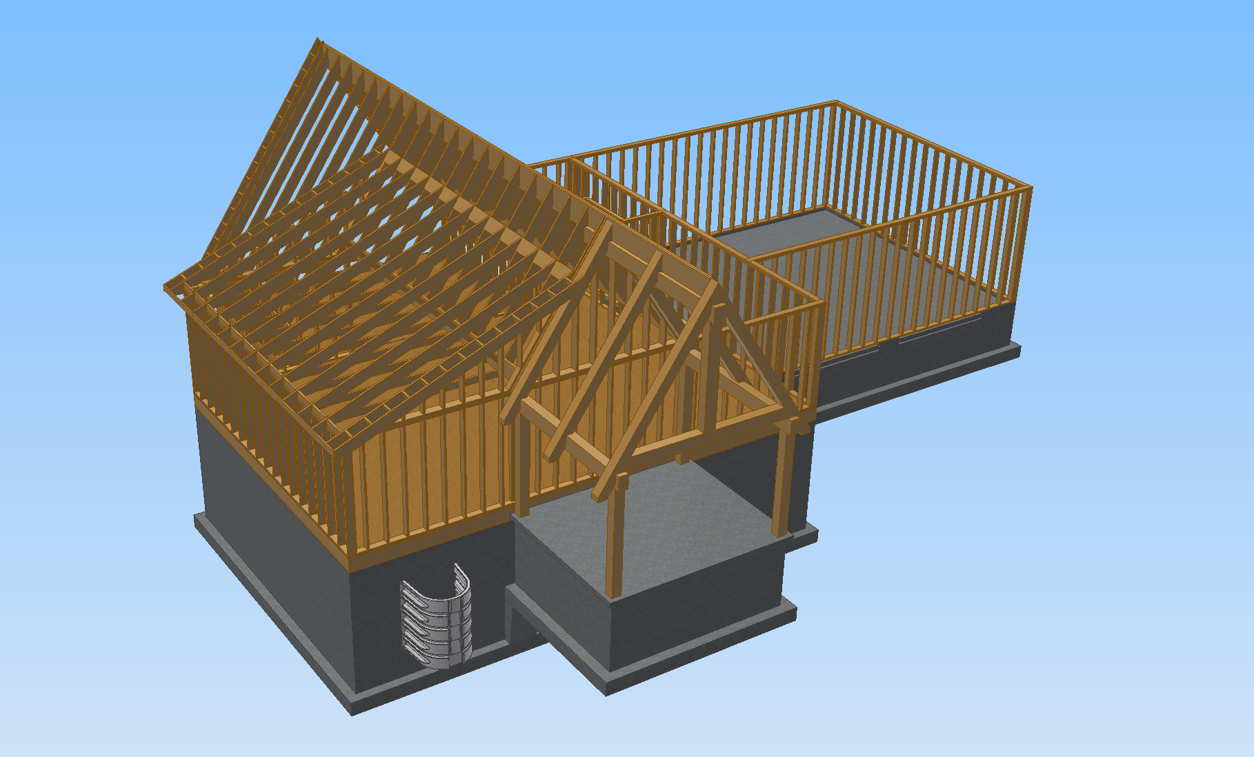

So, been wanting to build at a lot that I have owned for nearly 20 years now. I think I am finally in a position to do so, albeit at the worst time to build... That's my luck.
I have attached my shop/living space design. Talked to various residential and post frame builders. Many of them suggest bookshelf framing the garage and upper living space portion of the structure. Most of them recommend sheathing the garage and living space walls with 7/16" OSB and the living space roof with 5/8" OSB before the steel siding and roofing is installed. One of the builders thinks that's just a waste of money and that the steel provides the anti-racking for wind loads just fine. Thoughts? Will drywall in the living space be subject to more cracking without the sheathing?
The 10 X 12 OH door bay will be for a 2 post asymmetric truck lift. The 14 X 14 sheet roll doors will be in a 48 X 48 area where I'd like to have a 5-7 ton bridge crane someday. Want to go with sheet roll doors to make sure the doors do not interfere with the future shop crane.
The living space is minimal, per the municipality, I cannot go under 900 sq-ft living space, this design ends up at around 990 sq-ft.
I have also attached an ICF design as the "real" house option. Both designs are of my own making, but RA's have looked at both and they will be stamped, which is required in my area.
One of the builders is looking at both of these designs and will be pricing out the builds for me. (For either design I will be helping with labor wherever I can digging my own trenches, etc, but I do have a fulltime job) If they are similar in cost, what would you build? This would be my final residence, so the decision is a life decision...
I really want a shop ASAP because I am almost 50 years old and sick of working on my equipment outside in the weather.
At the same time, a "real" house would be nice as opposed to living in a barn. Not to mention it is an upper story with stairs that I will have to deal with the rest of my life.
If I were to build the ICF house, that puts out my shop probably at least another 5 years.
The ICF house design has a decent garage and will have provisions in the floor for the asymmetric truck lift. So I will have somewhat of a shop to tide me over until I put up a larger structure for working on my equipment. (Not an contractor of any sort, equipment is personal/hobby stuff).

I'm quite amazed how much this has come up. I did put some thought into my options about age & stairs, but not to the degree expressed by many here...

My shop design has 18ft walls partly due to needing the headroom in the second story living space, but also due to my desire to have a bridge crane. Most of the builders are recommending 4 ply 2X6 columns, one of them recommending 3 ply 2X8 columns. None of them said stick frame, maybe due to wall height...
I'm doing a 60 x 72 x 18 Ft H post frame residence / garage. Used 3-2x8 posts at 8 ft OC on sides, set wood posts on Permacolumns that bear on 24"diameter polymer footing pads. Secured footing pad to permacolumn with 2 galvanized eyebolts to take care of uplift. Backfilled 30" auger holes with dense grade aggregate for ballast.
Recommend 3- 2x8 cols over 4-2x6; no more material and slightly more strength, due to increased depth (thickness) of timber.
FWIW; I like your shop design over the A-frame design, only thing I saw; make garage wider; go measure your vehicles with both doors open all the way.
I went back and forth between a 30ft vs 24ft wide garage. I settled on a 24ft wide as I wanted to keep the living space above as close to the minimum 900 sq-ft as possible for tax purposes.
The garage I grew with is 32 ft wide, dual 9ft x 7ft doors and a man door all on the front wall. I know it can be a little bit tight but what I have will work. And tbh, they will most likely wind up being spaces for project cars and not daily driver vehicles.
I might actually change the doors to 9ft x 7ft vs the 10ft x 7ft I have in my current design.
The area under the deck will be where I park my daily driver truck.
My personal experience, based on living with both widths is that 24 foot is livable, but 26 foot makes your life easy Peezy. Especially if you don't like door dings!
I have one builder who is quoting the Barndominium project. I want to see where he comes in at before making changes. I could only find one builder out of many who were even interested in the whole project. It's not great out there for ppl looking to build, that was 2014...
