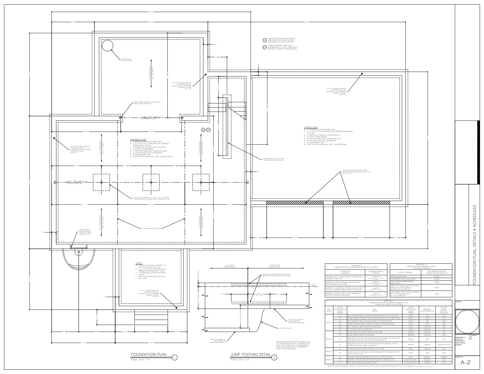

Trying to finalize my foundation plan. Been referencing the 2018 residential code: IRC 2018
I tweaked my footer more in-line with what the code states for a 1 story home in my soil conditions. I had a 24" x 12" footer, it is now 18" x 8".
I am wondering about wall thickness transitions. I have 9ft walls in the basement, code seems to dictate those should be 10" thick. For the porch and the garage I have the walls 8" thick. I don't care so much about the porch because it is covered with a concrete cap. However, for the garage the top of the garage slab sits below the elevation of the garage foundation walls 2", so the thicker those walls are, the more of a step of concrete I have around the inside perimeter of the garge floor. 8" wall, 2X6 sill plus 5/8" drywall = 1-7/8" step. If I can go down to 6" thick walls for the garage and porch there would be no noticeable step around the perimeter. I am referencing some architectural drawings of my brothers house and all the walls are 10" thick. So he has a 3-1/8" step around the perimeter and his garage foundation walls are 8" above his garage slab.
Wondering if it is a pain in the ass ($$$) for concrete contractors to have varying wall thicknesses and I should just have them all at 10" thick?

I had a very good concrete guy. Known him all his life. I completely turned him loose.
I would "assume" they would rather pour them all the same thickness. But I have no knowledge or experience to base that on.
Thanks again for excellent drawings.

When I did mine, I kept them all the same width, just because I made my own forms, and it was easier to do the math for one thickness. For your own knowledge, add up the number of yards it would take to do it at both thicknesses and see how much you'd actually save. Every penny counts on some projects. A good concrete person would have no trouble with varying thicknesses, though.

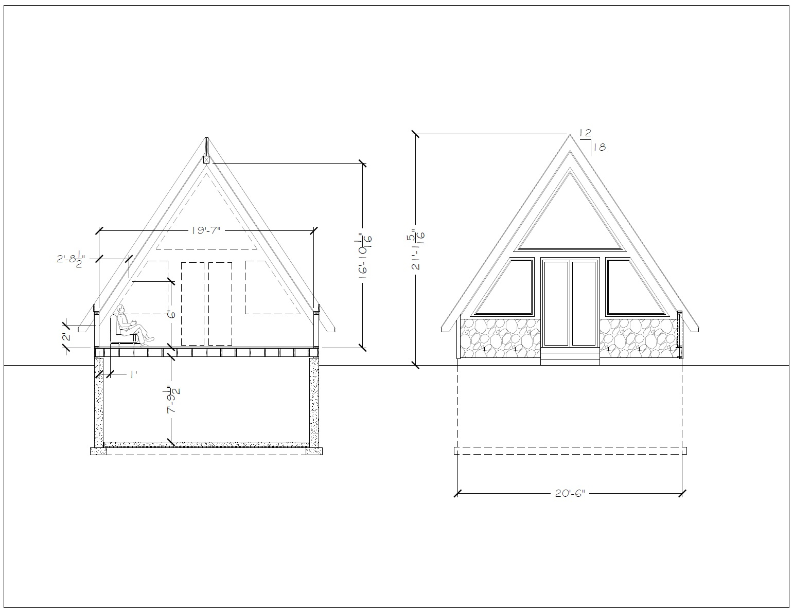

Working on section views, and am on to the A-Frame living room. I don't want to do knee walls because I think the windows look better on the outside non-truncated. I laid out a dude sitting in a chair 1ft from the wall. I'm 6ft tall and I guess the 8X6 decorative beams could be an issue? Maybe not so much for walking but getting in and out of a chair.
Anyone have experience with an A-Frame house or cabin?

That could definitely be questionable. No personal experience here.
In your picture/drawing on the left: My brother has an A-frame house. His couches sit a bit away from the wall in comparison to my couch in standard house build. His recliner sits out like mine. I am about 5'8" and don't have a problem sitting down into couch. Also I don't think people sit down with a straight vertical back, I know my back is usually curved forward to balance myself as I sit down. Along the bottom portion of the roof line behind the chair back area are cabinets. Never looked how deep they are. And his roof line guessing goes down to within 2' of grade level. Where yours show 2' to the floor level. Not sure of his roof pitch. Jon
