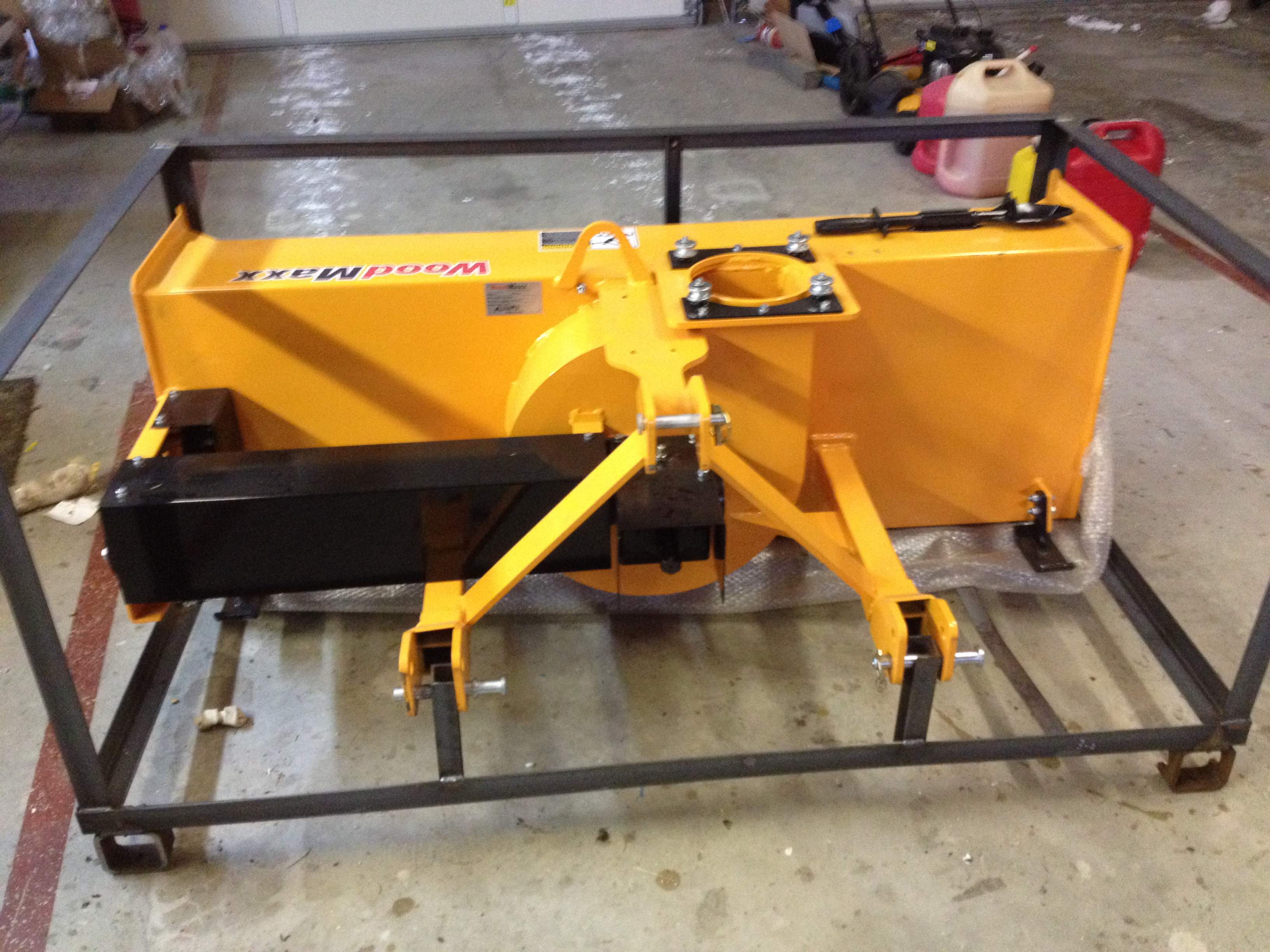

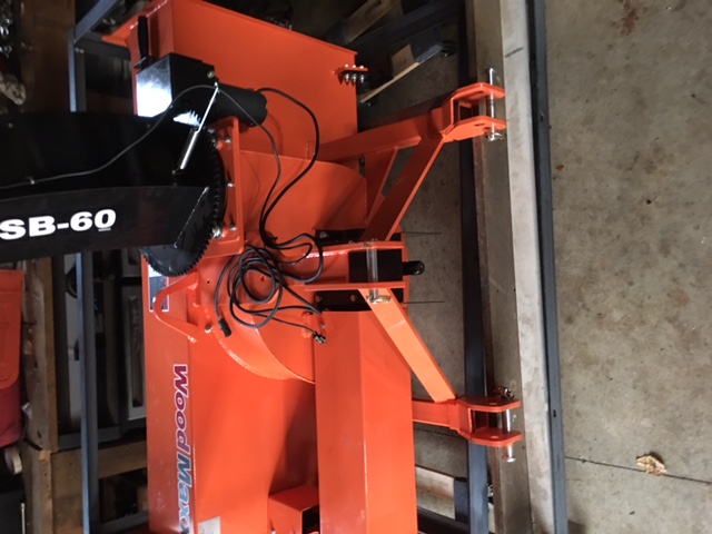

Here are some pics - its still on the shipping crate as I have my BH on yet doing some late fall wood cutting.
- Shipping crate is steel - I intend to cut it down and put casters on it - already got 8 4" casters on ebay and will make two dollys - 1 for the SB and one for the BH for storage

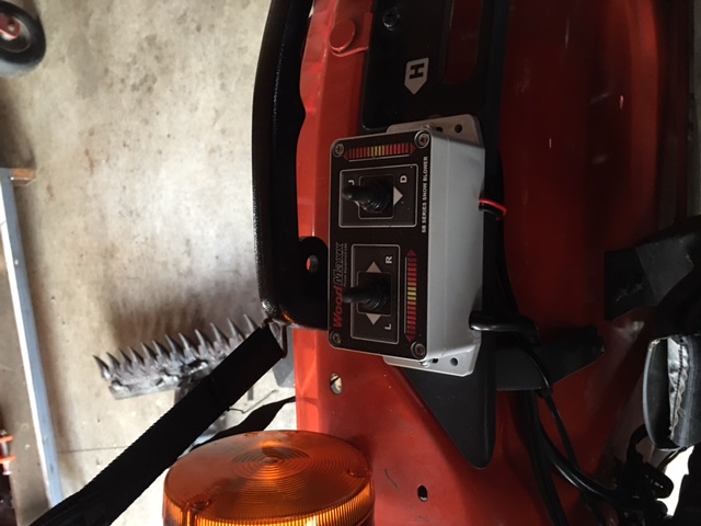

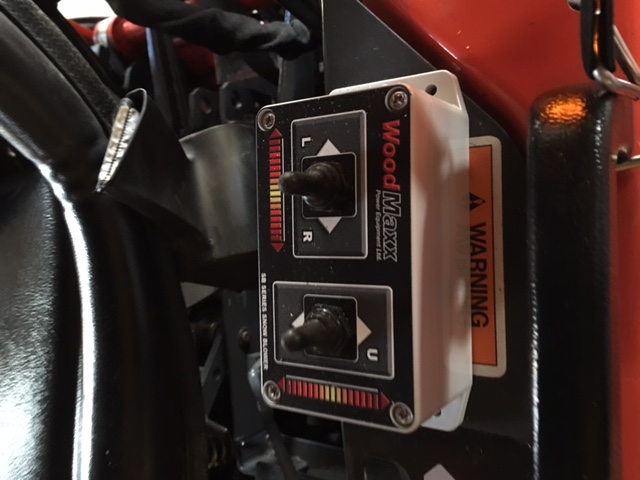

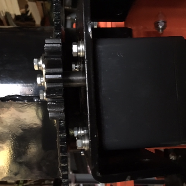

- Electric rotator and actuator - the chute motor is heavy duty and mounting is 1/4" steel - nice covers too - I needed to adjust the gear on the motor to center it on the chute gear - just used a large flat washer under the locking plate - the pic is before adding the flat washer
- Wiring - the chute motor has like a 10' long connection and the linear actuator 7' so when you get them connected they are unequal length they will hook up OK though.
- The bolts for mounting the chute motor I thought were missing so bought new ones - here they were zip tied to the motor leads.

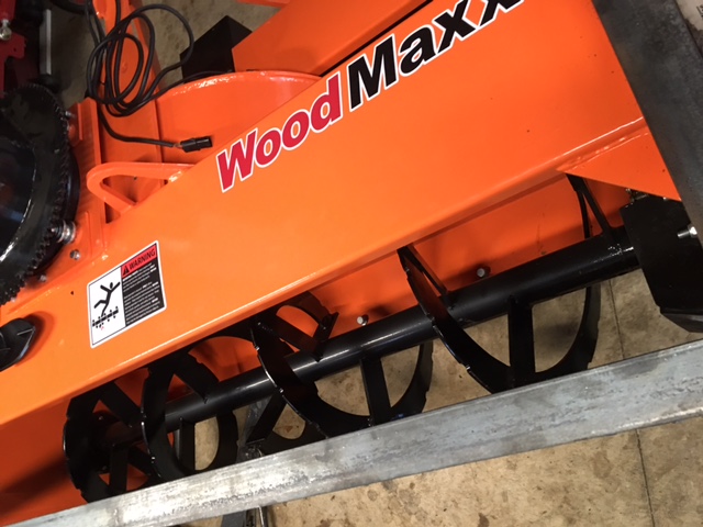

- Impeller run out - about 1/8" as it rotates - they said this is normal... haven't run it yet though to see if this creates any vibration issues. Control 1.JPGControl 2.JPGGear.JPG3Pt.JPGAuger.JPGChute Motor.JPG
All in all a nice unit - you will be pleased I think.
Carl

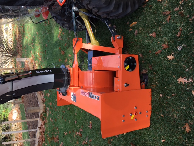

So did you get your SB yet? I have mine mounted now. Have ran it too - seems to run pretty smooth when straight coupled, but when I put the 3PT all the way down it does have a bit of noise and whine in the PTO shaft area.
I have measured the angle and it is 22.5 degrees total so everything I have read indicates this is OK.

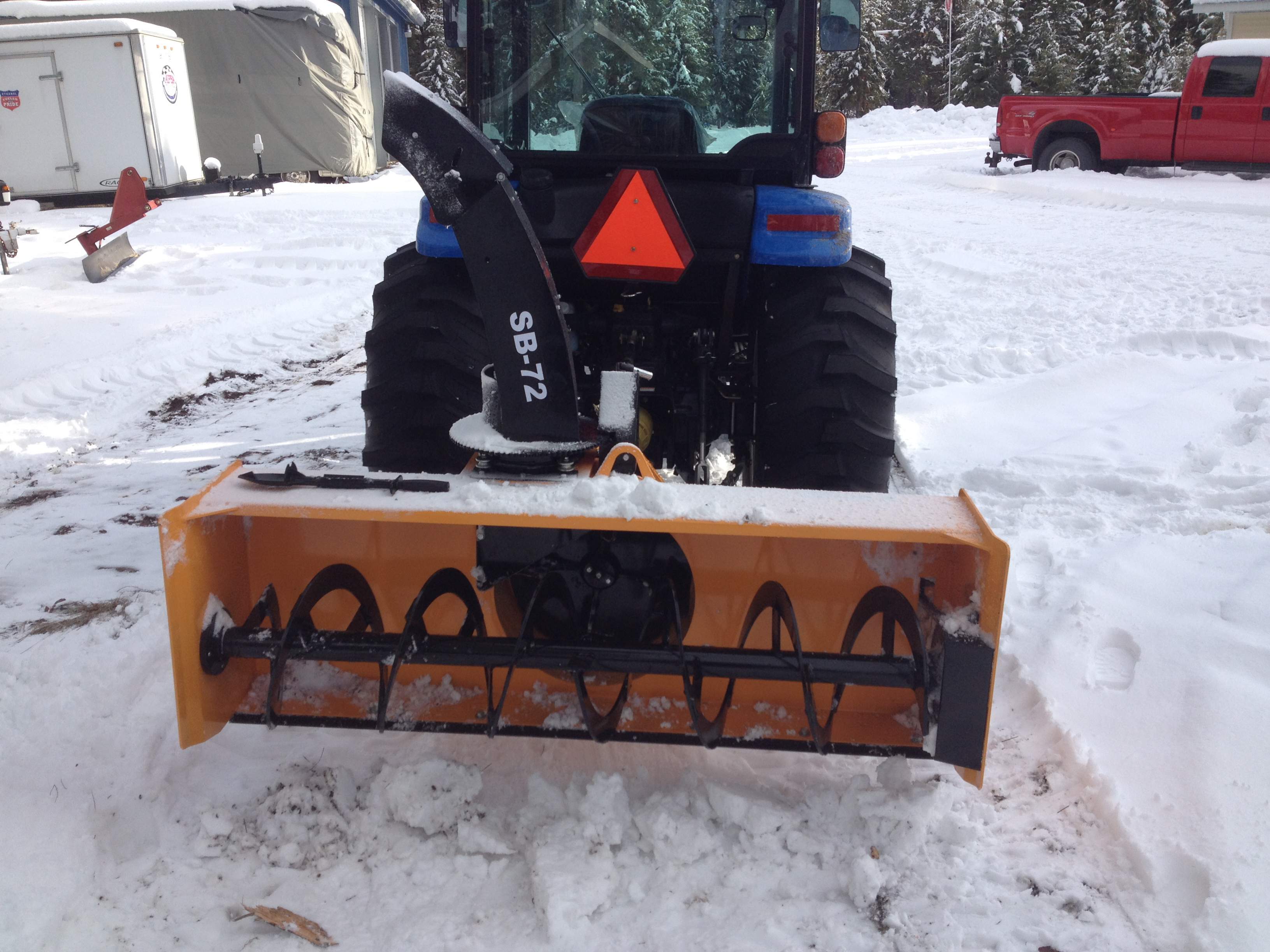

Here are some pics from the delivery day and unpacking the SB-72. It did arrive by an 18-wheeler.
20151119_150215.jpg20151119_150154 (Medium).jpg20151119_161523 (Medium).jpg20151119_161543 (Medium).jpg20151119_161558 (Medium).jpg20151119_161625 (Medium).jpg20151119_201300 (Medium).jpg
My Thoughts I recall at the time:
1) I'm glad I purchased 48 inch pallet forks, I think 42" forks may not be able to catch the edge of the frame when lifting the unit off the truck bed.
2) The paint is a darker yellow then my wood chipper, this yellow is more schoolbus yellow, the chipper is more cub cadet yellow.
3) Overall pretty happy with the quality and welds, etc.
4) The steel frame needed cutting, I used a cutting wheel, but I'm happy to have the scrap metal for other projects!
5) No manual was included, but there was a note apologizing for that and explaining to download it from the website. The note also said the printed manual will be sent to me when its available. The online manual (PDF) was very good, no complaints there.
6) It appears the cardboard box containing the hydraulic kit became unstrapped, but no damage anywhere.

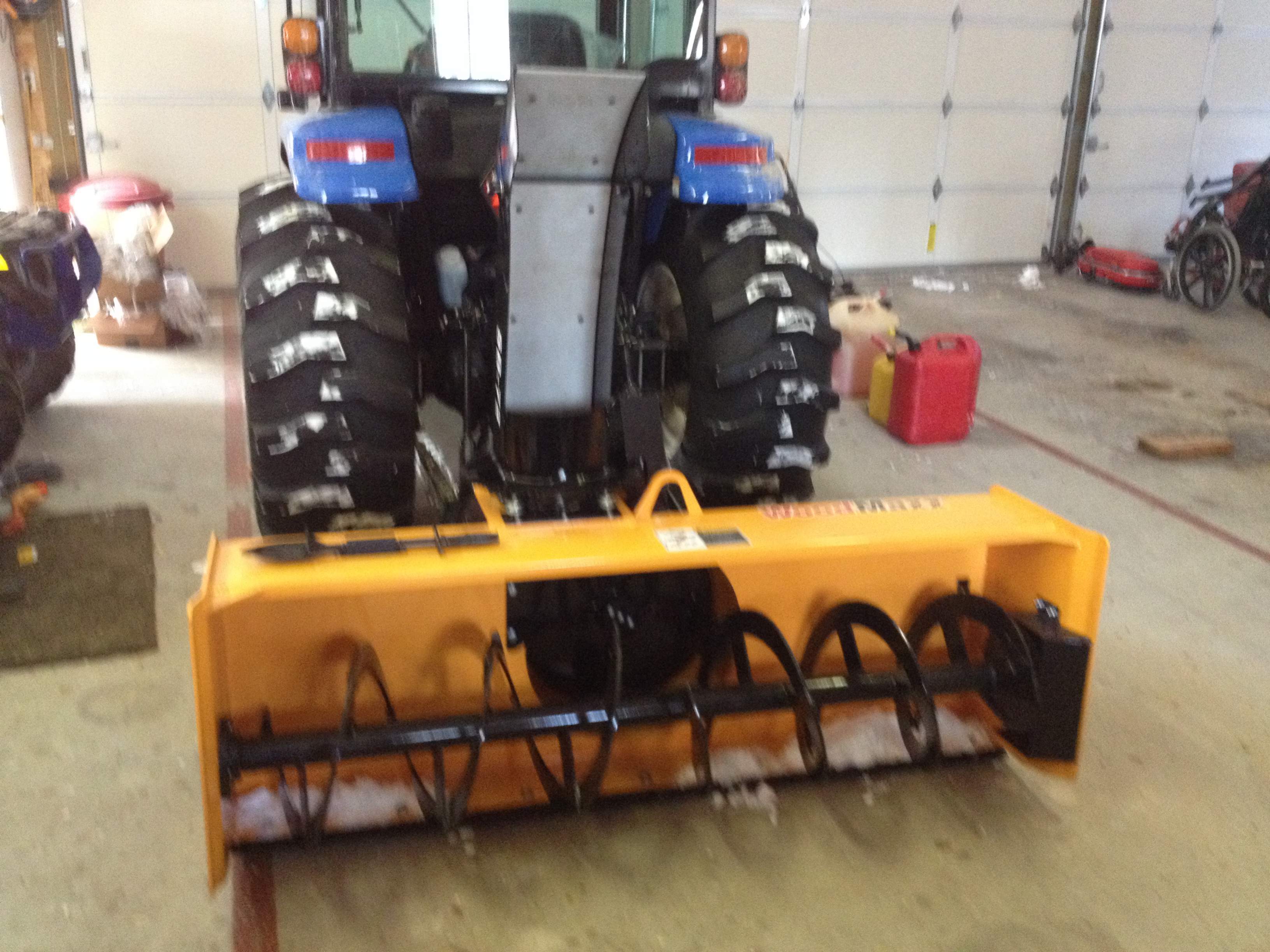

To not disturb my driveway gravel (crushed concrete actually) I installed a 1.5" inch pipe along the cutting edge. The pipe was purchased from Lowes and I removed a 1/2 strip from the pipe and welded on some tabs for the bolts. It came out pretty good I think.
20151129_101508 (Medium).jpg20151129_104246 (Medium).jpg20151129_104316 (Medium).jpg
I also dropped down the skids one notch, which is as far as you can adjust them and still have them secured with two bolts.

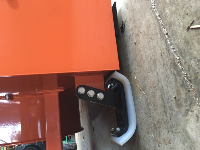

I got my skid shoes on today and that will keep the steel cutting edge off the driveway. Tried heating them in boiling water to form them but a propane torch was the most effective.
