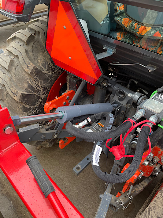

Here's a photo showing how the loader subframe is attached at the rear axle on my YM240. I think this stiffening has prevented the hoe from damaging this tractor.

Whatever yo do, just keep in mind that without a dedicated subframe, the chances of cracking the rear housing and incurring a huge repair bill are very great. No small tractor can absorb the stress without bad things happening back there. I know someone that happened to with an L model and the repair bill was north of 10 grand and Kubota will not warrant that and neither will anyone else.

I know someone also. I was shocked (as was the owner) to see the housing was an Alu. casting not iron. He managed to find a guy that did the swap, it took lots of hours. Not sure what model Kubota it is.
   / Anybody using a backhoe attachment on their CUT? #118
Most modern tractors are today (aluminum pressure die castings) If properly gusseted internally, they are just fine but they will still crack under undue stress, but so will cast iron for that matter.
